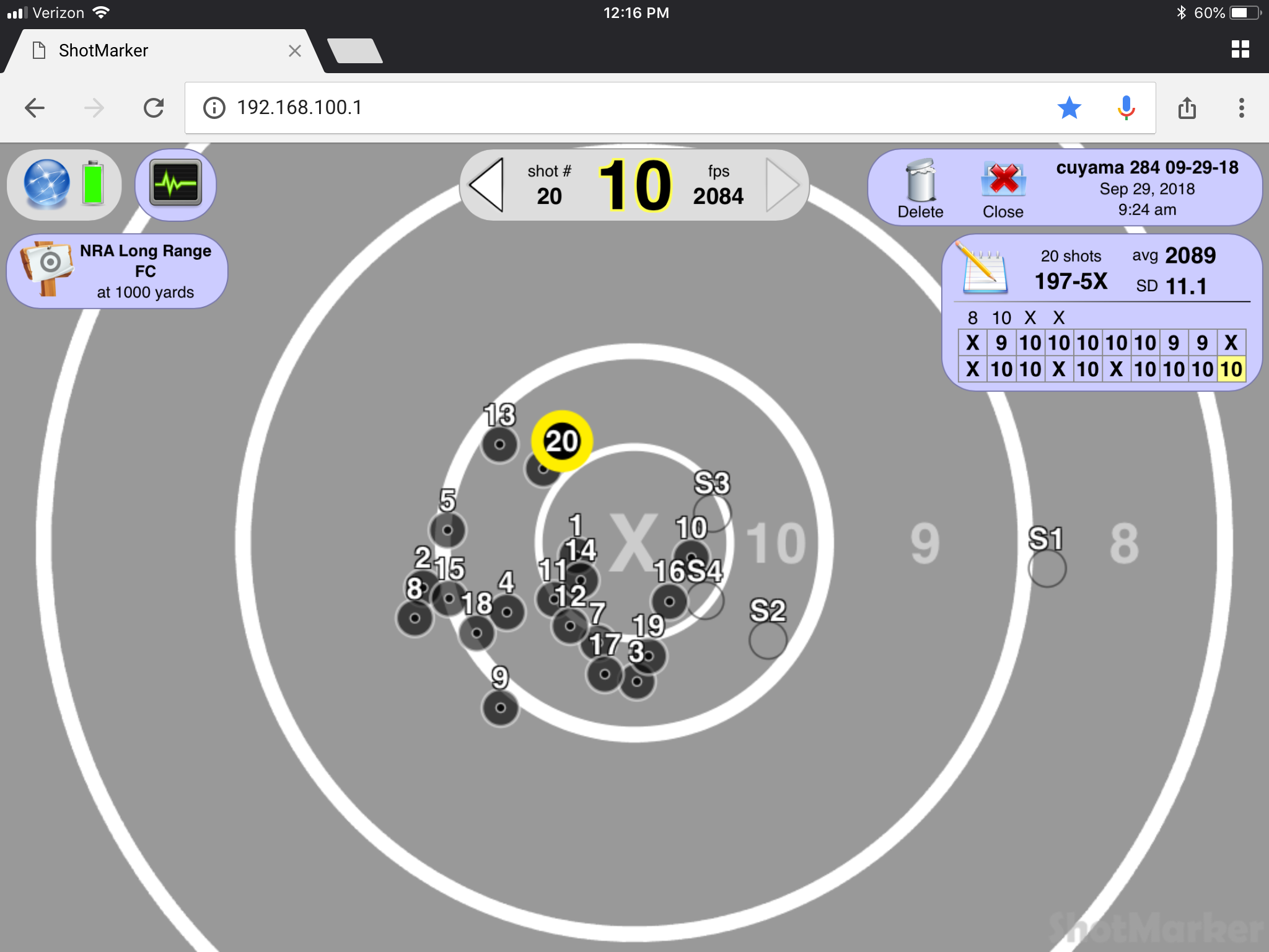

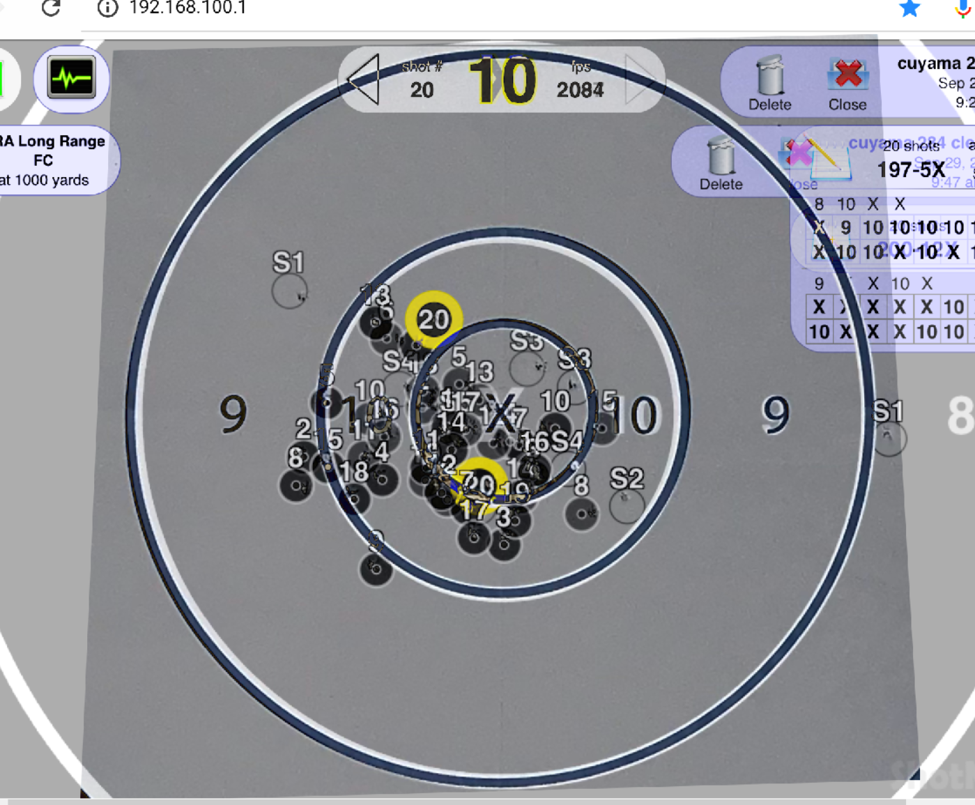

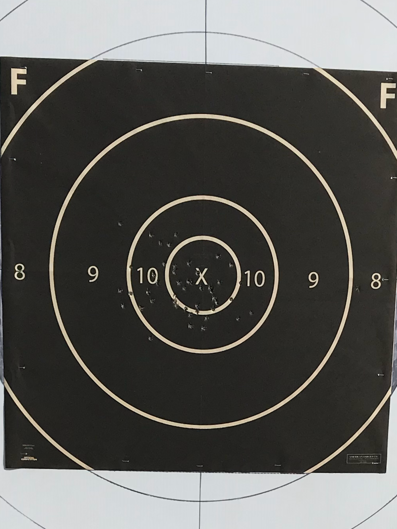

I agree that is pretty close but definitely not "dead nuts".....especially when that 1/2" can ruin a good score. Take a look at the photos comparing the paper and virtual target where the Shotmarker scored 5 shots as 10's when they were really X's. This was 2 strings of 20 shots plus 5 sighters for a total
of 50 shots on target, if 5 were incorrect that is a 10% error factor in my book. I count 27 X's on the paper target but Shotmarker identified only 22.
This is Adam, I make ShotMarker.
I did an overlay, see attached. It's hard to line up the photo exactly and it's pretty blurry but you can sort of see some of them are off by quite a bit, but most are good.
The system itself is accurate to within a millimeter. The sensors are precise enough to be dead nuts accurate. However your results may vary due to physical variables outside of its control. For example, if the wind is blowing and rocking the target back and forth, it will produce some small amounts of random error. If you shoot on a calm day, your frame is perfectly straight, rigid, and not moving, then your results will be much better.
It's not really practical to test the system by simply shooting and posting photos because you are not really testing the system, you are testing your target frame in the conditions at the time. These results show real world performance in the condition you were in, but without detailed accounting of these variables the results are not applicable to someone else.
Open those saved strings and open the sensor monitor. Look at the star quality of the shots (they should all be 5 stars) and look at the variation in the reported pitch and yaw angles. You can export the CSV and graph the pitch and yaw angles over time. They should be within half a degree or so. If you are getting variation in quality, pitch, or yaw angle, this will point to exactly the cause of the error. There's always a reason for errors and usually it's just the target is rocking back and forth a little bit.

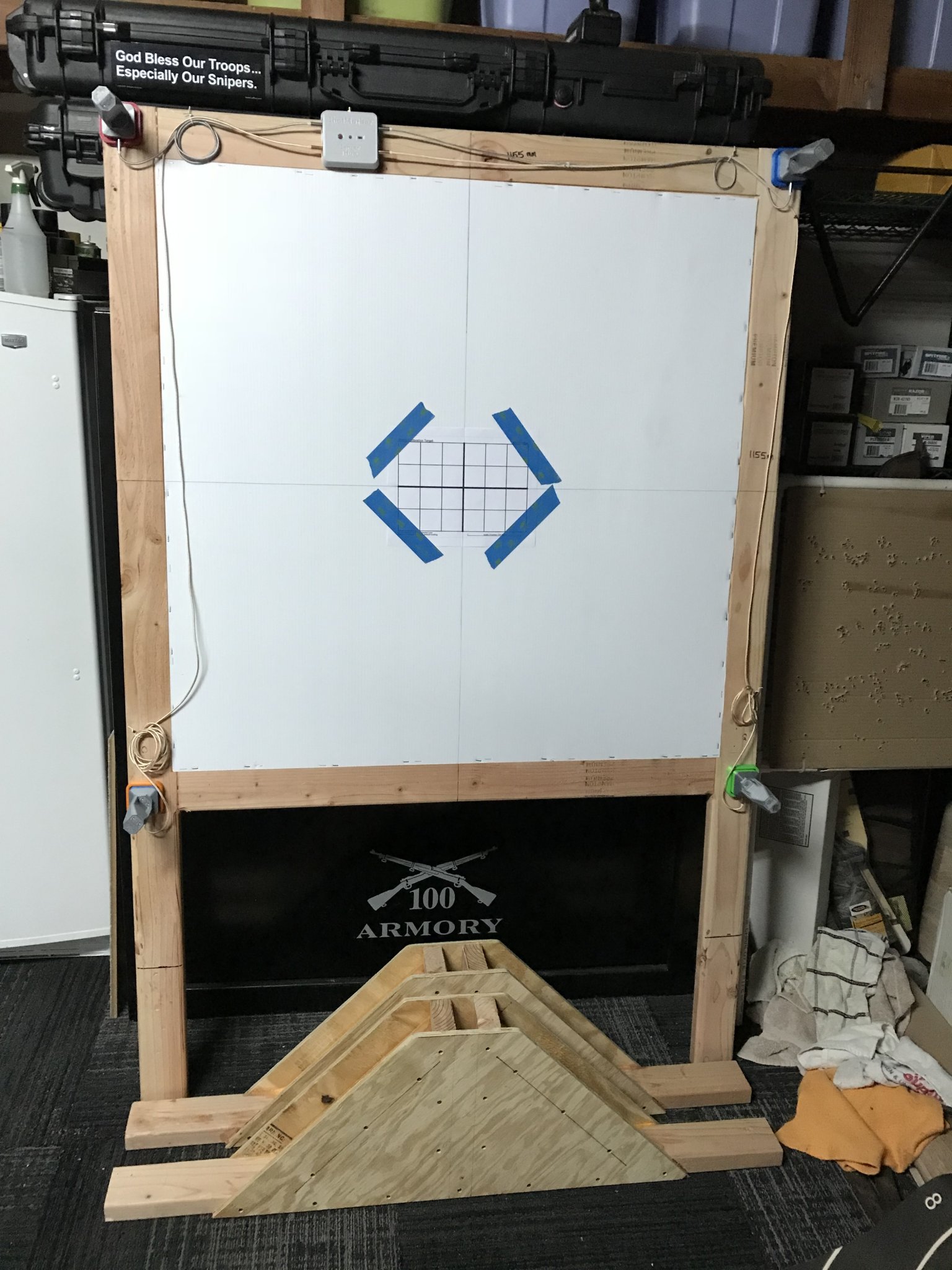

This is Brian and I have emailed back and forth with you right after receiving my Shotmarker. My target frame is only 4' x 4' made from half lapped 2 x 4's and have stable base that does not move nor deflect in winds under 20 mph. These strings along with the others that I had emailed you previously show every shot with 5 stars for accuracy at the target, I believe the previous backup I emailed you showed 4 stars on only one shot.

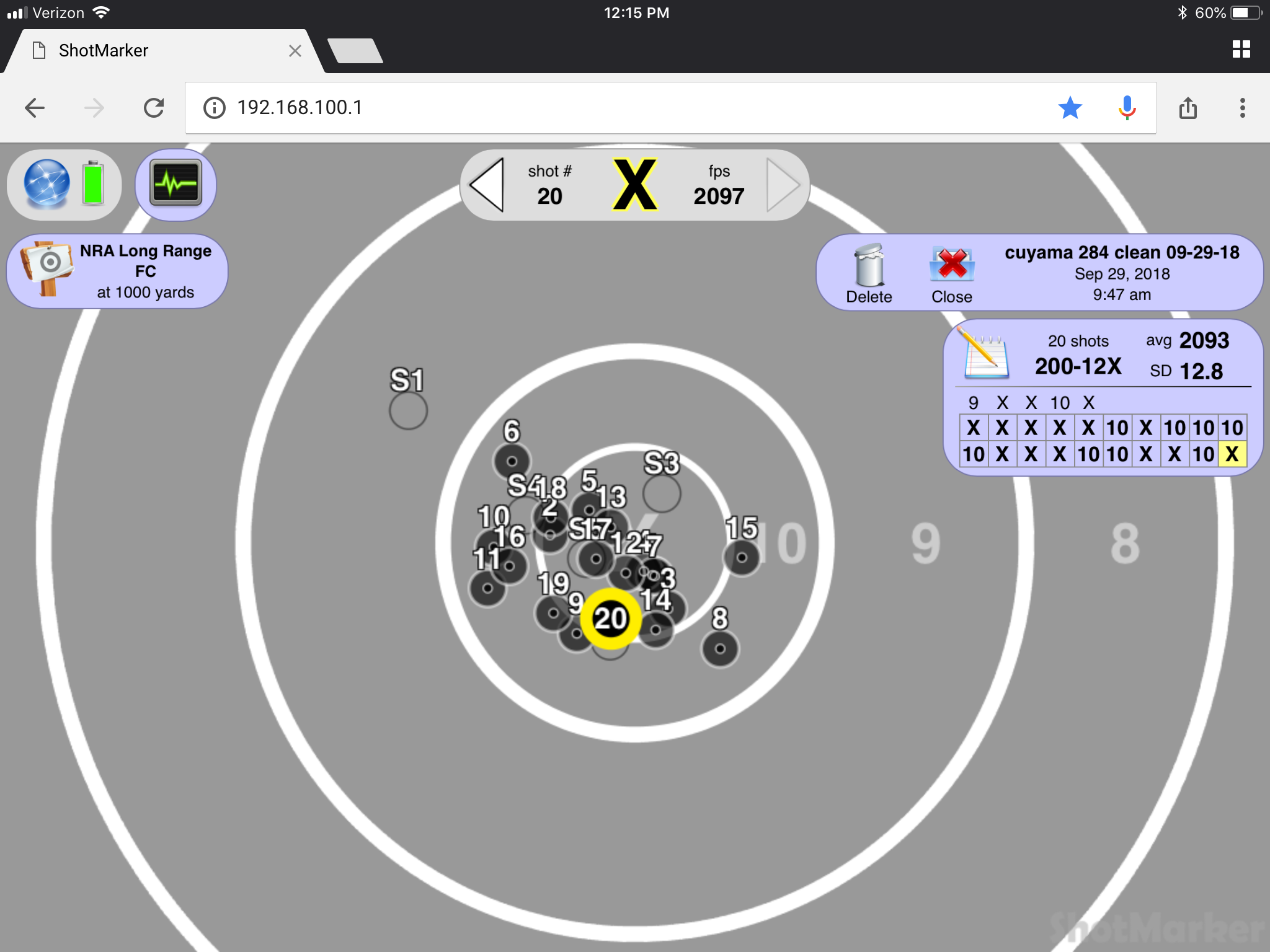

The two screenshots I posted were shot first thing in the morning with the wind flags barely moving, hard to shoot in better conditions. The target frame is very solid and not rocking back and forth in a target carrier but mounted with very stable legs spanning 4 feet. You made it very clear in our last email trail that the wind causes error with ALL open sensor electronic targets, regardless of how well the frame is constructed.
I had posted this thread to get feedback from others using your system not trying to bash any system nor manufacturer. It is not fair to advertise this or any electronic target as being accurate to the millimeter when tested in a lab environment, we all shoot in the real world and thus we and the electronic target are subject to mother nature and more specifically the wind.
I am not an engineer and know very little about how they work but I am a pretty good carpenter and can guarantee that my target frame is not moving nor flexing in the strings I have posted. At this point I use your e-target system as a tool to help my wind reading skills, with load development and do enjoy the ease of the setup and use.

I don't have an explanation for these errors, but I'm fairly confident that they are physical. This is likely a case of the wind distorting the shockwave in the air, something which will always be there regardless of the frame construction.
The wind effect is interesting. When the wind blows to the right, in general the shot will be reported slightly to the right. It's not random, it's proportional to the wind speed, which means from the shooter's perspective, the wind seems to be ~1% stronger than it really is. You make corrections accordingly and get the score you deserve. It's like having a bullet with a slightly lower BC, or a scope that adjusts 0.24 moa per click instead of 0.25, or wind flags that are slightly heavier, or scoring rings that are slightly smaller. It's invisible when you are shooting, the same for everyone, and completely irrelevant from a competition perspective, because you read the wind based on feedback. But when you go to the target and measure the bullet holes, you will see a difference. There is no valid claim for a higher score because the e-target display is what you were adjusting based on.
The random errors are the problem, and only if they are large relative to the grouping performance of the rifle. Generally the random errors that remain are just minor noise, and could go one way or the other. Yes you will gain or lose a point here and there, but you could statistically compensate by just choosing a larger bullet diameter for scoring.
I'm not trying to argue or defend my product or criticize your testing. Everything you've said is perfectly fine and your practical test is well done. I'm just trying to bridge the gap between lab test and real world accuracy expectations and help e-targets become more accepted.

@V-Ref I shoot at a club where the target pits and firing have been in place and the shots on target are shown well within the acceptable angle.
It is a designated target frame, not temporary, the system that we are speaking of comes with 3d printed bases that magnetically attach to each sensor.
The coroplast backing has alignment lines in both axis, an outline of an F-class LR center as well as the target rings to aid in centering the paper target
The dimensions between the sensors are 1155mm from center to center and clearly marked on the target frame as recommended by Adam.
Upon completion the entire frame was laid on a level surface and used a Hilti PR rotating level to confirm each sensor was on the same plane.
