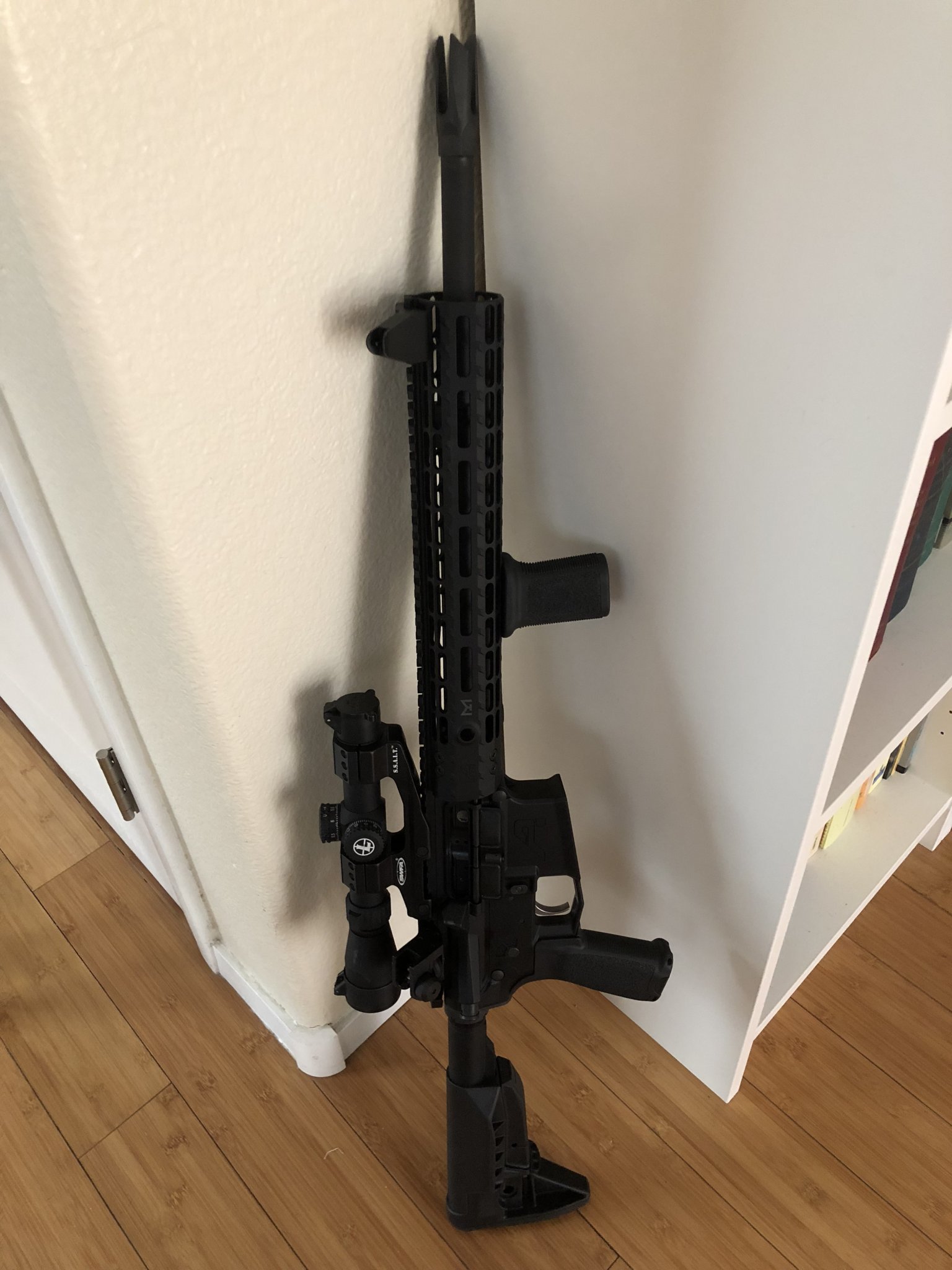

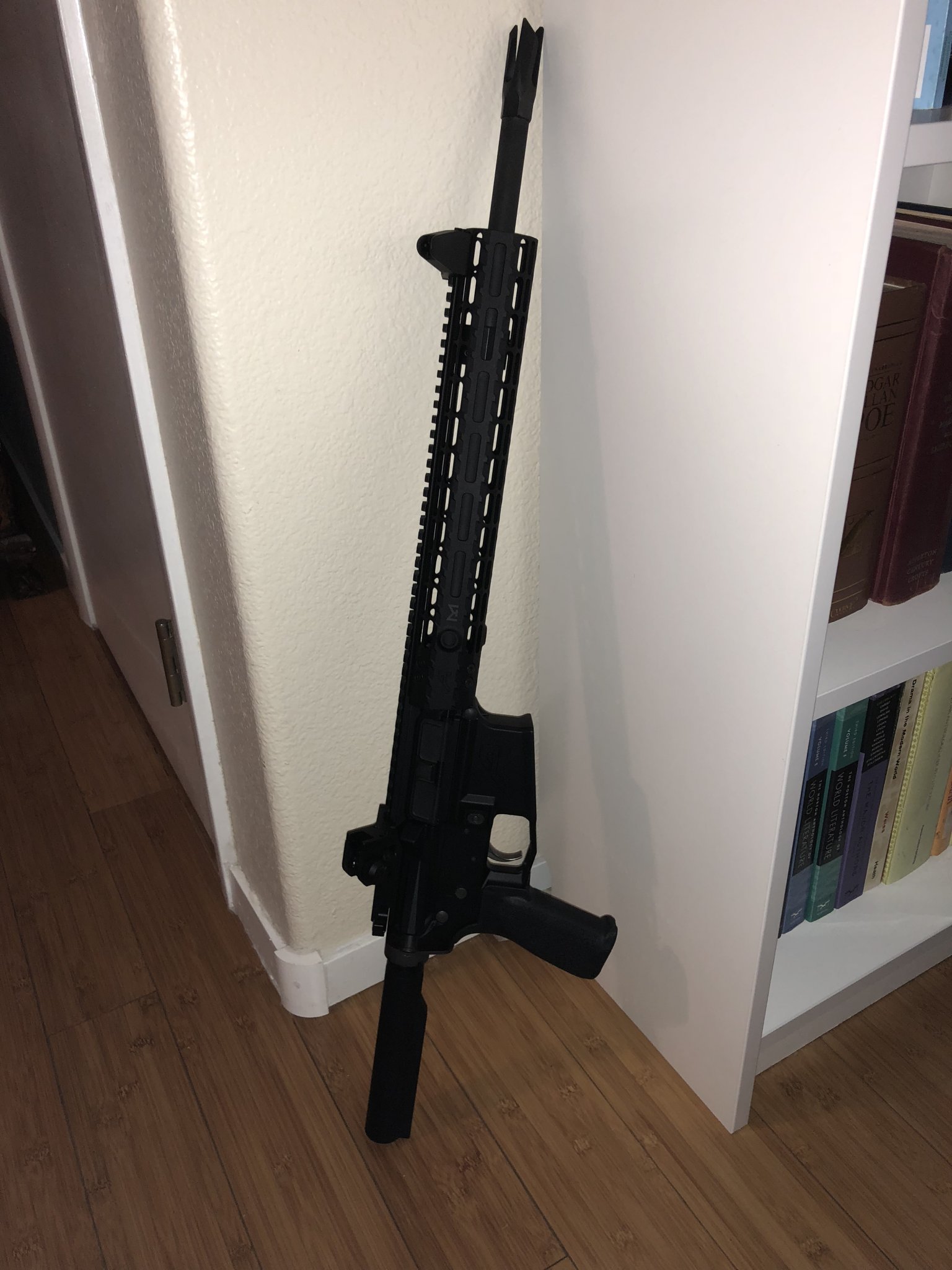

Thought about the Colt ... decided to build because it's fun. Barrel is really the sticking point for me. Good advice all around, so I'm just going to have to go with one of the recommendations above.
Upper (M4E1) and hand-guard arrived today from Aero. Seem decent; smooth machining, lines are true, hand guard locks up fairly well. Next is barrel ... still contemplating the JP pin and weld kit. Will figure it out soon and then BCG based on that.

Been a while, but plodding on. Have most of the rifle purchased and put together. Current parts installed:
Seekins 16” .223 Wylde barrel
Seekins Adjustable Gas Block
Seekins Rook Flash Hider
Wilson combat gas tube (always wanted something from them)
Aero upper with hand guard, and lower
BCM lower parts
BCM receiver extension and carbine spring
Stag H buffer
Ozark offset irons (seeing if I like the configuration)
BCM SOPmod should arrive shortly, along with scope (Leupold Mark AR Mod 1) and mount in the next week.
Kind of a weird rifle ... seems like I’m in between about three different purposes (precision, Self-defense, and range fun). Guess we’ll see how it works out ... 7F71B365-E66B-4612-9C35-4295A7C8FA30.jpeg7F71B365-E66B-4612-9C35-4295A7C8FA30.jpeg

It seems common that for people building their rifles is they tend to build to suit several interests/purposes, and then eventually circle back around and rebuild in their favorite simplified configuration and stick with it.
Or they sell the rifle and build a different thing altogether using the experience they picked up from the first one. It’s a valuable learning experience
YMMV

Well, all done and range-tested. Everything worked the first time, which was sort of ... disappointing. Ended up going with BAD enhanced BCG, to keep something local.
Anyhow, rifle is fairly accurate (1.1 MOA off the red rest with some Winchester NATO); so easy to shoot. Suspect it’s capable of better with more practice.
Not sure why I didn’t build one before ... thanks for the assistance, all.BD7E5AB3-9FC6-4927-96BE-D36FD38962A3.jpeg

You have built a custom rifle, nice.
You got 1.1 moa from wwb ammo, double nice.
Very lucky guy.
I'm impressed.
How high is you scope center to center bore with that mount?

Don't be disappointed with that man. Guys pay big bucks for name brand rigs that won't shoot that ammo any better than your rifle did.

Definitely not disappointed in the accuracy ... was just a little miffed that I didn’t have to tinker with it much after the build. I had a good time choosing the parts and putting it all together; didn’t think the process would be over so quickly though. Got lucky and the thing shoots really well ... guess I have more time to practice now. 😀
Scope over rail is right at 1.5” and a hair (haven’t measures at the bore). Came with the scope and a couple of mags from SWFA in one of their bundles. Thinking about upgrading to the new Larue C.A.N.. The SALT is heavy, and overbuilt for a 5.56, in my opinion. A little maximal, what with the 6 screw rings, for my tastes.

Thing I saw was it cleared the buis, nice.
Try a box of pmc 55gr down the tube.
Shoots way tighter in my guns than wwb and no primer strikes for thousands of rounds.
