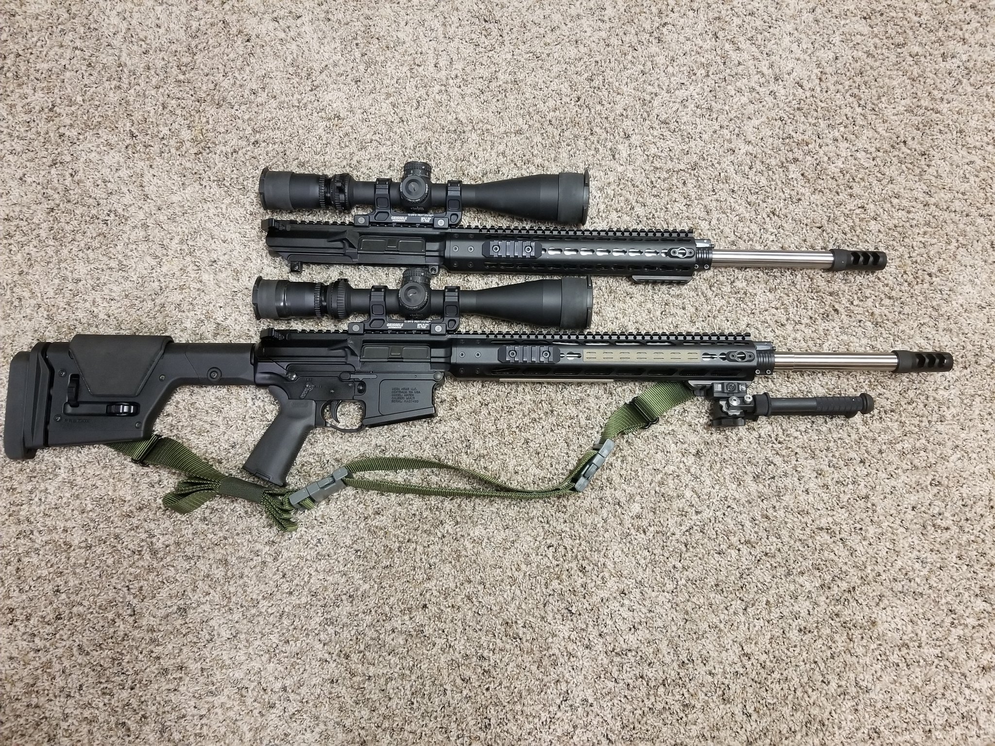

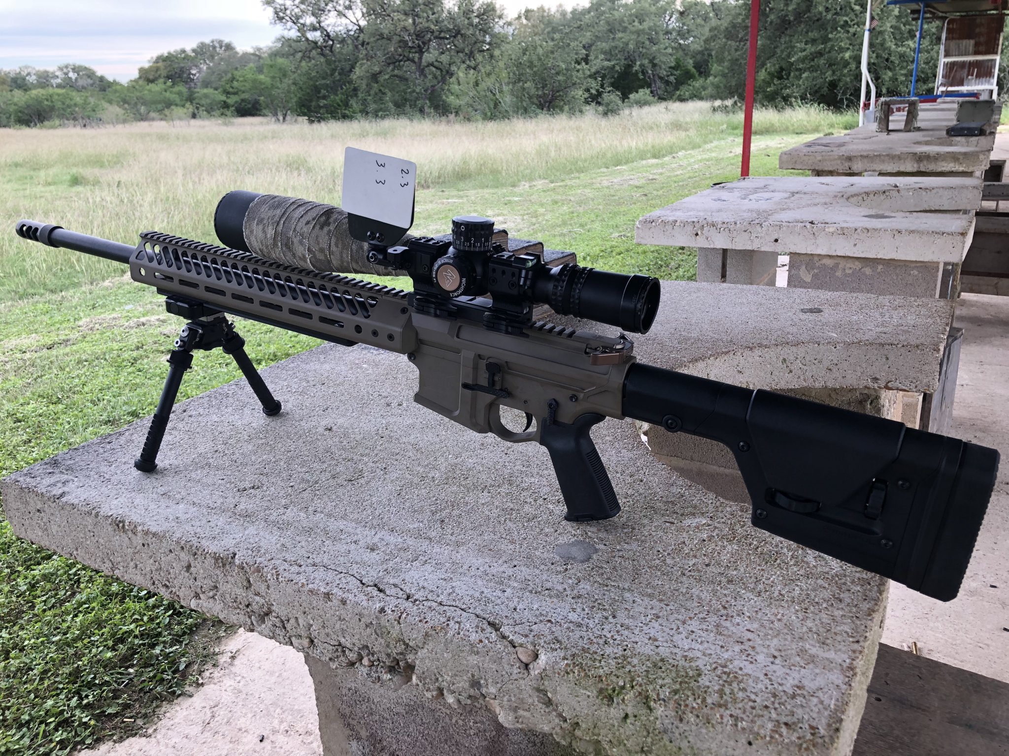

Here is my build using JP parts and Seekins build kit. In my case I used a Krieger barrel and JP bcg, bolt and SLR gas block.

Sorry I wasn't clear. I bought the SP10 upper, lower, handguard kit to build a 6.5CM.
I'd like to build another complete upper to drop onto my Seekins SP10 lower, but Seekins only sells kits so I can't get their upper.
Has anyone put a different mfg upper onto their SP10 lower or do I have to do another complete build? I'm aware there isn't a "standard" but I also know that some uppers can go onto different lowers. Just curious if anyone had done it with a Seekins.

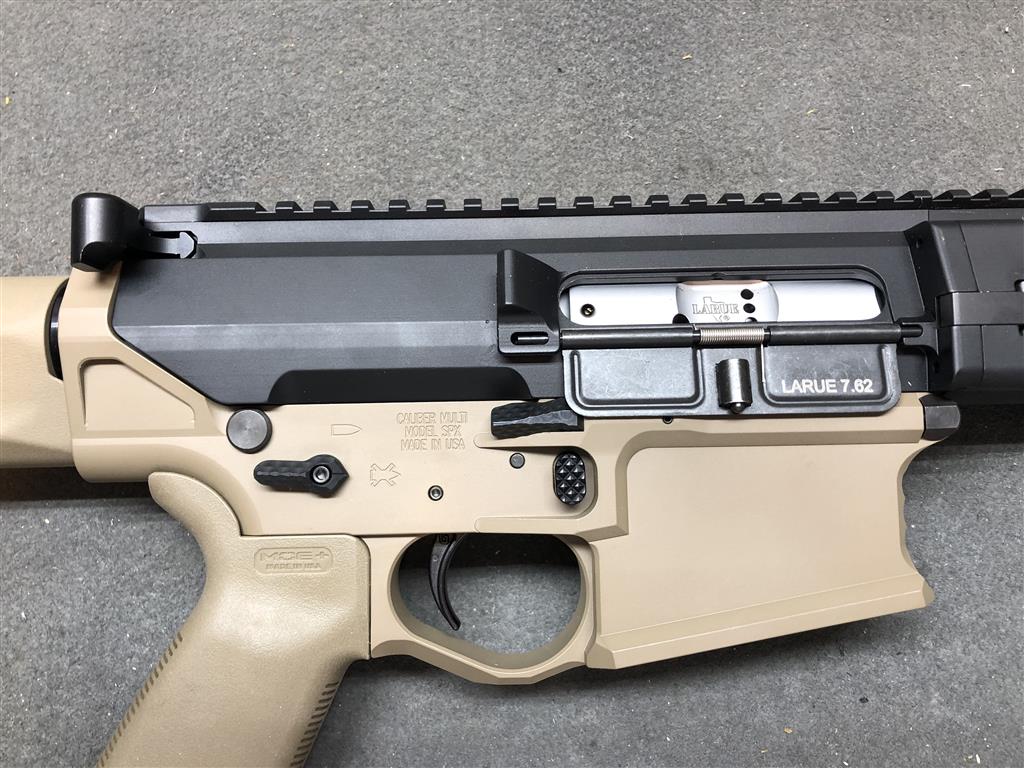

Been curious about this in the past but not where I could check a couple. Looks like an Armalite would fit but it won't (at least one of the older ones), close but pins were off a hair. A complete LaRue PredatOBR upper went right on with tight lockup (a little gap in the fit) and seemed to cycle/dry fire as it should. A stripped Matrix went on but was loose and with sloppier fit than the LaRue. Not saying you should do it or that it can/can't be done but there's a quick test of 3 different uppers on an SP10. There are other mfgs with similar patterns and one or more might be fine but easiest is probably to try to get an actual Seekins upper.

The barrel extension is from Krieger, that’s where I got the barrel, it’s headspaced to a JP bolt. They can also sell you a JP bolt. The bcg is JP. I used a SCS for the buffer/spring.
The tolerance was fine it wasn’t loose or too tight. I didn’t have to modify anything at all for it all to fit.

Moot point since I think the only way to get a large frame LaRue upper is to buy the ultimate upper kit making it more than the complete Seekins builders set. And I know physically fitting isn't the whole story, but I'm curious, what is it about a LaRue upper that makes it not work on a SP10 lower?

Well shit, when I tried and OBR, I could not get the thing to close. Good to know.

Haven't fired it that way but just for kicks I stuck 10rds in a pmag and cycled them through w/o any issues. Gets me to thinking though. It would be neat if Seekins offered a large frame upper with a more typical barrel nut/handguard setup. I know that's not what the SP10 is intended to be and there's probably a reason they don't offer but for those with an SP10 lower it would be nice to be able to build another upper for it.
