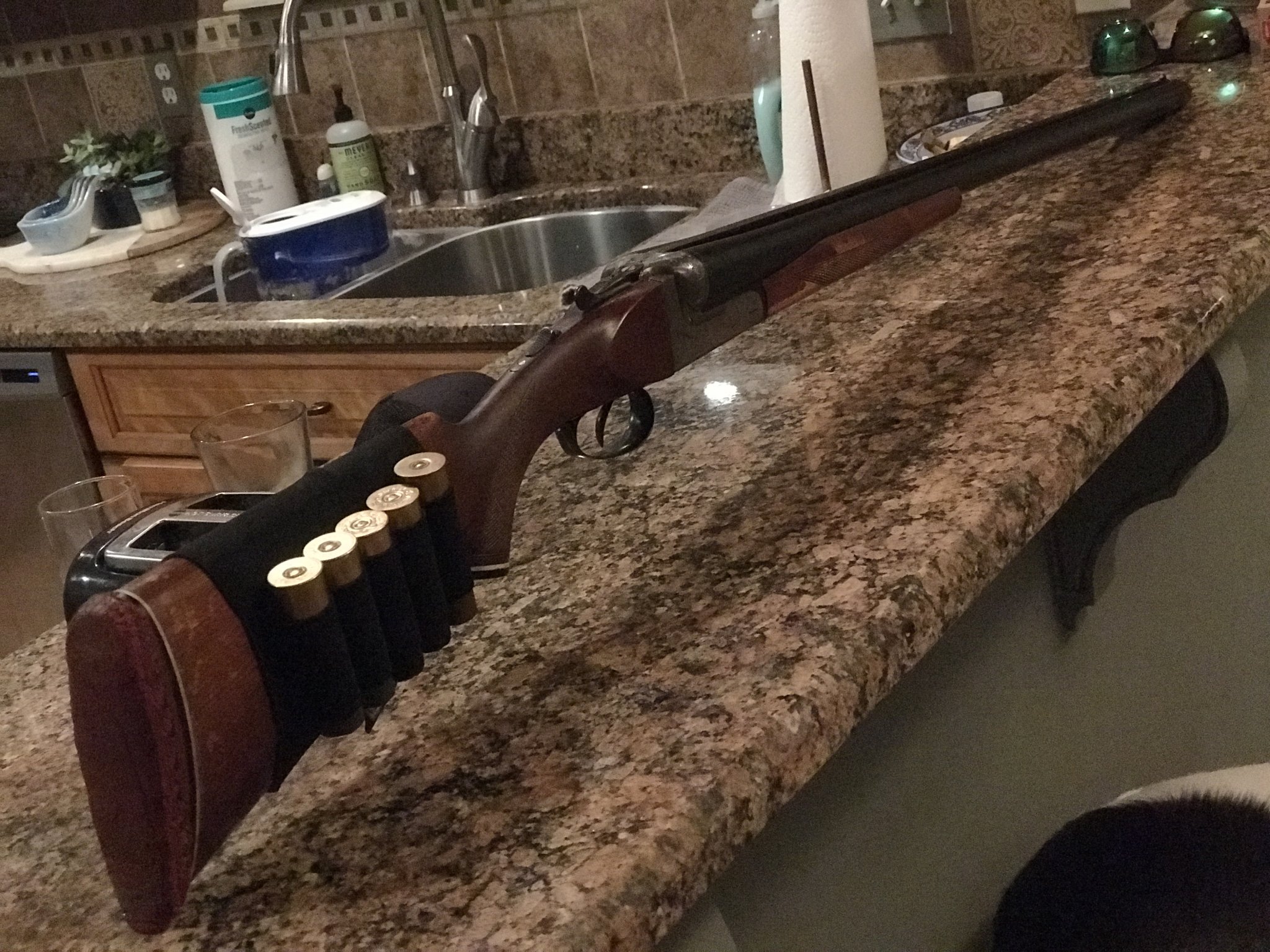

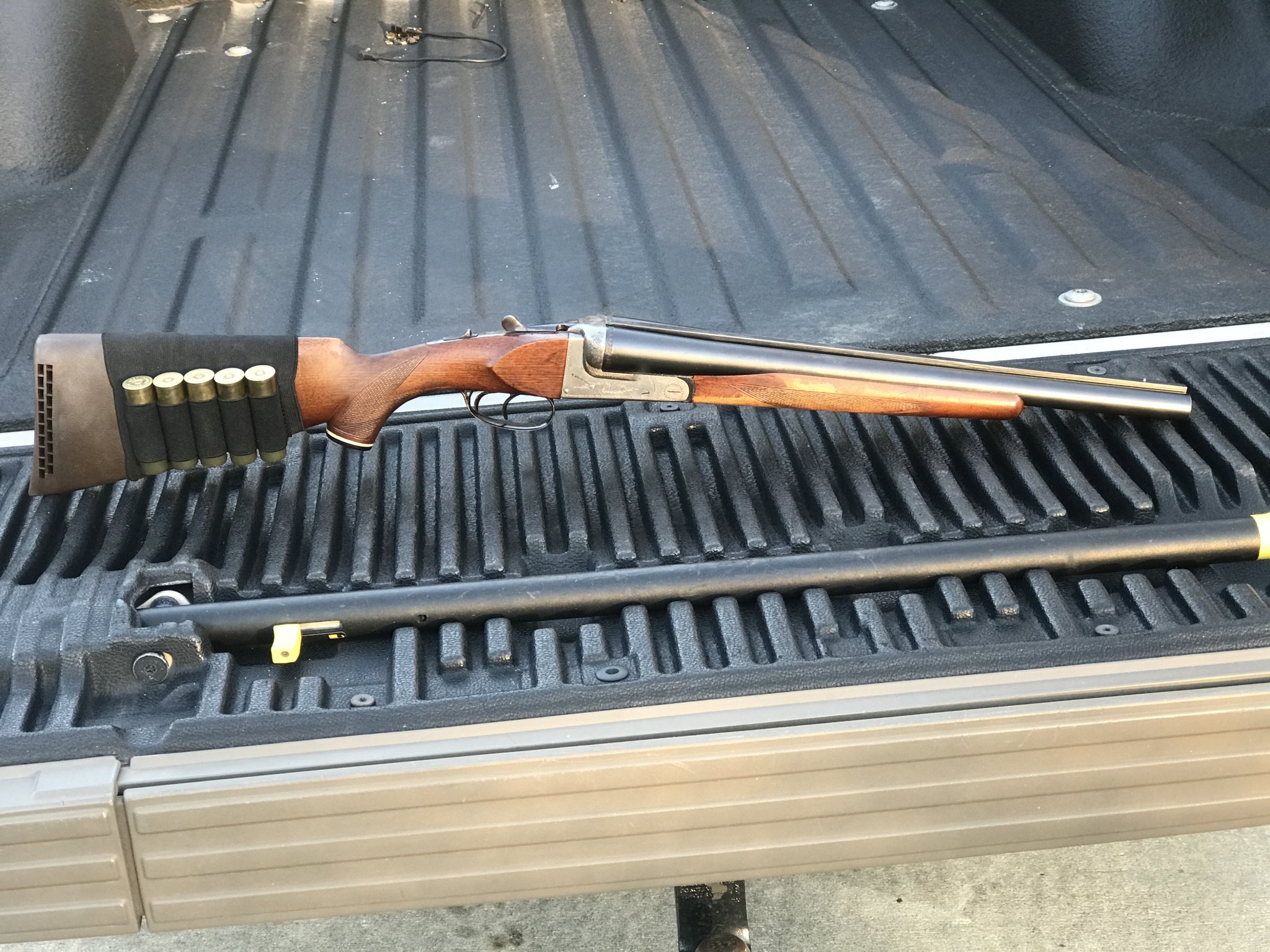

So I bought this absurd 10 gauge sxs shotgun that is in great shape, especially for an old gun. Only issue is it (was) extremely long, like the damn thing was 4-5' long total.
I don't hunt geese, and already have turkey guns, so what else is there to do besides cut this bad boy down?

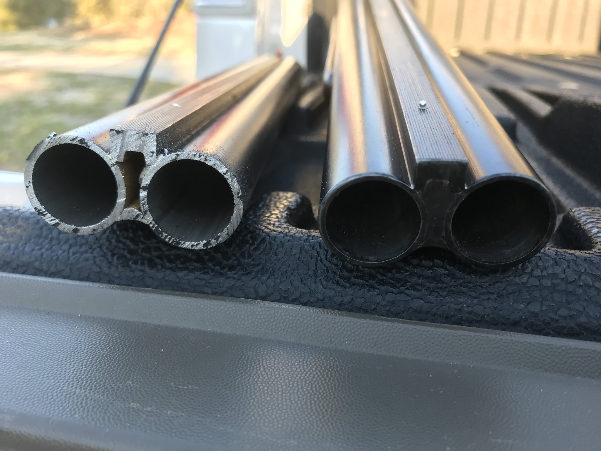

This first pic is the original barrel length...
This next pic is the portion of barrel that was cut off, next to the new muzzle after being filed, crowned (lol), and cold-blued. There was a gap between the two barrels as seen in the unfinished section of barrel. To fill this in, I stuffed the void with steel wool, then poured molten solder into the gap. When it hardened, I filed it smooth to get a somewhat finished look.
Here's the finished length at 18.5" (1/2" relief left just to be safe, or in case I messed something up on the first cut)
Next step is a quad rail with a mounted light and laser. Yes the gun is a novelty, but a damn cool one. I am not sure how well the light and laser will do with the recoil factor, but it's going to be a sweet little rig. I think I might get more enjoyment watching other people shoot it!

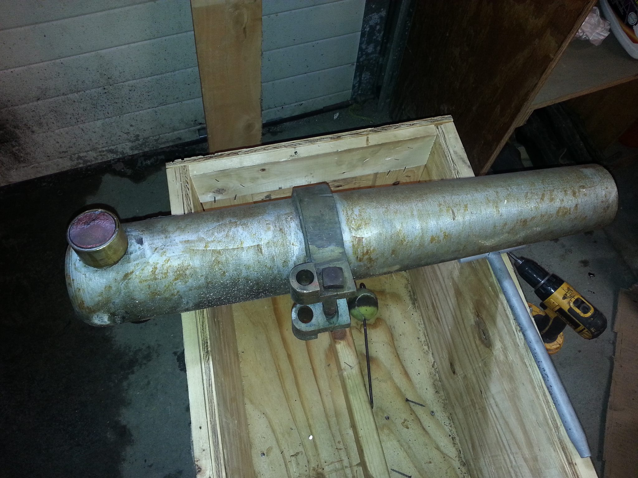

I was a deck ape (all 5'1 3/4" of me) before I switched to engineering and it was intended as a derogatory term for us but we began referring to ourselves as deck apes as a verbal middle finger to the ops types that looked down on us.
A couple of things to note from the pic on the deck of the Katmai Bay above, that is a 30-06 case full to the crimp of powder pushing that 15 ounce (not grain but ounce) projectile, the front and rear sights have been removed to keep them from removing the shooters right cheek, lastly the shooters left hand is required to go over the top of the rifle when firing to help control the upward swing of that bastardized '03 (not a light rifle). The shooter is required to lean into the shot like that and I have seen 200 pound guys pull the trigger that far into a lean and end up standing straight up post recoil. Our gunners mate put one of those 15 ounce projectiles THROUGH the wheelhouse of a fishing trawler while trying to pass them a tow line in 90mph winds, the projectile missed the fishing trawler captain by about a foot.

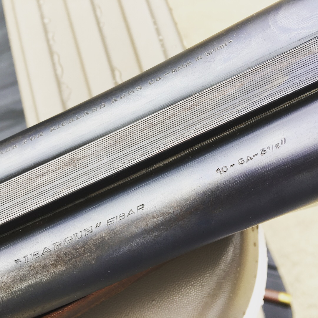

I bought one about a yr ago... off gunbroker..planning to chop it down also but when it arrived it was a little to nice and I couldn’t or haven’t yet chopped her down.. it sets in the corner for a conversation peice
