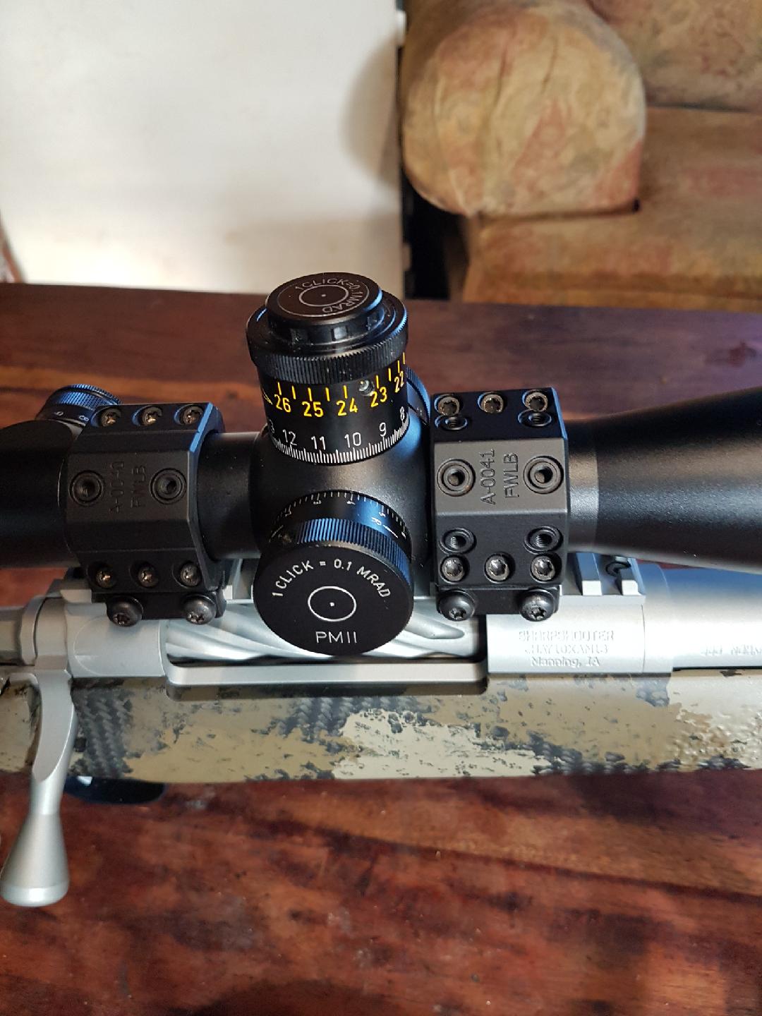

What are you using to prevent scope slip in your rings? Is there a rosin or glue I should be using? Need advice. I am running an S&B in a Spuhr on a .338LM.
Is anyone using loctite (blue) on their Spuhr ring screws to prevent them from backing out? How about using loctite on the rail screws?
Trying to make this thing bullet proof.

If my memory serves me correctly Spuhr does not recomend using any adhesive on there mounts. they just state you can use it.

I believe you are correct. They "strongly recommend" rosin and list glue as an alternative what I'm assuming is a bomb proof setup.

Are you actually having slippage problems ? If not, I would suggest staying with Spuhr’s standard mounting instructions. As shipped, their mounts have “wax” applied to the threads of the cap screws and all three of my SP 4006’s haven’t had any slippage problems whatsoever. Having said that, they are mounted on .223, 6x47 Lapua and 308 win, none of which are anywhere close to the recoil of .338L.
I have had, and tried many different ring/base combinations in the past and really never had any slippage problems, including Badger .50 cal rings on a .338L build. Really nice rings. My suggestion is that if you have a Spuhr mount, follow the mounting instructions, try it as is and if you have slippage problems, then and only then, try to solve the problem.
I have standardized on Spuhrs because they have thought things through to the N’th degree and their machining/finish/quality is just superb. By the same token, yes, there are many other really good mounts out there. It’s kind of hard to find a shitty scope mount these days.

I can certainly tell you that simply torquing everything to Spuhr's specs without anything else didn't work out well for me at all... 3/4 of the ring cap screws backed loose after 100 rounds of 6.5 Creedmoor.

I use a Spurh and S&B PMII on my 300 Win Mag. While not as bad as yours, I send the 215's at 3,000 fps. I have had no issues, and I do not use rosin. Blue Loctite at 15 inch pounds is all I do.

I push the scope forward in the rings until the turret housing stops against the front ring. Yup, it’s that simple.

That shouldn't be necessary to prevent slippage and gives your objective bell the minimum support. I personally do the opposite - put the front ring as close to the bell as your rail and eye relief permits.

If it slips, try some rosin powder. You really do not need much.
As far as blue loctite goes, I would strongly discourage using it on screws that hold the ring halves together. If you use a torque wrench and loctite, you are likely overtightening the screws. Wet torque and dry torque are different.
If the screws are loosening over time, degrease them.
That having been said, I have zero experience with Spuhr mounts. I have used a lot of other mounts and almost work more or less the same way. Mostly I use Aadmount and they do not slip on a 338LM in any way that I can see.

Used rosin on a Spuhr 4601 mounting a PMII on a 338LM. Tongue all screws to spec & sequence. No issues after hundreds of rounds and occasionally, check screws with torque wrench. Not a fan of using Loctite on rings.

Some thoughts on torque and ring scope installation. I talked to Kortik about torque values and he said they should be quoted based on dry parts. If parts are wet (oil, Loctite) reduce torque value by a quarter to a third. As to Spuhr specifically, I think they recommend the use of rosin.
Rosin, is available from Midway at twenty bucks for a half pound. Use of rosin for mounting scopes is pretty much standard in Europe but not so much here. You should also use rosin when using a barrel vice or blocks to remove a barrel. Some people recommend putting the rosin into suspension in alcohol and then painting it onto the surfaces you don't want to move. On my RPR I had to use a three foot cheater to get the barrel nut loose. The barrel never moved in the barrel vice. This stuff really works. If you remove the scope from the rings use alcohol to remove the rosin from the rings and scope tube. You will have no residue and no ringmarks. I apply the powdered rosin with a Q-tip. The halfpound will last you and all your friends about five lifetimes.
There is another consideration regarding the mounting of scopes. We use a significant numbers of rings that are aluminum with steel cap screws. I was told years ago to tighten to torque the screws in a crisscross pattern. Then to loosen and retorque each screw in a similar pattern. The reason given was that the first round would initially compress the aluminum threads and the second round would be more stable. I would love to hear from someone like Glen Seekins whether this is a wives tale or a worthwhile additional step.
Check with both the ring manufacturer and scope manufacturer for recommended torque. Use the lower.

Sub 9lb. Ruger .416 Rigby using Ruger rings and blue loctite the scope slipped. Lapped the rings and used rosin / loctite. Problem solved.

Rosin works great. There is purple loctite that i have used on ring cap screws before for customers that had to have something. Degrease your screws and the rings. I always use blue on the base screws.
All my personal scopes get reference marks with a pencil on front and back of scope tube right up against the ring on the top half. This will at a glance show you if your tube is slipping fore and aft. Then with a silver or gold sharpie I dot the ring cap and scope tube. This will show rotation at a glance.
These marks are the first thing I check if the rifle shows a problem.
