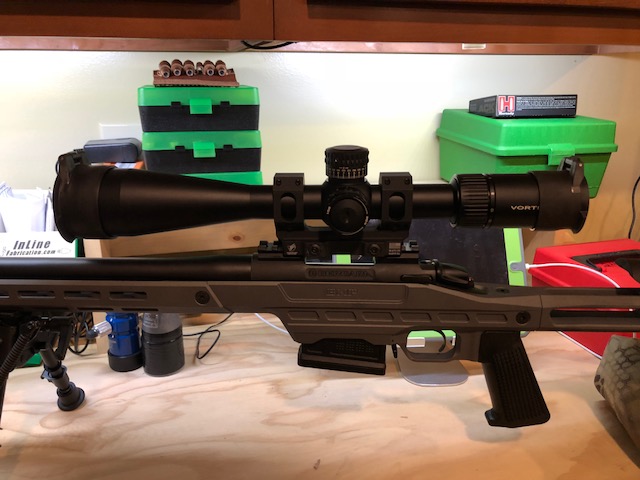

Just mounted my Viper PST on my Bergara BMP with an American Defense mount and it looks really high. It feels good on the cheek but I'm worried its too high. I'm new to long range and want to get the rifle right. Let me know what you think please. The base is a 20 MOA and the mount is 0.

I changed the mount on it and went with medium rings. It looks better but check rest is all the way down now and I have to get settled in on it. I'll try to get a picture of the new setup.

I can get settled in on this ok, just seems like I have get down on it and move around some. With my Tikka CTR and Bergara HMR it kinda comes natural, I get down on it and I’m set. I know I’m inexperienced and have a lot to learn, just want to do it right the first time.

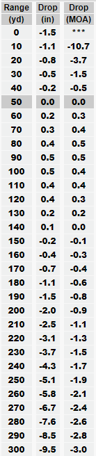

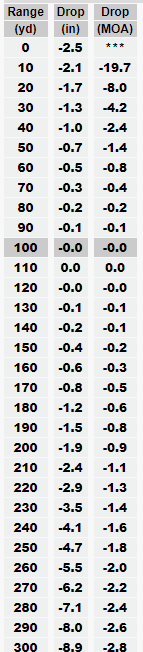

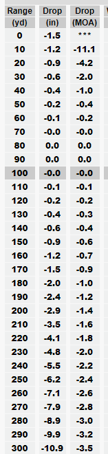

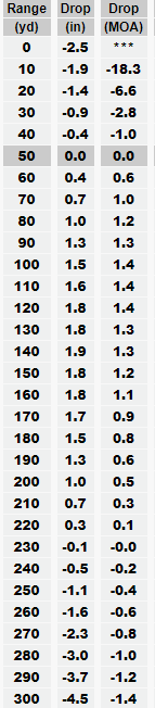

I think much of the old close-to-the-barrel-as-possible is also a rule of thumb for general hunting, with the scope way high there is a bigger difference inside of 100 yards. Enough to matter? Not really but many hunters still never go over 100 yards on a shot anyways so that close range stuff is an effect that they could easily observe on pie plates at 50 yards. Go beyond 100 yards and the higher up actually works a bit better with the point blank range but again, most deer arent shot any further than 100 yards so the shorthand became what it is.
1.5" over bore -------------- 2.5" over bore
They also used 50 yards zeros too a bunch to try and time is right for the 50/200 zero and its a bit flatter with the lower scope height to 200 as well.
Thats my speculation at least

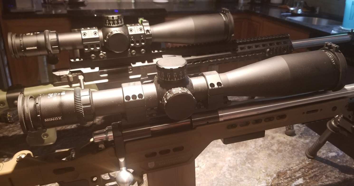

Like Rob01 has commented, some rifles are designed to use a tall mount, even though use of a tall mount (even with a 56mm or larger objective) will leave a large gap between the barrel and the objective bell.
I have an AIAX which requires a relatively tall (Spuhr 4006, 1.35" high) mount for a 56mm objective to clear the forearm (handguard) with its full length Picatinny rail. The comb (cheekpiece) is at the bottom of its adjustment for me to get a proper cheek weld behind the scope at this height, so I couldn't use a lower mount even if the scope bell were a smaller diameter.
My friend has an AIAT, which has the same stock as my AIAX, with the same comb lower limit. Even though the scope objective bell clears the barrel with at least 1/2" to spare with such a tall mount, he can't use a lower mount as he'd never get his eye pupil aligned with the optical axis of the scope because the comb won't go any lower.
With more scope height over the barrel bore comes greater sensitivity to windage error introduced if the rifle is not shot with the scope bore directly above the barrel bore (rifle canted sideways) when the scope is zeroed and when shooting at a distant target. I run a scope mounted level to decrease the likelihood I'll cant the rifle.
It also looks a little odd when there's a large gap between the scope and barrel, another downside to more scope height.
That said, my 2 LR rifles are the 2013 AX and a 6x47 Lapua in an MPA BA-Lite chassis. I run a Minox ZP5 5-25x56 on both. The scope on my MPA is in Seekins low 34mm rings (.92" high) with the comb on the MPA is at its lower limit, resulting in nearly 1/2" lower scope height than the same scope on the AX. The comb on both rifles are 1-7/8" below the optical axis of the mounted scopes, so I get the same cheek weld on both.
Is it possible for you to lower the comb on your MPA? scope heights AI vs MPA cropped.jpg
