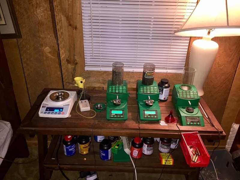

I use the Chargemaster and my loads are very accurate with velocity spreads in the low teens and single digit SD. For a kit that can be found in the for sale section for $225, it's a fantastic tool. If you pick one up, make sure you buy the reducing insert as well, which is also for sale in the reloading PX.
With all that said, I am really tempted to spend the $800+ on an FX120i and trickler. The Chargemaster resolution is 0.1 grain, and I've found it's not quite as precise as I'd prefer. Let's say I'm dispensing 42.0 grains. Sometimes my charge weight is actually 41.98 grains. Sometimes it's 42.05 grains. I realize it's me being a perfectionist and the chance of me actually missing a shot because of 0.07 grains is microscopic, but I'd prefer to shrink that discrepancy down to the 0.02 grain resolution of the FX

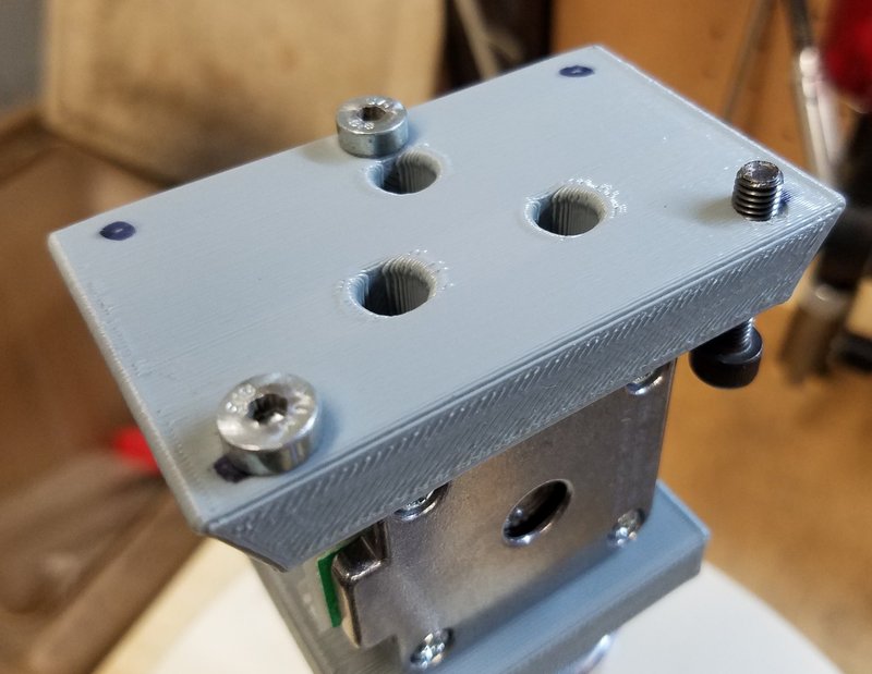

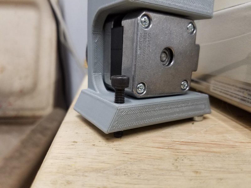

I'm going to drill and tap 3 holes in the base for leveling feet, as the squishy double sided tape on the bottom of the included trickler base is its only immediately obvious weak point.

That Area 419 frame is nice but I can't justify the price. It's certainly $75 worth of material and CNC time, but I've spent enough for the time being.
I added 2 fixed “toes” and an adjustable one to the plastic frame . Given the thin cross sections it was a bit of a challenge but 105% thread depth helped. The screws are whatever I could find in my bins.
Much easier to fine tune level now.
