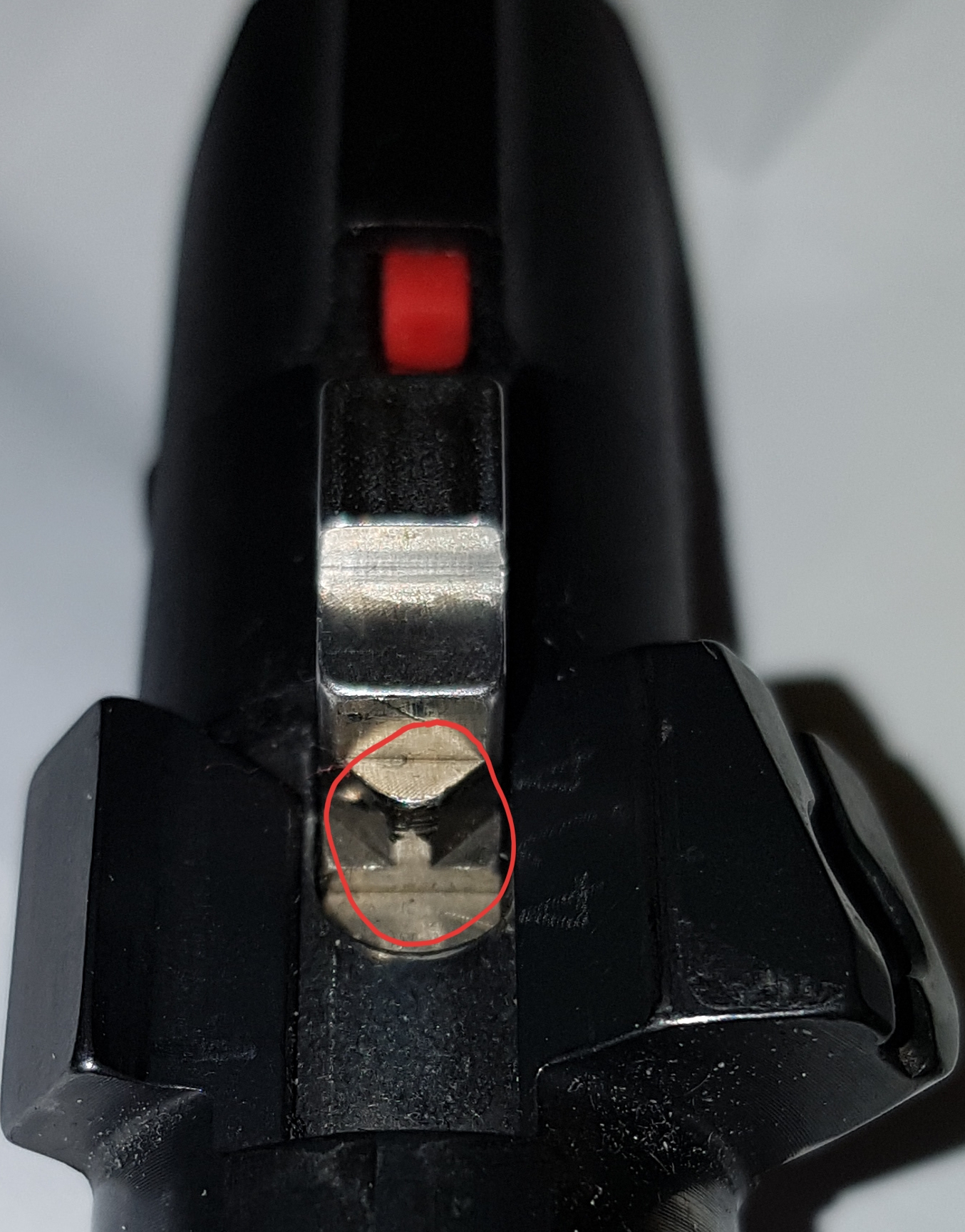

But closing took small force. Not much, but I wanted to make it even smoother.
I found a fix for this from web. I took some material, 0.5mm/0.0039" from the bolt to make the bolt catch trigger later. This is called timing?
I believe that also the trigger surface can be shortened, sometimes even adjusted.
Now I can close the bolt with my pinky and it is by far the easiest and fastest bolt I have tried. It just flies.
I also wanted to ease working the bolt up. As you know it gets more demanding with the 60 degree throw.
I did this by rounding the edge that climbs up the bolt to cock it.
I also had problems extracting 22LR. But it threw the HMR cases like 1 meter away. I do not remember which ammo did it concern, but it was like 1/20. I took slightly some material from the top of extractor claw to let it rest fully on the rim.
I also had sometimes a case left on the mag, an ejection problem. Never with HMR though, only 22LR.
For this I found some instructions but I mainly just tried myself to eject slowly and watched closely where the extra kick needs to be.
I then bent it a little and it is good now. I should boost it some more so that they fly better into my casecatcher.

@AirGunShawn
If I were to have a part failure I'd go look from brownells first. Check MGW too.
I consider only the firing pin and maybe the firing pin spring to be reasonable spare parts.
Both should take from 50k to who knows how many shots before needing spare parts. But the firing pin can ruin the range day if anything.
You can take the bolt open and after removing the springs, try the two pieces together and see where it needs rounding.

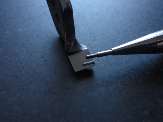

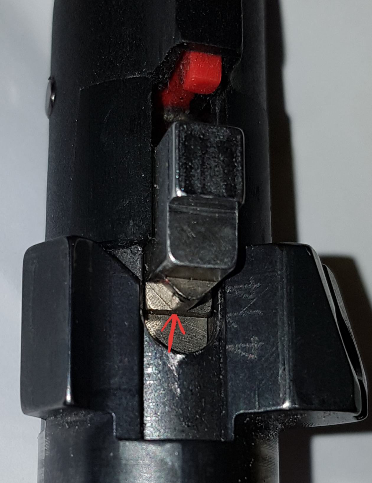

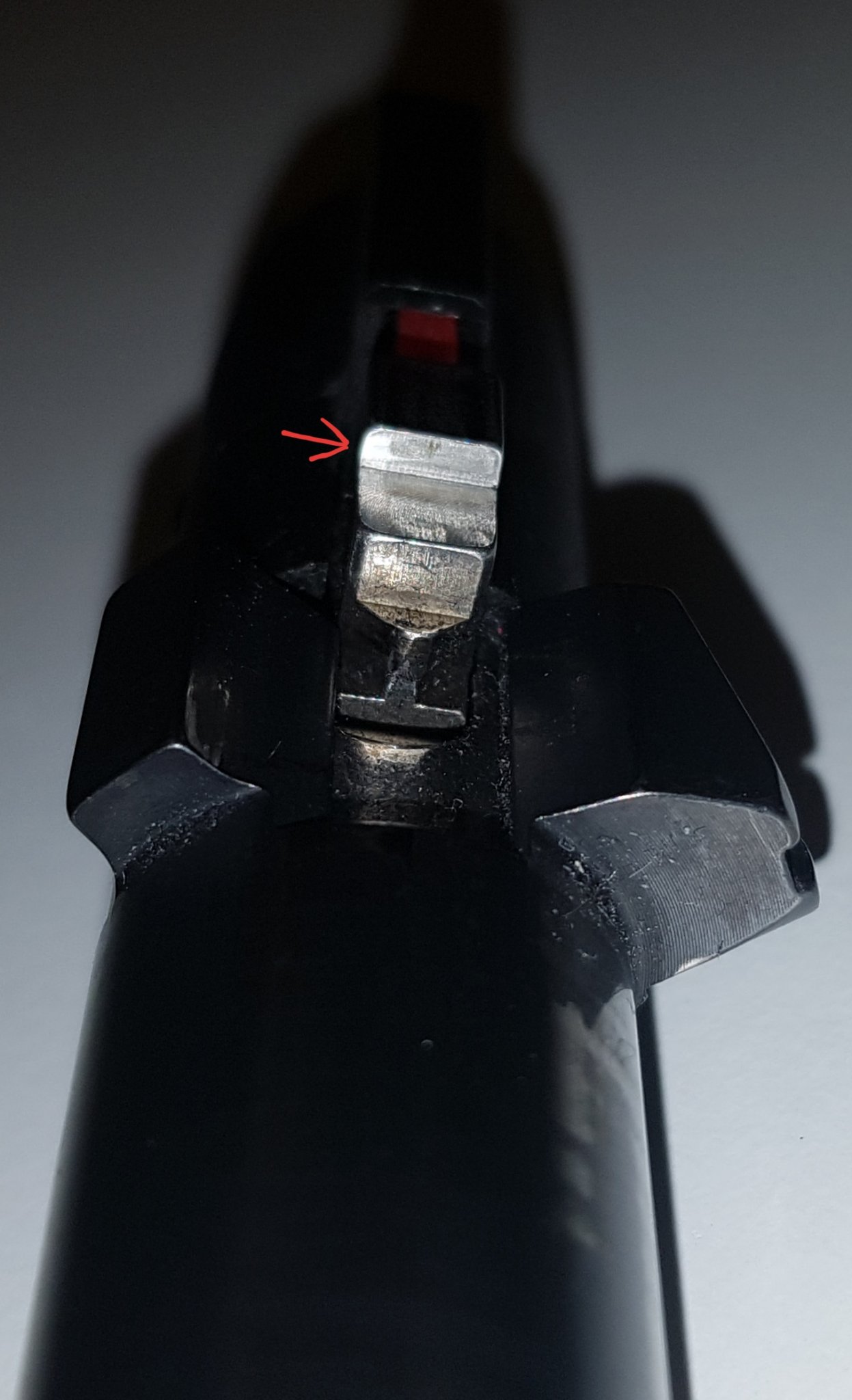

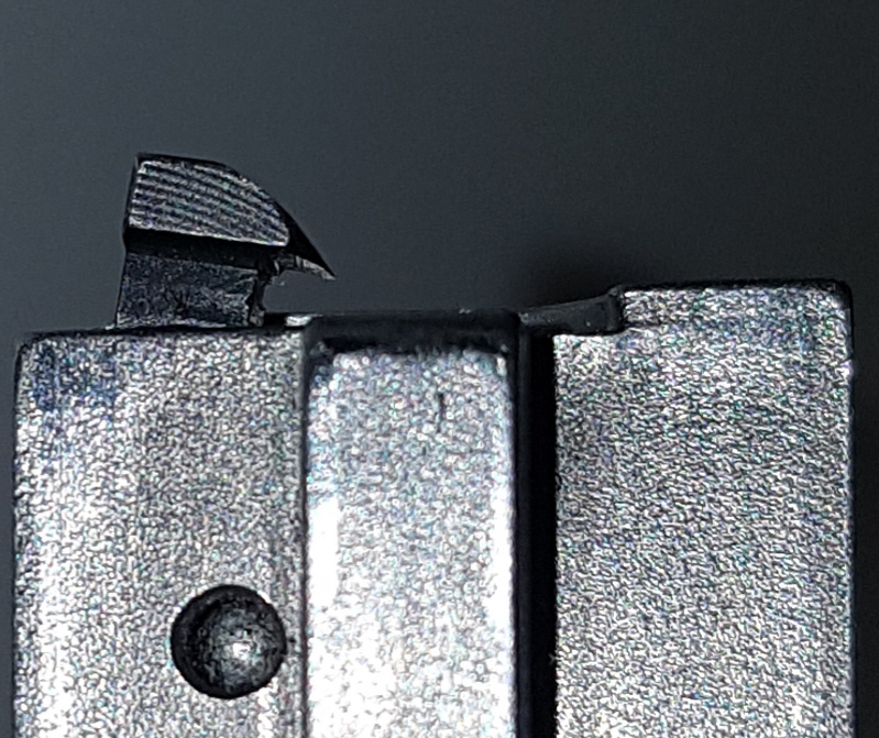

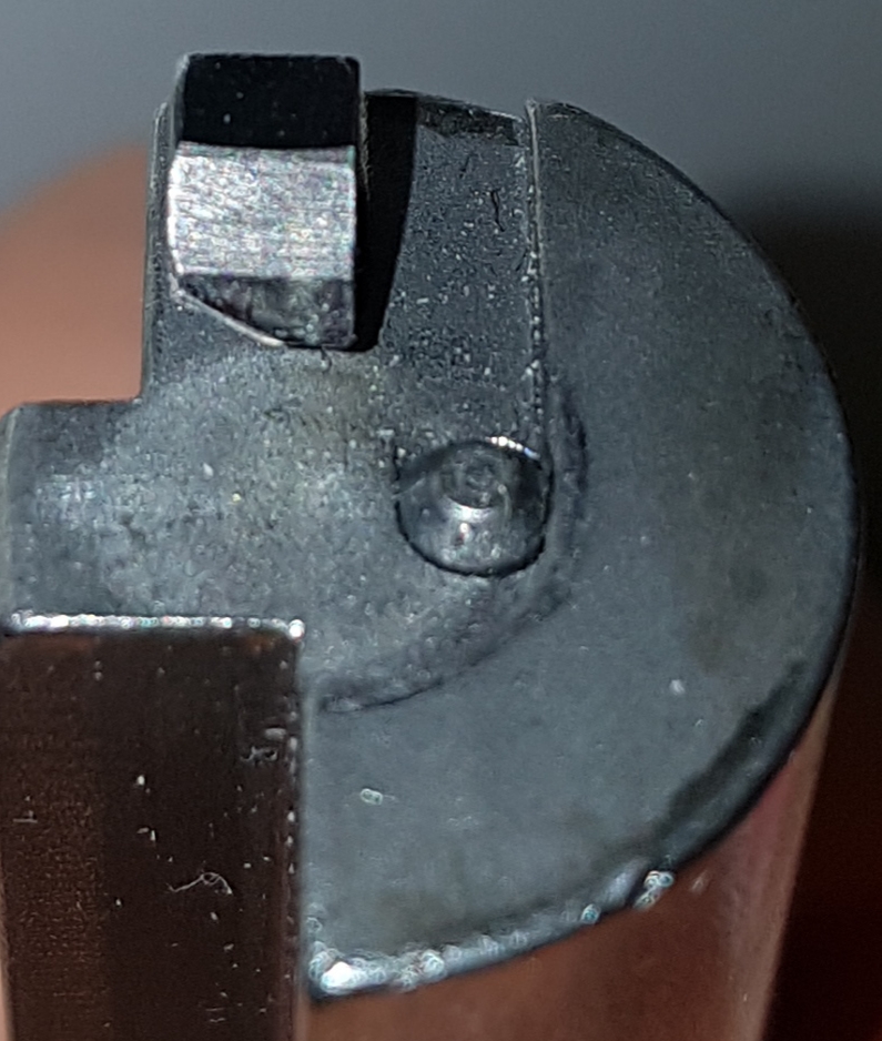

Please think ahead of yourself when removing material from these things.
I recently buffed the area of bolt rise and it became stiff as hell after putting the bolt back together. After applying a needlenose of motor oil in there I can and have operated the bolt with just the index finger. It seems the silky bare metal is not good for dry friction.

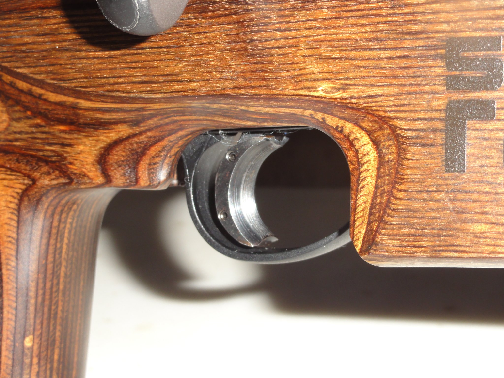

Please see the pictures I posted. The first 2 reduce the force applied to trigger, thus making bolt handle lowering more eased.
Second 2 make the bolt rise / cocking (moving the bolt handle up) more average, eliminating the peaks.
I rather not touch the trigger face, it is probably the bolt rise.

I like it very much. The more I shoot other guns the more I value mine. I wish I had more luck with finding mid grade ammo for it.
Once you have disassembled the bolt and fit the cocker against the bolt handle unit and try to twist it like it was being cocked, you will feel where it requires more force.

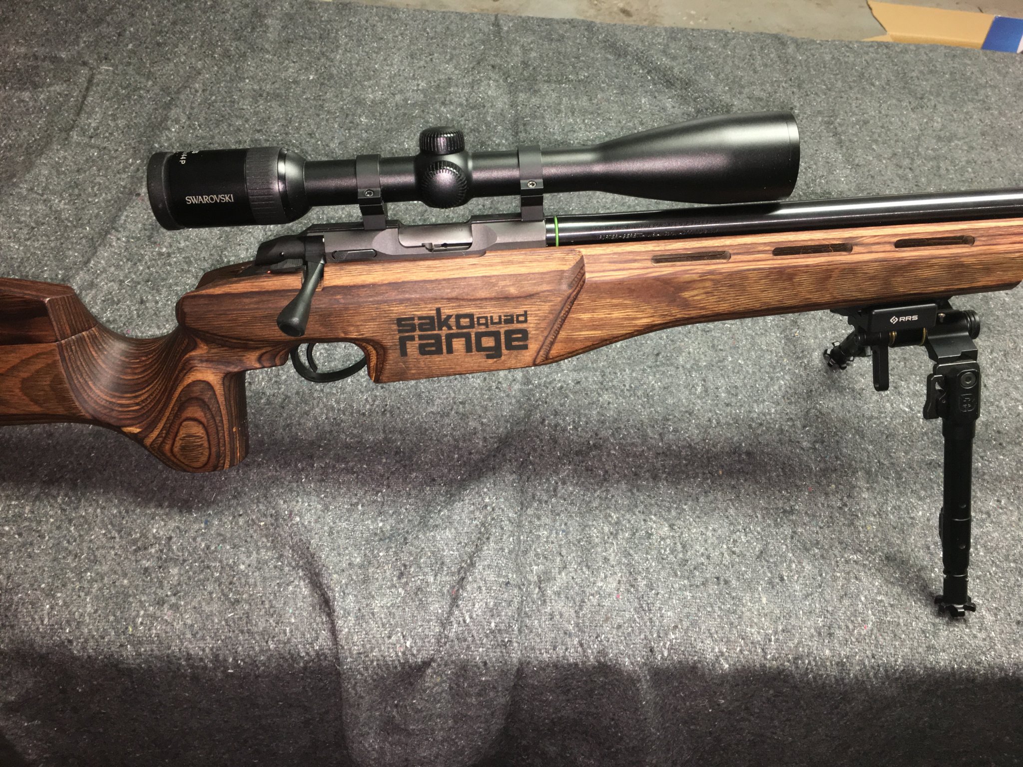

I'm going to have this Sako Quad Range in a couple days. :)

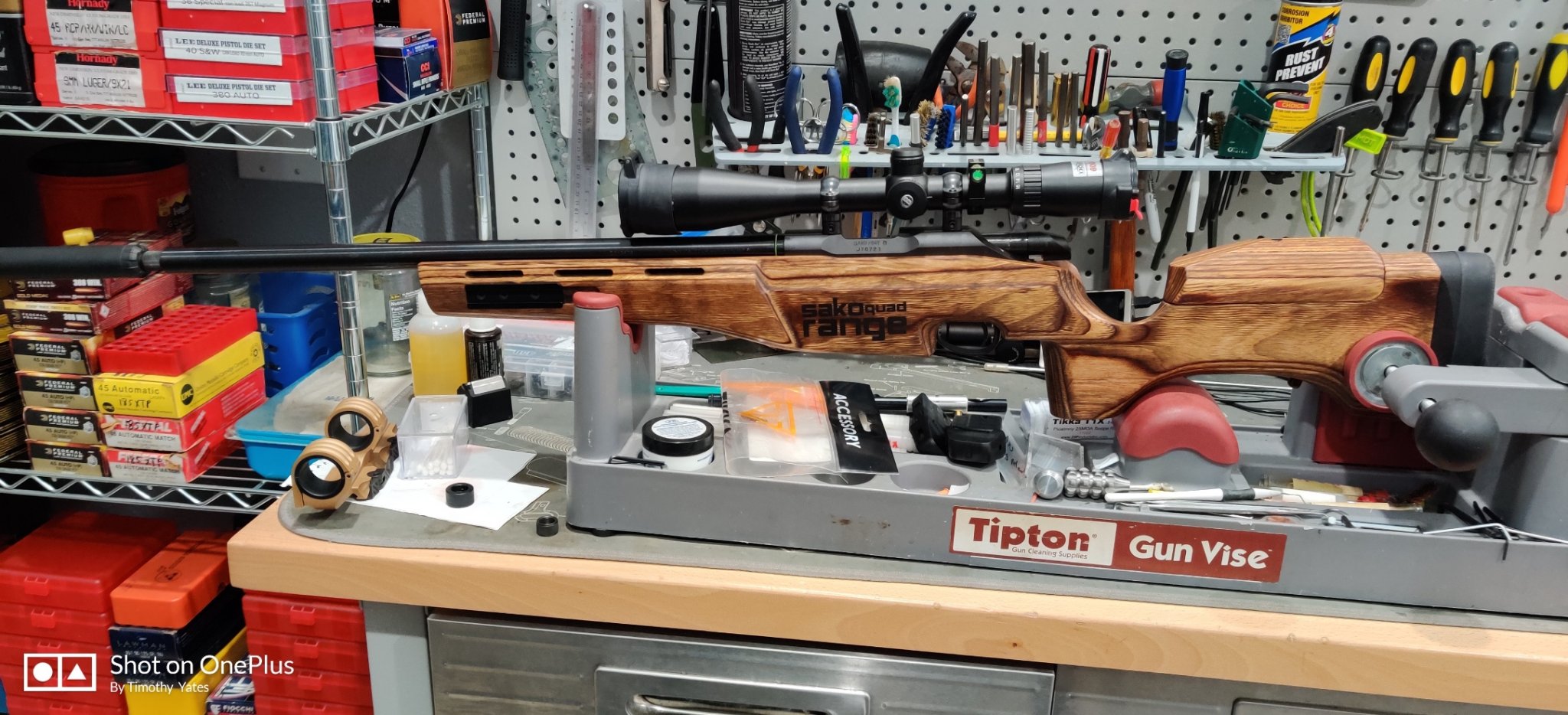

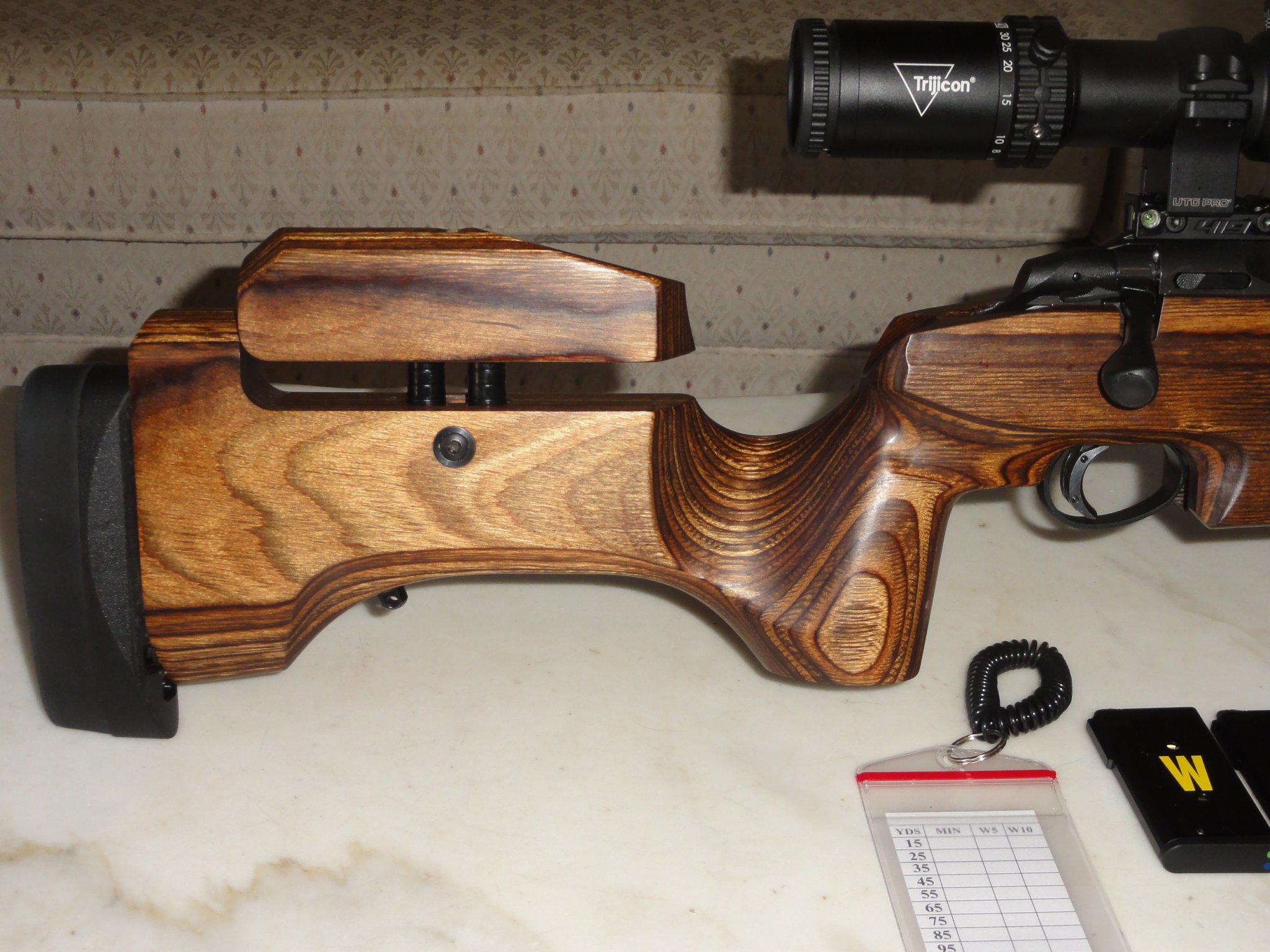

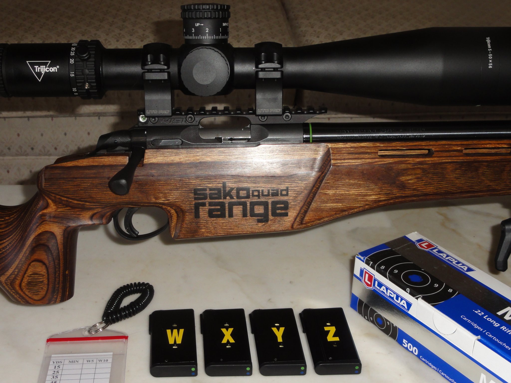

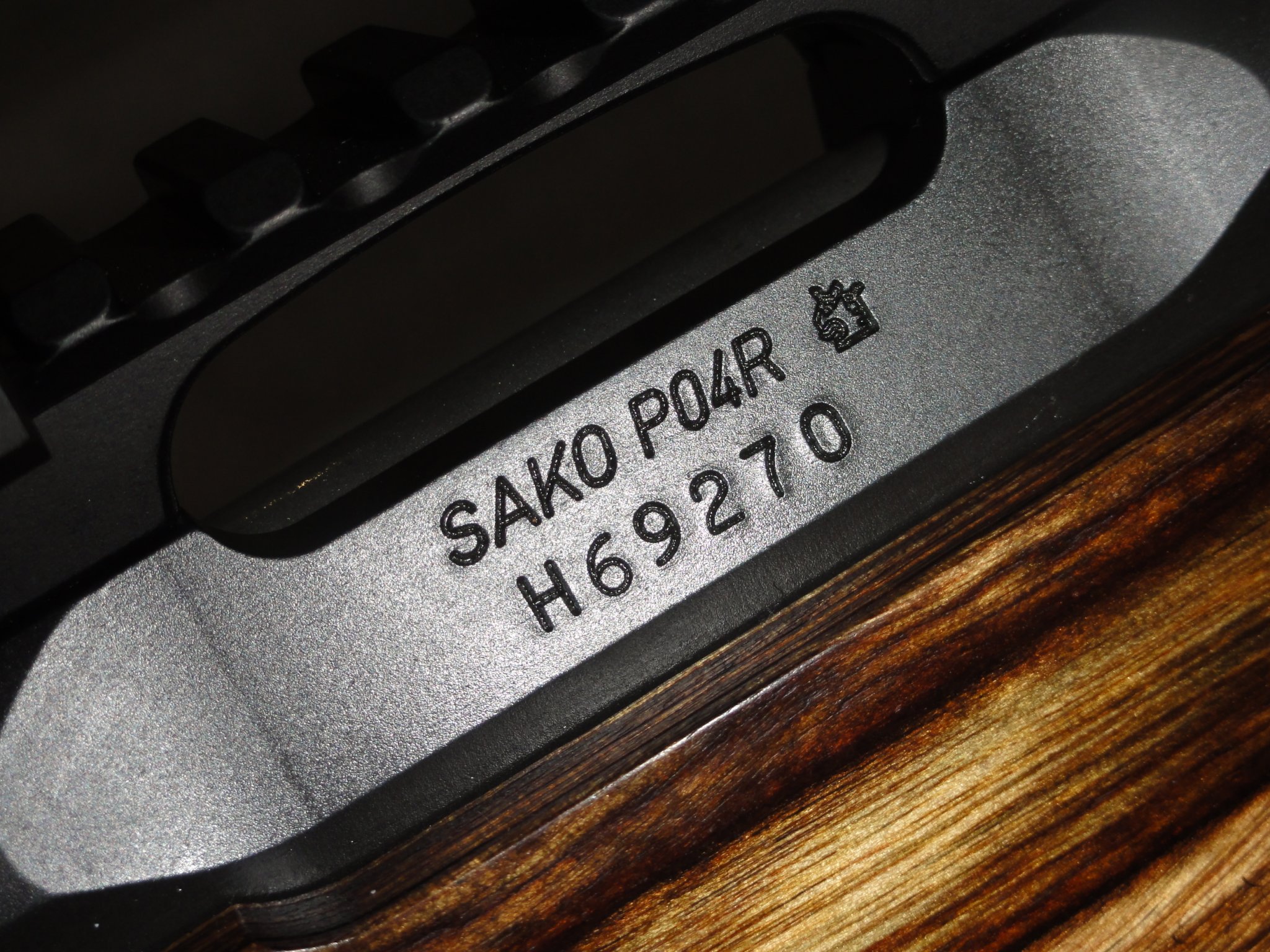

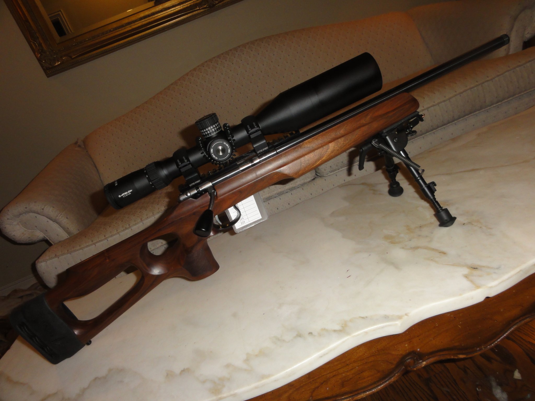

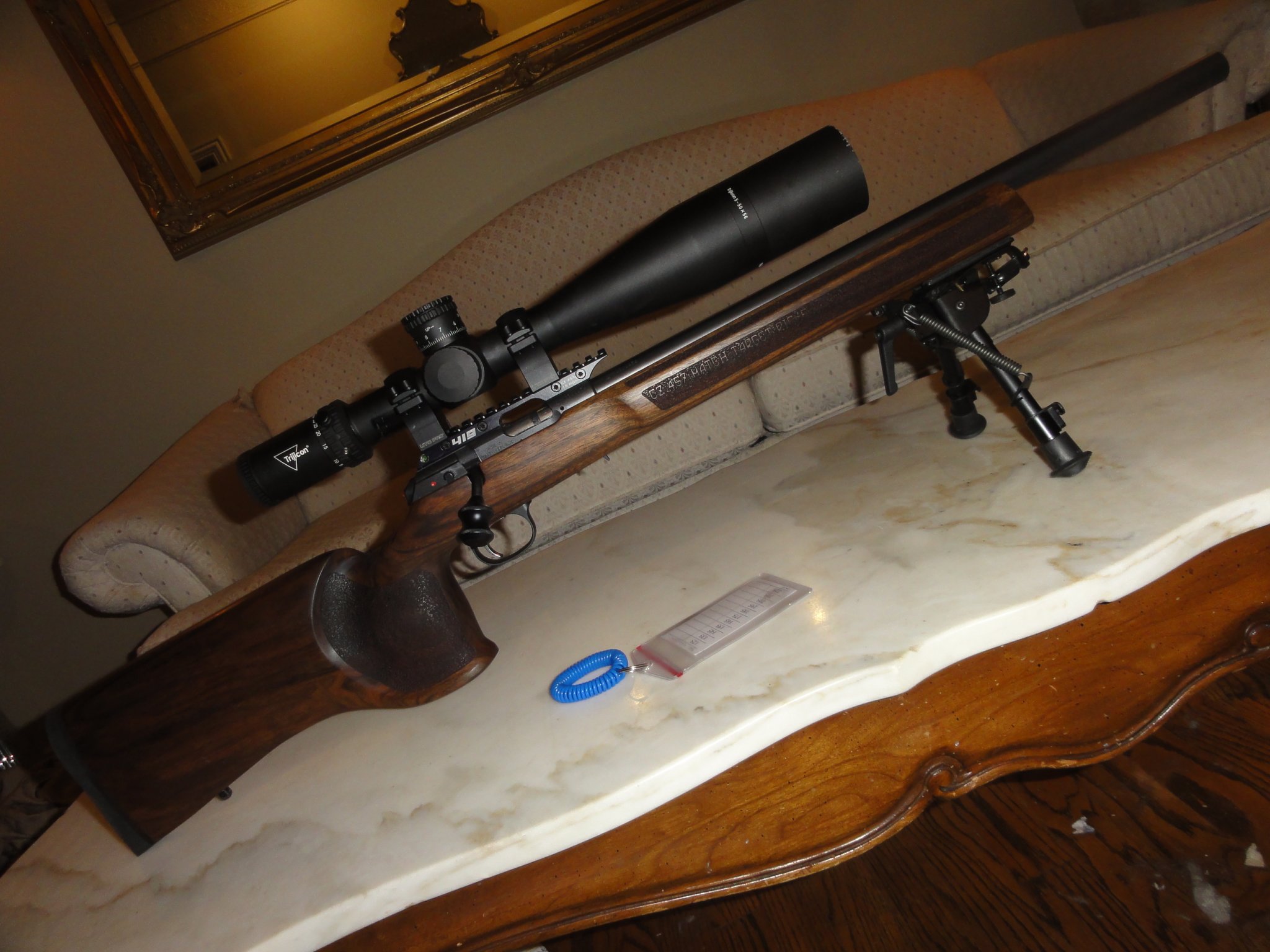

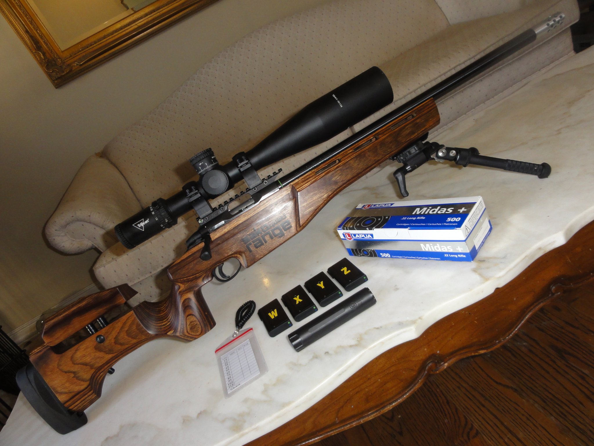

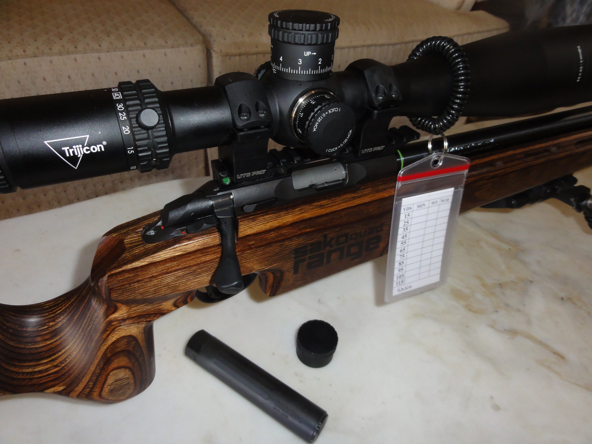

New Sako Quad Range photo's from 2/19/20.
I got my new AREA 419 clamp on rail and mounted a Trijicon 5-50x56 on her. In the process, I just found out a really cool feature of my Atlas bi-pod. It has a tool less
adjustment feature. The ACE trigger shoe is a #13 and feels great. I'm also testing some vinyl letters to identify my magazines. So far they are proving to be resistant to gun solvents and cleaners. I put all of the letters on what will be the left side of the magazine when I insert it. I want it to help me orient the magazine as well as id it.
Does anybody make an extended magazine release for this model?
I'm really happy that I was able to get this gun, she is a real joy to shoot.
Shawn

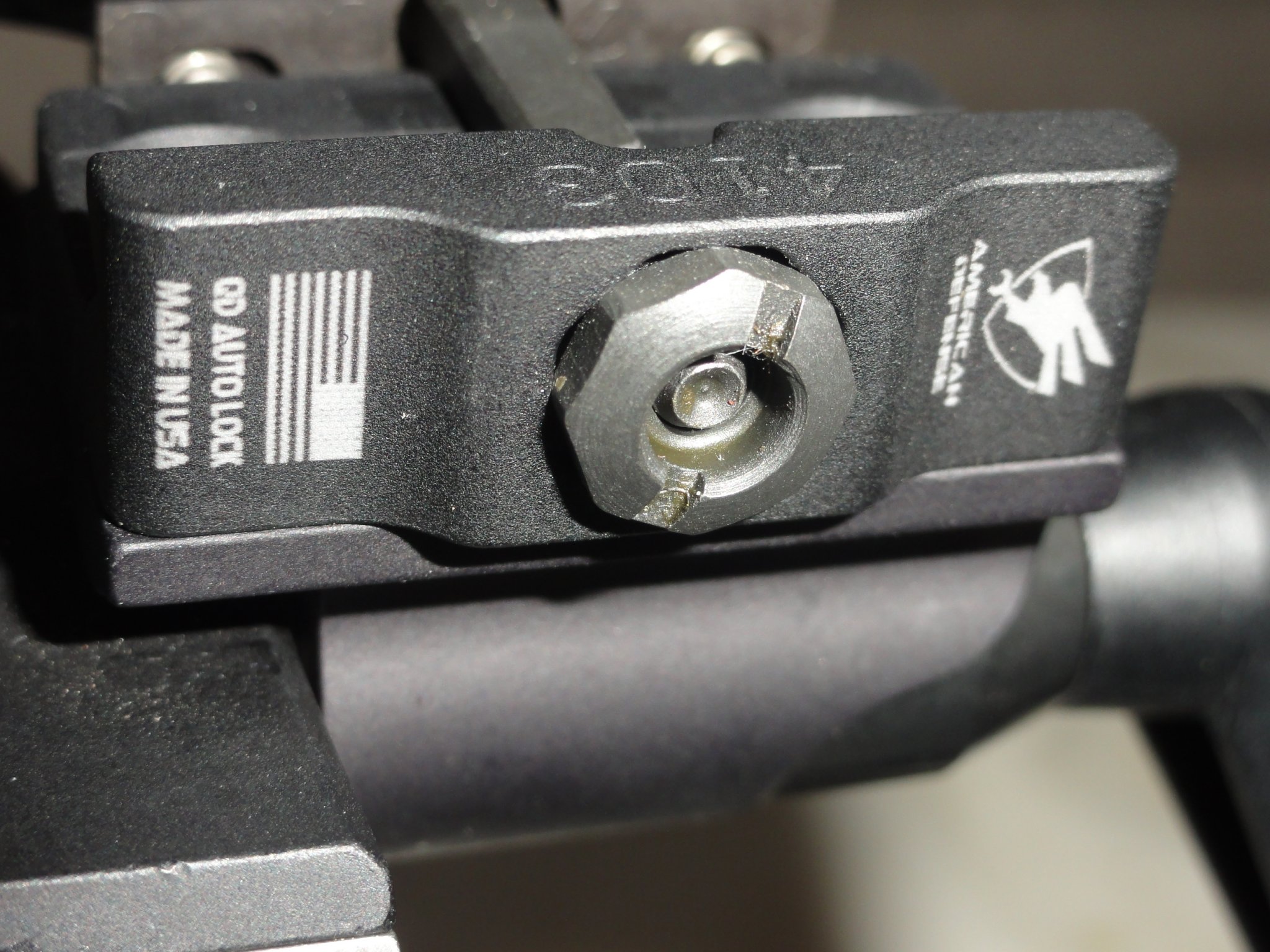

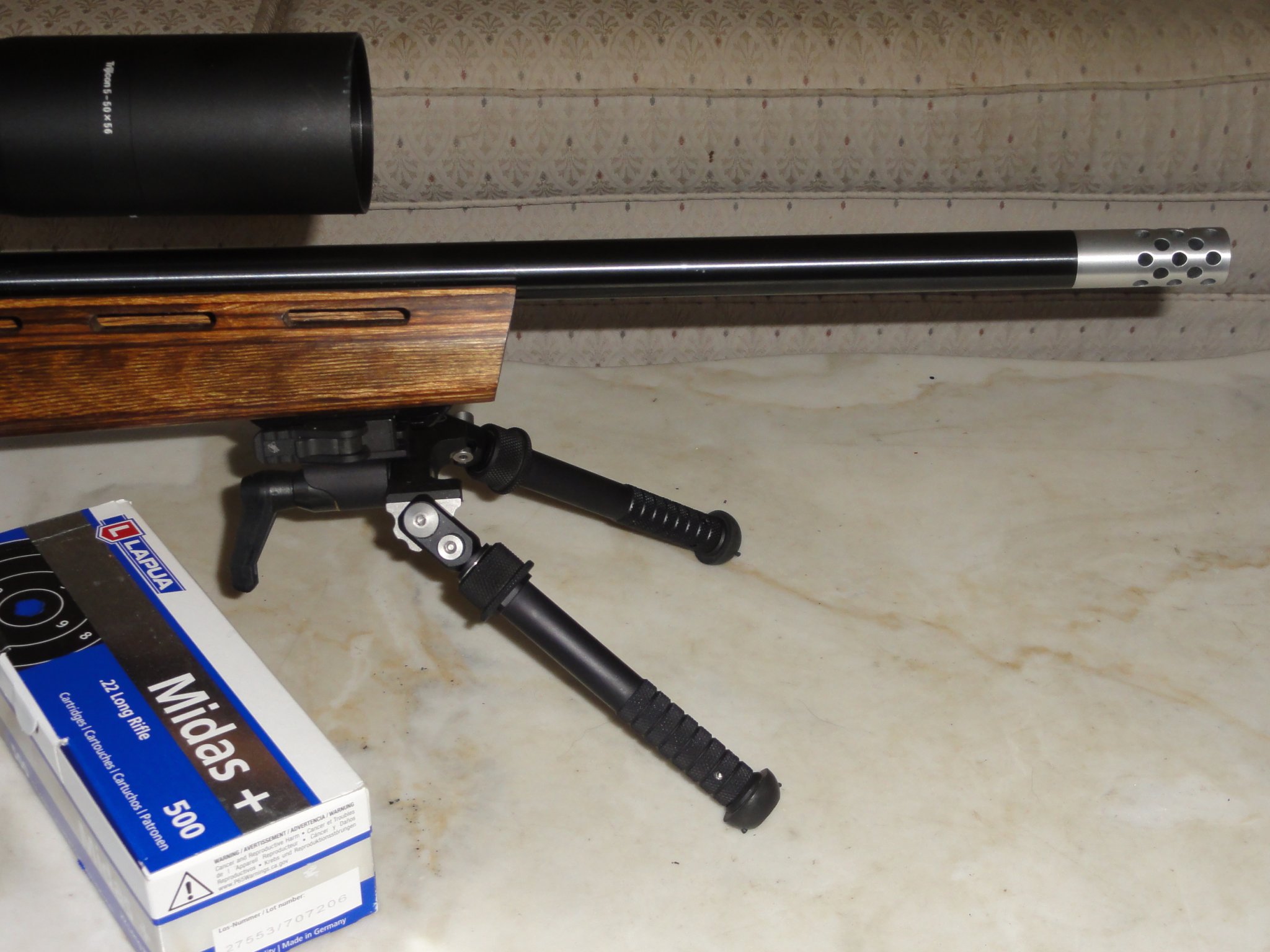

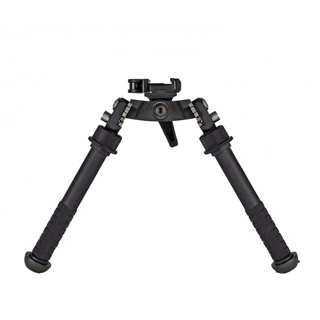

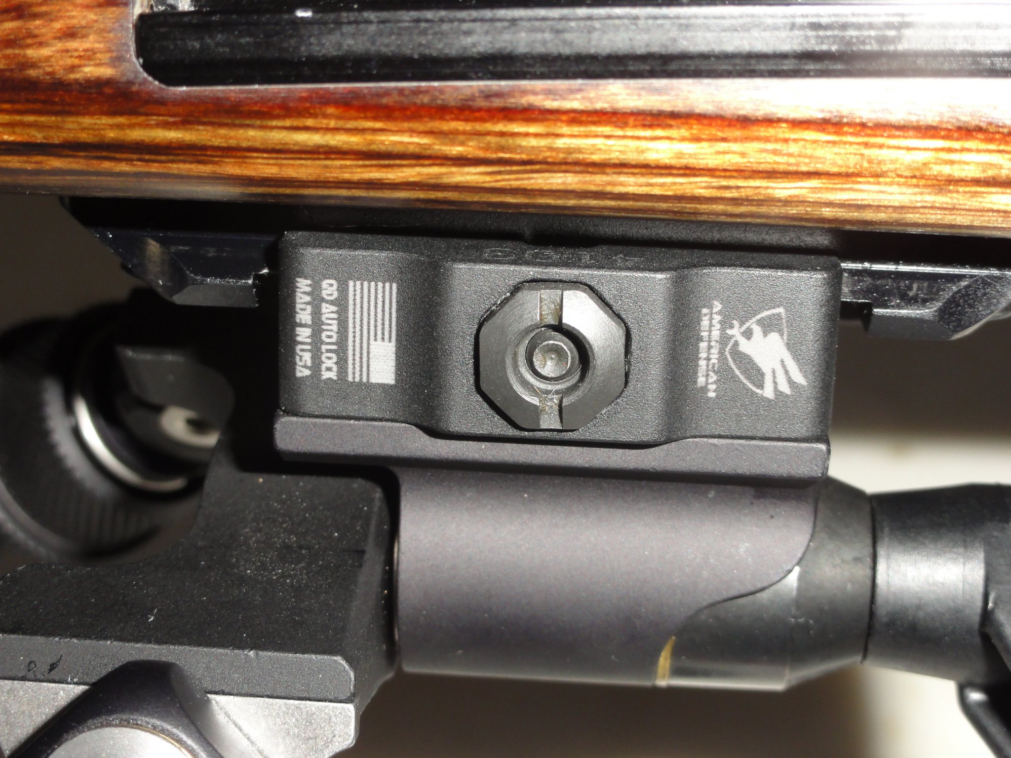

Atlas BT-65 bipod feature noticed while working on my Sako Range.
I needed to adjust the pic rail clamp and went to grab the proper tool for the job. I saw a slot in a OCTAGONAL nut and thought that it was a screw driver slot. It is not !! The octagonal nut sits in a
octagonal recess to prevent the nut from turning. I realized that I needed to turn the nut but the only way to do that is to get the nut out of the recess. All you need do to adjust the "QD AutoLock" feature is
to compress the pic rail clamp with your fingers so that the nut pops out. Then you rotate the nut in
45* increments to tighten or loosen the clamp. It is a really well built unit and I have never had to adjust it before even though I have transferred it to different guns.
Is this worth 300.00 ? ..... It is to me. I'm glad that I spent the extra money for the quick release clamp feature as well. It is shown on the left side of the last photo. I guess that I just like quality stuff.

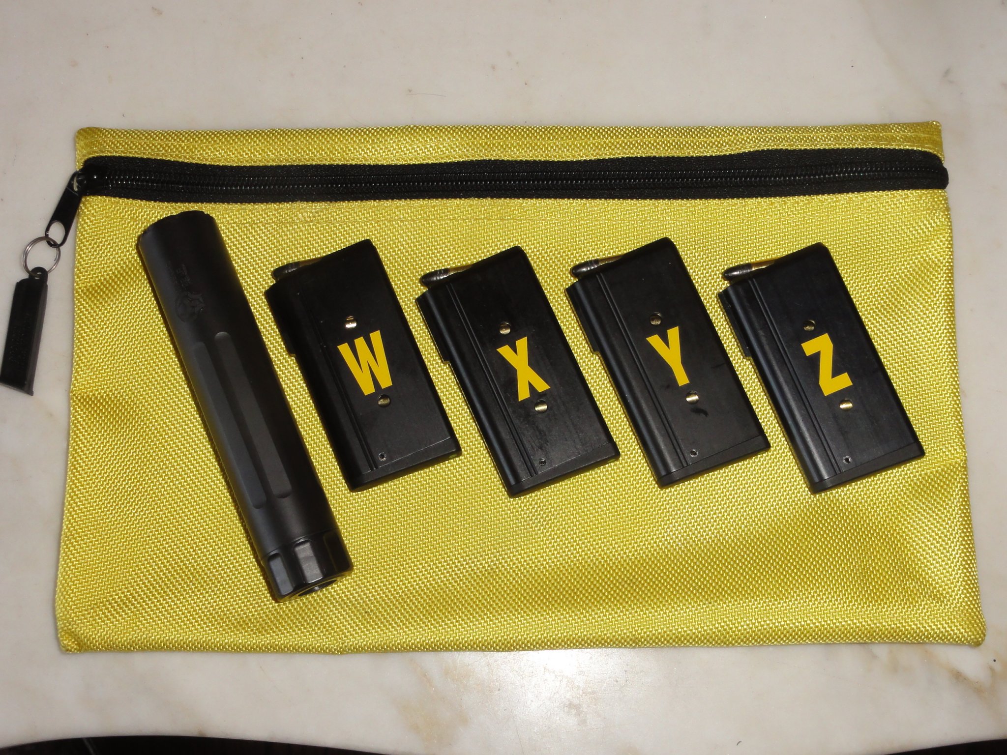

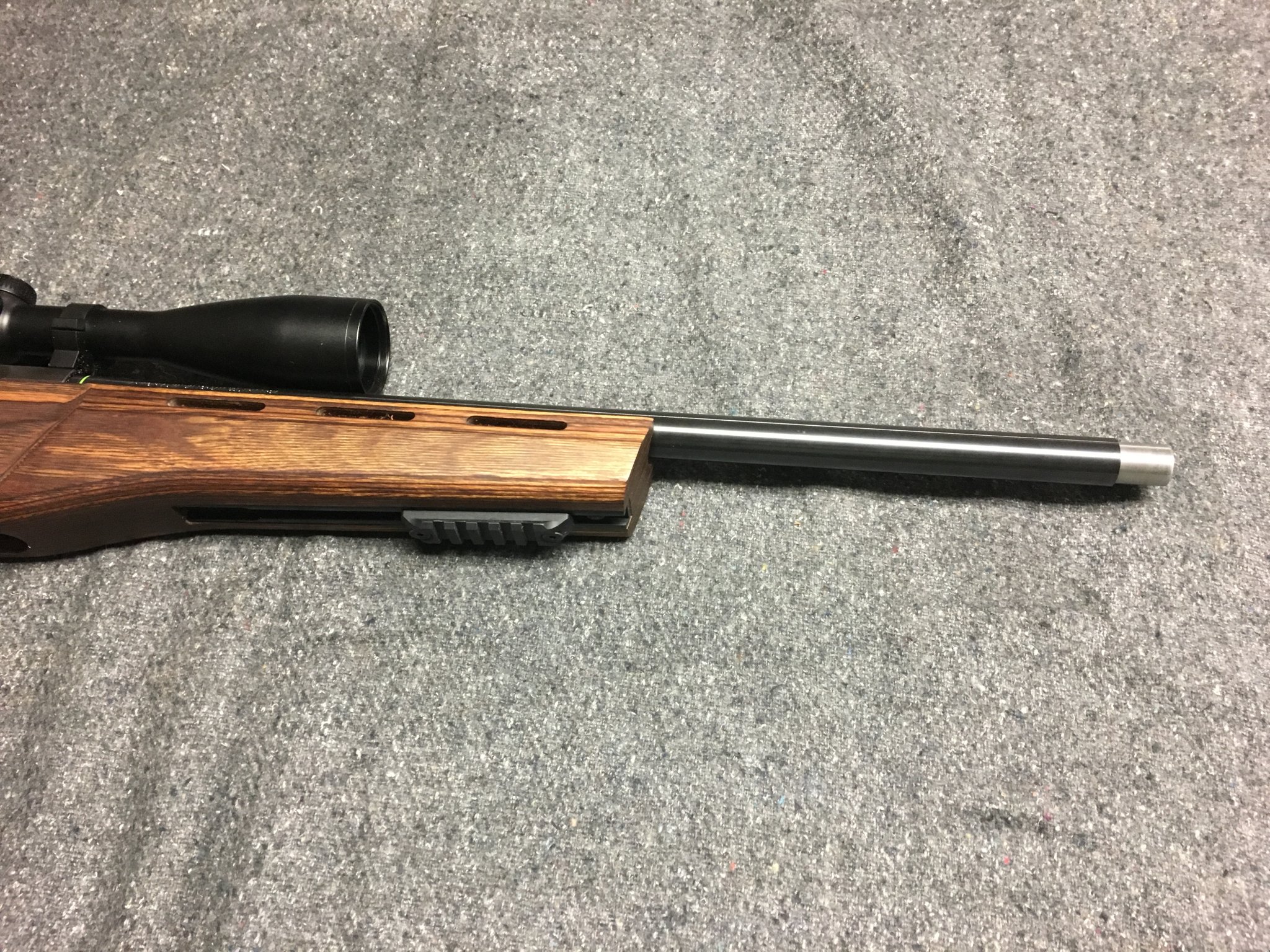

I see you have 4 mags - I think the Quad mags are maybe the best mags I have come across. Super easy to load with very nice form factor and design.
I have almost like controlled feed, the mag spring pushes the cartridge between the bolt and extractor claw and from there the bolt carries it into the chamber. Usually the last round may not be caught and it takes some slight "damage" to the rifling bands. Takes a moment to spot it and I do not think it has any chance to cause problems. Mainly I just want easy feeding.

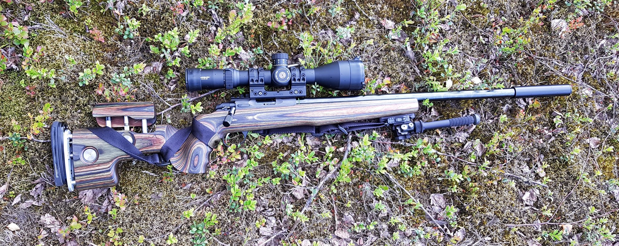

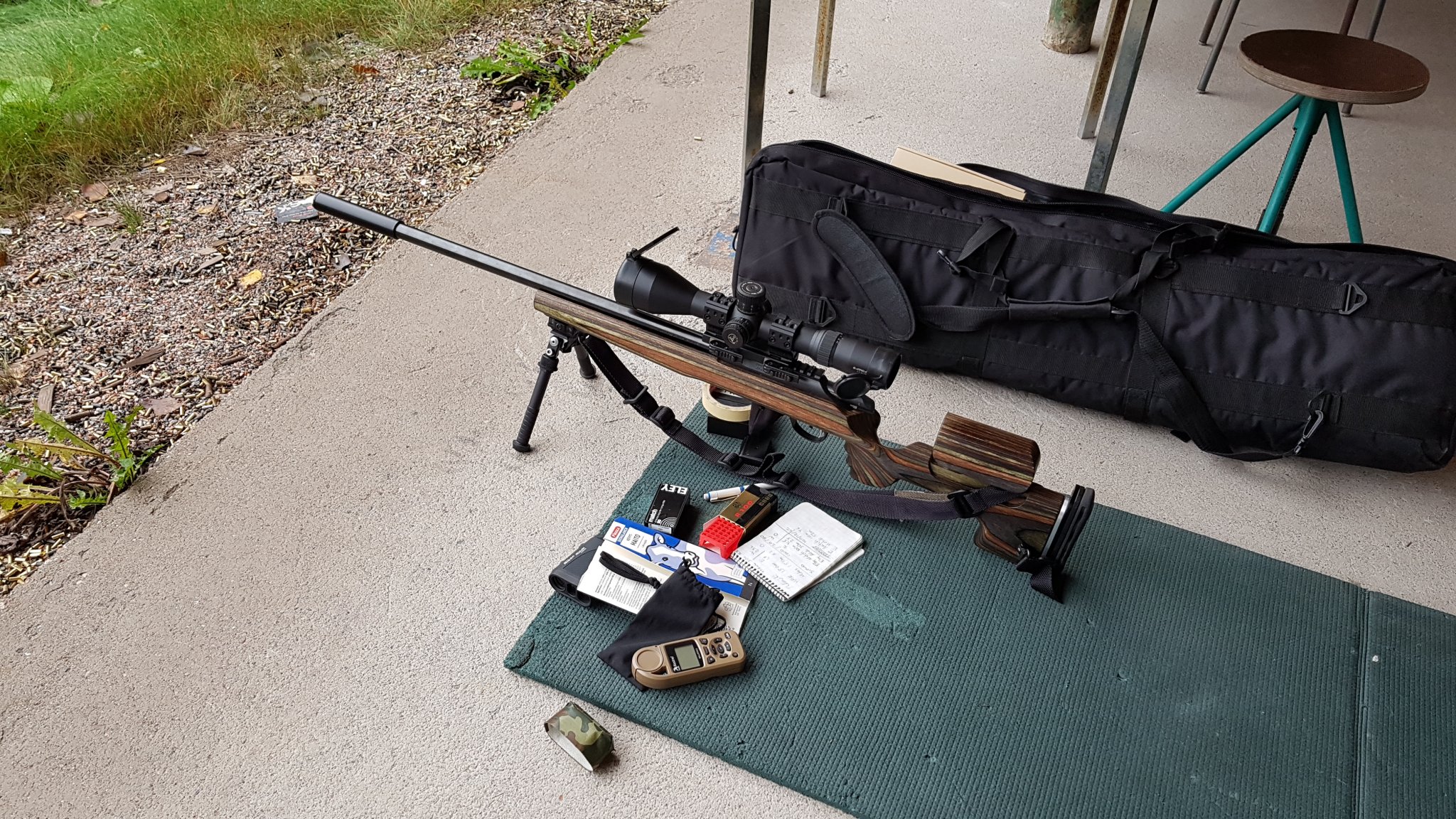

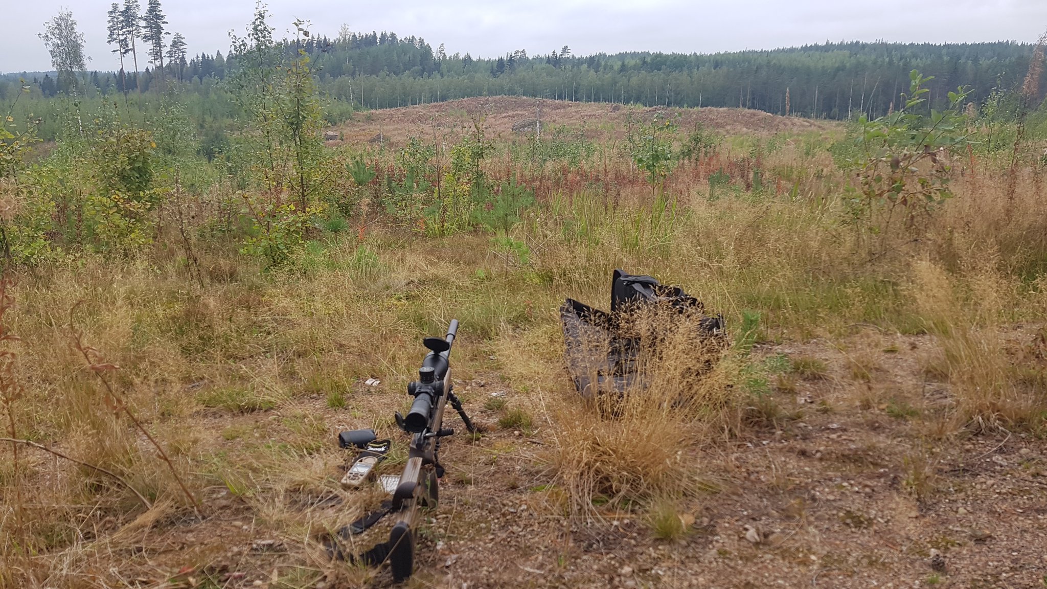

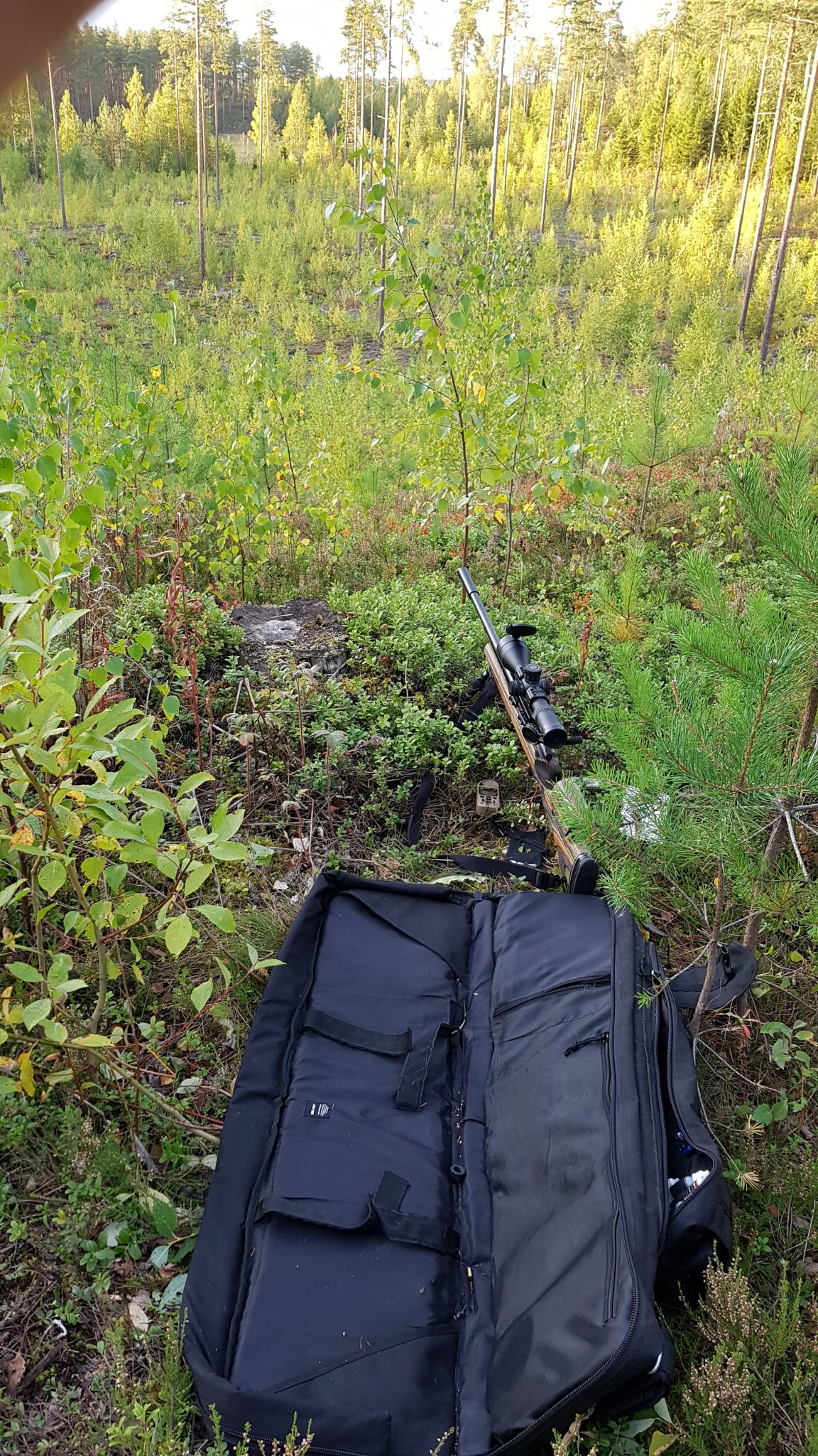

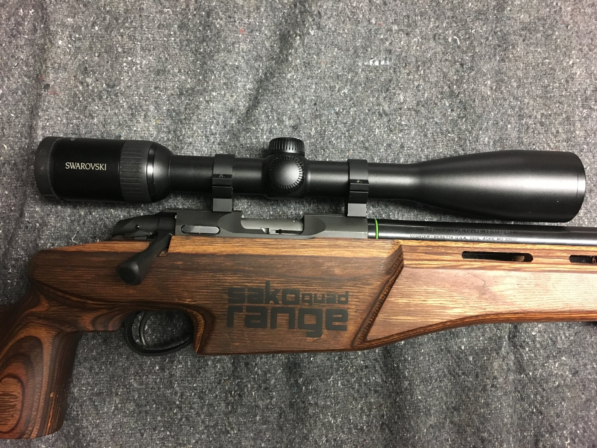

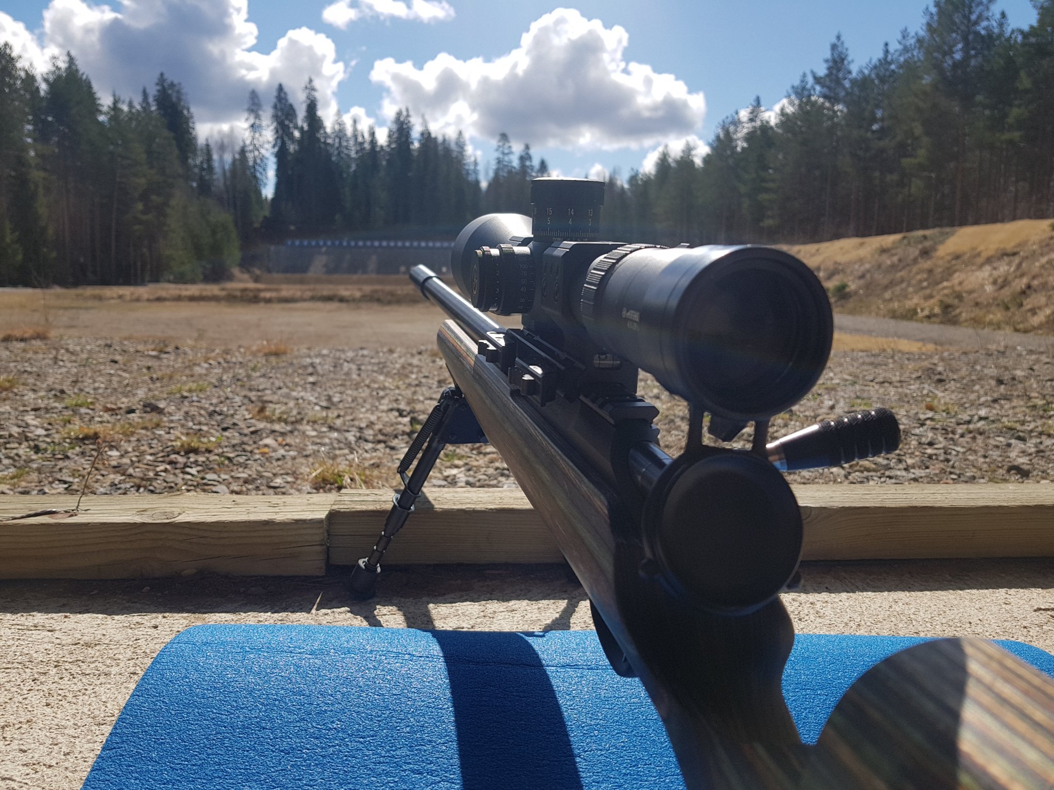

Here are few photos of my Quad - should have added them already, it has seen some nice places!
Near miss,
Nice looking rifle.... Is that the new bbl. you mentioned? It as a really nice high gloss, deep blue finish.
My Quad bbl. has very fine grind marks on the surface so it looks just a little dull. A bit like your silencer.
Your correct, I only have four mags for now. I'm a magazine slut so I'm sure I will end up with at least 8 and maybe ten. I have 19 Vudoo mags, 17 CZ, 16 KRISS, 12 Anschutz, 9 Ruger mkIII, 14 Kimber, a pile of Magpul .223 and some Kimber 82 mags for a gun that I don't even have yet.
I also need to get some for a Walther KKJ that I just put on lay away. It just gets out of hand !!
I cant help myself LoL
Those bags only have my active mags in them along with a little ammo for each. I'm thinking

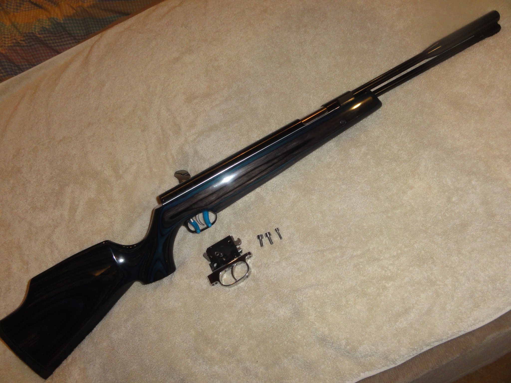

AirGunShawn
Apr 2, 2019
436
130
49
The Walther looks fantastic.
The Walther just needs to be deep cleaned and waxed.
As I live outside US the export fees make the bill quite big. $420 barrel +$350 export license +$20ish postal to make it leave the US.
Then the customs here, 4% custom rate with 24% VAT.
It comes down to $1020.
Then theres the FA licensing fees here so it goes to $1100 for final price.
My Quad barrel is accurate to 50yds and MOA at 110. But not with many brands and lots. With occasional likings to Lapua Biathlon and Midas, it also likes to shoot 20-30 years old Lapua but it is quite scarce. I hope to see better overall and long range performance with Lilja / custom.
Hi NM,
That cost is CRAZY !! It is too bad that you folks in Finnland get so screwed. It seems to me that the bbl cost is high enough. At that cost it seems like someone local could custom make one for you.
I recently got a Sako and I just adore her. In fact I just ordered two more magazines for her tonight.
I could not pass on them at $39.00 each new. Four more next month and I should be set for a while.
Shawn
Shawn

Nice build. I've owned a couple quads and currently have one with a Lilja barrel and Manners stock, US Optics 20moa rail that was drilled and tapped for better mounting that other rails that use the factory rail to attach

South Carolina
Today I joined the Sako Quad family with my Range. Biggest disappointment is it come with the European threads for the suppressor. Lucky for me I have so much crap laying around I had an adapter. Not sure if this was a standard feature but a steel ring set come with min. It has the set trigger which breaks at 10 oz. and has a threaded barrel. I read on the Sako website the Set Trigger and Threaded Barrel are options and not standard items.
AirgunShawn said his come with a picatinny rail that mounts in the rail on the side or bottom of the forearm. Did anyone else get that? I did not get one.
Near miss
Belligerents
Apr 8, 2019
391
155
49
Finland
As mine started out with a plastic stock I do not know. I have thought about installing UIT rail to my GRS but it would require reshaping the stock so probably not happening.
UIT to picatinny adapters cost pretty much compared to dovetail adapters. No china production there, maybe because mostly competition shooters use UIT for easier adjusting of sling attachment point.

South Carolina
I played with my Quad Range trigger today. It is really similar to the T1x but with more adjustments. I only adjusted the screw that is in the same place as the T1x. Turning it out until it hits the mounting bolt reduced my pull from 1 lb 11 oz to 13 oz. This had no effect on the set trigger option, which remains at 10 oz. I tried to make it drop the sear but couldn't which is a good thing. Can't wait to get it on the bench and also install the 17 HM2 barrel. Rain rain.
Near miss
Belligerents
Apr 8, 2019
391
155
49
Finland
You did not even change the spring? I did not have pull meter when I tested mine so I do not know how much it was.
The screw that opens against the bolt that attaches the trigger unit compresses the spring.

South Carolina
Yeah, that's the screw. No, no spring change. I know knocking off almost a full pound is crazy but it is what it is. It will feel really good once I get a shoe on it.
Near miss
Belligerents
Apr 8, 2019
391
155
49
Finland
I have heard of many owners putting a spring from a ballpoint pencil in there.
I never did test it after installing B&A, which was maybe a little overdoing.
