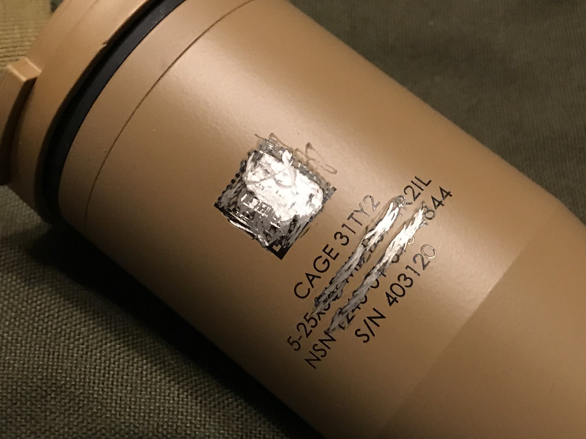

If you are considering removing the badge, be aware that some of these scopes have pristine markings underneath, and some have had the markings defaced at the factory. I removed the badge from mine with fishing line, which worked great by the way. Underneath I found the factory markings had been partially removed, apparently with a Dremel tool, leaving the rough, raw metal exposed. In spite of this, it’s a great scope.

Mine had the military markings too. That’s what they ground off, leaving my scope looking like it has a bad case of road rash. The thing that really pisses me off is that these scopes were listed for around $3800 when I bought it. Some other PM II 5-25’s were discounted to about $2400 at that same time. I guess I not only paid a premium for the Horus reticle, but for the factory “distressed” finish, and limited edition brass bandaid as well. Even so, it’s an awesome optic. I couldn’t bring myself to send it back for a refund, but I wouldn’t pay full price for another one without knowing that the finish was intact.

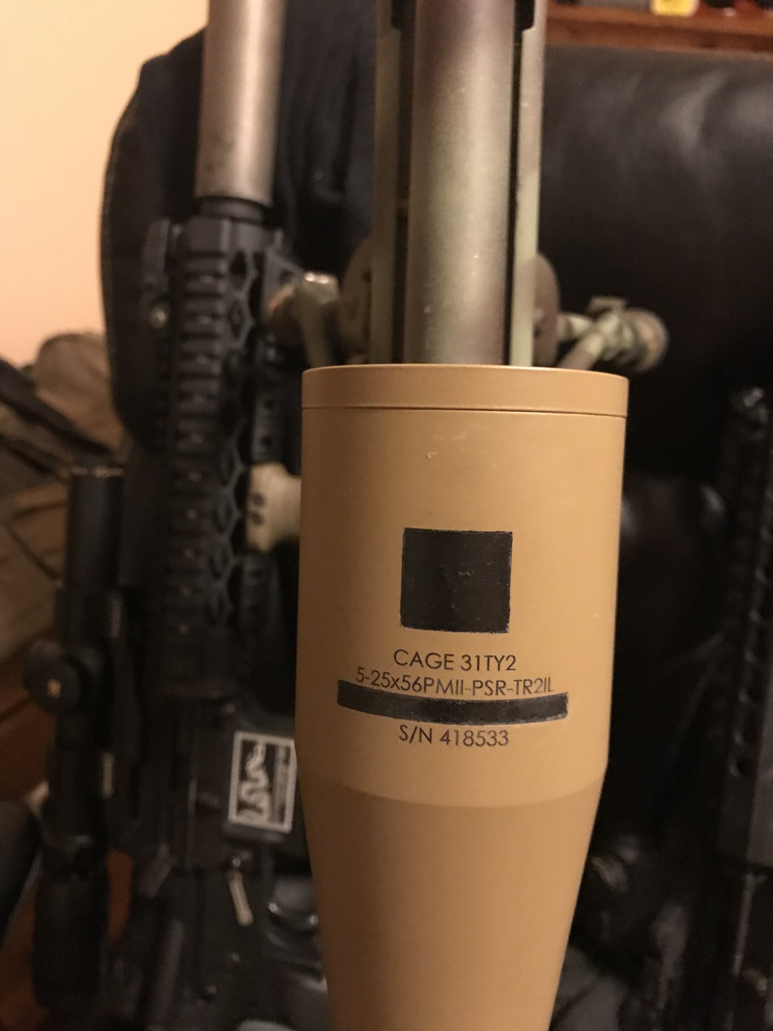

#20
They don't deface all of them. At least the one that's blacked out looks neat and uniform. Here's what they did to mine.

#23
Euro Optic has them listed for $2999. The Limited Edition doesn't have the MTC on the elevation turret. It does have the MTC only at the zero mark on the windage turret.
