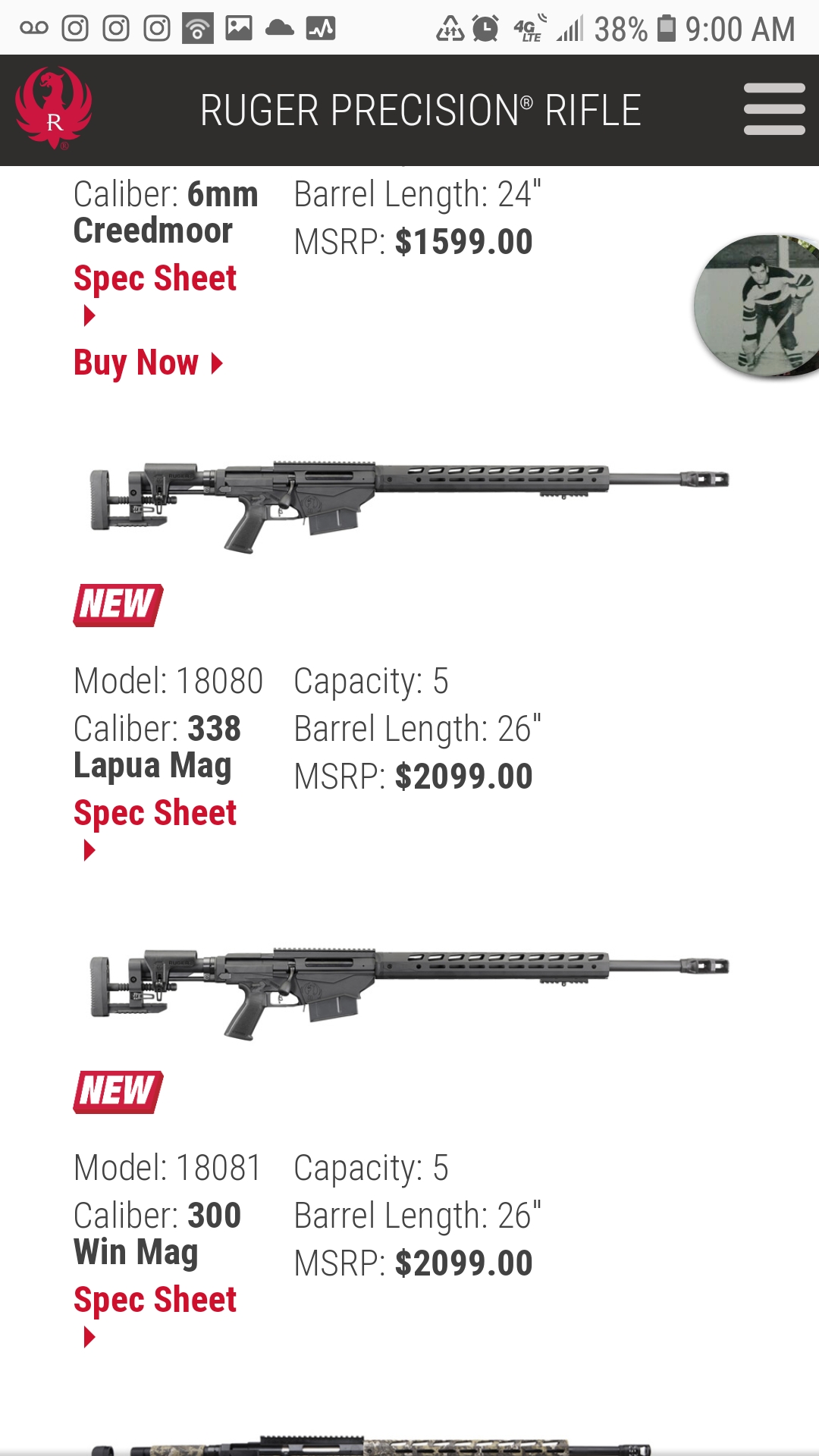

Looks like ruger just announced its RPR in 338LM and 300WM, I have the original RPR and am happy with how itperformed. Every time I talk my self into a 338 I end up going back to the thought that I would be better off just building a custom then pushing it down the road another 5 years.
If this model is as good as the SA models would it be worth getting into?

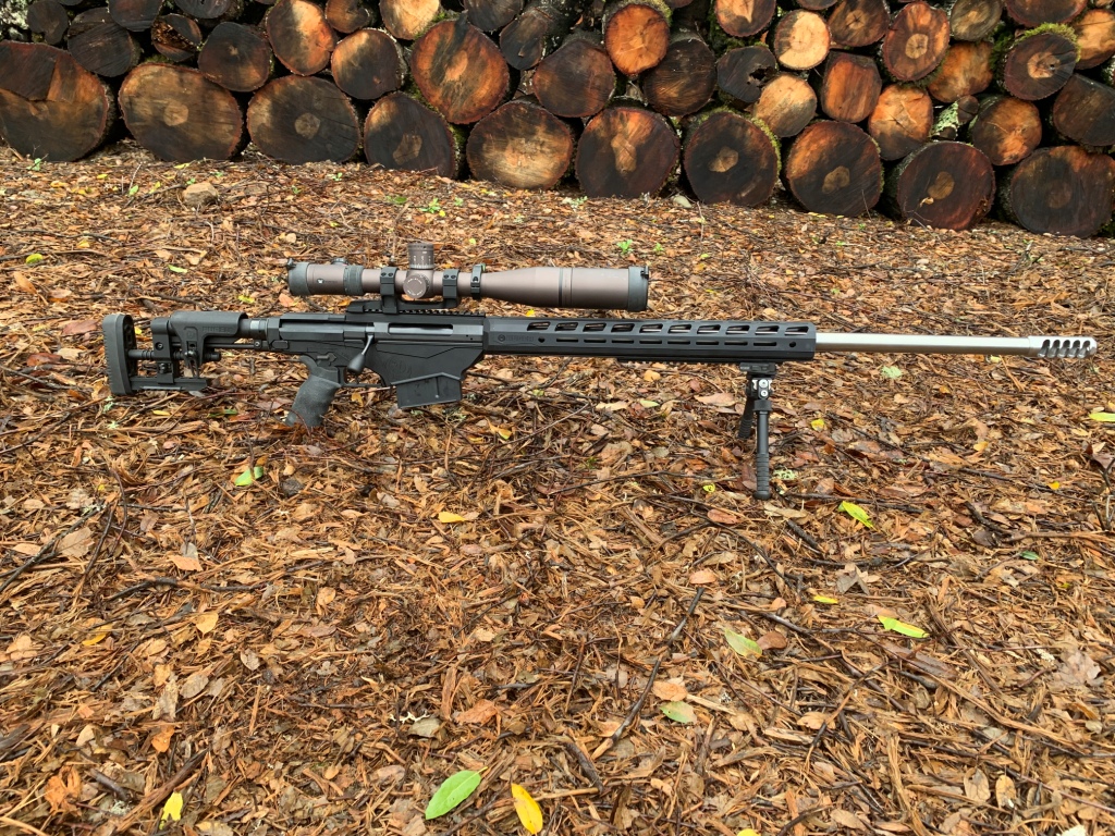

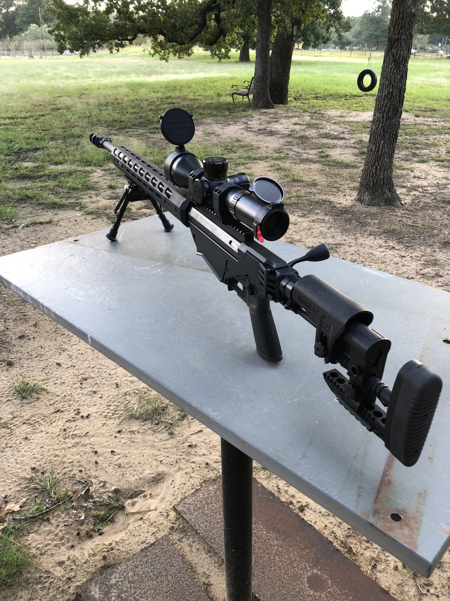

I traded a gen I 243 and $788.00 for one on Sunday. I only had 6 rounds of factory Hornady ammo on hand and got it zero’d and Shot a 3 round group. They went into about .75 just before dark last night. I ordered Lapua Brass and 300 grain Berger OTM today from Bruno’s. I’ll try and get back here for a report ASAP. Going to use H1000 and CCI 250s. I’m really impressed so far.

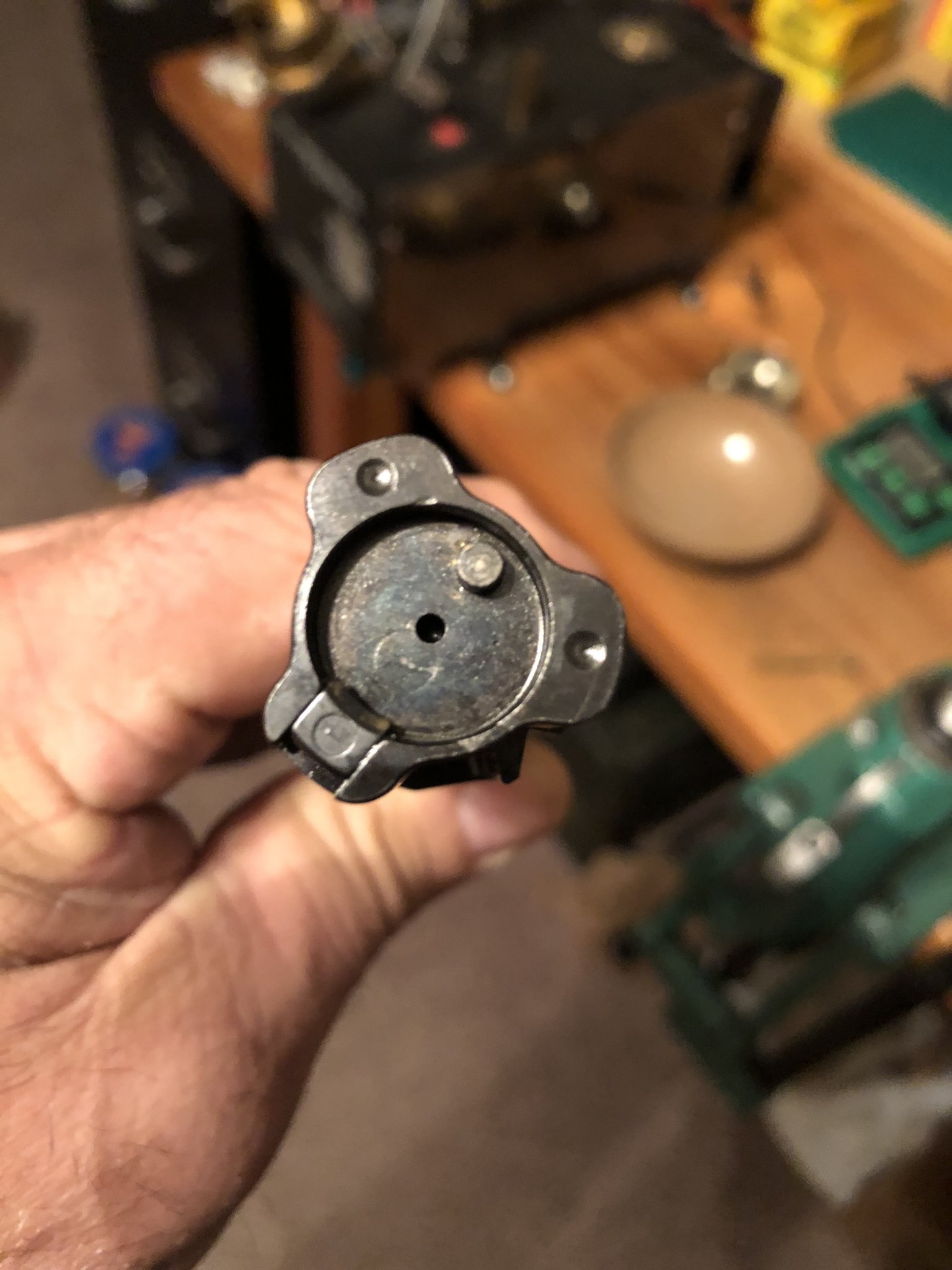

Any comments on the build of the action? Maybe a picture of the bolt face? And I assume the chamber is cut properly and there's no need to polish.
Thanks for the post excited to hear more.
I’ll get a photo of the bolt face this evening. Everything looks good so far but with the limited rounds through it so far, I can’t comment on much.

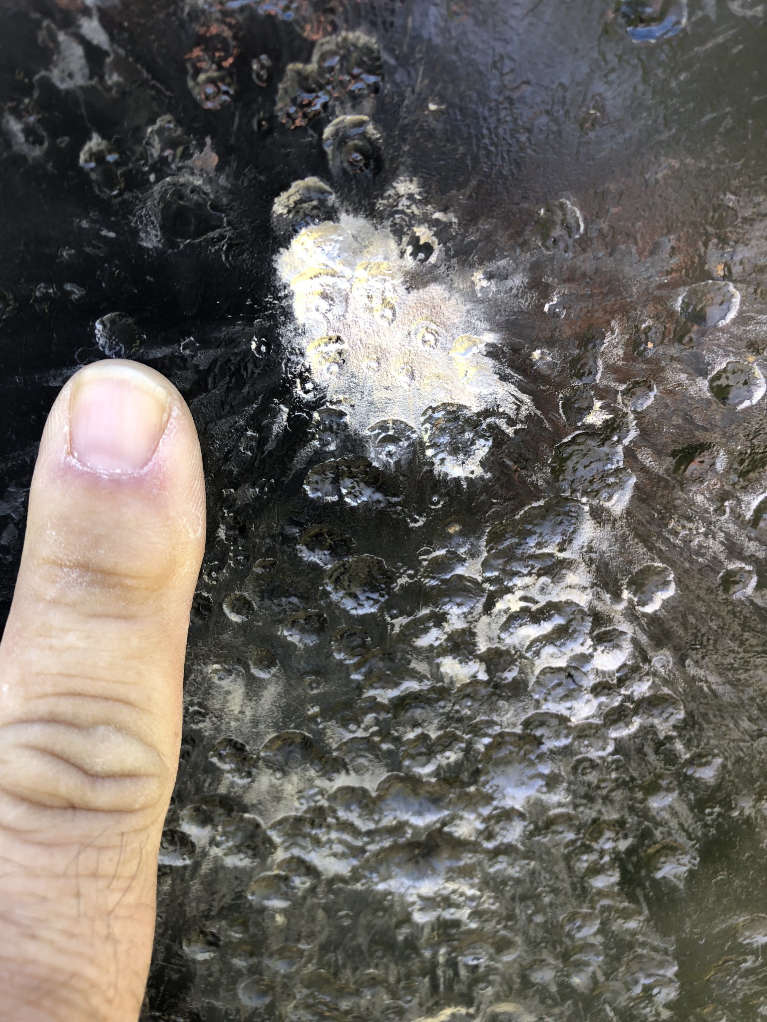

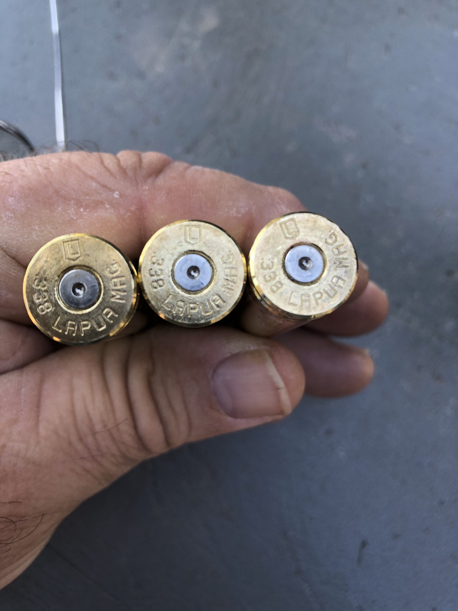

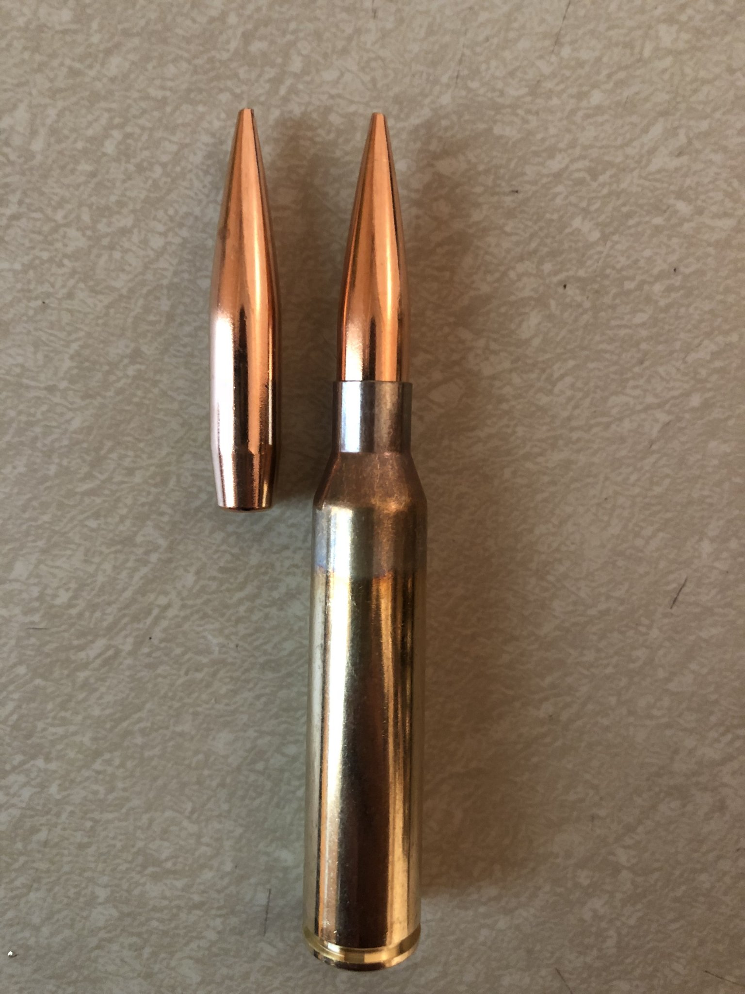

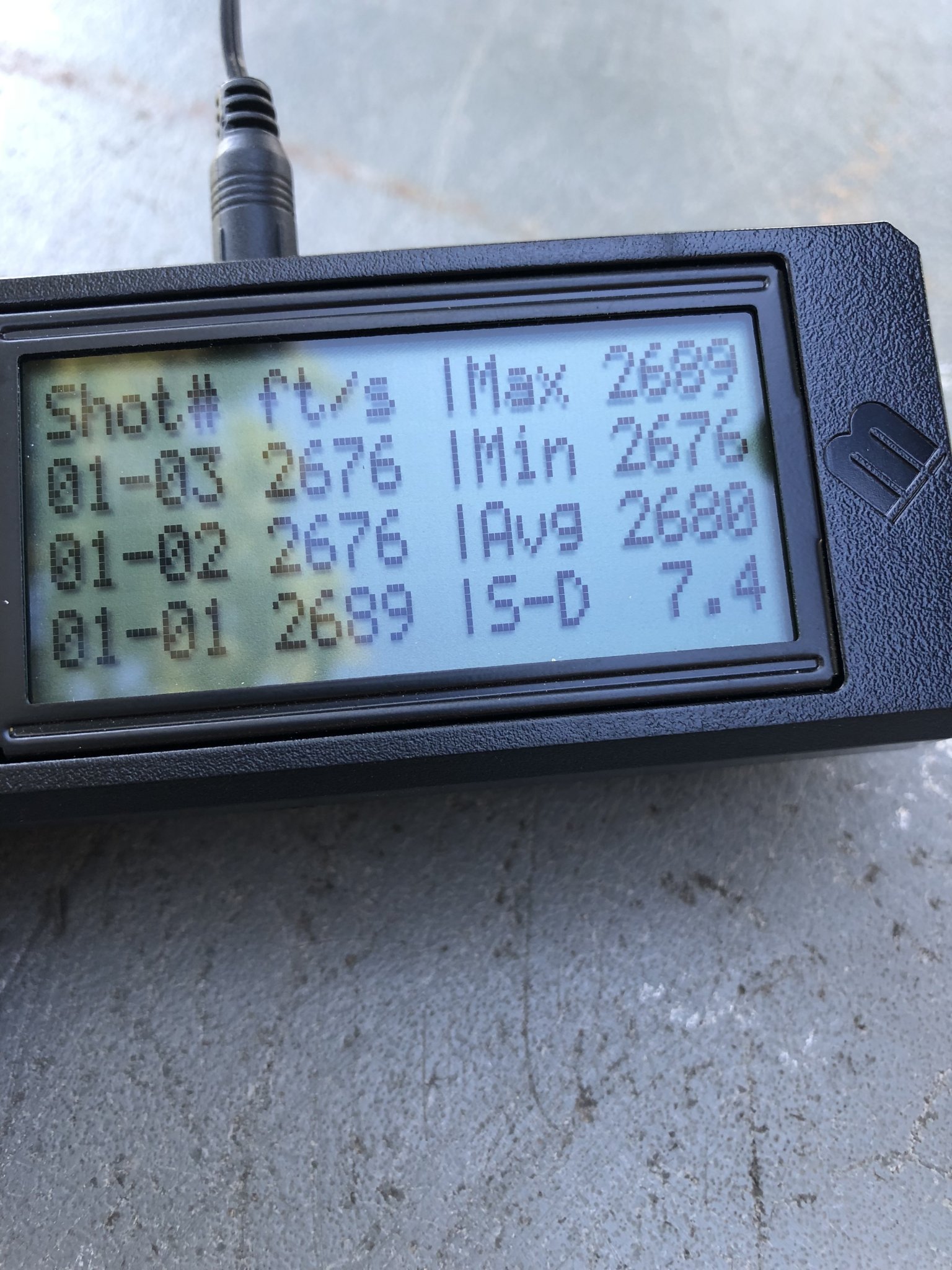

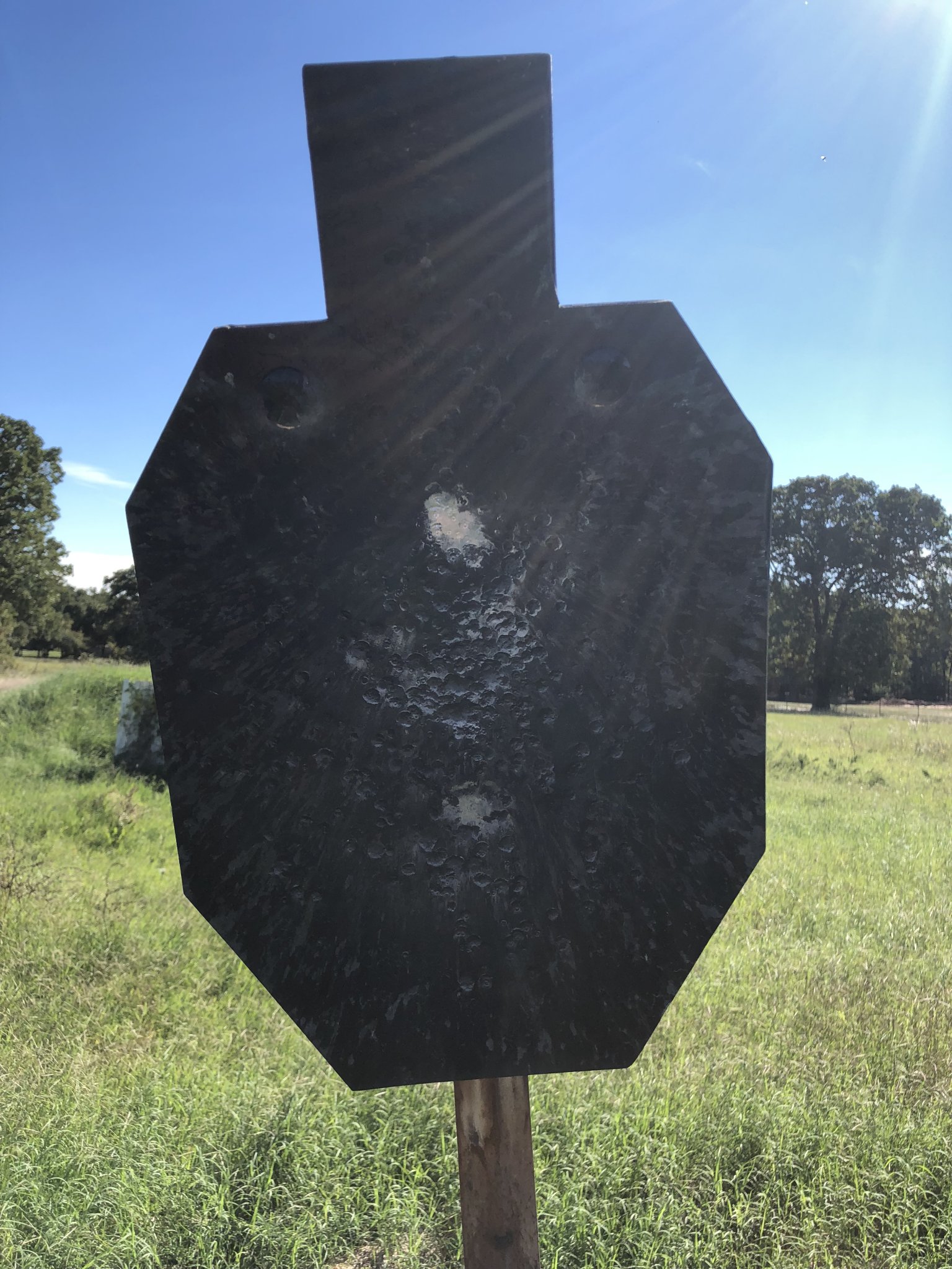

Well, at this point I have 12 whole rounds down the barrel. 5 factory Hornady to zero, 3 hand loaded 300 Sierra....then the fun stuff, I loaded one 300 Berger OTM .010 off the lands at 91.5 grains of H1000 in new Lapua Brass just to check for pressure. That’s the lower impact on the target. Then 3 at 92 at the same seating depth. It’s well past magazine length at 3.893
I held 1.5 mills and sent 3 through the chrono!
I’ll load a few up to fit the magazine and see how they do.

Post 28 has a few pictures and chrono results with 92 grains of H1000 and 300 grain Berger Hybrid. I haven’t taken it past 100 yet but can tell you it’s a shooter. Go for it. For the money, you can’t be disappointed.
