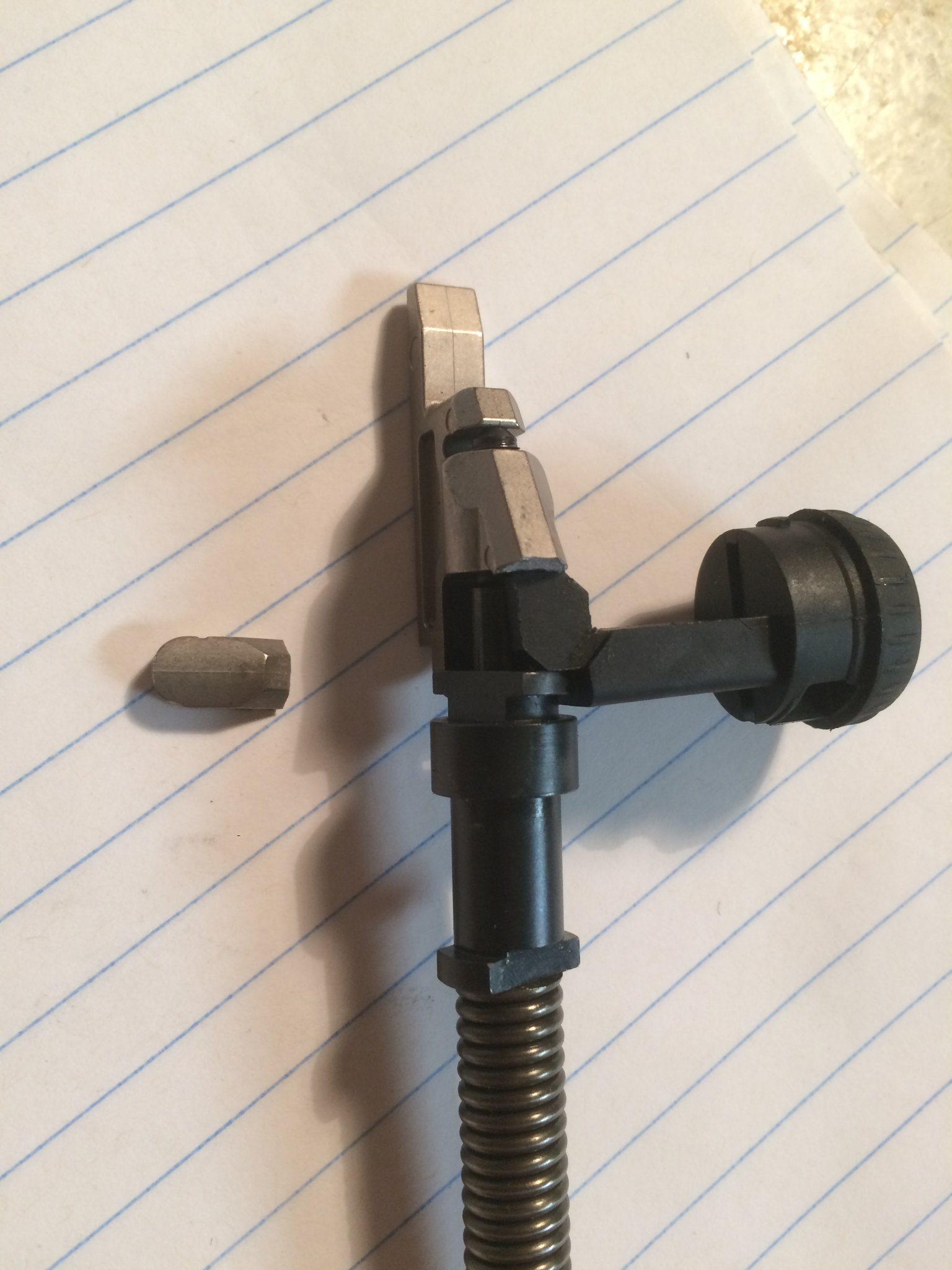

I dropped my bolt and dented the lug that contains the extractor. I polished out to where it functions, but now its not 100% on extraction. Anyone know where i can get a new bolt? Preferably a small firing pin.
Thanks
Thanks
Call Ruger to see whether they can take care of it.

I called ruger. They will replace the bolt, but i need to send in the rifle with the original barrel. They are sending a new extractor, spring, and ball. Hopefully that fixes it.
I had to polish out the raceway and the extractor rib to get it to not stick open. I fear i took too much, as now if i dont cycle the bolt moderatly fast, it drops the round on the mag below.

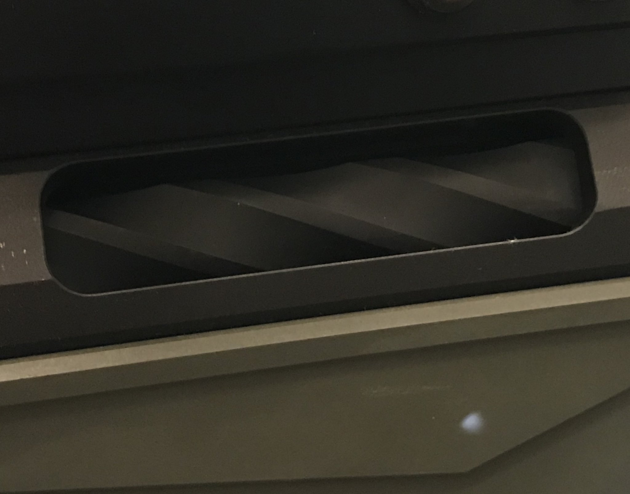

So pretty new to the forum. I just got a gen3 rpr in 6.5 and looking to upgrade the bolt shroud. I really like the Anarchy Outdoors titanium shroud but wish it came in black to match the new nitride coated bolt on the gen3. Just wondering if I could get some feedback from you guys to see if there’s other options I’m missing. I know you can get the AO in black aluminum and same with LRI but like the idea of the heavier titanium shroud with tool. Thanks!

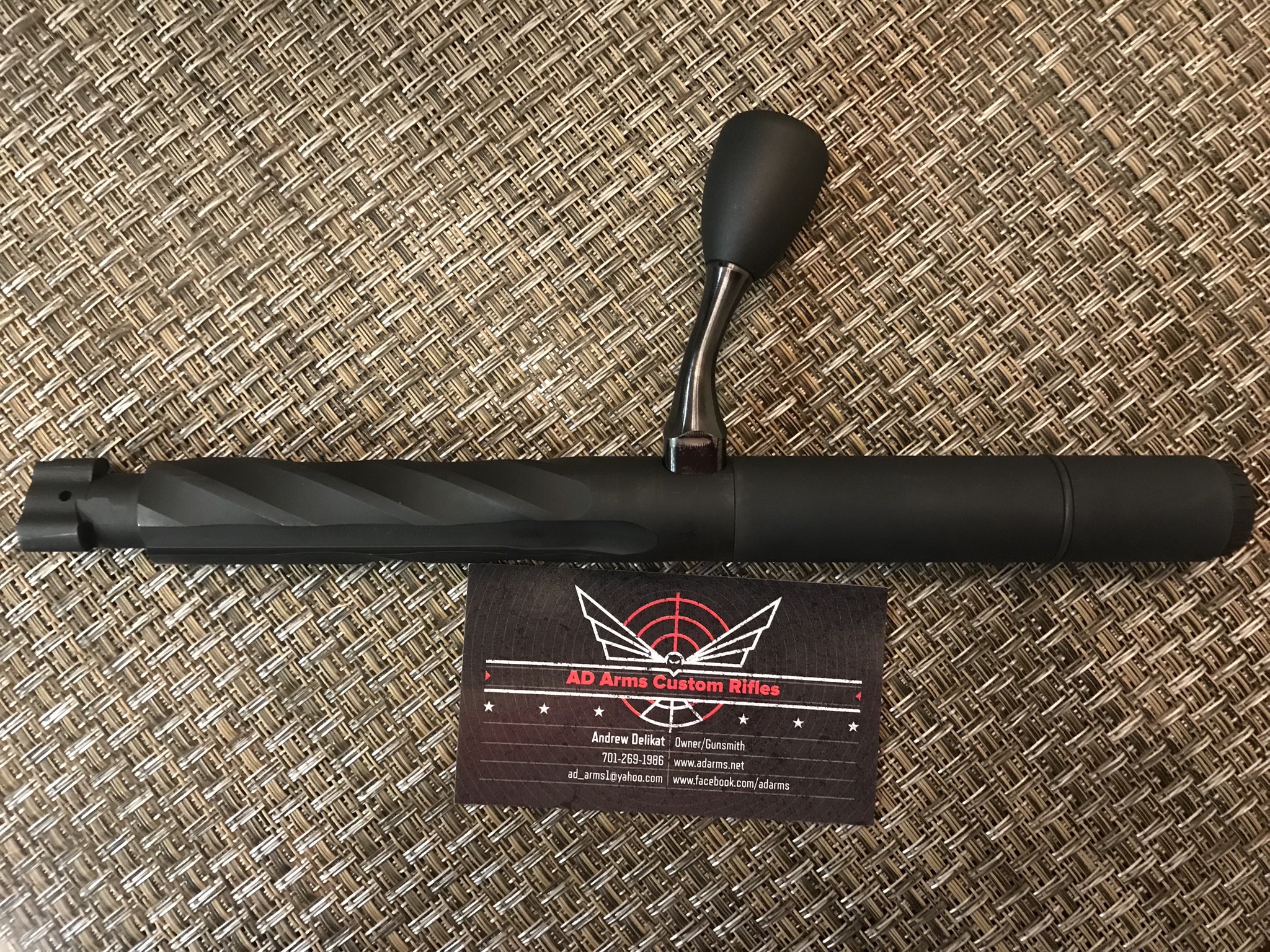

You can have it microslicked. I had my bolt fluted and microslicked and it runs way better than it did new out of the box.

The Anarchy Outdoors titanium shroud fits great and smoothed up my action considerably. I also want to look into getting my bolt fluted. I just wish I could buy a spare to send in but Rugar wont sell bolts.

I shipped mine to Andrew Delikat. I insured it for $500 because it didn’t want the bolt to get lost. If it did I would at least get something back. He did an amazing job and I highly recommend it. He can also flute your shroud to match your bolt flute if you go that route. His pricing is pretty cheap too.
