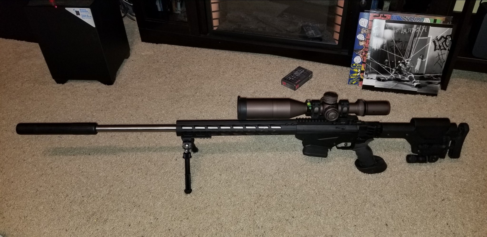

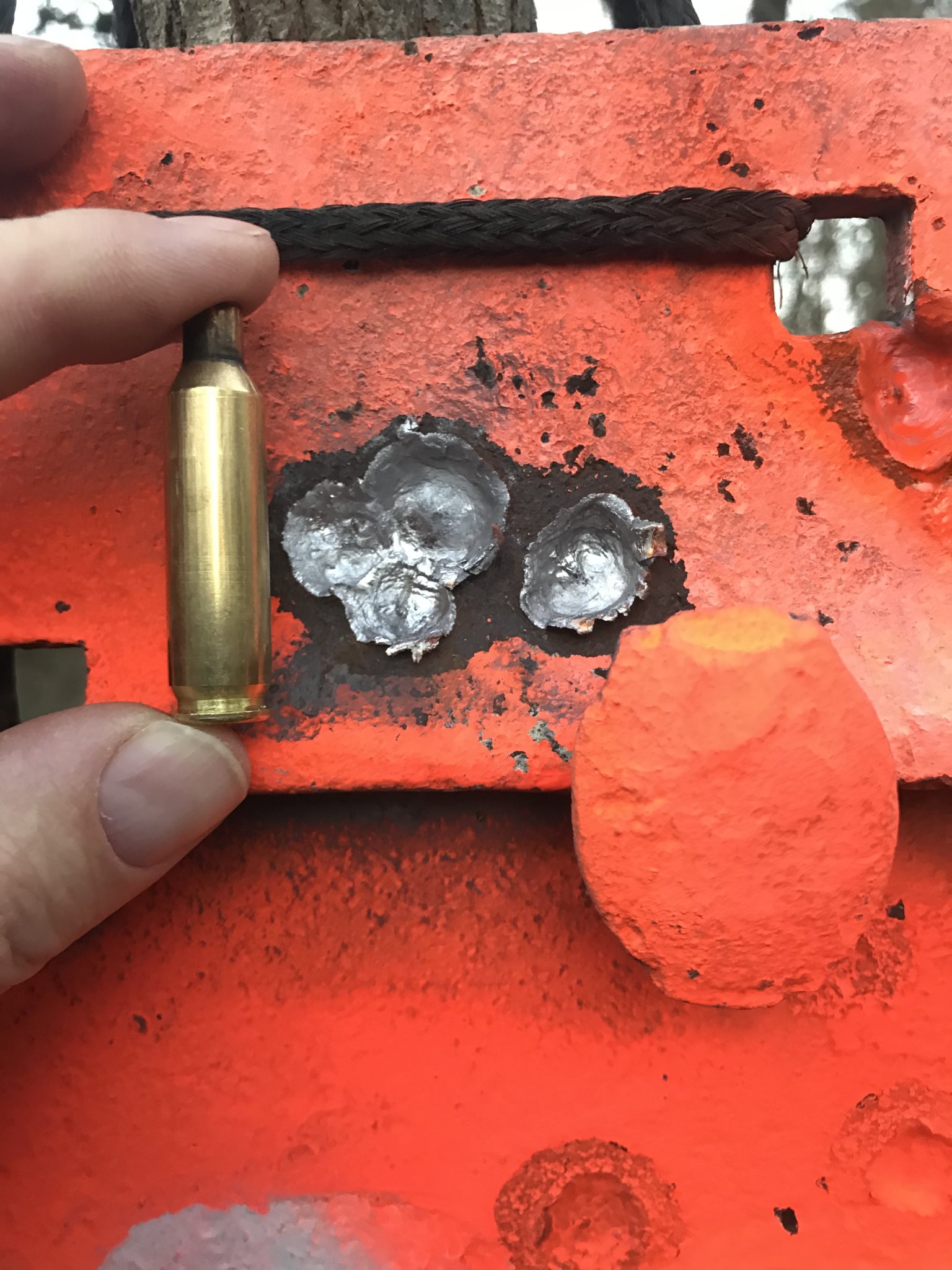

Today I shot five rounds at 400 yards. Load is 40 grain H4350, Berger 105 VLD Target with WLR primers. FPS 2833
Shot off one of my precision match obstacles. Not rock steady. BallisticsARC called for .1 click for windage which I did not dial in. Scope at 1.7
The bullet impact I’m pointing at was one of three extra rounds I had loaded up with 42 grains of H4350. First two were off target so I turned scope from 1.7 to 1.3 and bullseye.
I’m going to try some different primers & loads to get my FPS up.

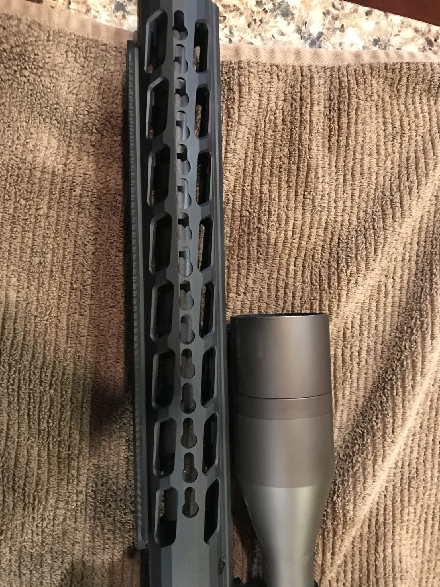

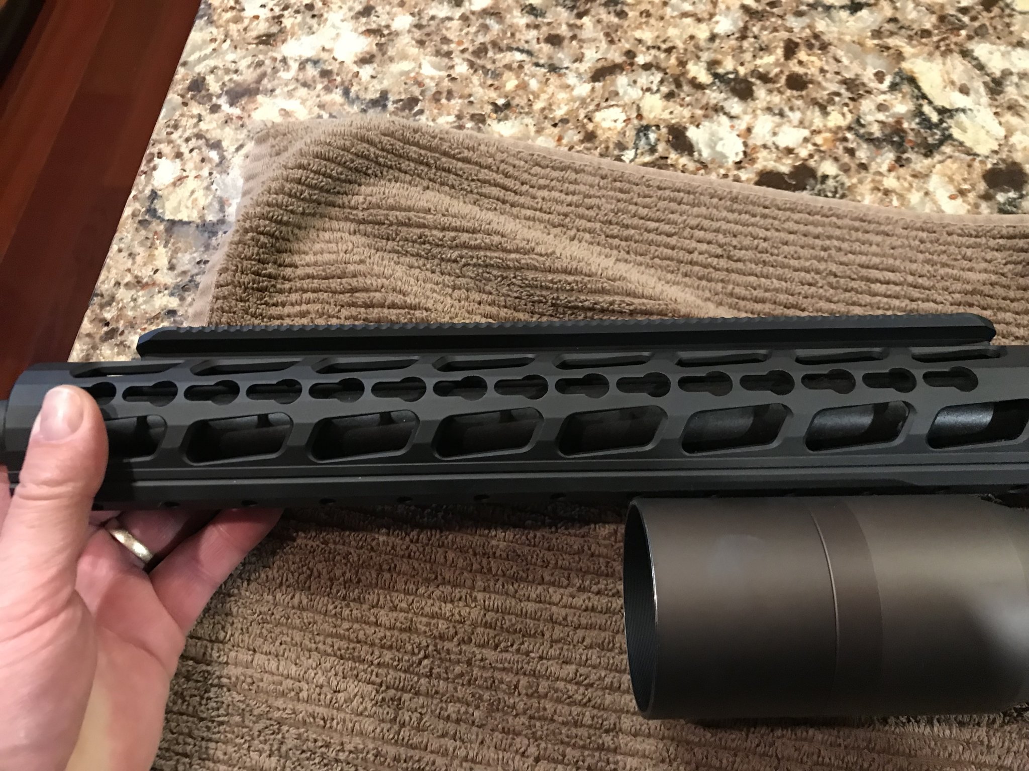

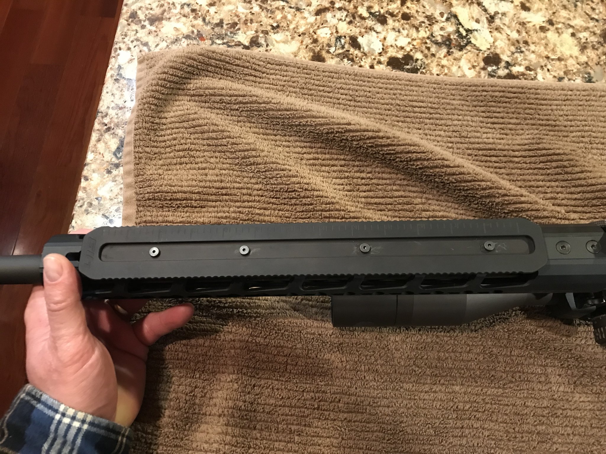

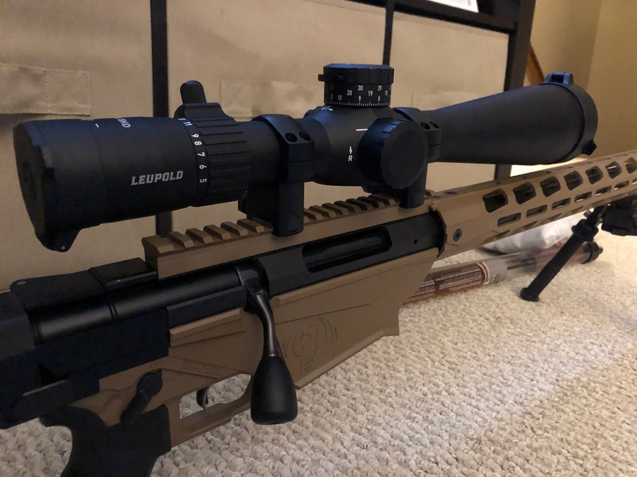

Also today I ordered the 419 ARCA rail for my rifle. This should help it sit flat and not roll around side to side.
Very nice! Catalyst Arms made a new handguard that’s very interesting. I may look into one.

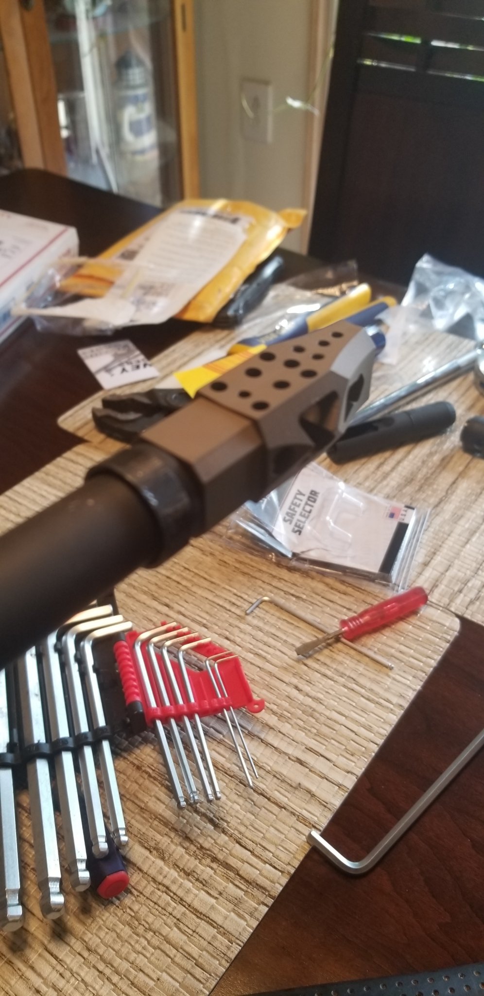

All of my new parts just came in for my build. Last thing to order is my Krieger barrel and then everything will be sent off for Cerakote and reassembly. Then it will be time to start shooting.

I have one on the way. The 20 MOA rails are 2 weeks out from shipping. My factory base is canted untrue from the bore. Found out after using a spuhr ISMS on my AXMC and moved the scope to my RPR and realized the Reticle was off. Something to check on your RPRs!
That's something I havent thought about. I think something is off about mine.

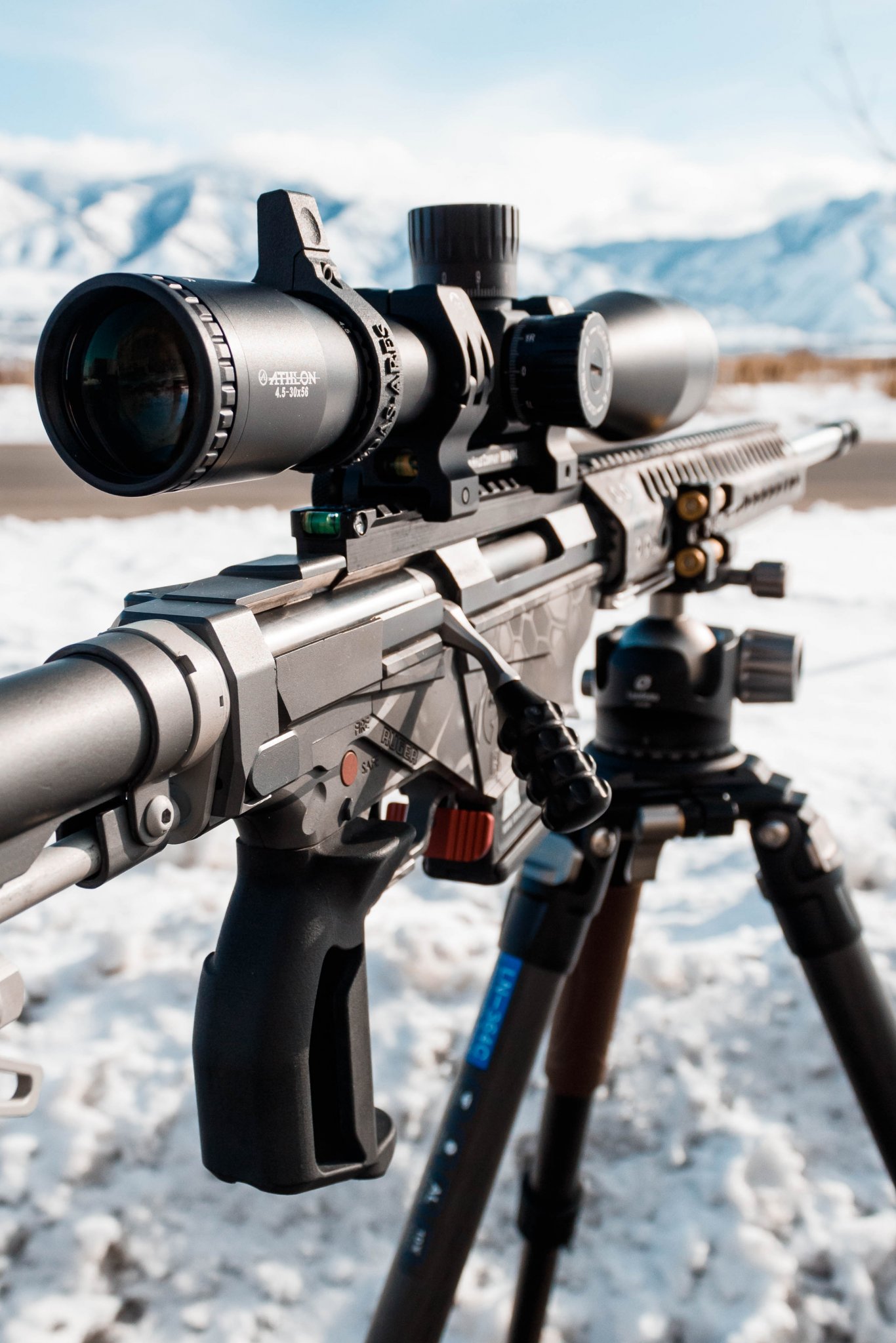

What’s goin on with yours?
I have a pic bubble that hangs off the side to level the rifle. Then I have a separate bubble that I can sit on top of the turret. When I level everything out, my eye sees the reticle being off by maybe a hair. I have yet to take it somewhere that I can reference the reticle against to make sure its level.
I'm going to pick up a Knights Armament level and see if that is any better.
The only true way to tell is to level the Reticle to plumb line and then go with it. I’ve got the anarchy outdoors 20 moa scope base awaiting shipment. Hoping it’s higher quality.

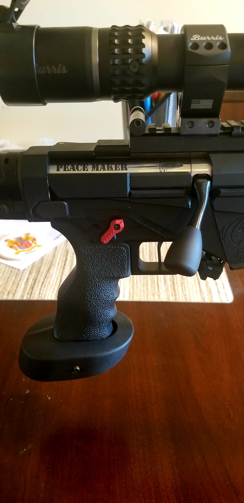

I just received my ambidextrous safety switch and custom engraved titanium shroud from them. Great customer service and they shipped fast. I was eyeballing that same rail with the bubble but I'm more inclined to buy that add on bubble level and sit it right under my scope.

Gamedic your better off with the level set up under the scope. I bought a Vortex level that mounts on my Razor. I can’t see it when I’m looking through the scope. I have to move my head out to see it. I noticed this at my first match last week when I had to shoot of a large tractor tire. I laid down with my rifle stretched across the tire. The shot was over 500 yds and I couldn’t see the level. I was shooting at a KYL rack. I hit the first three but missed the last two both times through. After shooting I got up and seen my level was pegged to the right. I got to rethink this...
That's what I was thinking as well. The level I put on my turret is just a simple level that I set on the scope to make sure everything is balanced and then take it off.

I have the same issue and just started practicing to keep the butt pad in my shoulder at the same angle to keep the rifle uncanted. This way I don’t have to rely on a level. You could look into a Spuhr Mount, a Send It LED level, or the new AO base rail with level. I use a Spuhr Mount so it has the included level in the mount.

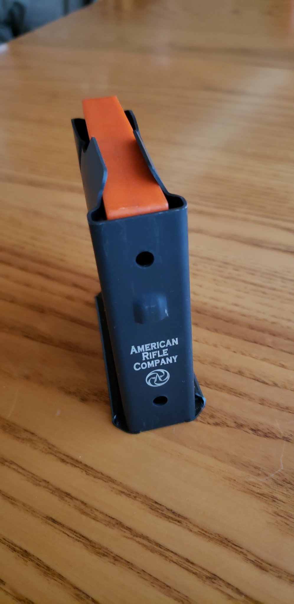

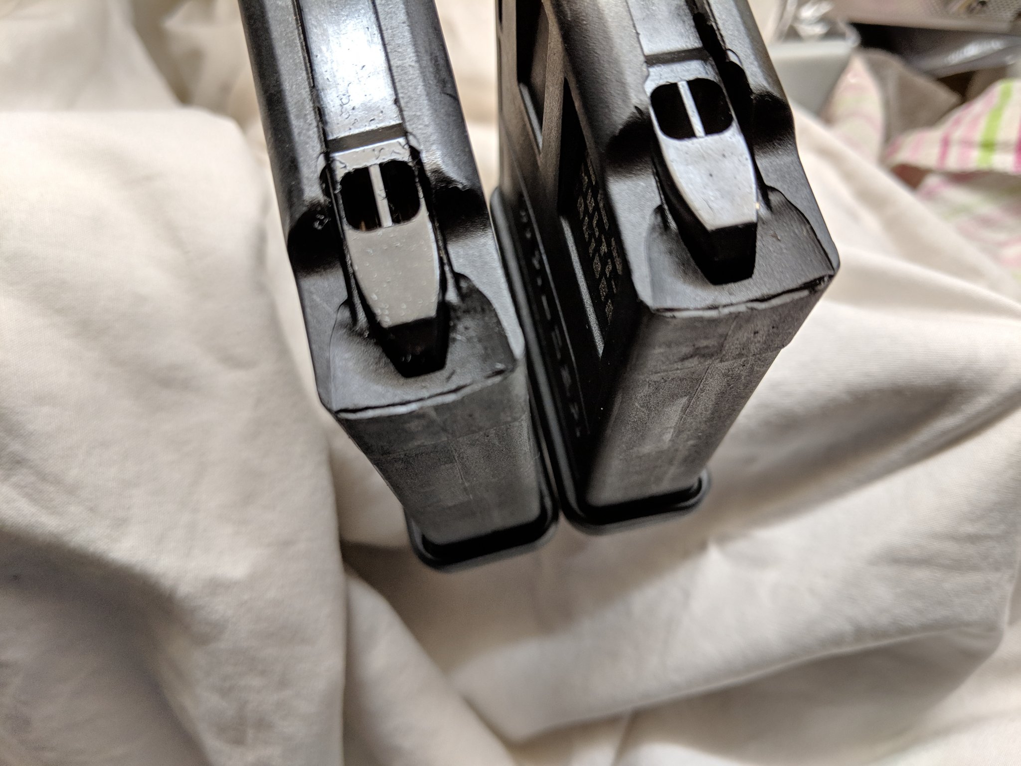

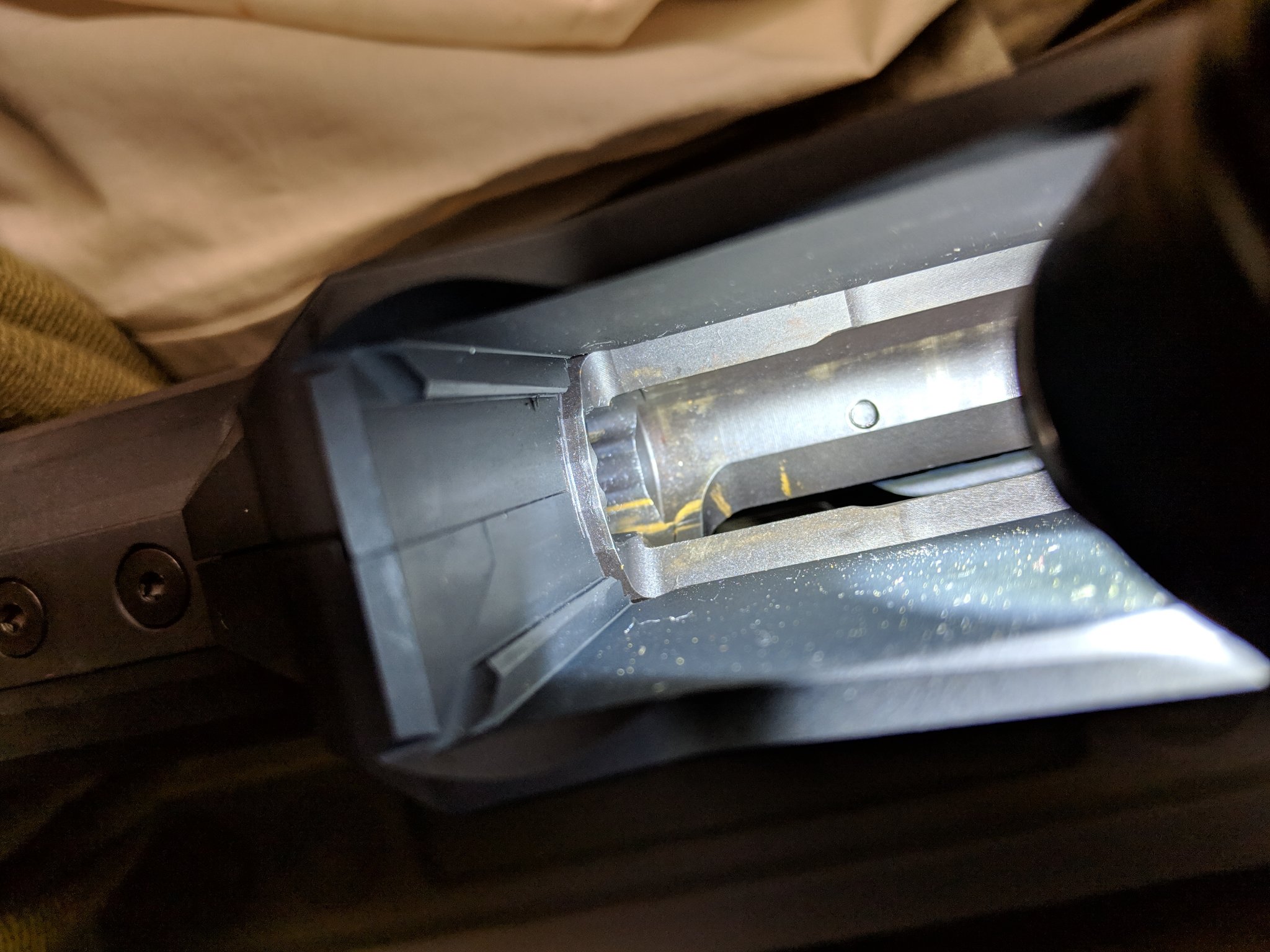

Today took some pics of my 223 of the gun and mag. The front top of the mags are touching the bottom of the barrel?
That is why it is so hard to sit the mags. I thought may be the gun is out of spec but then I look at my RPR 6.5 it sticks up into the mag well just the same.
So are the mags out of spec? If I Dremel off a bit off the lip they should be fine? But what if I use steel mags? It is much harder to remove material, and it might not be a good idea? So who makes a good steel mag for this? I think it is AICS style?
I am trying to see whether I can just do some Dremel work or send it back.

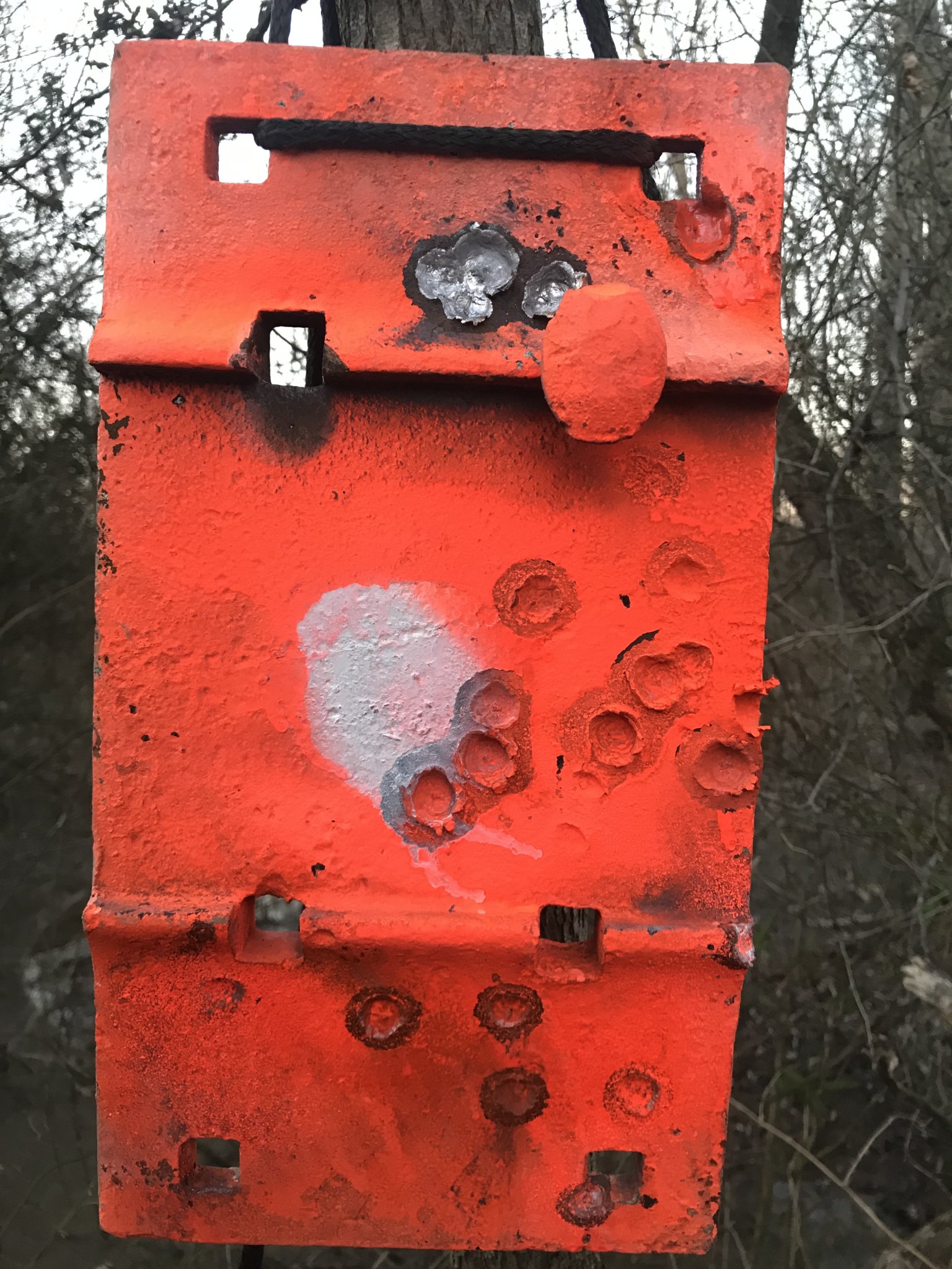

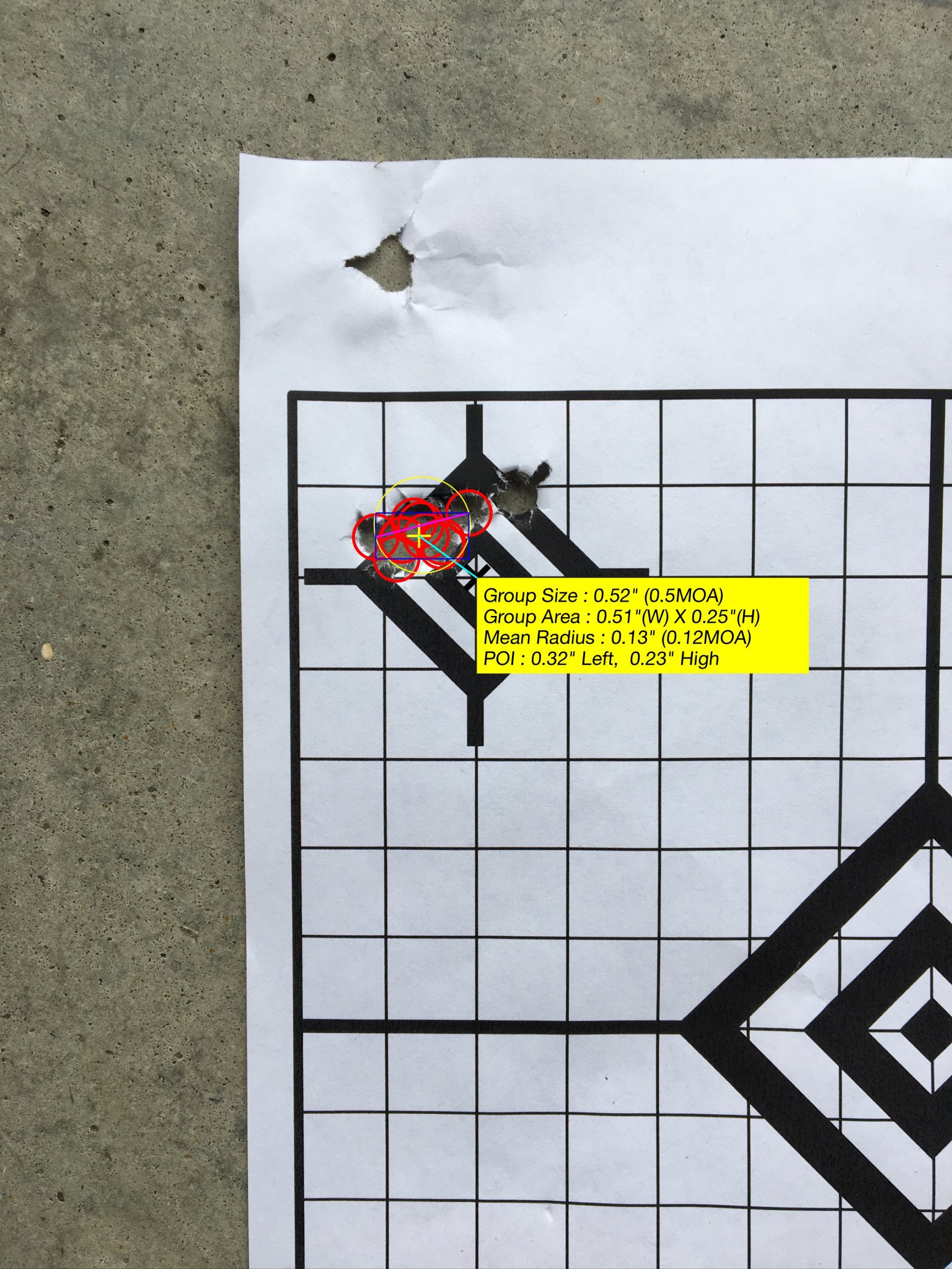

Yesterday I bought a brick of Federal Gold Medal 210 Match primers. I loaded up a five pack of Berger 105 VLD target, 42 grain of H4350, GM210M with Hornady neck sized only brass. This combo shot really good at 400 yards. I was calling this load my match load. According to BallisticsARC and my scope dial the load is around 3000 FPS.
good group!
Yesterday I had bought a box of Hornady 105 HPBT Match bullets to try due to cost vs the Bergers. About 13-15 dollars a box cheaper. I figured these to be my practice ammo if they worked out.
So today I loaded up five Hornady 105 BTHP, 42 grains of H4350, GM 210M and neck sized Hornady brass. I shot them at 400 yds. I figured 3000 FPS. I took a photo of the group. Aiming at the white dot. It appears they are a little faster than 3000 FPS with 1.5 on my scope.
I think I just found me a new bullet. I also believe the Federal GM210m primers are the go to primer for this combo.

If that's the best you can do at 400 yrds...you are gonna have to tighten up or you're off the team...
Nice work....looks like you may have found your go to....looks good
good group!
I too use railroad plates for metal targets.
