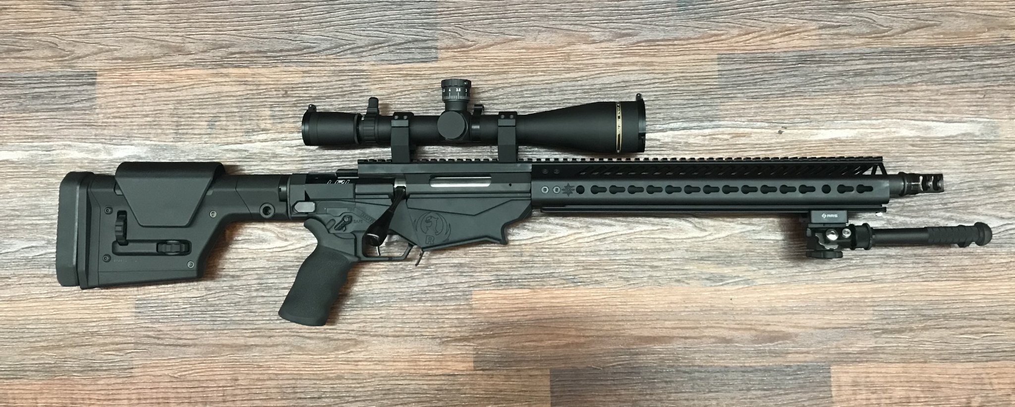

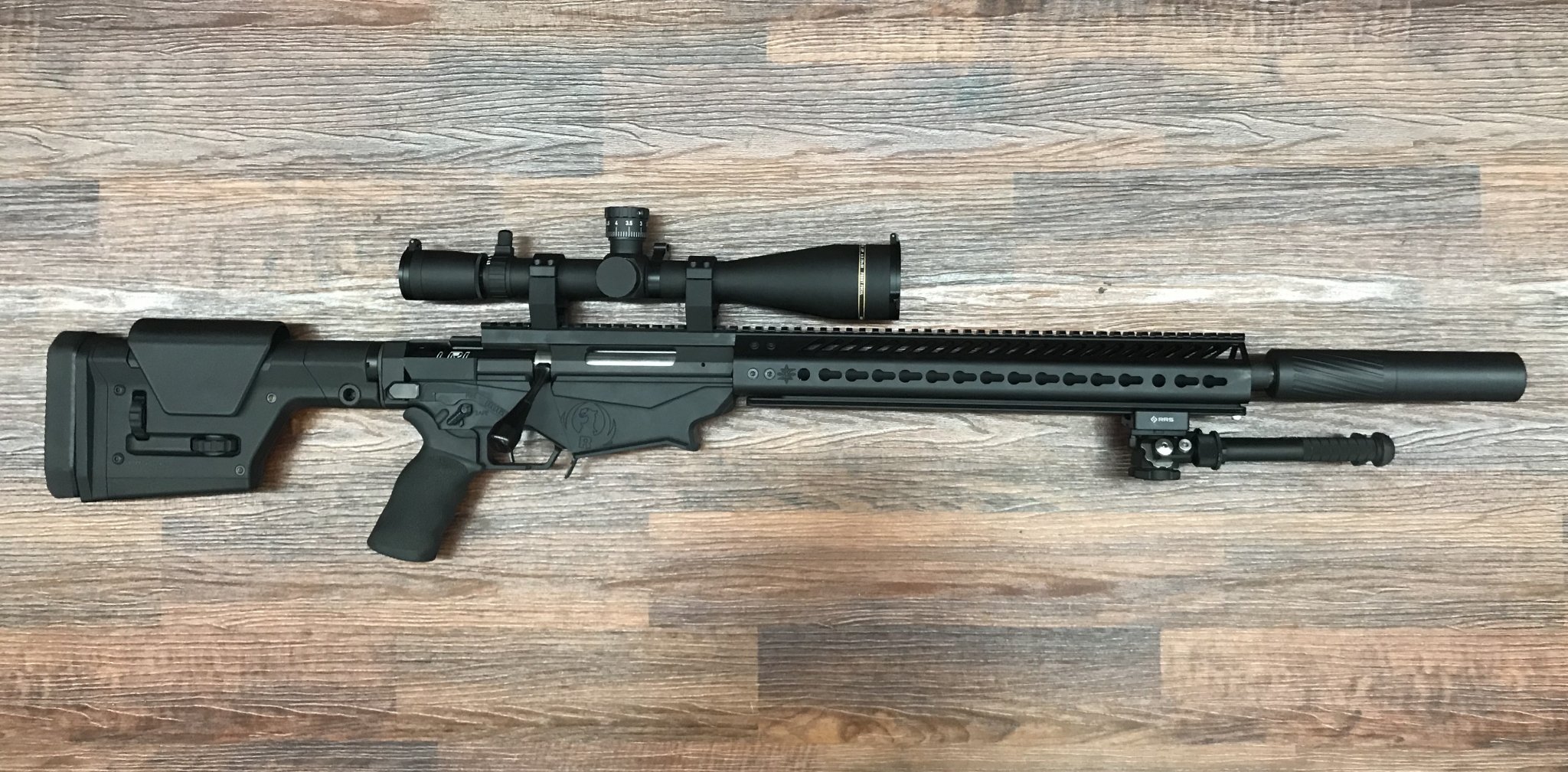

Here’s my little RPR. It’s chambered in 308. It’s one of the integrally suppressed versions from Machine Gun Tours/Witt Machine and Tool. Finally got the glass for it. I’m running a Vortex Viper PST Gen II 5-25x50 EBR-2C Reticle (MOA) with Vortex Precision Matched rings. I did minor upgrades to the bolt. Replaced the bolt shroud with the Titanium shroud, replace the bolt handle and knob with the titanium version, and added a Catalyst Arms Mag release extension. Have not put too many rounds through it so I’m not sure if I will replace the trigger or not. So far I like the trigger.
View attachment 6941160View attachment 6941162View attachment 6941161View attachment 6941164
Which height did you do on the rings? Looking to shoot 1000-1500 yds and need to make sure I will have enough adjusment in the MilRad version I just ordered.

When I talked to Vortex and told them the rifle I have and scope I was fixing to order they said high rings would work best. So that's what I ordered. Precision Matched Rings — Height: 1.45 Inches

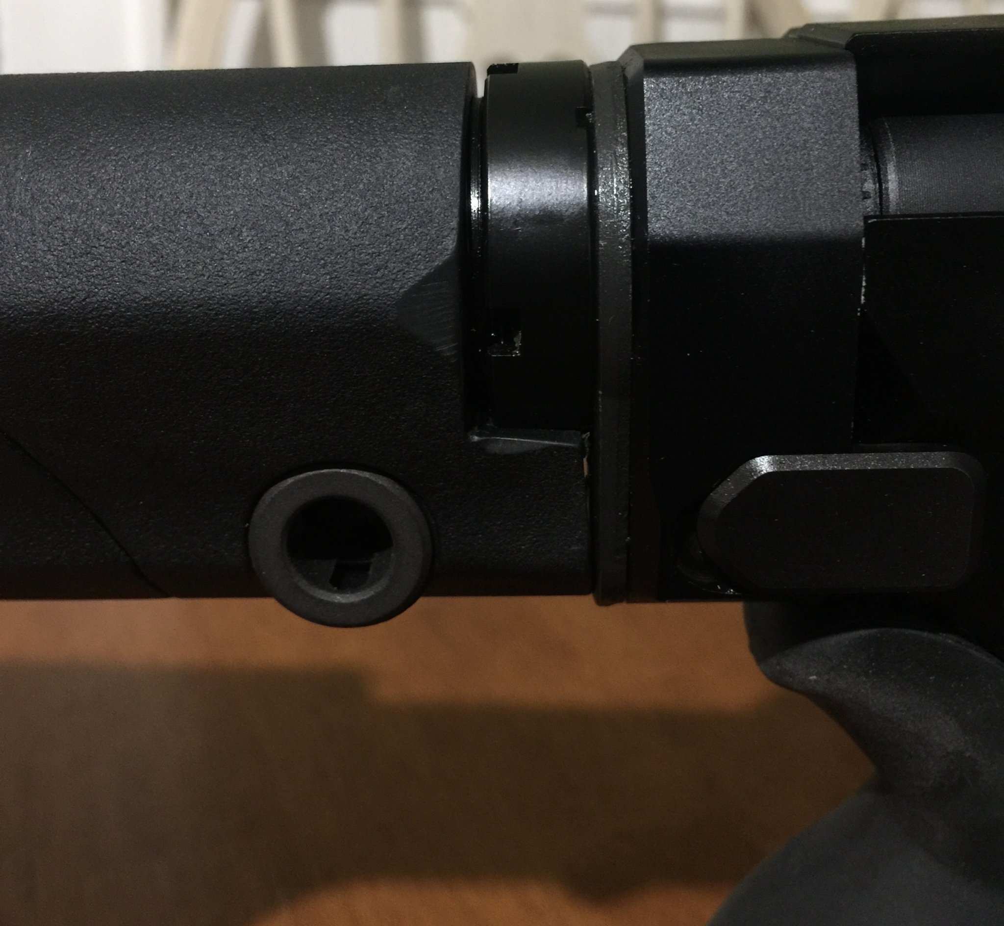

Are any of you as big of a goofball as me and have the plastic tool that separates the firing pin and cocking piece pop off? I have been unable to get tool back in and probably made it worse but rotating the assembly and not sure how it was when I started. If anybody has any ideas, I would appreciate any help...

Fixed it. For those that find yourself in the same predicament, this is what I did. I took the firing pin assy and slid the bolt handle onto it past the lug. Rotated the handle 90 degrees so the handle is locked on the lug. I used padded vice jaws and held the bolt handle facing down (the tail portion of the firing pin assy that sticks through the open slot in the shroud is up). I clamped on the tail that was sticking up with vice grip pliers and pulled on the pliers to compress the spring. Then I was able to slide the tool in, release the vice and pliers, take the bolt handle off, and re-assemble as usual.

I have done the same thing. Luckily I found a guy on YouTube that did it also and watched his vid on how to fix it. Lol I did this within the first 5 minutes after I brought the rifle home haha
LOL, thanks for the reply. Nice to know I was not the only one. I need to work on my YouTube searches because I didn't find any, but after you mentioned it I looked again and I found one.
