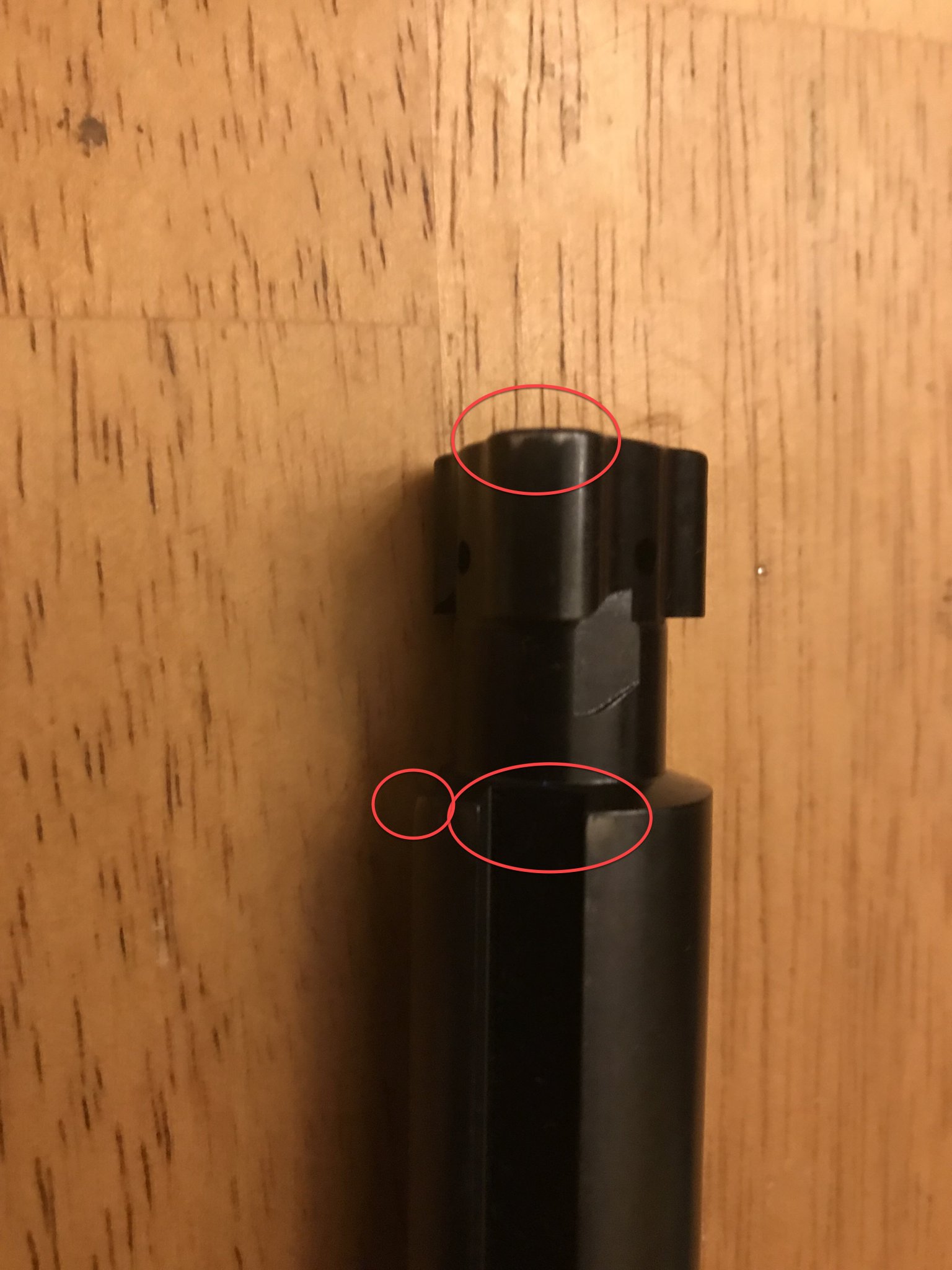

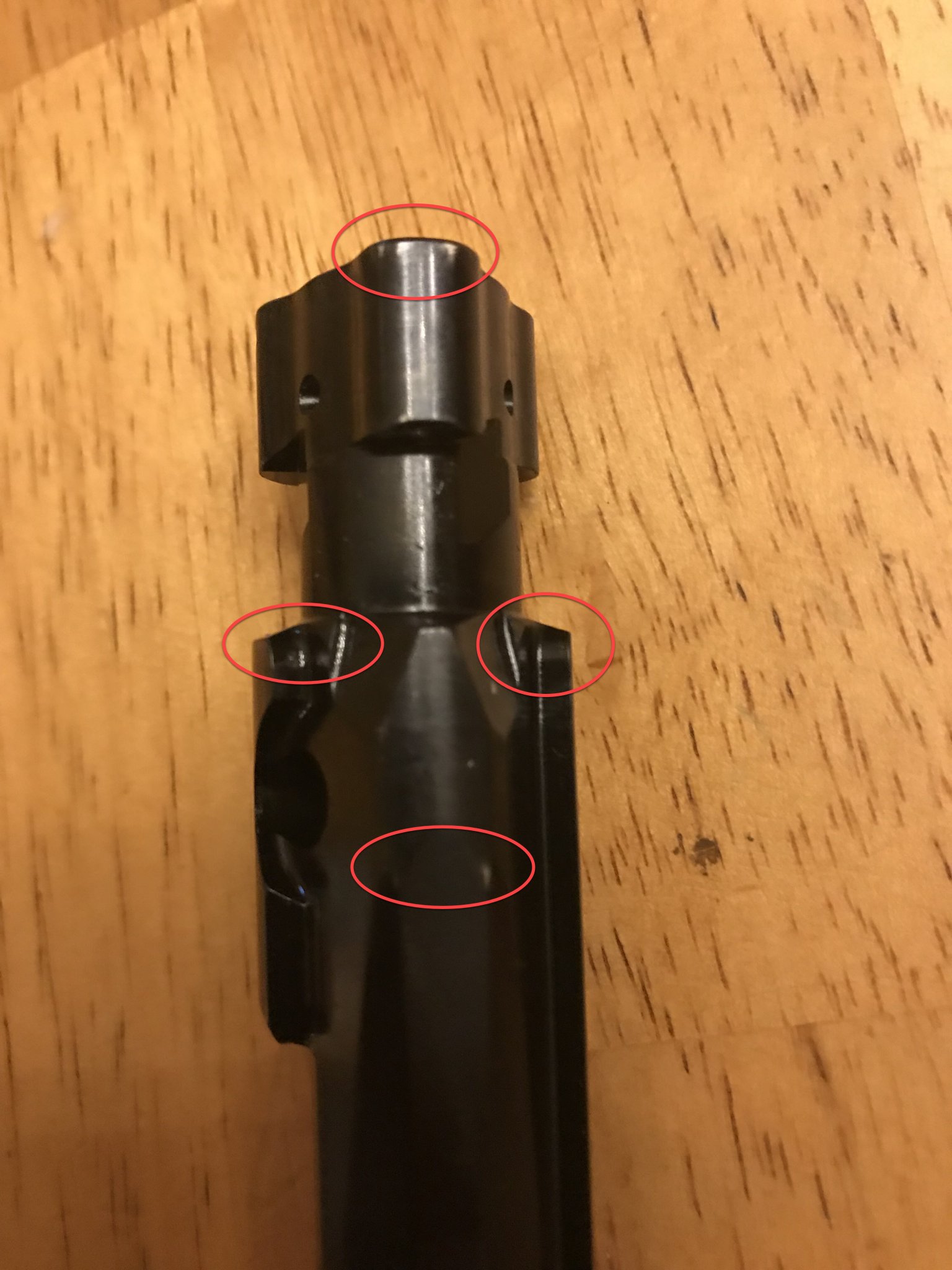

Lots of folks here have talked about polishing the RPR bolt to get rid of the zipper like feel/sound many Rugers exhibit when running the bolt. Can someone who has successfully accomplished this please post a picture clearly showing what areas, on rifle and/or bolt, were polished to make the bolt run smoother? Thanks!
Also interested in if there's some light polishing that will smooth this out? On all of my guns, I've used a Dremil with Mother's Polish to smooth the action. Alternately, found this YouTube that should certainly work to marry the surfaces. Not sure I'd actually close the bolt as this would wear the lugs. Running it back and forth should work though.

For smoothing up the bolt, I just used some very fine grit wet sandpaper. It did a really good job. My action is very smooth now. I didn't touch the inside of the action.
Regarding the JB bore paste video...I would have removed the trigger and cleaned out the action a lot more than what that guy did. Not sure I would want JB bore paste getting down into my trigger.

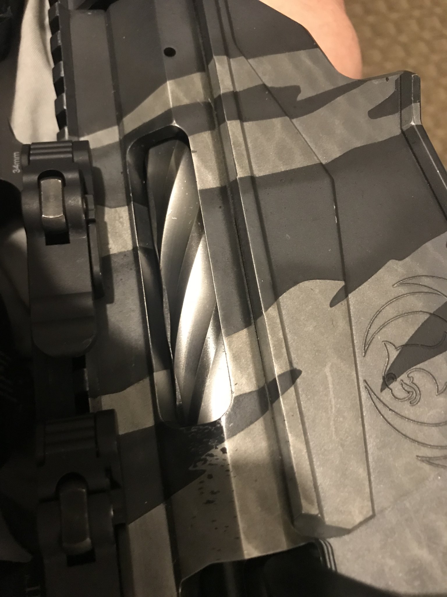

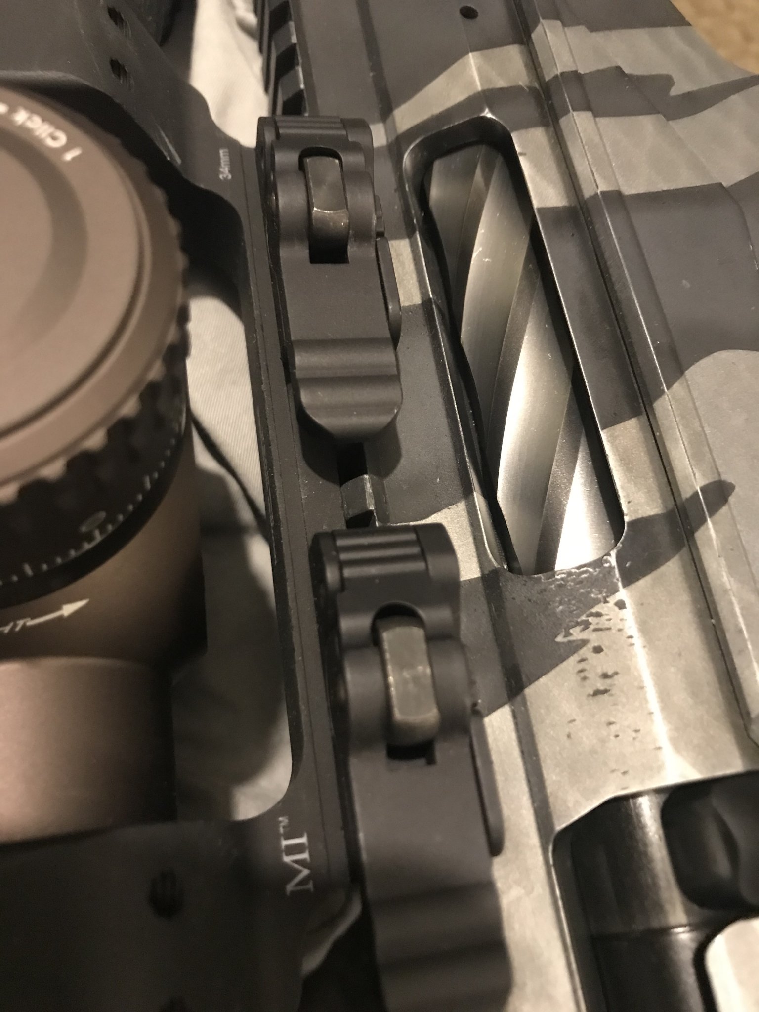

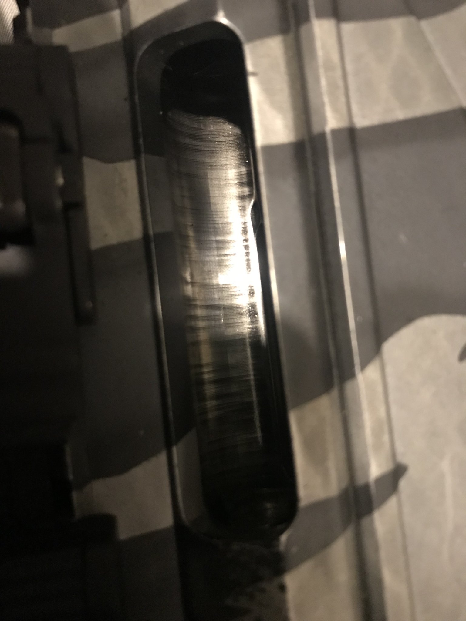

As I watched that video the first time, I was also thinking about the abrasive mess inside the receiver, particularly the lug area and trigger.
Looking at the video, the machining lines inside the receiver seem to be what's causing the contact that makes that zipping sound. Just looked at my new bolt and it's smooth. I found it interesting that literally after running my bolt back and forth only 10 times, I had immediate wear on only the front edged corners and nothing at all on the side of the bolt. Clearly, this tells me where I have to be careful with lubrication. I'm guessing that these corners are also the only points contacting the machining lines.
Don’t polish the bolt. I asked the same question on accurateshooter blog. All benchrest guys. “Scientists”. Lol. They told me to polish “clean up the bolt raceways, Not the bolt. Anywhere the bolt makes contact on the inside of the rifle in the upper receiver back to the stock. I knocked down all the high spots with fine grit wet sanding. Was worried it would hurt accuracy, but it did not, Worked fantastic. In combination with the heavier Anarchy outdoors bolt shroud, it is smooth and quiet. Also had my bolt fluted, But I don’t know if that played a role in removing the zipper. It may have helped. Also
Thanks for sharing that. As an aside, that fluting looks great!
Looking inside that receiver, it's tight! I can see the raceways but can't see a way to get to them with even a popsicle stick. And I'd be concerned with screwing up the profile if I can't get something flat in there. So how did you do that wet sanding please?
I used a 3/4 inch wooden dowel with sandpaper wrapped around it, And my finder with a small piece of sand paper.

I meant finger**. With a small piece of fine grit sandpaper
That part makes sense. What I'm puzzled about is how to smooth the raceways? One appears to be a machined dovetail with a lot of obvious machining chatter marks. The only way I can think to get into the raceways is with a sacrificial bolt and abrasive paste. I've submitted some related questions to Ruger to get their take.
You cannot get another bolt which is the part that stinks. They won’t give you one. You should be able to reach everything by your fingers, Or a dowel. And stay away from your lugs in your bolt, Or the part where the lugs make contact in the upper receiver.
