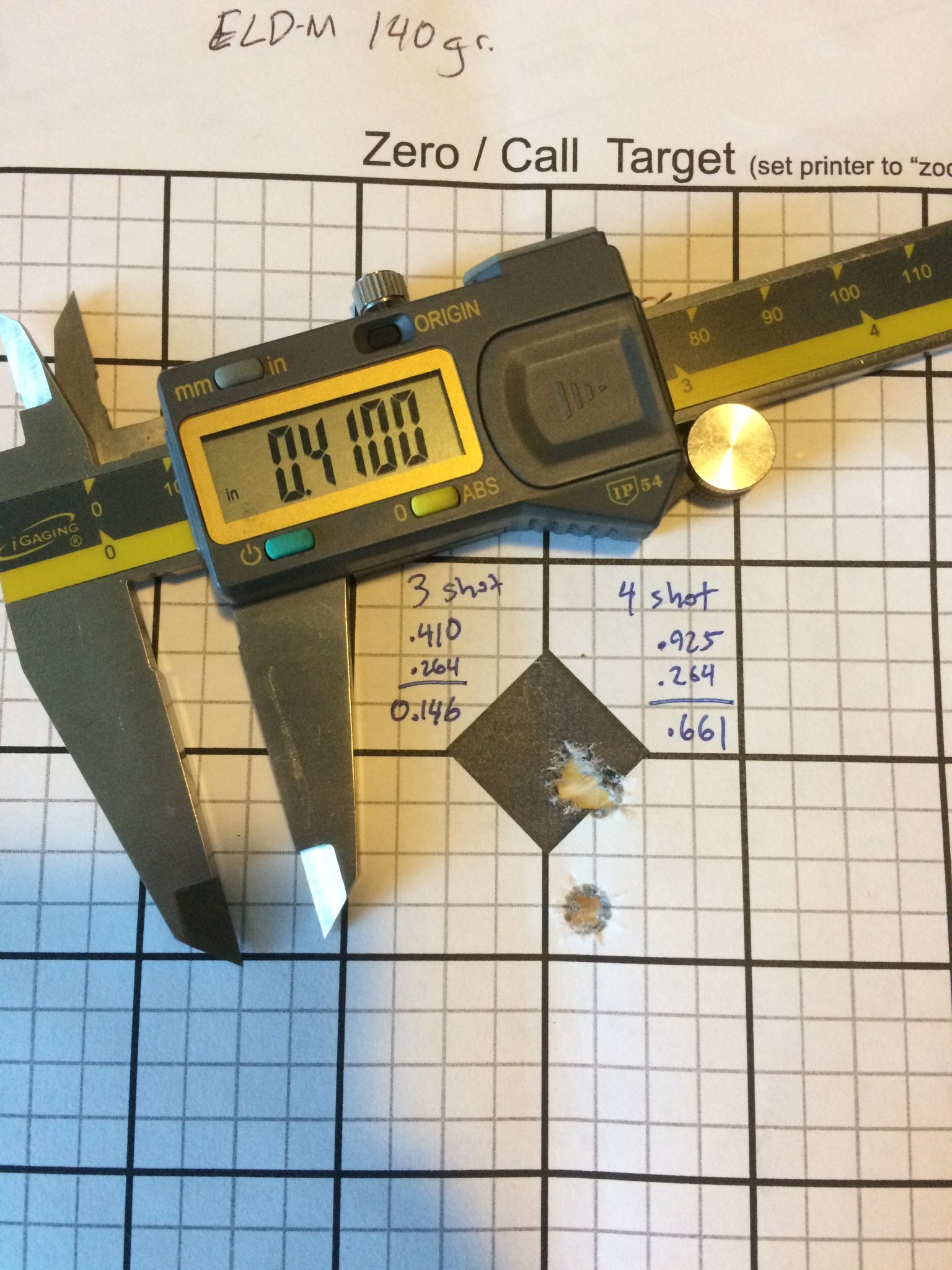

I’m using Lapua Brass with H4350 and 140 ELDs. 43.1 grains gives me single digit SDs. My barrel is slow and that’s right around 2770. Hoping it speeds up after a couple hundred more rounds. But can’t complain much for a factory barrel that shoots factory 140 eld ammo extremely well too. I have once shot Hornady brass I’ll probably do some testing with after my load is finalized in the Lapua brass
