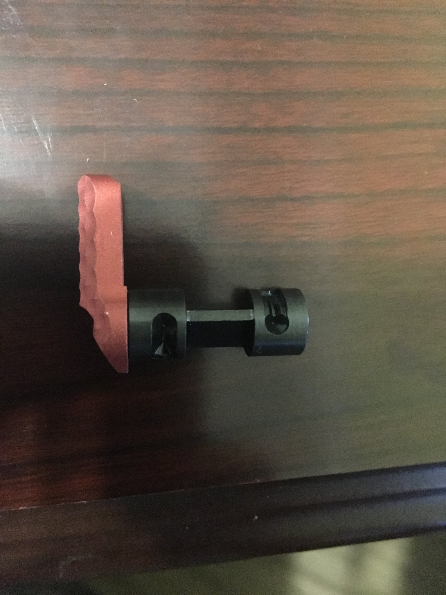

Hey Guys I just picked up an 6.5 CM RPR with a LRI 26" barrel.
I replaced the trigger with a timney and the safety lever (seekins) I am getting a little wiggle in the safety now.
I made sure the spring was reinstalled. Not sure if this is normal.
Thank you

I did remove and replace the safety. I did notice the Seekins Safety body was different than the stock one.
The body on the seekins is triangle shaped and factory safety is D shaped.

I have a standard 90 degree Seekins. Moves about that much but everything works fine. I’ve heard the 60 deg might be a bit better but have never had any experience with it.
i use the ambi seekins safety. it has a 90 and 60 degree position depending on which way the barrel is inserted. if you put the short throw side on the left where the spring is, i dont get any wiggle at all with factory trigger. i will be receiving my timney trigger tomorrow so ill see what ahppens. but i bet you have the same safety i do, if you look on it there are 2 detent positions. the one i have here where the safety selector is the 60 degree side. per seekins, this is the side they recommend using for the RPR.

Update for you. I received my timney trigger today. I could not install it on my rifle. long story short, my trigger is out of spec and .005" wider in the rear and doesnt fit in the receiver slot. Timney being the great company they are is taking care of it and getting a replacement out post haste.
However, i did mess with the safety. the factory safety has very little wiggle room in it, but i feel the same play in the seekins one that you do. i’d imagine as you summized earlier, this is due to the design of the berrel and the fact that it is a 60 and 90 degree throw safety where as the factory is not ambi and is a 60 degree only (ICYWY, its the same safety as the SR762). so when i get my replacement trigger, ill install it and let you know what happens. i do notice a lot of wiggle in the timney trigger saefty mechanism. if you wiggle the blade inside the slot where the safety selector fits, there is quite a bit of play, that could contribute to what you are seeing.
Also, FWIW, seekins did tell me that they have never tested their safety with the timney trigger at all so they make no claims to compatibility.

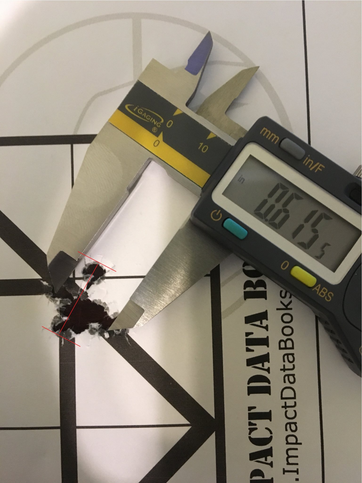

I just rebarreled my RPR and have been working on load development the past 2 days. During this time I've had an unusual malfunction creep in periodically. I fire a round and when running the bolt to the rear the back side of the front lug on the bolt runs into the top round in the mag on the angled part of the shoulder just below where the shoulder meets the body/side wall of the case. When it hits the blot stops and is stuck till I work everything loose and it put a little nick in the case of the next round.
This has never happened before with either the factory barre or a Proof barrel I had in there for the past 4 months. I think that this could just be a coincidence in that It is happening right after a barrel change but really don't know. I think maybe the fix might be to adjust the mag lips to hold the top round a tad lower but that is just a guess as well. This particular malfunction also happens with 2 different mags exactly the same. They are both Accuracy mags and have functioned perfectly for the past 2 years.

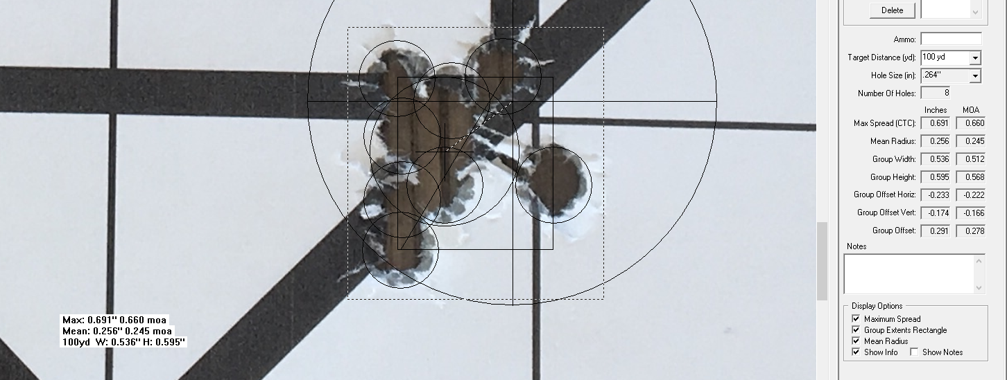

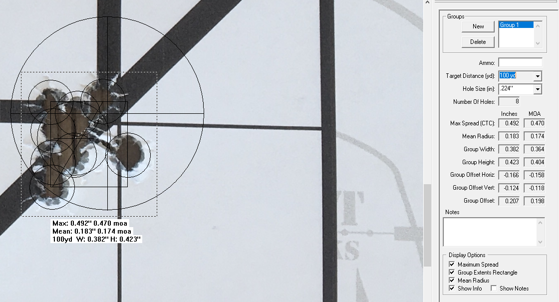

Got to the range today. had to re establish zero after tearing rifle down. After confirming my zero I fired off a fast 8 shot group at 100 to confirm it was all set.
Factory Barrel
Hornady 140gr ELD-M
EDIT: had to fix the target. someone else mentioned if i put in the hole size diameter and i didnt change it. i also double checked the reference measurement and that was off as well. Guess i didnt save it when i did it? anyway, changed a bit from .48 to .66. still not bad for the ol RPR and me. Personally, i still think this target is off. it looks more like a 1 MOA group than .6 MOA. i ll have to make sure i know what i am doing with this program. me thinks if i put calipers on it it would be closer to 1 MOA. not as impressive i guess. Well, another edit, looks like it is in the .6 range.
