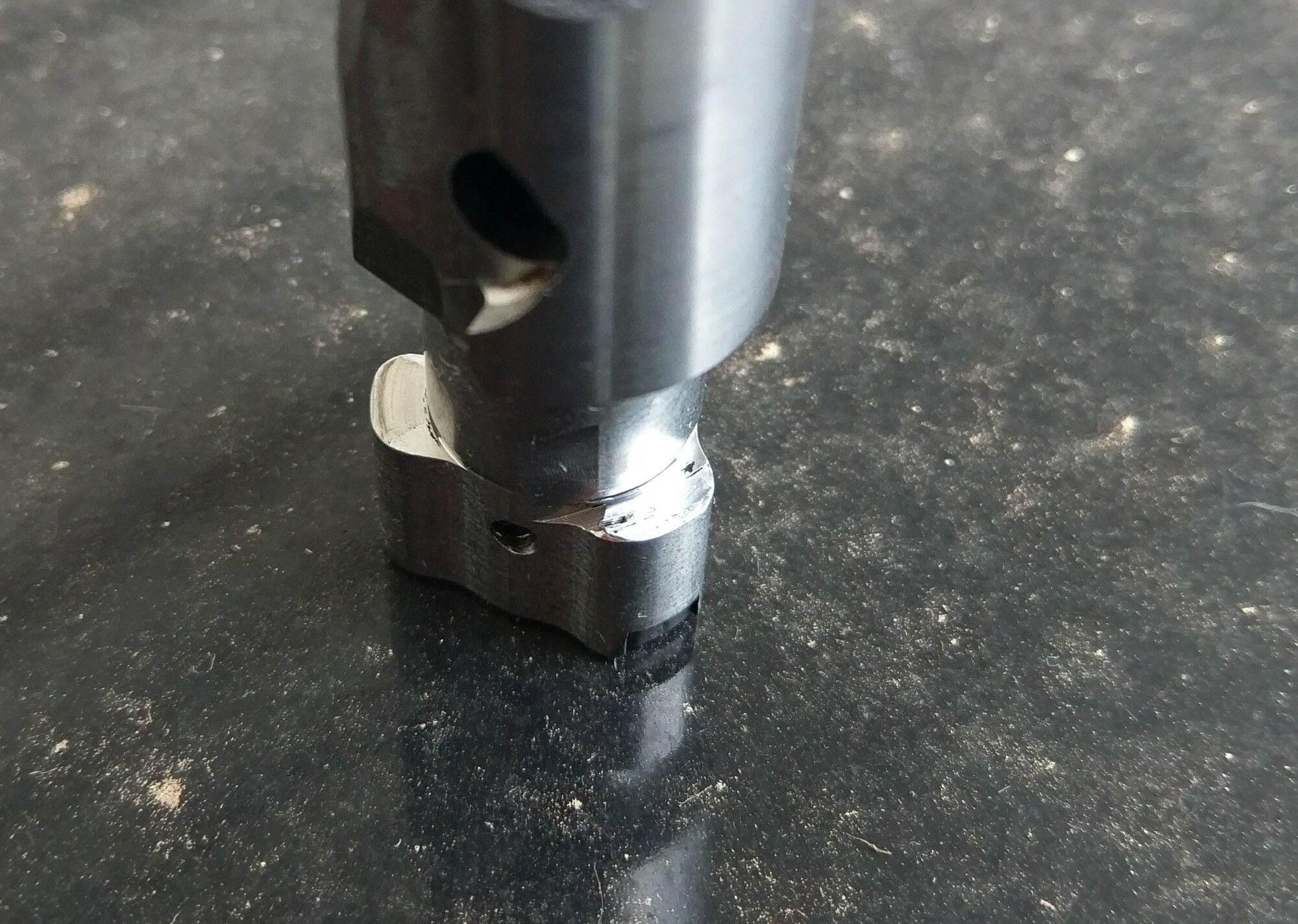

Mike a
Jan 29, 2018
3
0
2
Recoil lug or Bolt lug
Bolt. Duh, dummy me. Sense my 1st post I've removed the barrel cleaned real good and lapped. I used that reddish colored polishing compound that came with a Dremal tool kit. I mixed it with a little gun grease. Cleaned up really nice. I have to say the stainless bolt lugs were the worse but the action lugs were ugly too. The bolt lapped quicker than the action. Seemed like the stainless bolt was softer than the chrome moly action. Actually the bolt lugs seem real soft, scratch easy! Think I'll have to pay closer attention to keeping this area clean.
I use a little grease on the lugs and clean the receiver lugs after every outing.
To avoid this.
FlaShooterG
Jan 21, 2018
89
23
12
To avoid this.
Hope you don't mind me jumping in. Does anyone make an aftermarket bolt that is better? I was warned about this and have also been going down the route of adding a little grease to the lugs to avoid wear.
Why would anyone NOT lubricate the bolt and lugs? I was taught by my grandfather in the early 60's the basic things that need to be done to maintain a firearm. Greasing the lugs on the bolt and receiver are basic, and have always been. Anywhere metal moves on metal, it gets cleaned and lubrication of the appropriate type. EVERYTIME, even if it's just a quick trip out with only a single shot, clean and lube. I have several of his rifles now, some well over a hundred years old, including one that he got from his grandfather, and all still function flawlessly.

So I've got about 2400 rounds through my .308 now. Curious if anyone else has had their butt stock screws come loose. My stock went from wiggling a little to very very loose. Pulled the butt pad off, screws out, loc tited them and reassembled. Seems all good now.
i replaced mine witha PRS Gen 3 and some blue Loc tite. GTG.
Griz
Thanks for the response. I absolutely agree that clean and lube should be done on all weapons each time following their use. Truly, this is the way to insure they function as designed for as long as possible. It is really nice when we are handed down sage advice that is as sound as yours and I thank you for it. What I am also looking for is advice anyone can offer on replacement bolts for the RPR other tha trying to go back to the factory. Does anyone know of a replacement bolt that is either more accurate or more durable than the factory bolt??
To avoid this.
Id like to avoid that. Not to derail the thread I know how much grease/oil threads become a debate but is there any good or bad grease to use? I have some Hoppes Black grease, some other red grease in a syringe, and some automotive wheel bearing grease from AR barrel nuts.. Would any of those suffice or is there any that may be better?
I've got just over 1800 rounds through my RPR, so far, and have been using Otters Choke Tube & Gun Grease (just a smidgen) on my lugs and they currently look great and lock down nice and firm.
I'm not fond on Hoppes Black grease or any other "black" grease as it prevents seeing what that might be going on in the area it's being used in.
I keep a small jar of RIG on my bench. It was designed for stainless steel to prevent galling, but I have found it to be an excellent grease for just about anything that needs greased. I like the small container with the full size screw off lid, makes it handy to dip from with finger. screwdriver tip or q tip for easy use.
I always use an automotive anti seize (the silver stuff) on barrel nuts. It was designed to use even on spark plugs where the heat gets really intense. It wont dry out after several years and get sticky like bearing grease. I have been known to get an AR barrel exceptionally hot...
I didn't think of the color hiding bad stuff. I guess I'll use some of the red grease for now and watch for some more choke lube. I had some but who knows where it ended up.
Thanks!

Im using the milcom TW25 grease, it is thin and does not make a mess. It stays where you put it but cleans off very easily.
