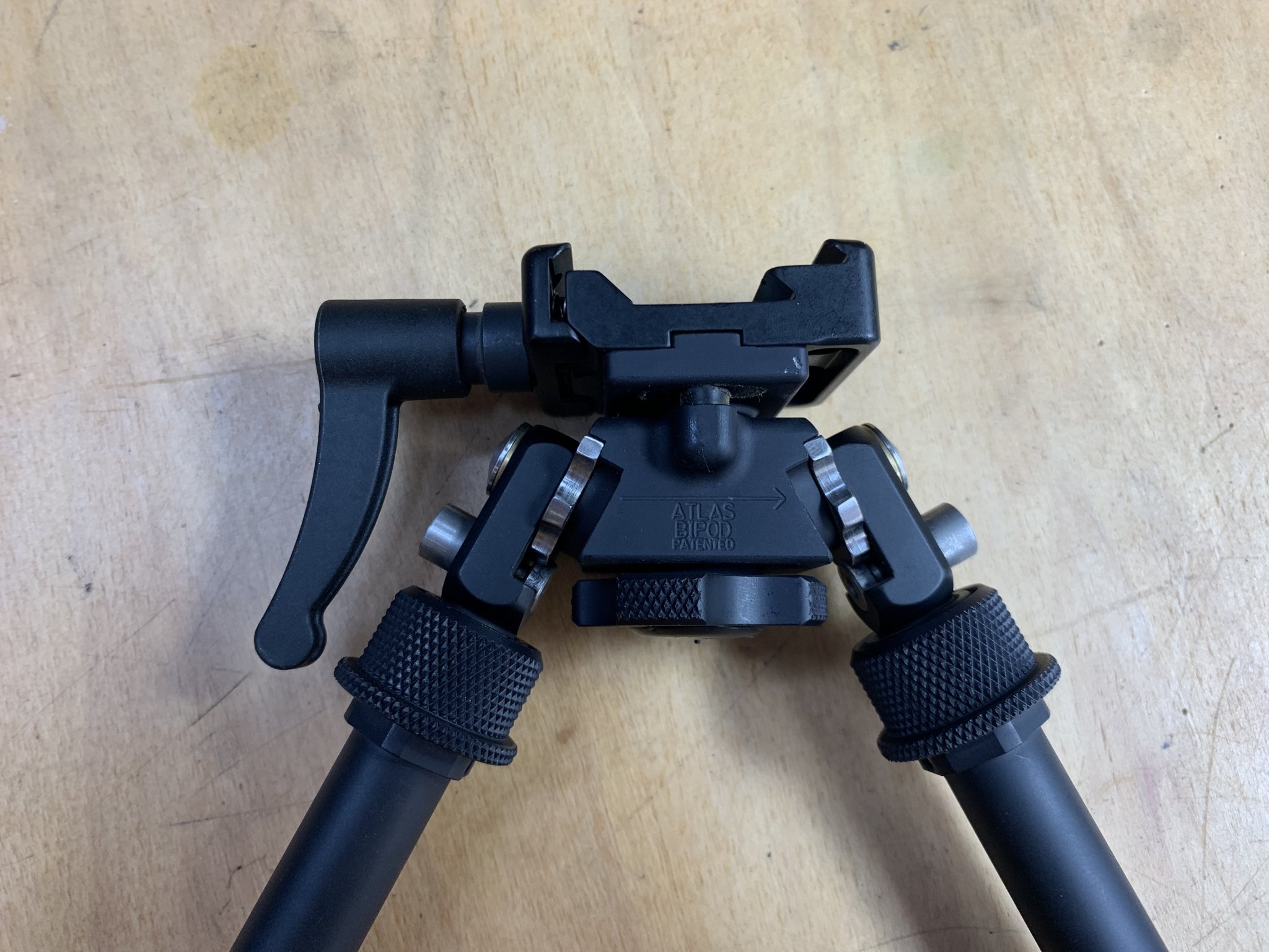

Just a head's up, but if you're using the Atlas Cant and Loc bipod, your options are limited. I picked up the B2-40-LR clamp and learned the hard way that it won't work with the Cant and Loc. The BTC-Pro will work, but I wanted a lever clamp instead of a knob.

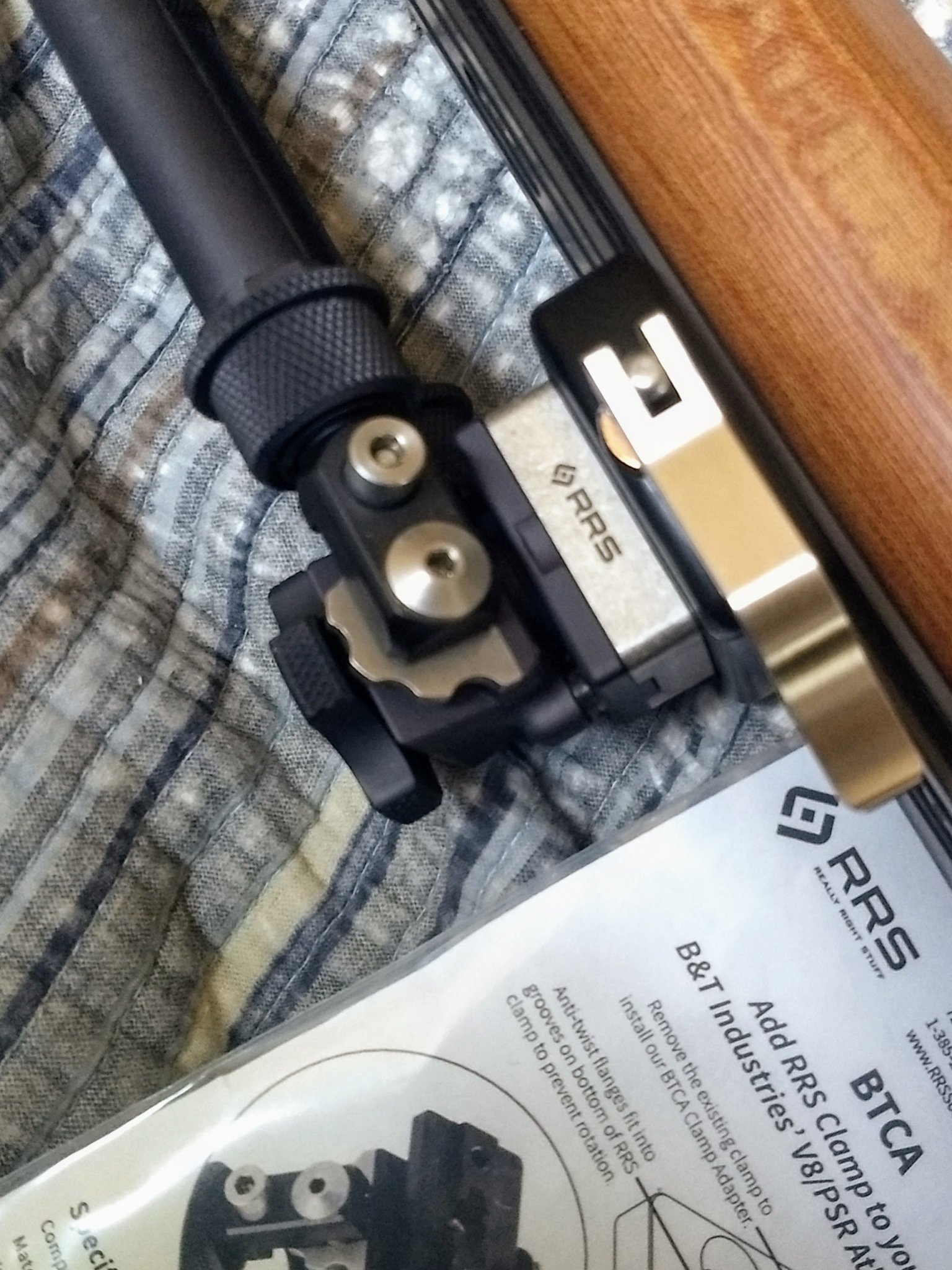

@MPHReallyRightStuff, for those of us who prefer a lever release, do you have any plans to release a clamp adapter that is compatible with the CAL bipod? I ordered the BTCA and B2-40 LR, but since it was designed for the older style Atlas bipods, I'd really like a clamp adapter that will let me use the B2-40 LR with the CAL

Is there any timeline for when an adapter will be made for the SC-LR and the Atlas CAL?
The knob is nice - the throw lever is better.

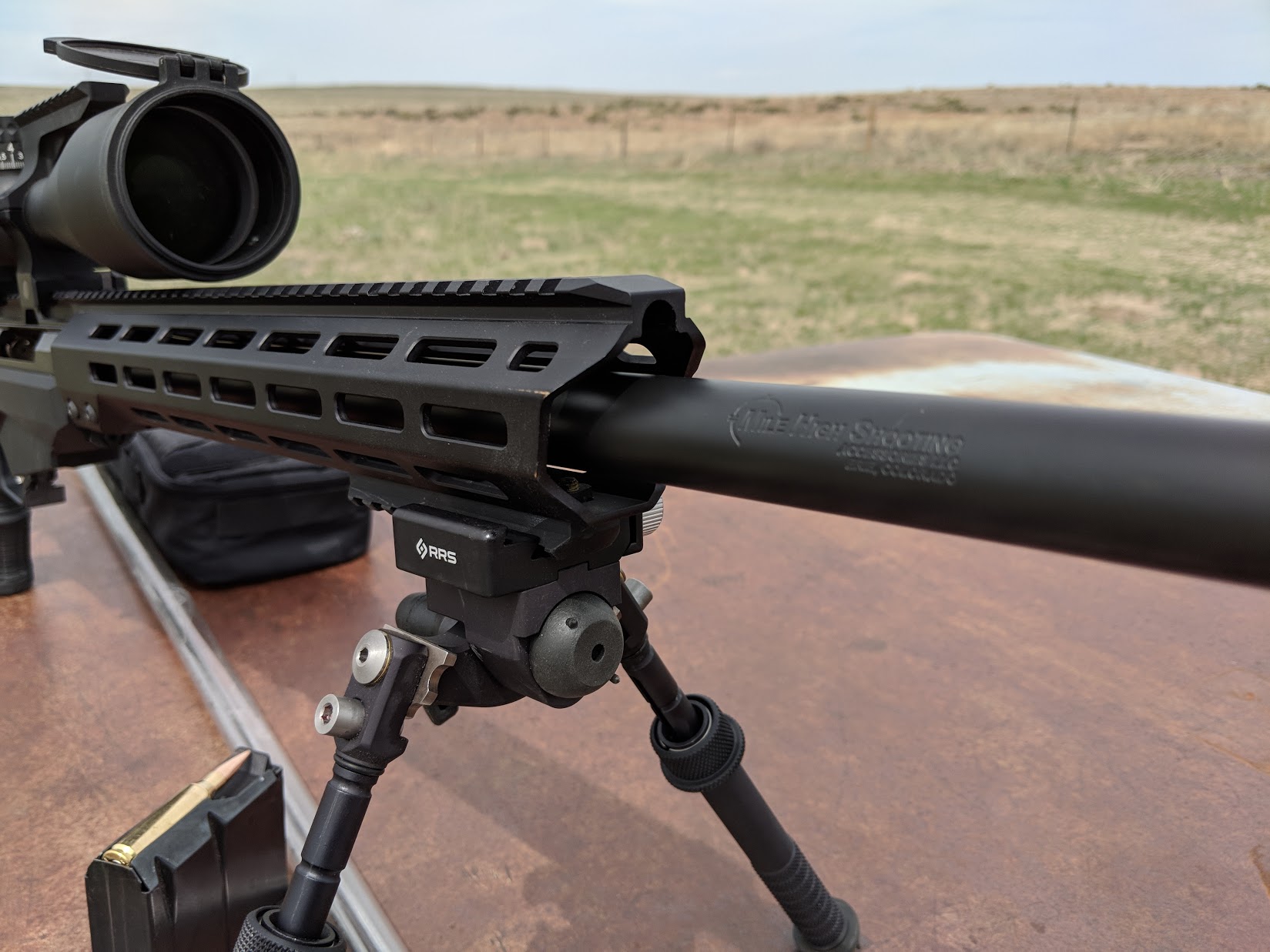

Mike @ RRS took great care of me and swapped me for a SC-LR which I’ve been using for a few weeks now. All I can say is that this thing is awesome. I’m still really happy with my BTC’s on my Harris bipods but I’ll be buying more of these SC-LR’s.
IMO these and Hawk Hill feet are a must have for every bipod.

I have two RRS BTC Pro clamps know and they are hard to tighten since the knob is so small and relatively smooth. Has anyone found an upgraded knob that fits the RRS?

SC-LR has really taken over my gear. Anvil 30, Atlas, Mini fortune cookie all running them.
I’m thinking of switching over to MPAs RAT base or the Area 419 version.
Never mind, made my own. The knob on the RRS sucks!
