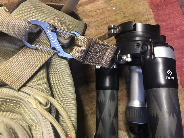

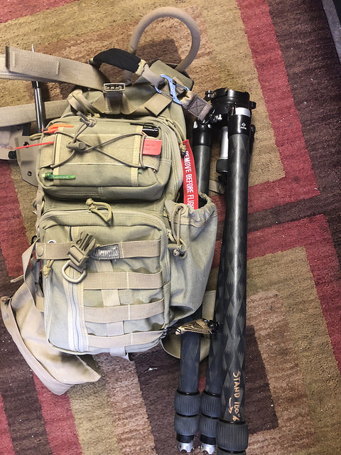

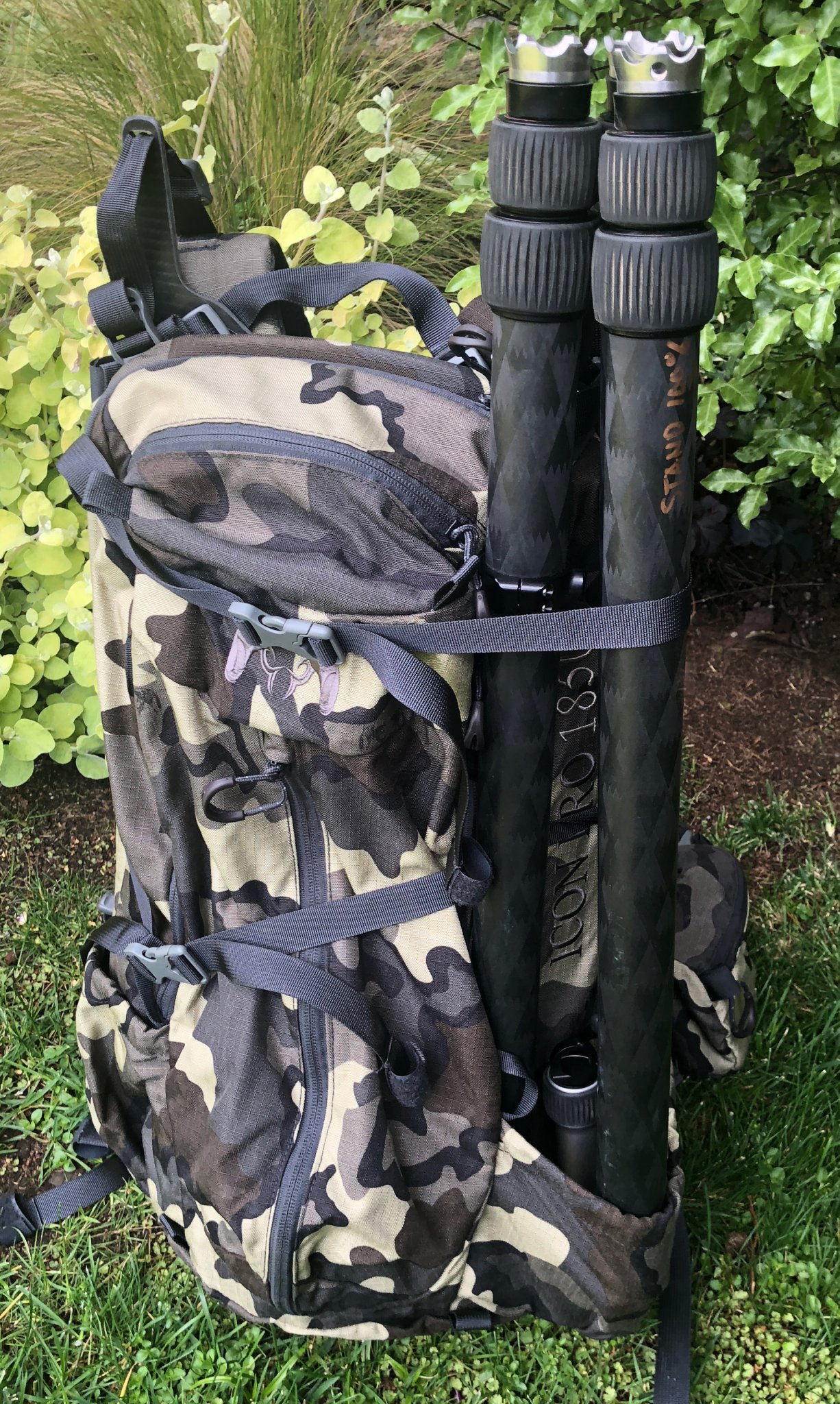

Just another fast on off carry option. I use the flush cups so that I can run it on the side of a tiny pack and still access all my pockets. It comes on and off with the push of a flush cup.
In the pocket is my 15x spotter. The front strap over my chest, my PLRF and Kestrel
I leave the attachments on the pack:
#3 S-biner https://www.amazon.com/Nite-Ize-Siz...e=UTF8&qid=1549064437&sr=1-5&keywords=s-biner
It was actually cheaper than using the tab gear attachments I had, buying a entire sling for $9.99 on Amazon. The price is gone up a bit to $13.99 still cheap. I then just cut the metal buckle off..https://www.amazon.com/gp/product/B01JA9E45I/ref=ppx_yo_dt_b_asin_title_o03__o00_s00?ie=UTF8&psc=1

Does the tripod bang around when worn like that?
Diver160651
Who cares
Belligerents
Feb 7, 2013
3,046
1,488
219
BELMONTCA
If I was Running, but not at all hiking. You can also run a strap over it..
On my bigger pack I run it upside down in a side pocket, with the top compression strap over the leg.. but might switch to just using the flush cup on that too. The flush cup on the outer most leg keeps the other legs locked in.

@Diver - I really like how your running that! I might try something like it. I strap it against the outside of my Assault 30 right now, and I have been looking for a better solution, I like the idea of the flush cups...

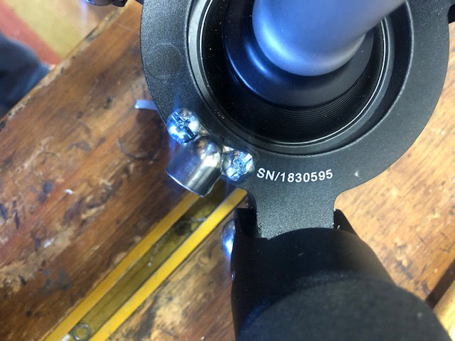

@Stpilot12
I no longer have my 3372 - can you use your calipers and post the DIA?
The only downside I see is that you'd need 2 collars as the Apex flush cup will not easily go one the Feisol apex.

@Stpilot12
Yes.... I’ll post that up this afternoon. Yeah, it would prolly be $$ but I was thinking I could run 2 collars if they fit

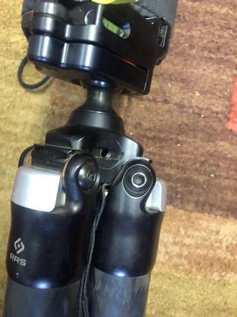

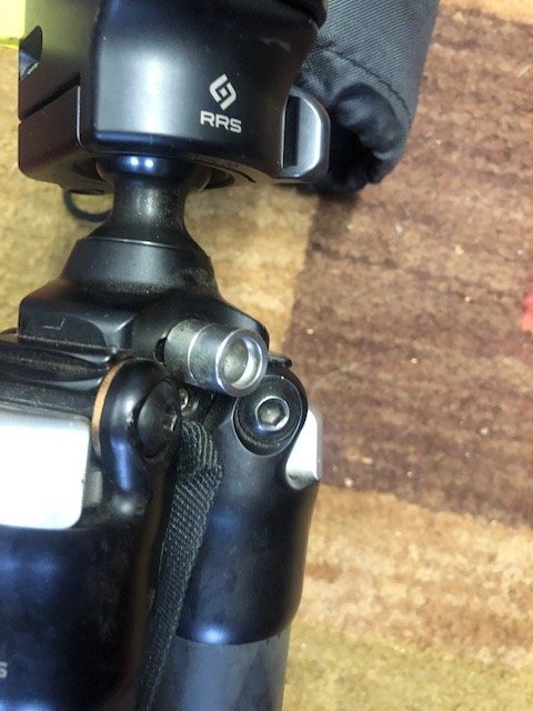

Just wanted to add a couple things I've received a few PM's on using the flush cups.
  1. The Flush cups are available on the RRS website.
  2. For the leveling base, you want this set. Note in the images below that you can make it work not only on the RRS TV33/34, but also the 3372 if you are willing to tap 2 10/32 holes. http://soar.reallyrightstuff.com/RRS-Pod-QD-Strap-Set?quantity=1&custcol58=1
  3. Yes they are also available for the Anvil 30 but you need these two items.
    1. QD Mont for the Anvil 30 Apex http://soar.reallyrightstuff.com/QD-Mount-for-TFCT
    2. Leg Collar for the #3 series (assuming you have the #3) http://soar.reallyrightstuff.com/RRS-Pod-QD-Collar
The Anvil 30 mounts on the side vrs the bottom of the leveling base's Apex. The leg collar is as previously shown.
For the 3372 - You need to drill and Tap 2 10/32 or a course thread will work like this.
Below is the Series 3 collar on the 3372 legs without modification:

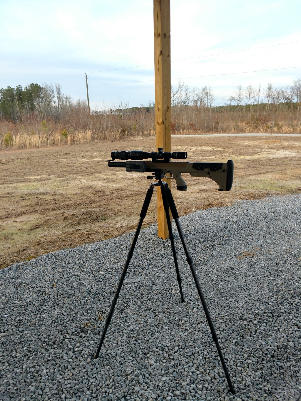

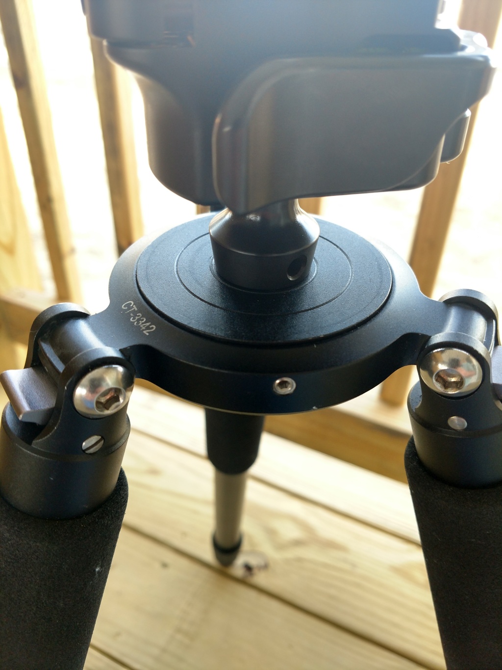

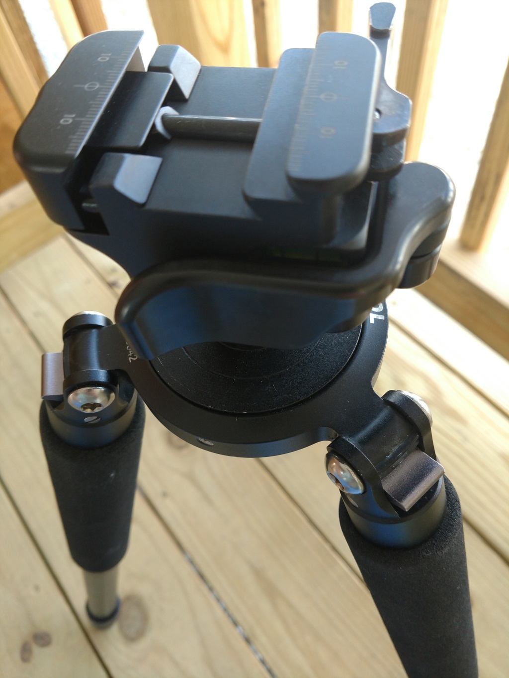

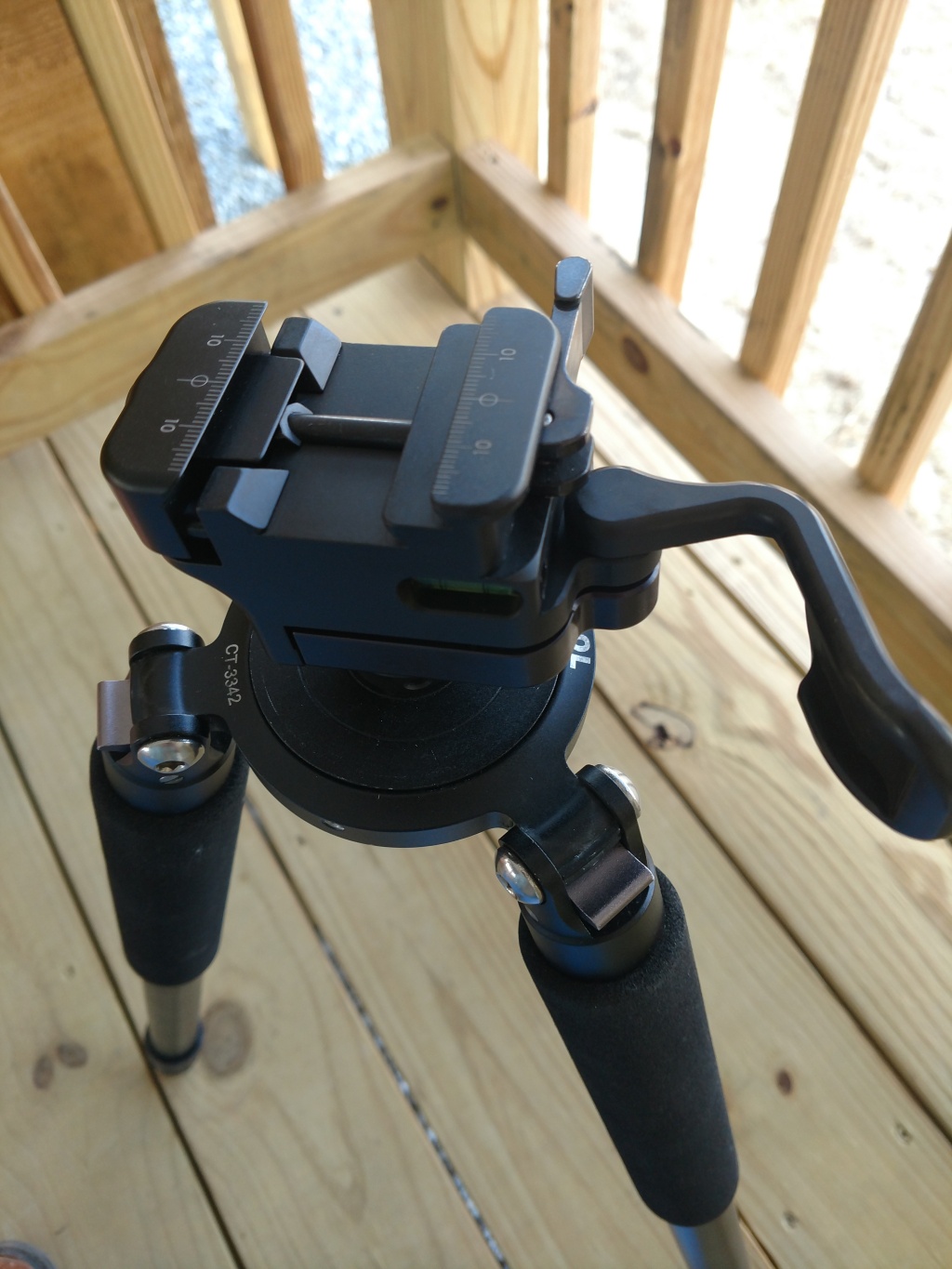

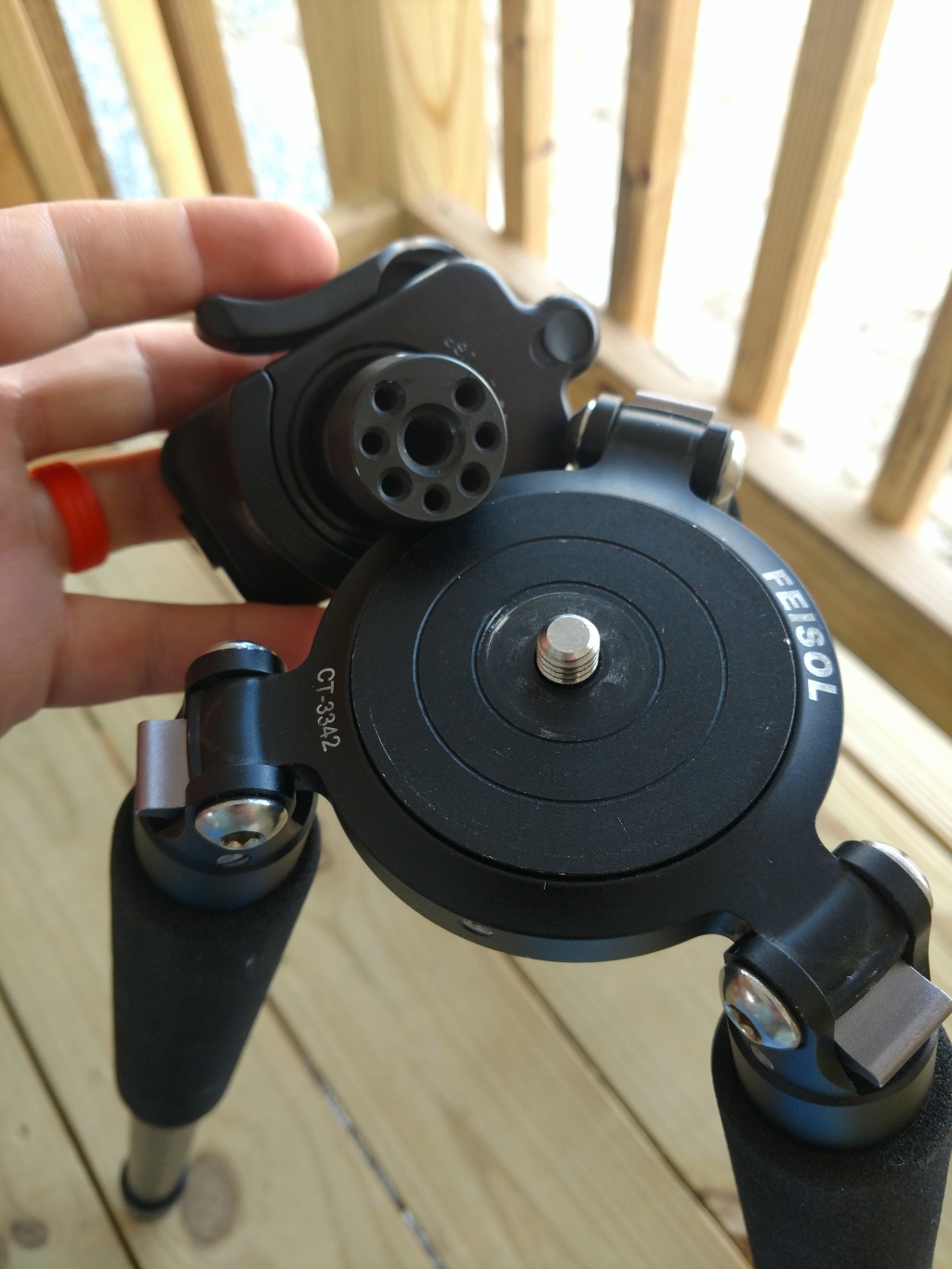

Here ya go @Diver160651
Anvil just screwed directly into the feisol base
There are some other threaded holes around the 3/8 (these are how they attached to the RRS adapters is my understanding after talking to Michael over at RRS), but they are too close to get something into from the bottom in my case I believe

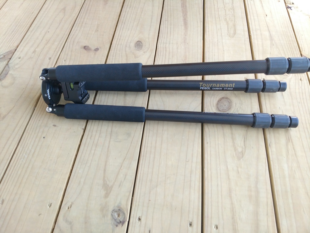

Unit folds up onto itself and still fits in my bag as wellIMG_20190128_165631.jpg
Somewhere along here is about where I'm running it for tension when using it
So when I want to mount it into the tripod or take it off I just clamp it completely down like below, and use the rifle to gain leverage to tighten and loosen.
I have not accidently taken it loose yet, not even close. I might tomorrow though... But disclaimer, I'm not all high speed low drag fighting from rooftops or PRS on a clock... I just like to shoot stuff and hunt a little bit
Unit folds up onto itself and still fits in my bag as wellView attachment 7013509
Nice - I do not have my 3342 anymore any chance you can measure the apex plate when you get a chance. Your post is answering a lot of PMs I've had - so I am sure somebody will be grateful.
Thats one light setup!
I think I know what you are after and the question is what led me to speak with Michael at RRS, he was incredibly helpful in comparing measurements to the RRS bowl options compared to the Feisol.
If you are thinking what I believe I can confirm simply there is no bowl option even remotely close for the smaller Feisol.
If you are after something else, I will try to get all the dimensions I can if you let me know what you are thinking
