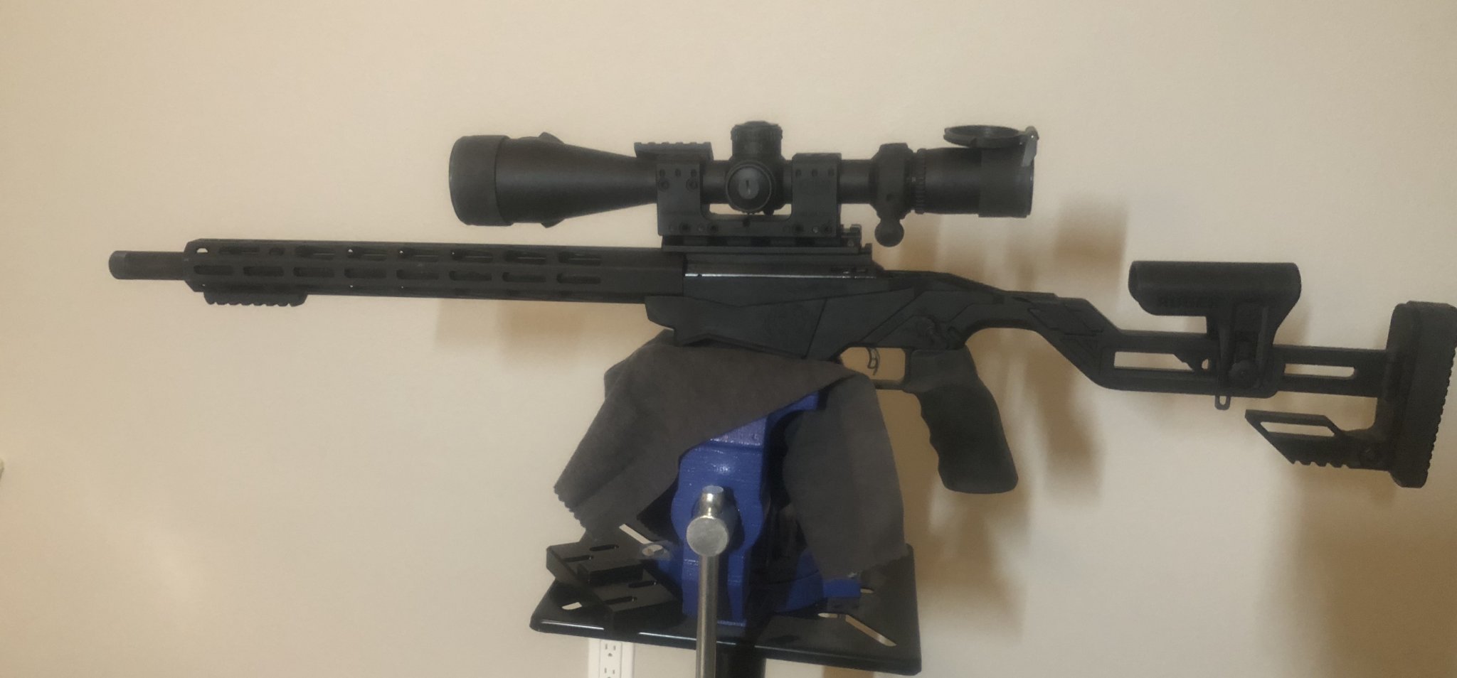

I recently finished my dedicated 22lr upper receiver to mimic my .223 they both shoot tacks and i couldn't be happier with how it turned out
Aero precision upper
Midwest industried keymod handguard
JP enterprises bolt and 18" match barrel
Rise Armament 3.5 flat blade trigger
vortex crossfire II with burris PEPR mount
Bettermag 15-22 magazine adapter
rpr stock

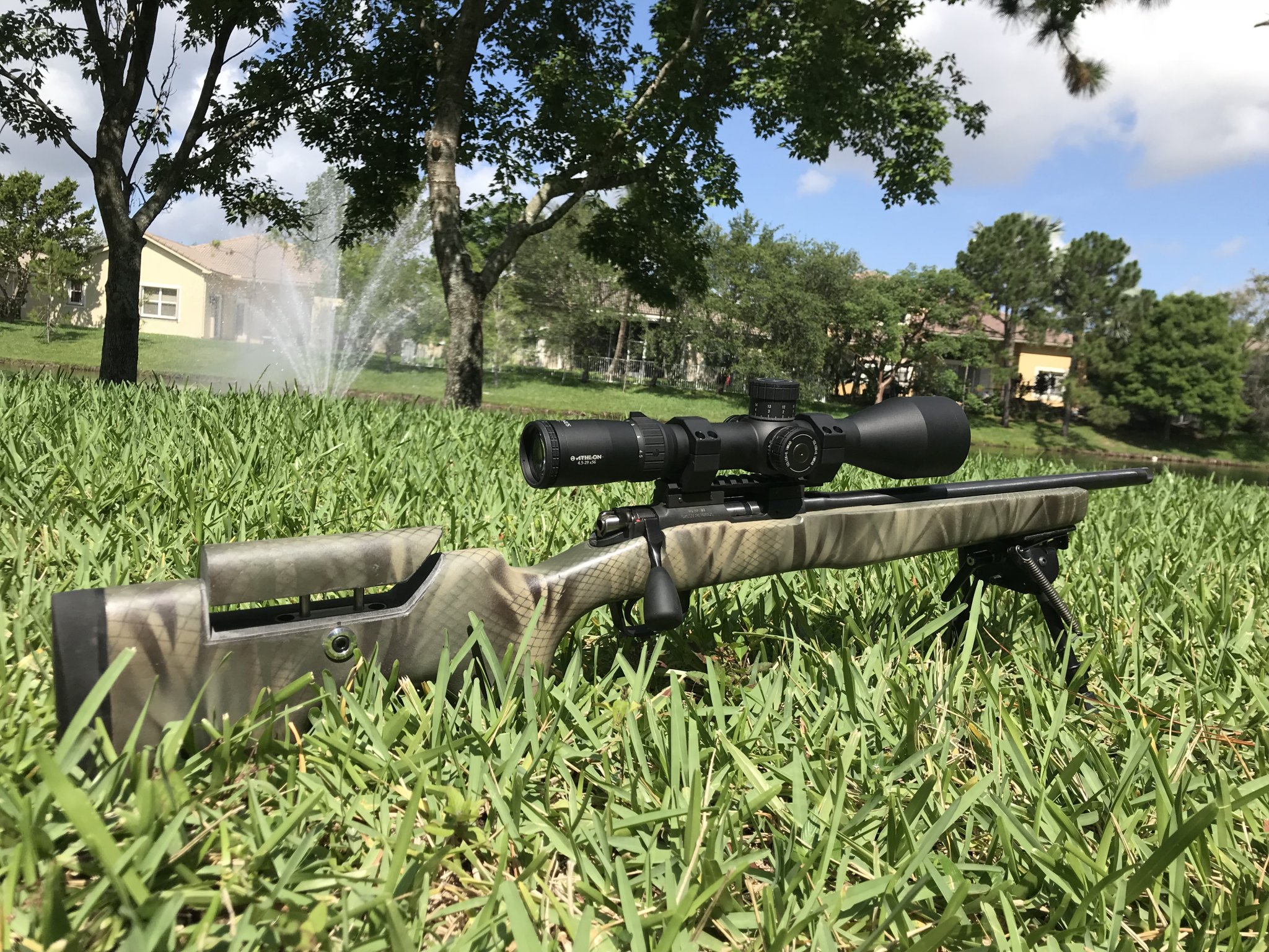

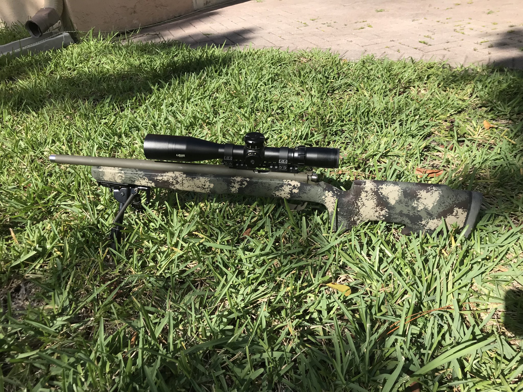

My fun rifle, CZ 455 with boyds stock, bedded, pillared, oversize knob, EGW 0 Moa base, SWFA 3-15 FFP. Works great for the local 35-200yd monthly steel match.
Old paint scheme over a OD green cerakote base. Didn't like so wiped it off with acetone and elbow grease, want to do a true to era vietnam horizontal tiger stripe pattern next.

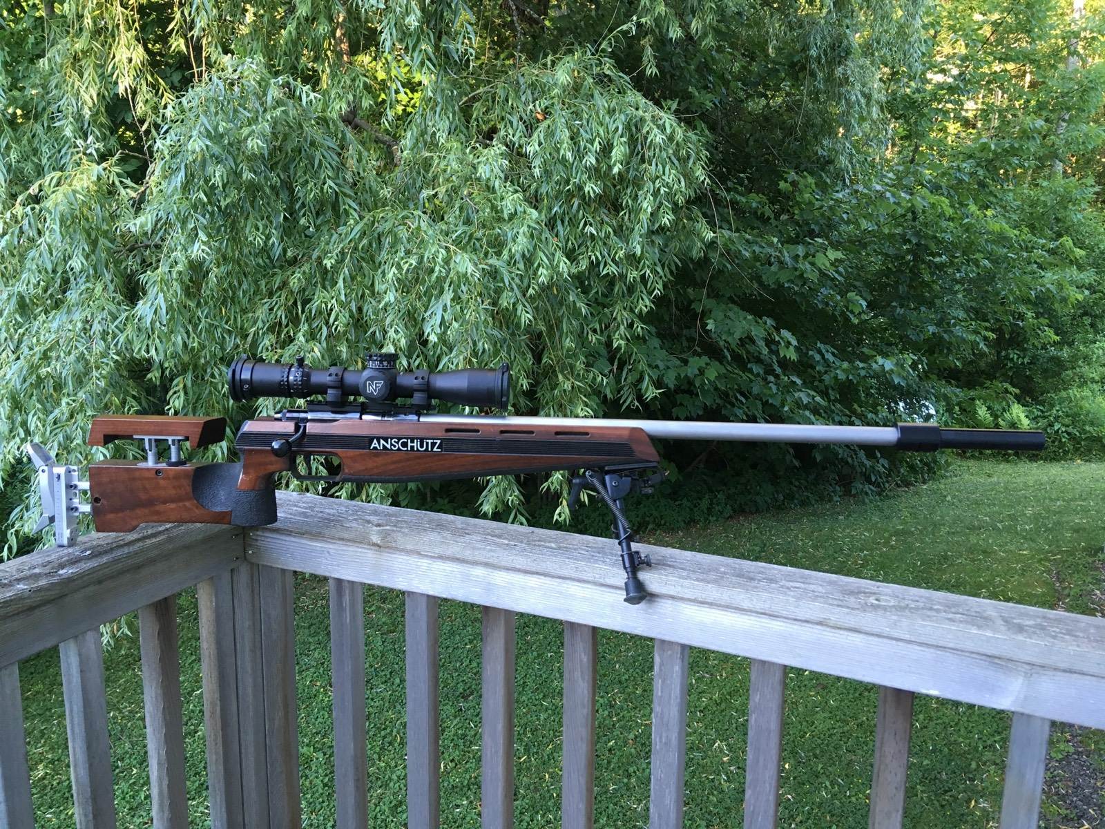

Not a prs style for sure, but it is accurate. ARA benchrest rifle for this summer, a 1960's british BSA Martini International MKII falling block single shot. Barrel on this thing is 1.200" at receiver and is 28" long tapering to .870". Rifle weighs 14lb 3oz in this config.

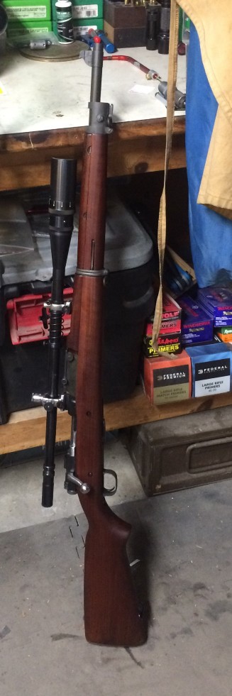

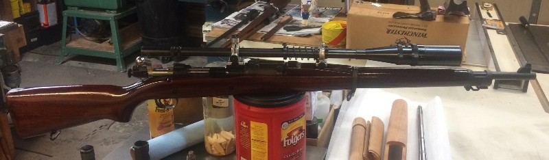

1903 Low Serial Number receiver with custom insert for M22 mags, M2 bolt.
Douglas Barrel, 16 twist
Timney 1903 trigger group
Minelli S.P.A Walnut stock w/USGI Hardware - final inletting bedding done with barreled action
Earle mounts
scope was a loaner, but will wear a 16 or 20x 1.5" calibrated head Unertl.
Lots of hand fitting and adjusting to get it right. This is no ISO9000 affair, but I love it. Only 7 of these are being made, split between single shot.20180328_184824-327x981.jpg

That's cool as hell man!
How does she shoot?
Tim said it holds an inch with SK standard. I haven't shot it yet. He work on it an extra week to get the firing mechanism consistant. I cannot wait to get my own scope and get it on the range.
Here it is with the oil getting layered.

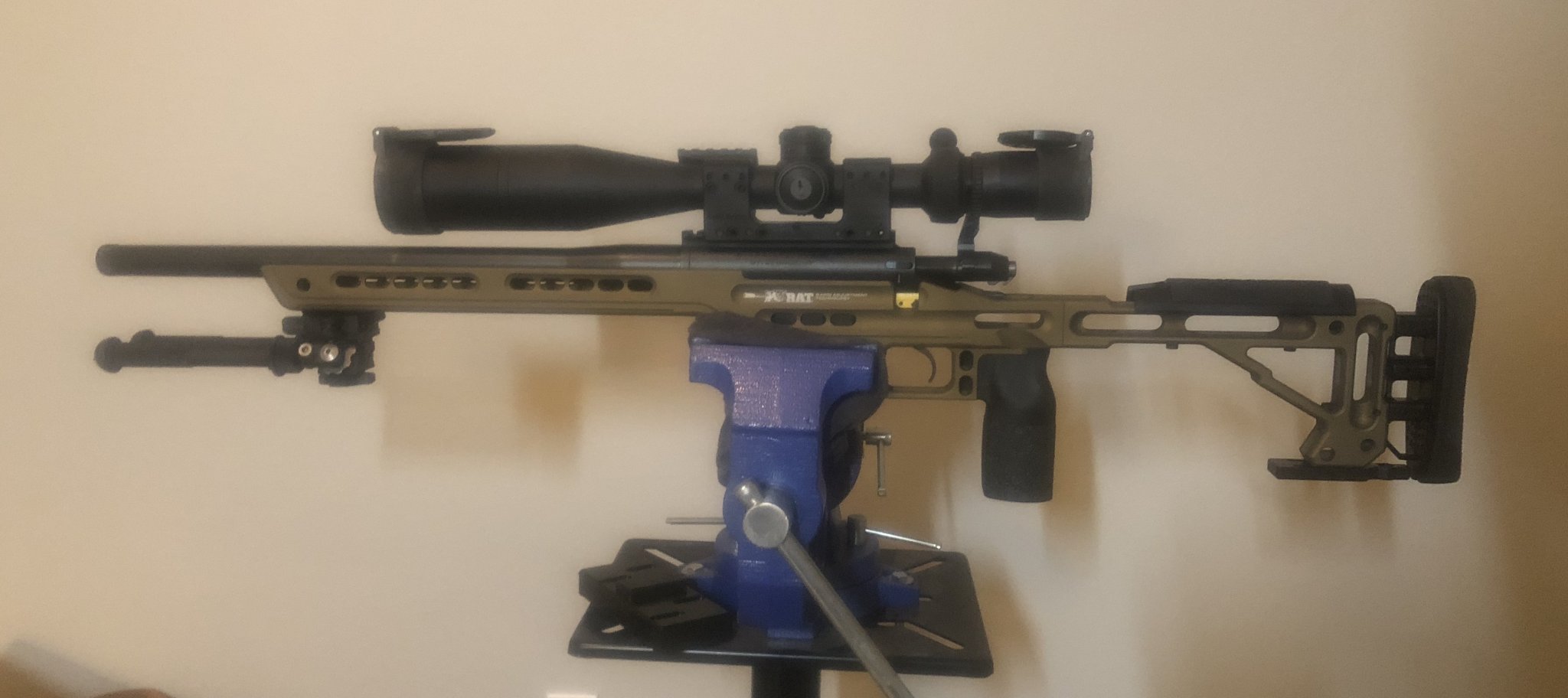

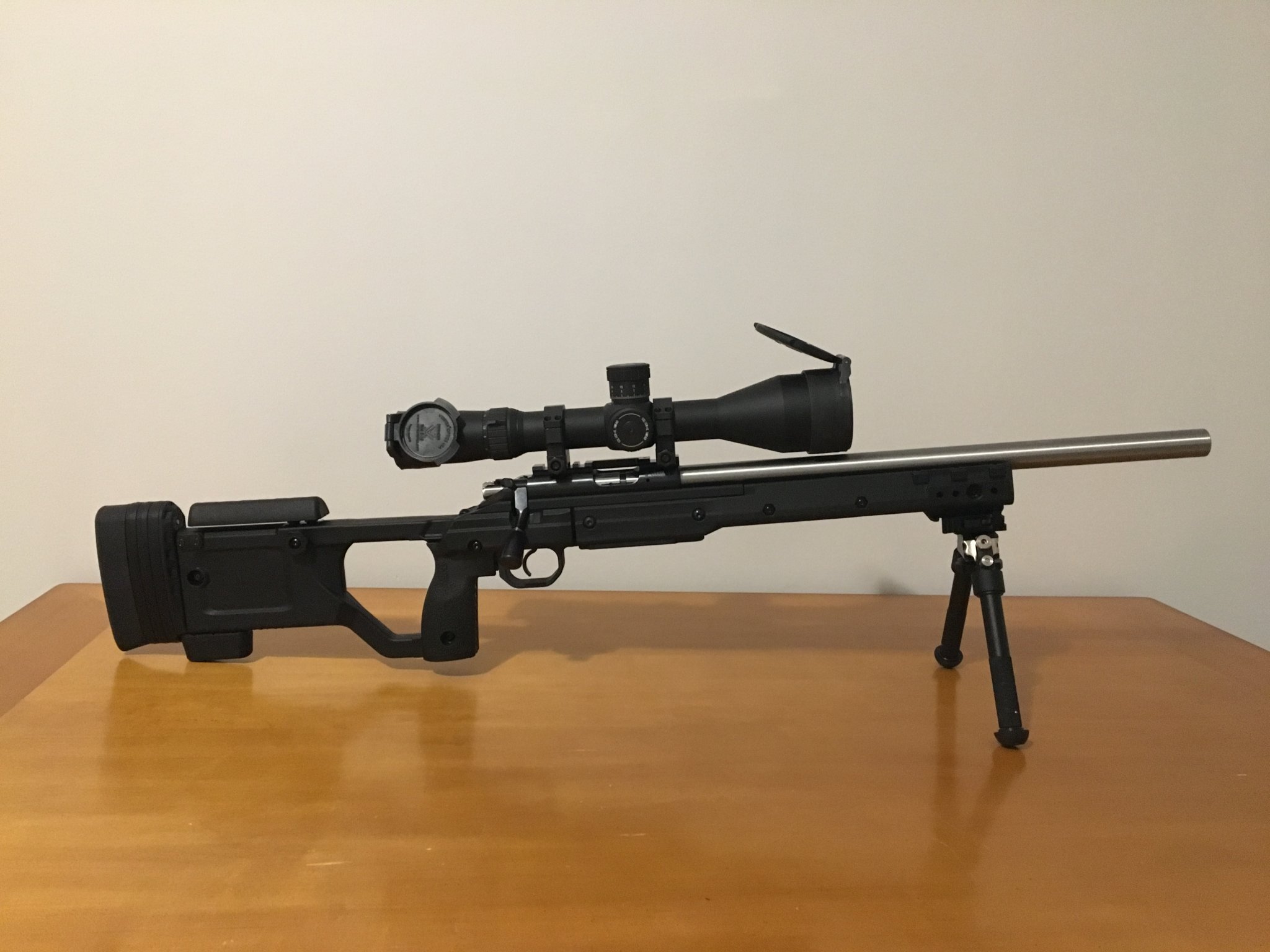

Kidd receiver and 20moa rail
Kidd 16.5" threaded barrel.
Kidd threaded pins, take down screw and Vblock
Kidd trigger in factory housing (2lb)
Kidd bolt, charging handle and spring
Boyds ProVarmint with steel bedding block and pillar.
PA 4-16FFP mil/mil

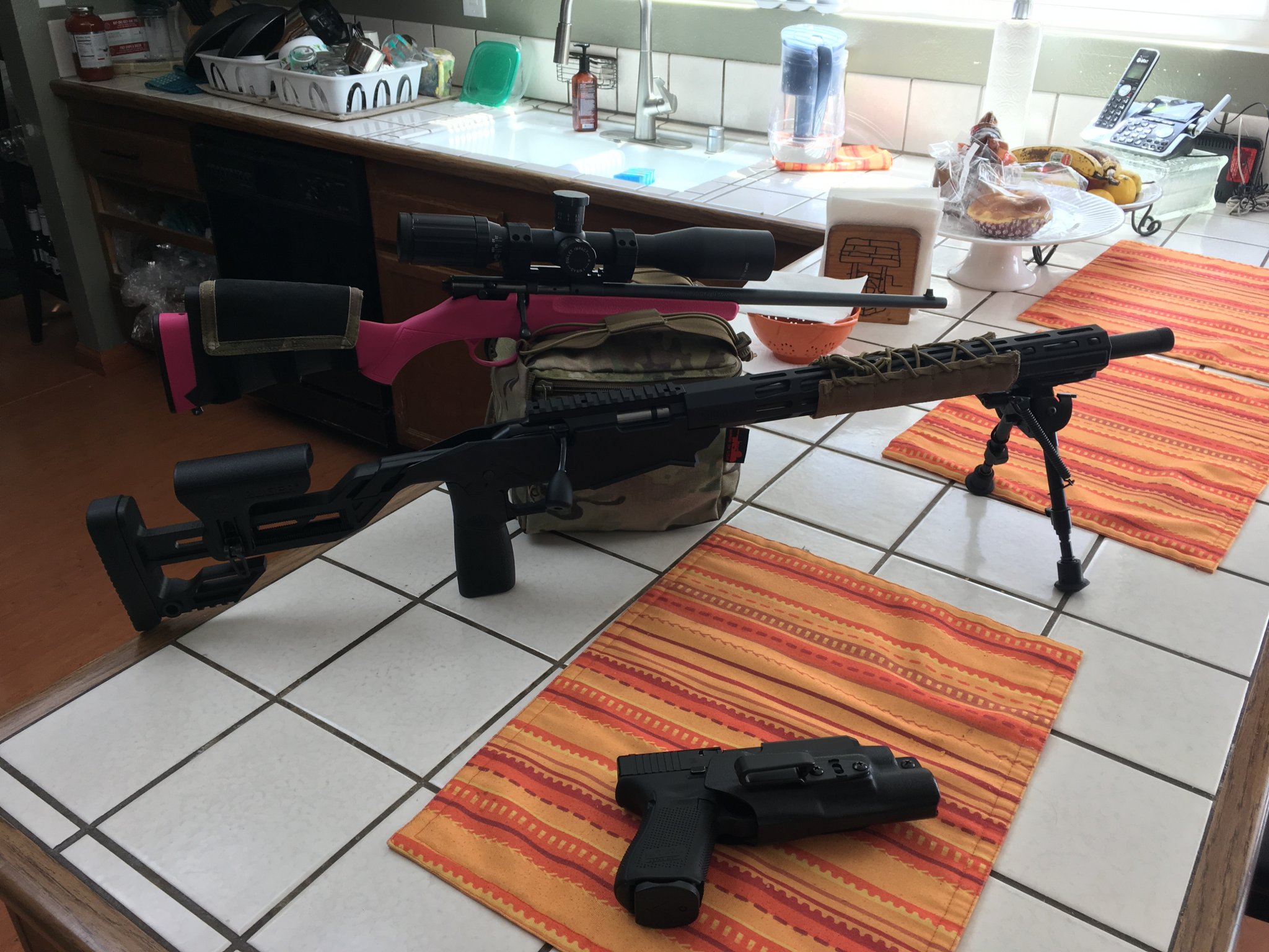

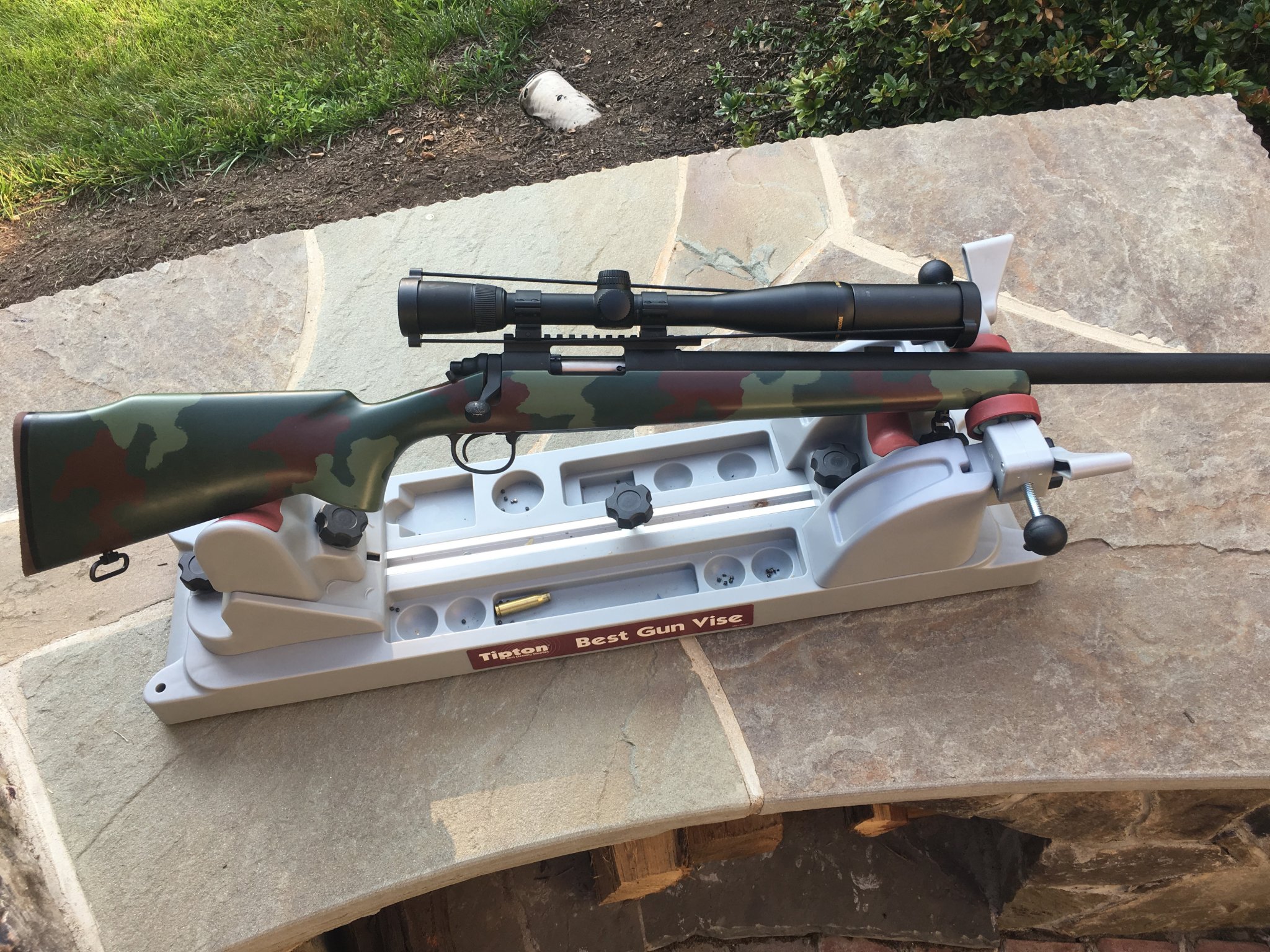

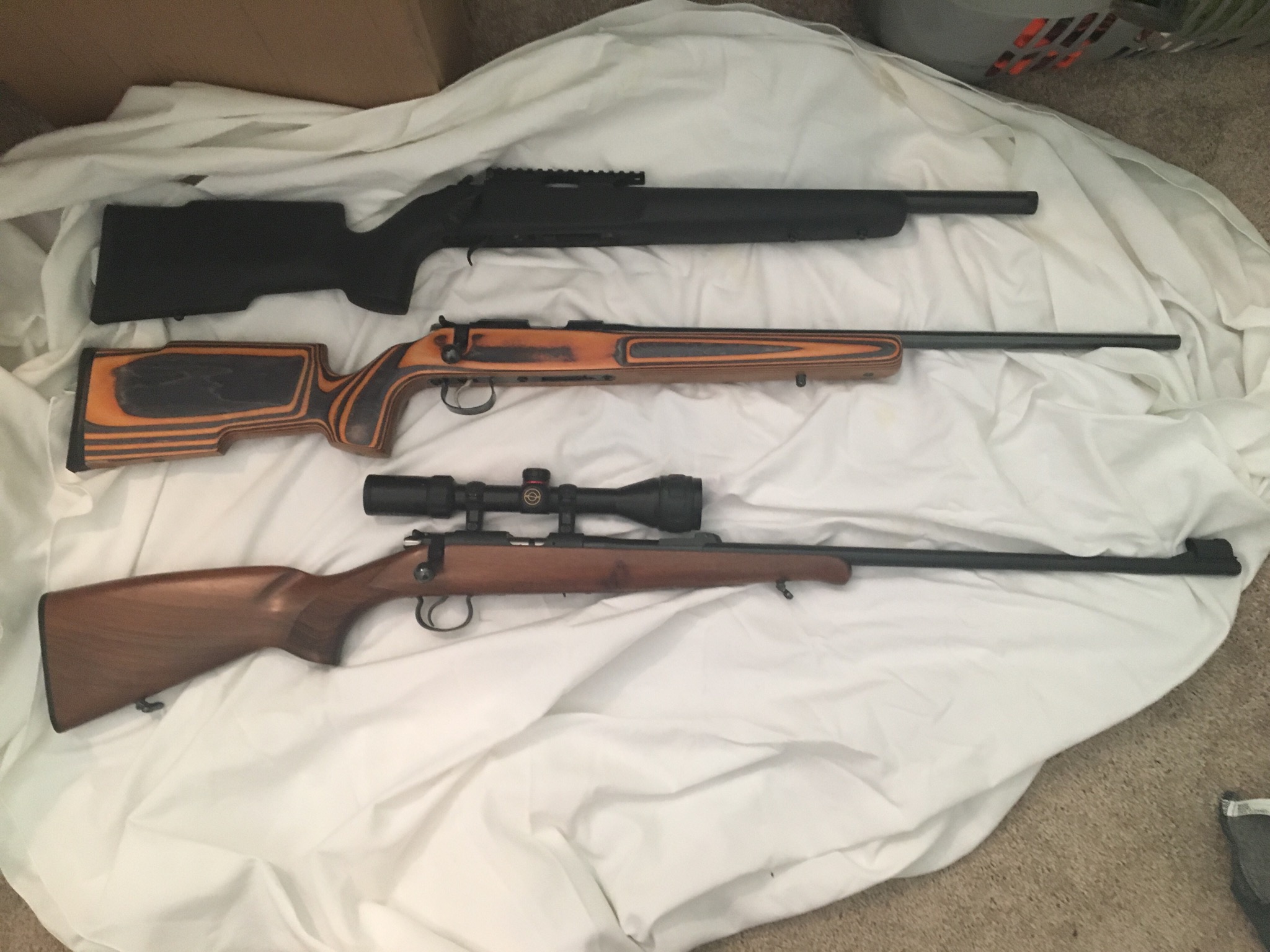

Well, the day after I got the CZ 455 I decided to work on the paint job. I love the stock, hated the look... So I went with a brown camo base (flat brown rusto) and dabbed some tan, black, white, grey and brown/orange on top... followed by 3 coats of matte clear (it's a little reflective, but at the range I don't have to worry about actually being camouflaged)

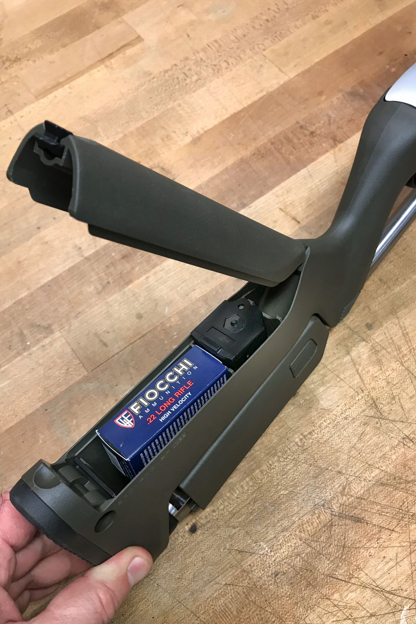

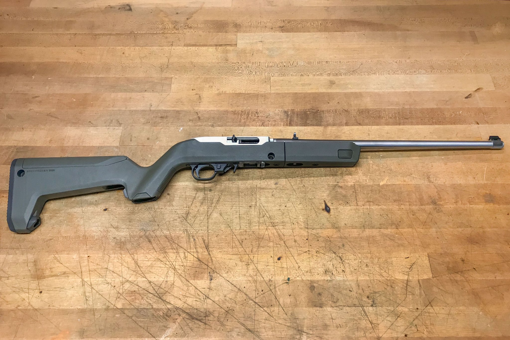

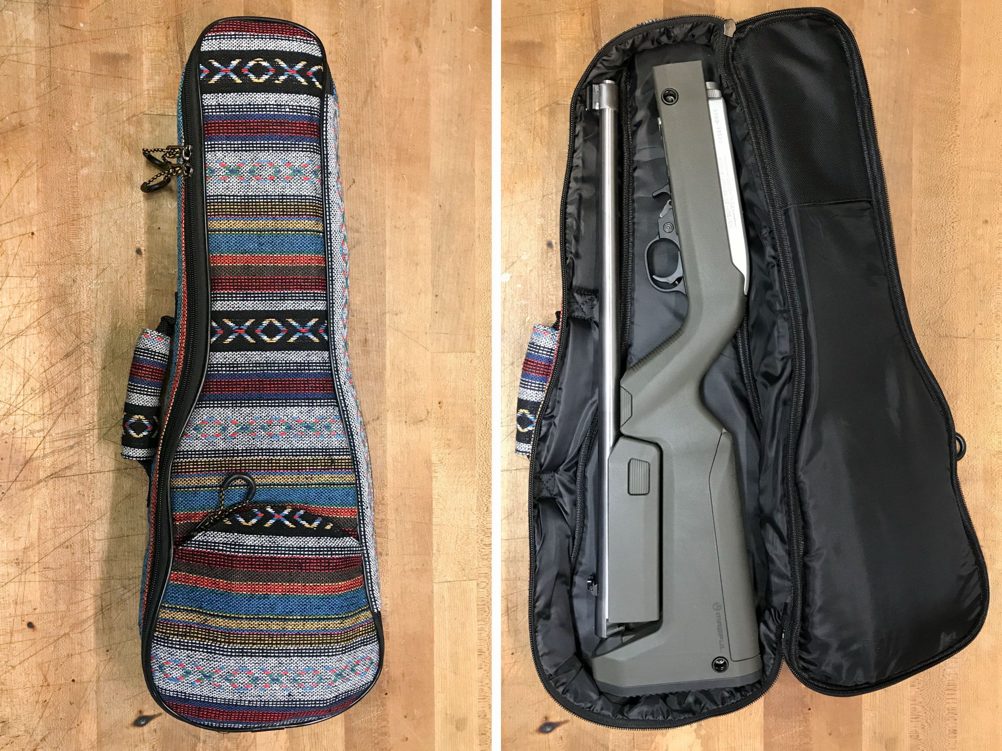

Ruger 10/22 Takedown in a Magpul backpacker stock inside a cheap eBay case. Buttstock holds a couple magazines or a mag and a 50 box of ammo. I don't use it much but I like it for what it is. Magpul's mass market engineering continues to impress me. Ruger continues to unimpress me but I'll be damned if I'll spend $1500 on a 10/22. (I did upgrade the trigger and shock buff thing.)
20180424_ruger1022backpackerriflegun_0517.jpg20180424_ruger1022backpackerriflegun_0518.jpg
Would love to find a convenient way to put a fiber optic sight up front but so far everything seems like a PITA. It's a fun plinker and when the Zombiocrats take over I can hunt wabbits.

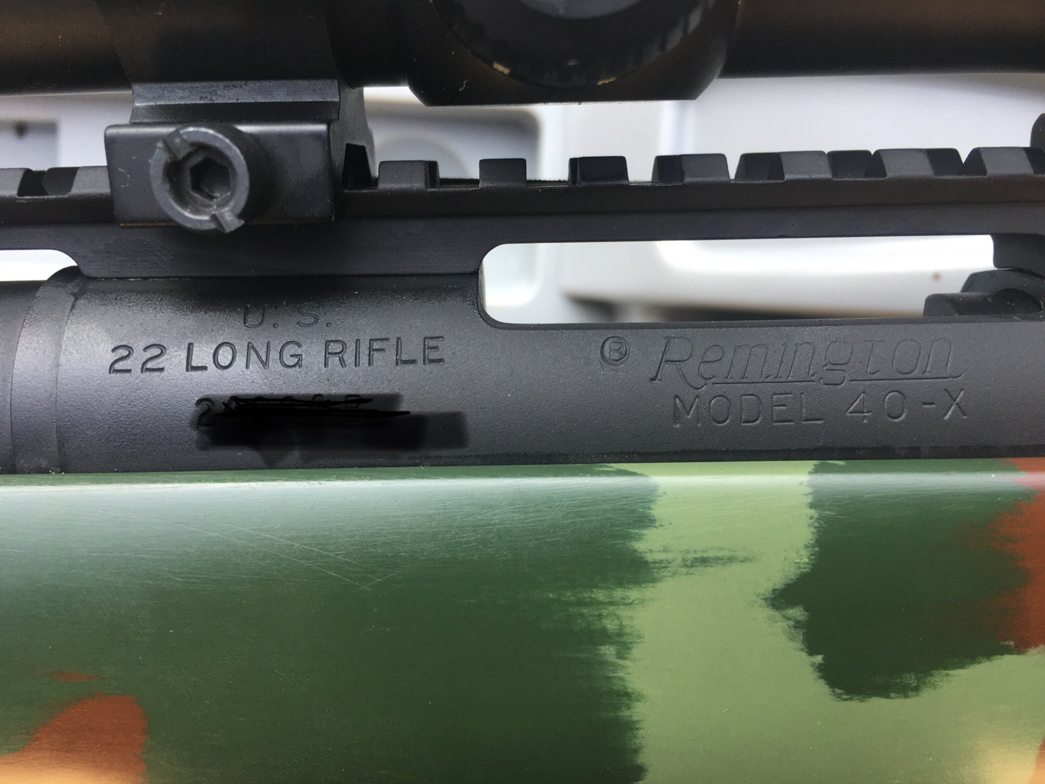

I have a 40X from CMP, PT&G bolt, and AICS stock + suppressor. Wolf match ammo has been a good round for this setup. I've since changed the Harris bipod out for an Atlas.
I've seen this rifle before. Probably THE sexiest rifle I've ever laid eyes on.

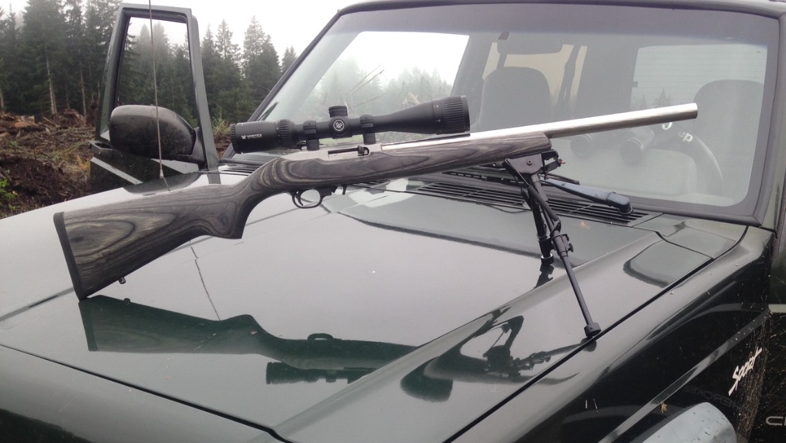

Here's mine. Ruger 77/22, Boyds Tacticool laminate, StraightJacket barrel system, Nikon 4-12, added flush cups (pretty sure I found the idea here), badger bolt knob, bolt shim, tuned trigger. Shoots like a dream20170520_182452.jpg20170520_182436.jpg20170520_190205.jpg

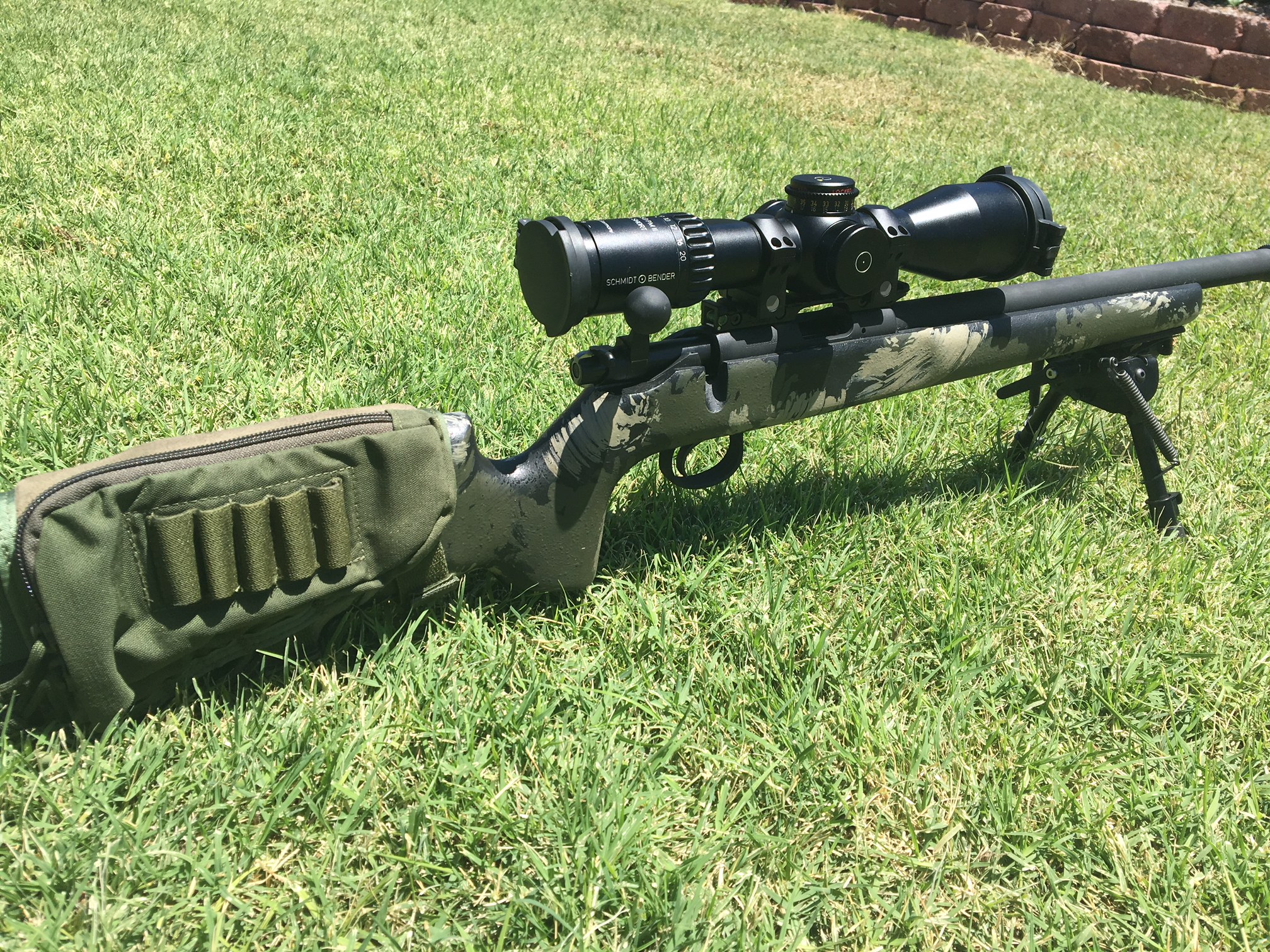

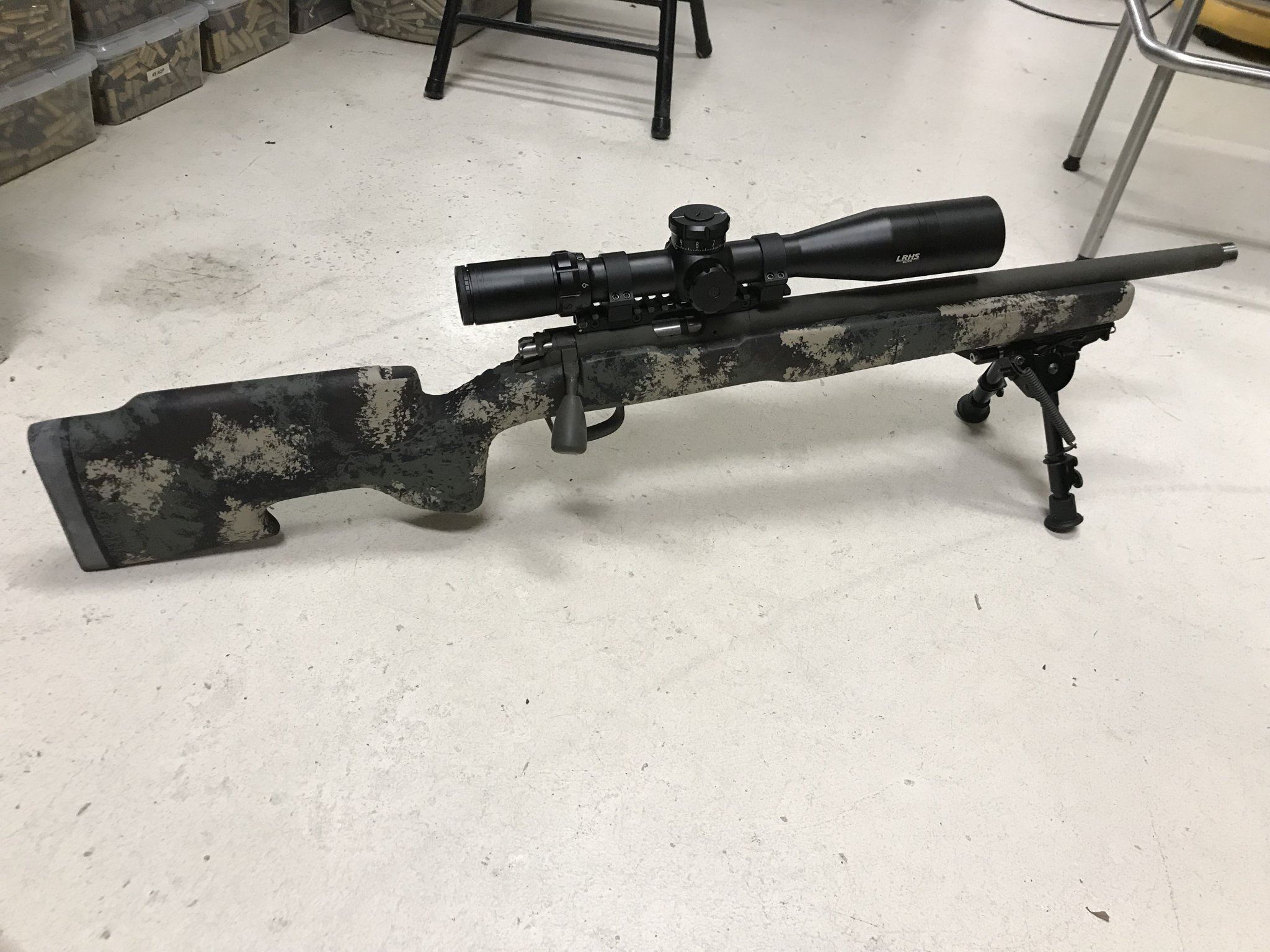

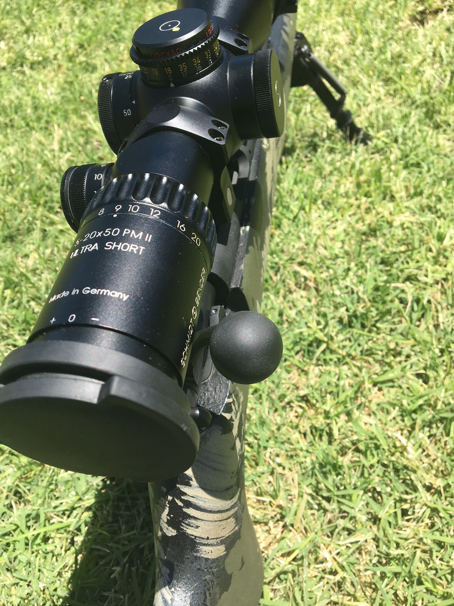

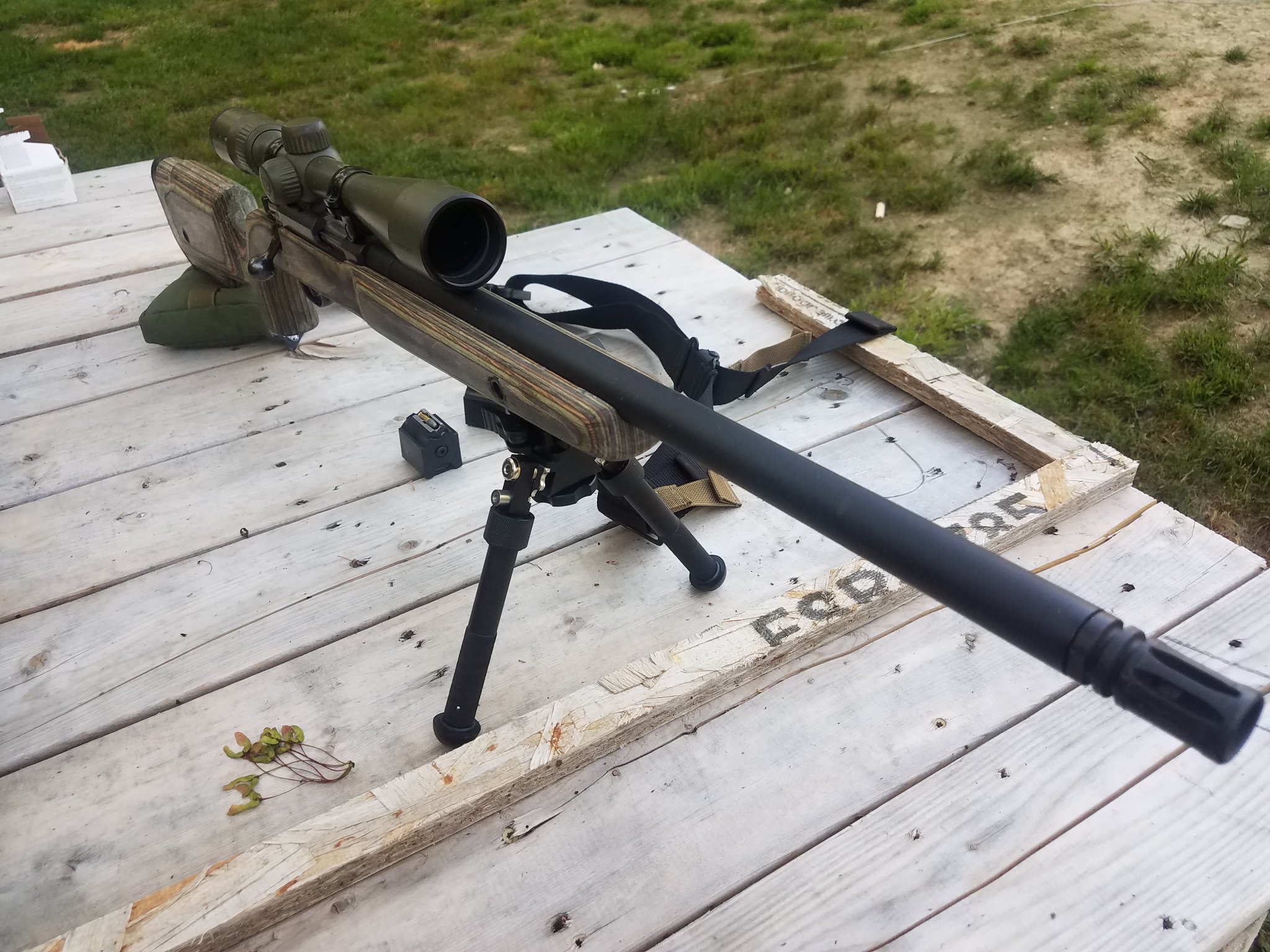

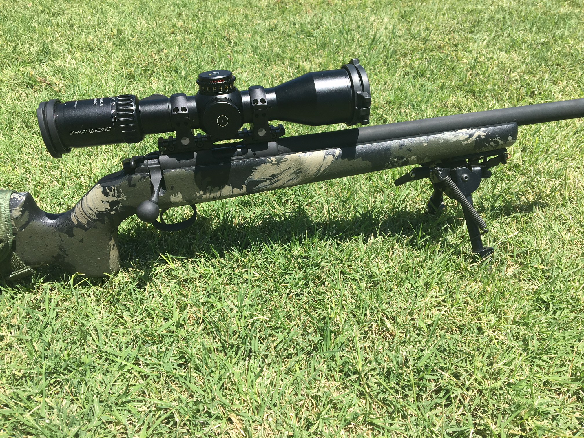

Here is my CZ 455. It started as a varmint model. I did all the upgrade work myself.
Boyd's stock, pillar and glass bedded with Krylon camo sponge paint
Lilja 16.75" barrel
DIP bottom metal and steel mag box
Yo Dave trigger kit
Area 419 rail, trimmed a bit shorter for the S&B Ultra Short
Armor Black Cerakote
Anarchy Outdoors bolt handle
PTG round bolt knob
Triad Tactical stock pack

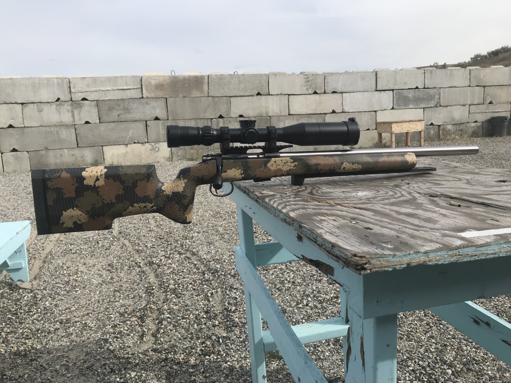

Orange, CT

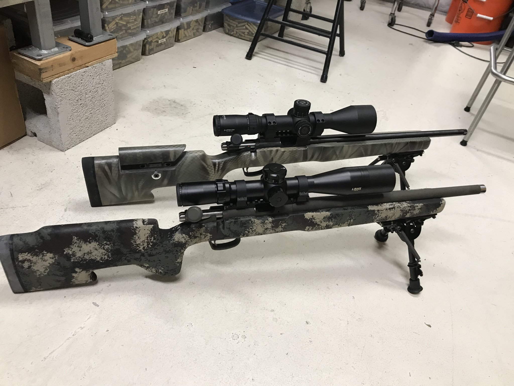

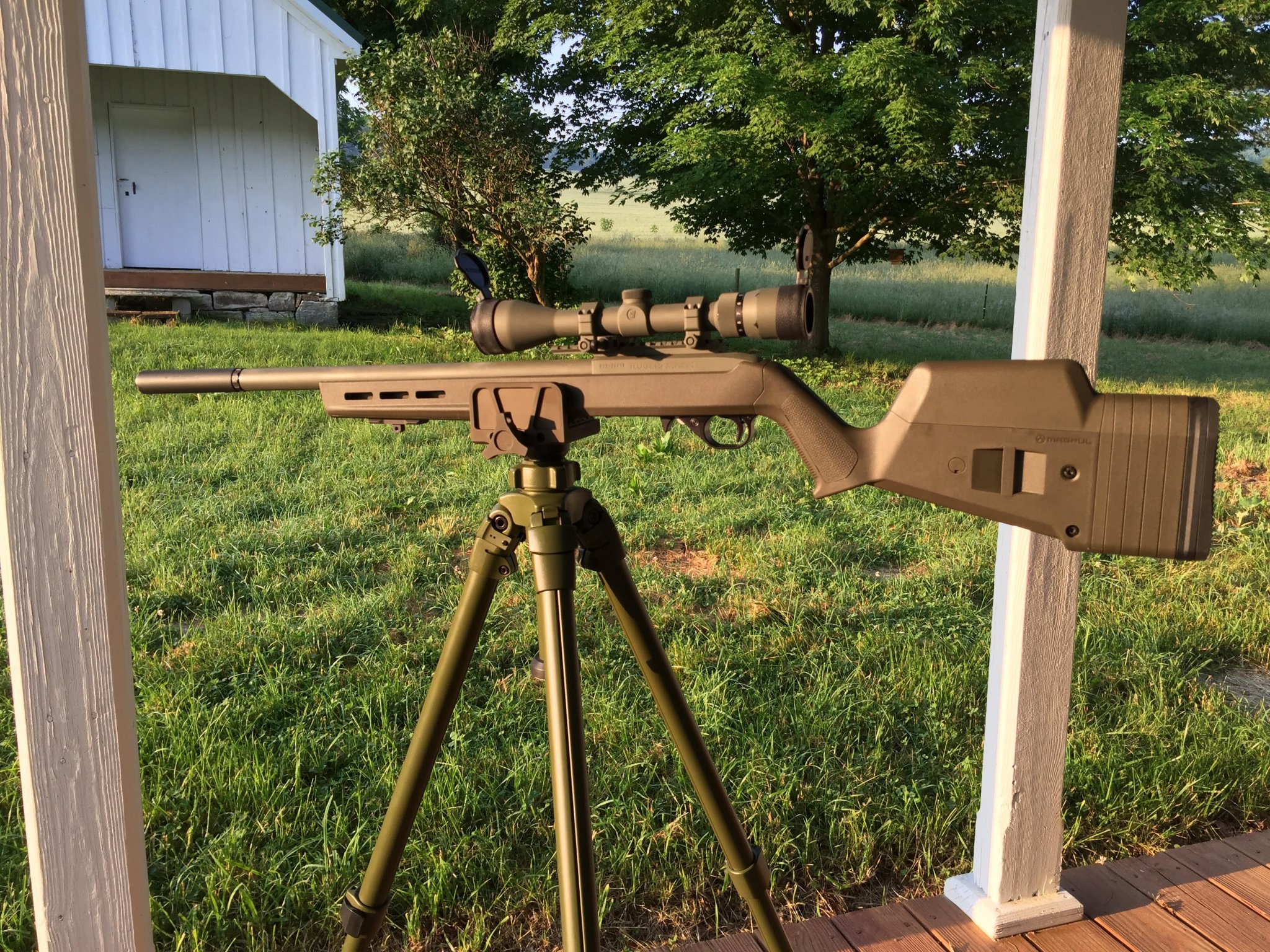

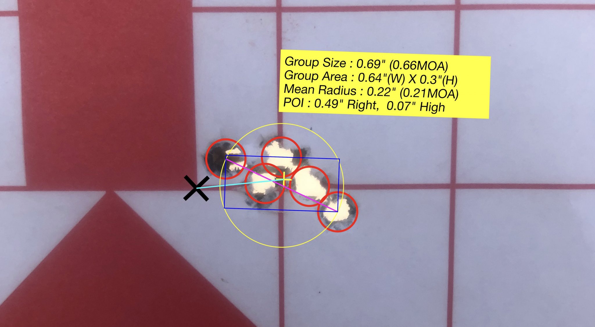

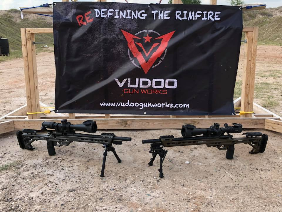

Ruger receiver ... everything else mechanical is from Kidd including 18" stainless barrel. Two stage trigger is simply amazing. Scope is an Athlon Ares BTR in Seekins rings. Aerosol DuraCoat OD green on all metal. Chassis is the new McRees. Shoots amazing and runs 100%. Group pic is at 100 yards ... no wind this morning so it went really well. I have a tricked out CZ 455 with a Lilja barrel too and this thing easily shoots as well.
Rifle in the back is a TRG in 6.5 Creedmoor built by SAC ...

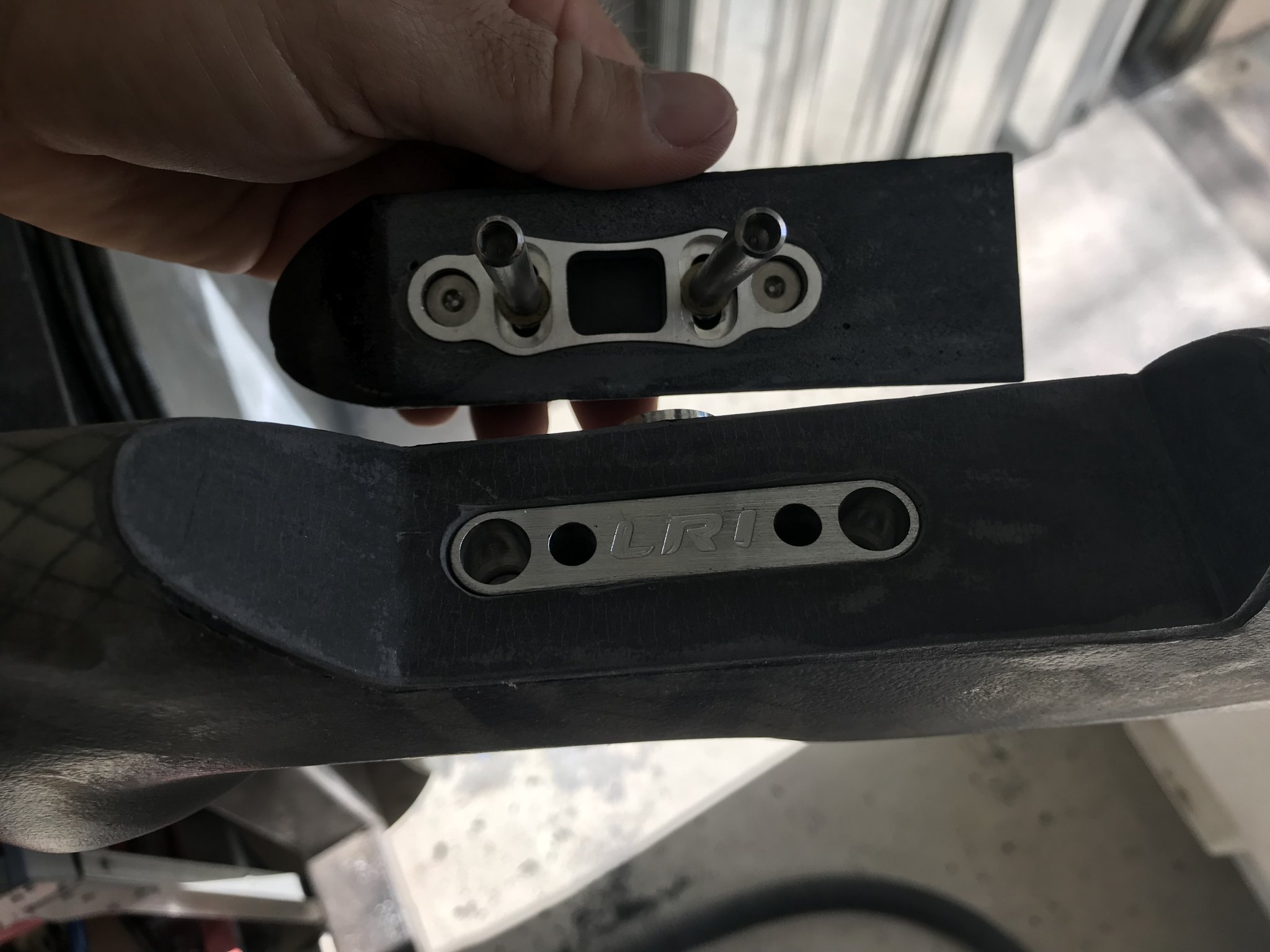

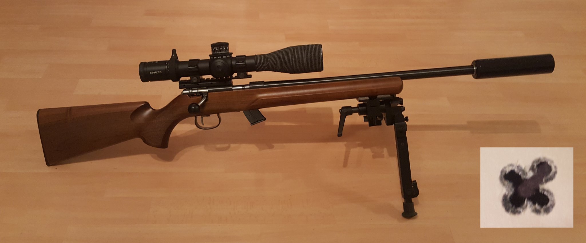

Here's my CZ 452 22lr. After installing Cronus 4.5-29x56 on EGW HD 20 moa with 34mm Seekings low rings I couldn't see through the scope without raising my cheek off the stock so I've installed LRI's cheek riser (found in classifieds) to remedy the problem. It turned out great for a garage hack and a 1/2 days work.
How did you cut the stock ?
