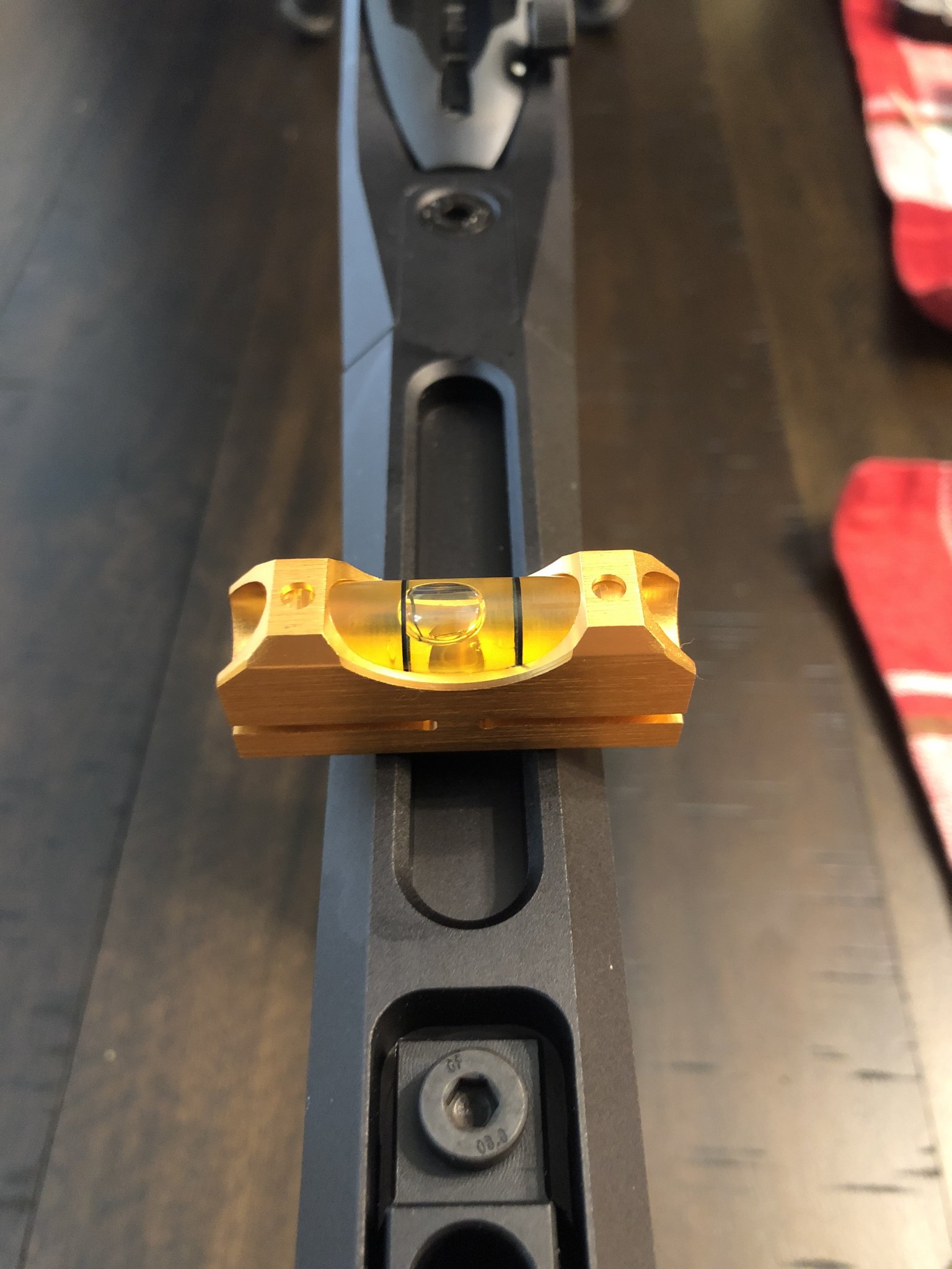

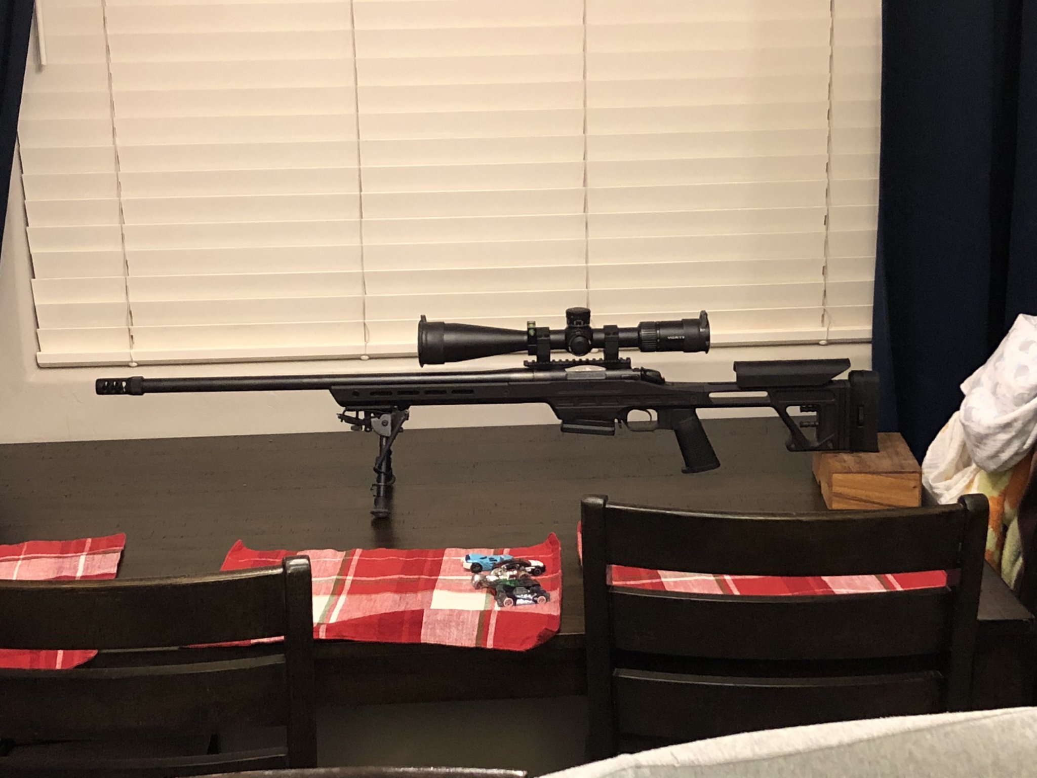

Mounted the bipod to assist level the gun. Raised the rear and leveled off the rear of the stock.

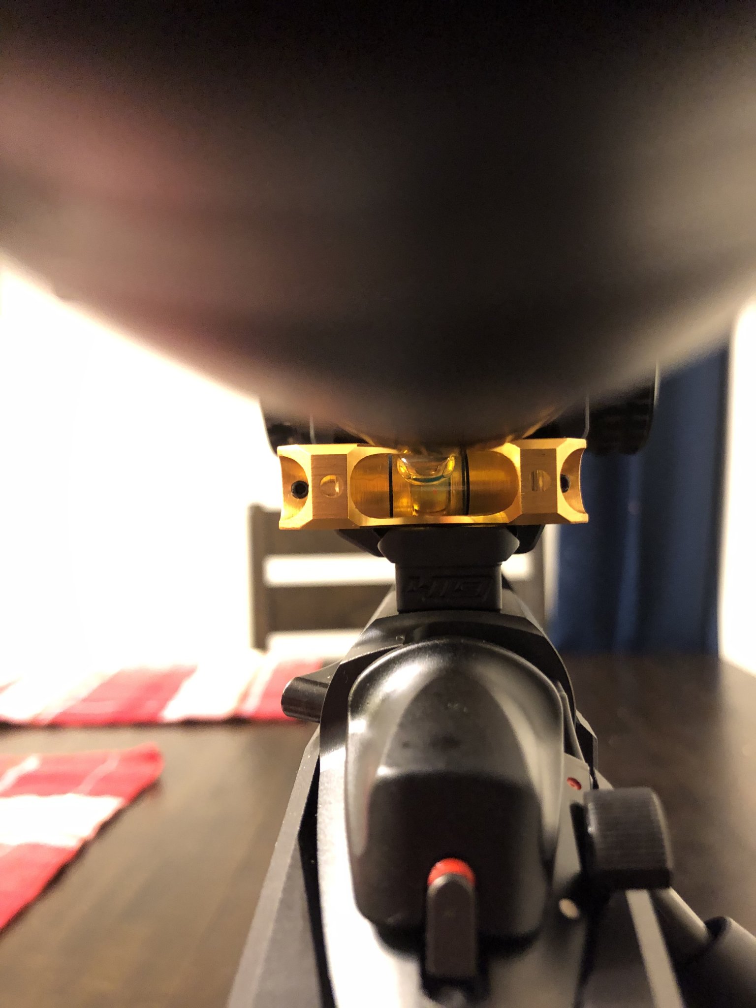

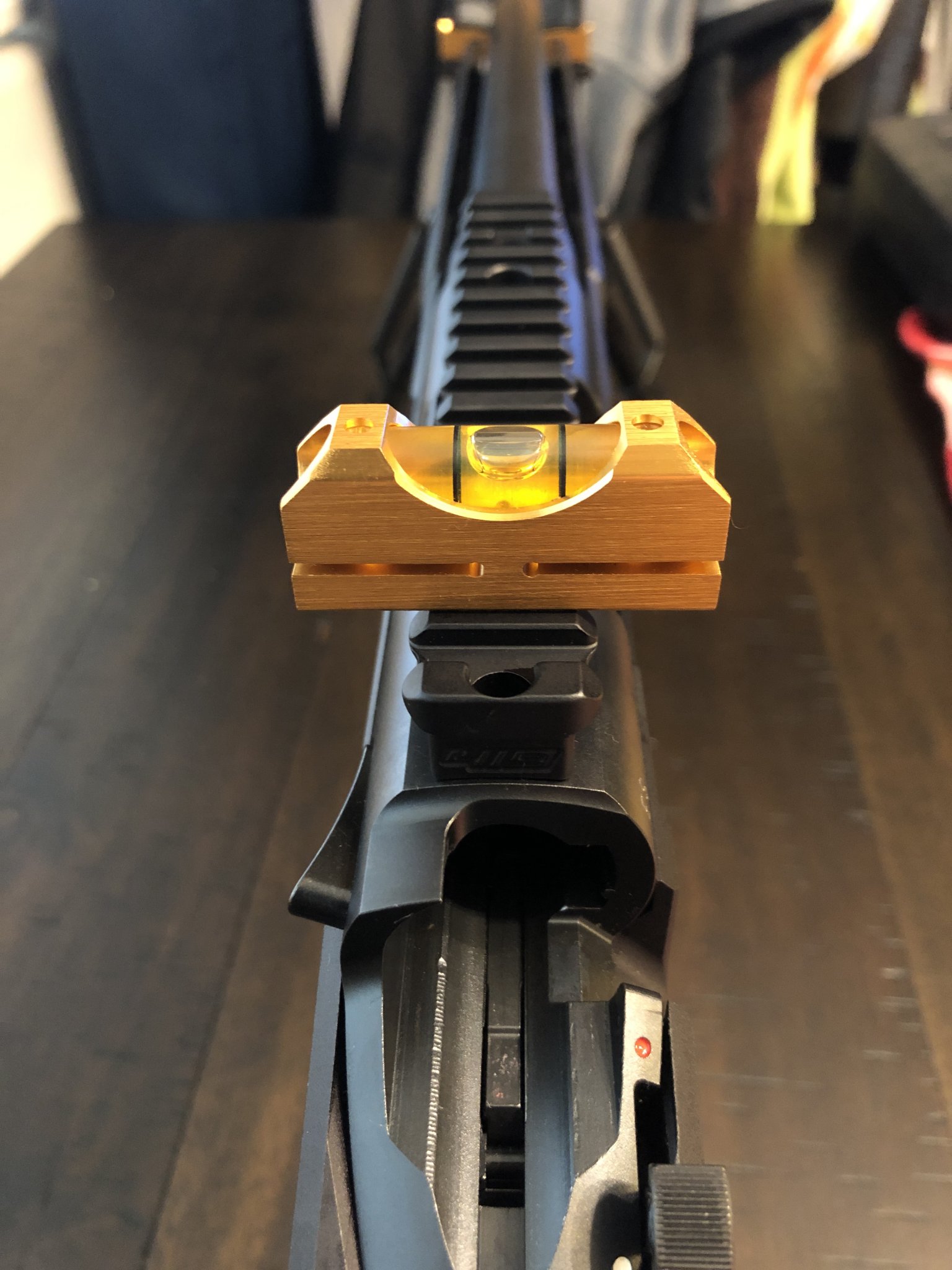

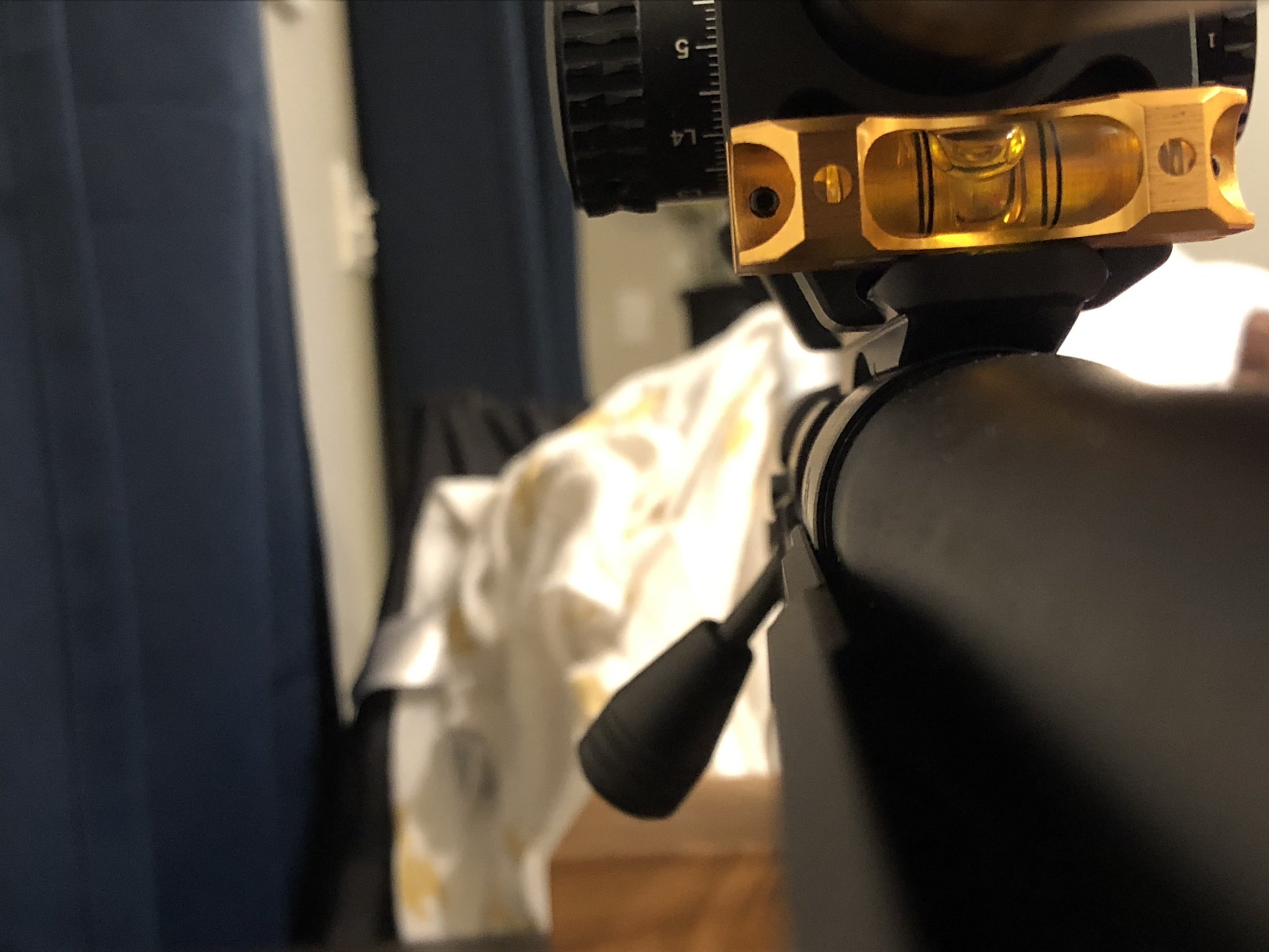

I mounted the 419 base and things started to come up uneven. In the pictures, I made the base level and then took a picture to show the stock uneven. Tried loosening and retighten and adjust to match but once I torque down to 15 it comes up with the same results.
I’m also getting the rear of the base uneven to the front of the base. Hard to see in the pictures but I was too eager to mount everything.
Is this an issue or am I making things more complicated then it should be?

When I make the chassis level, the base isn’t and vice versa.

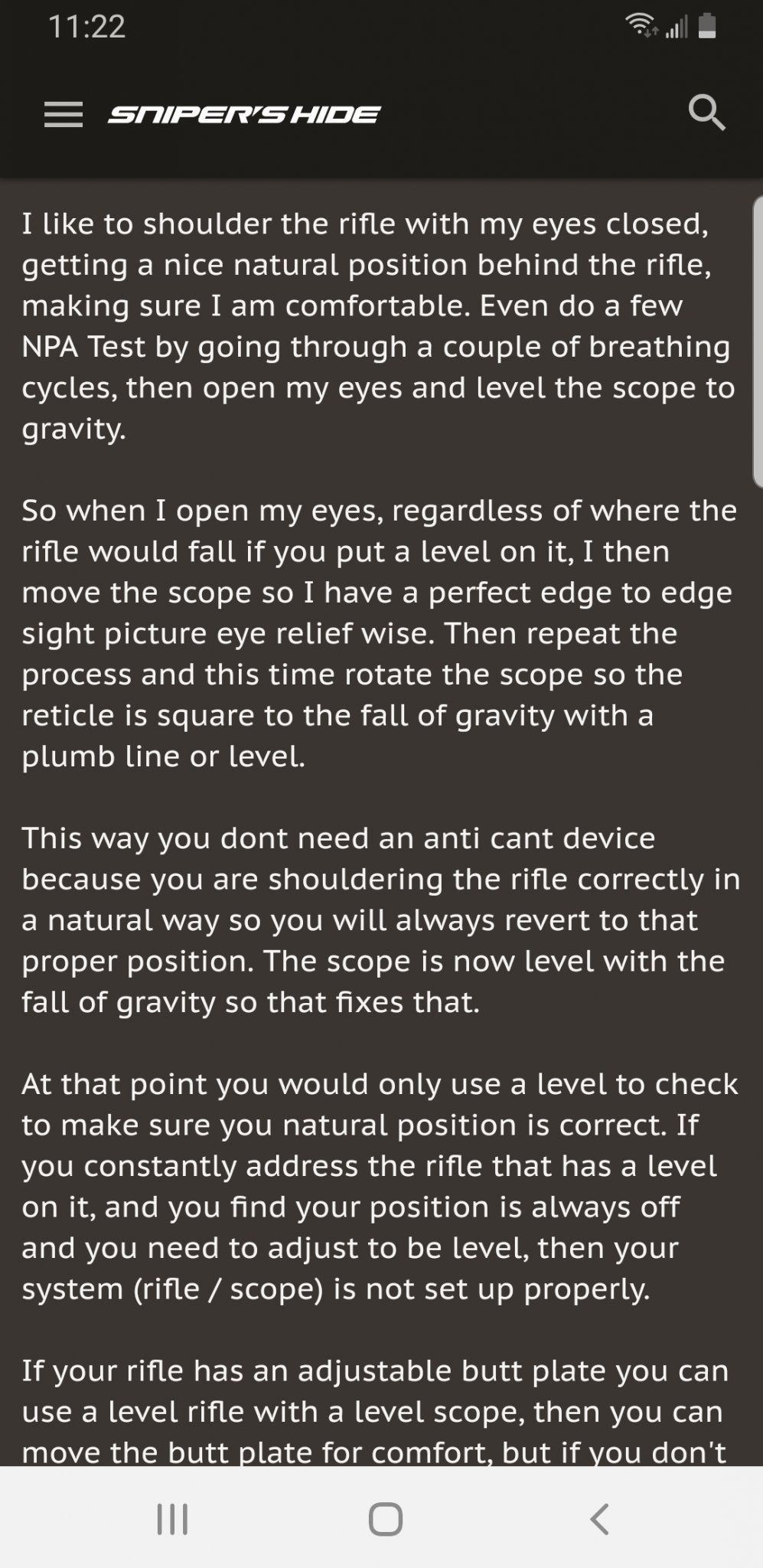

Like I said I was too eager and continued to mount everything earlier. Took the level reading I got from mid base to find my level to set on the barrel level; and then I used that to set the level on the zero stop on the scope after removing the turret.

Pretty sure he's saying that most people cant the gun slightly when shouldering a rifle an to set the scope up level for your natural position such as this post describes.Screenshot_20200125-232215_Samsung Internet.jpg
