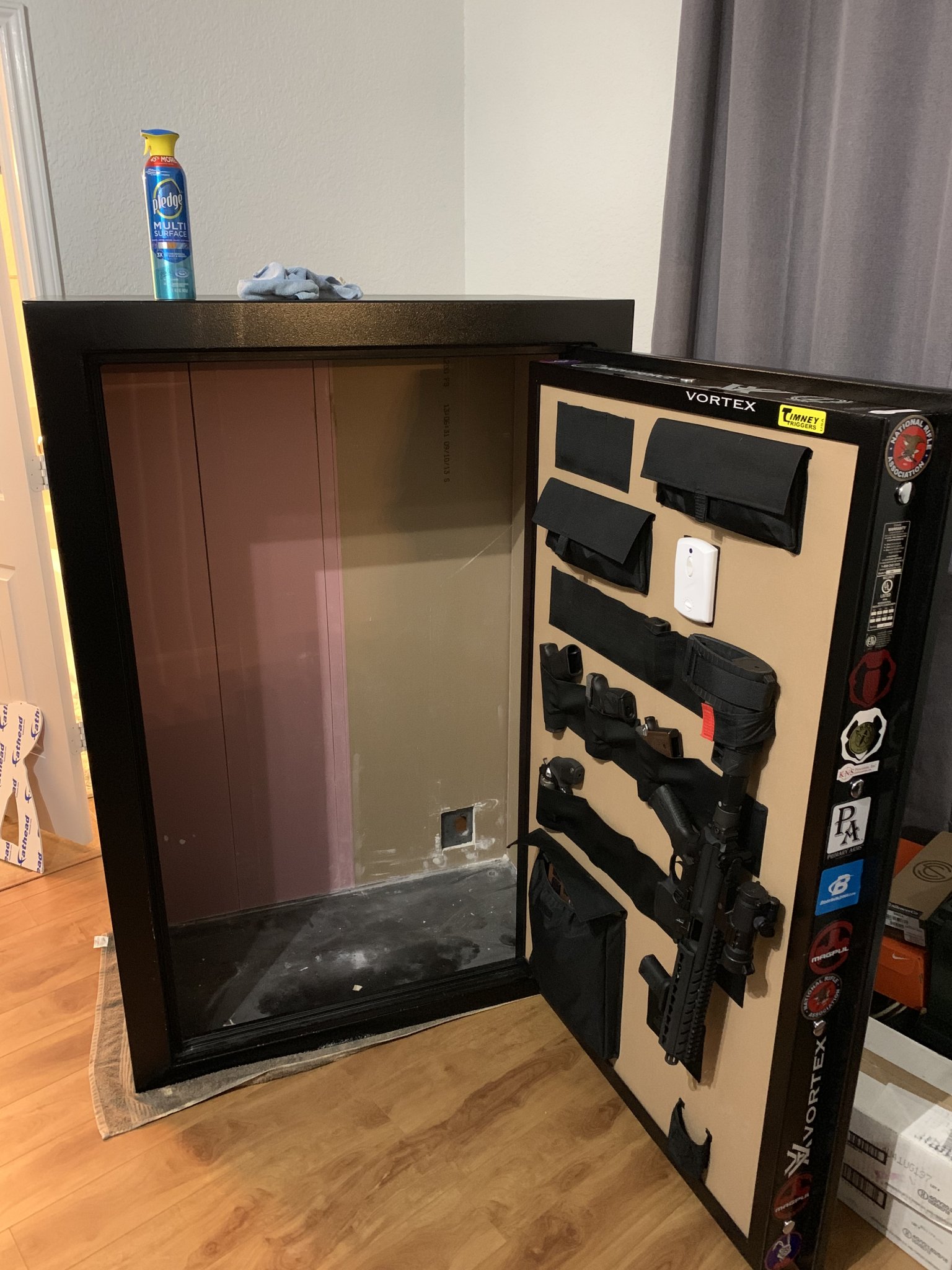

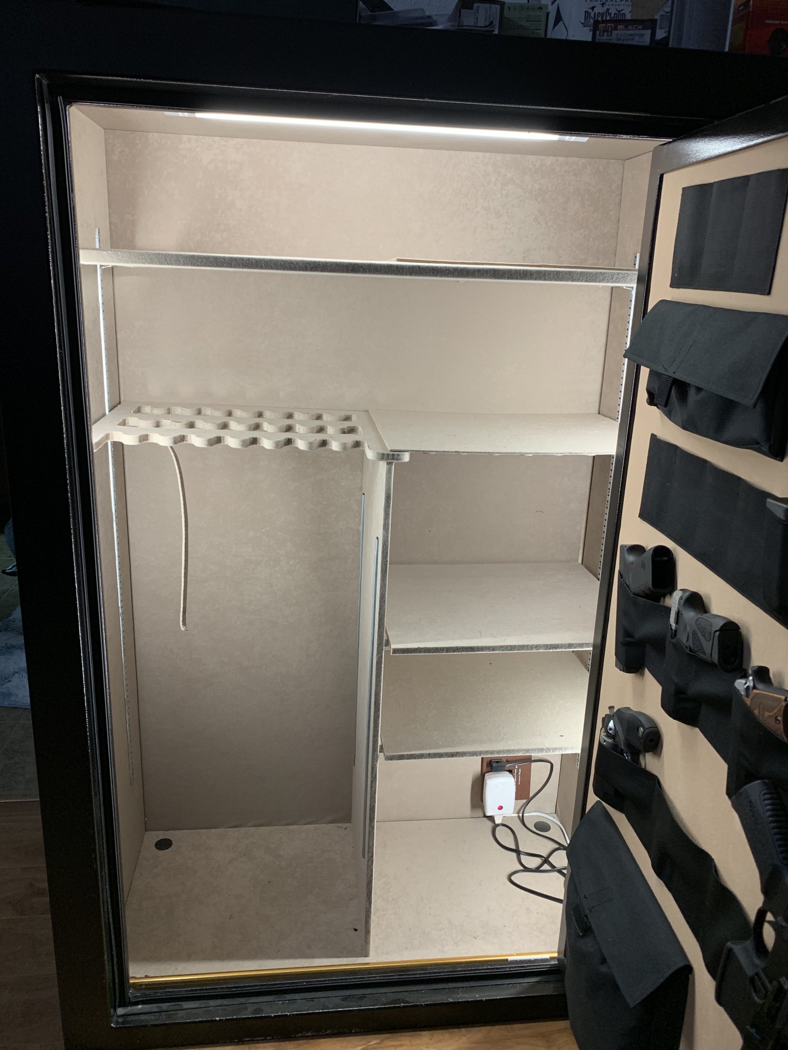

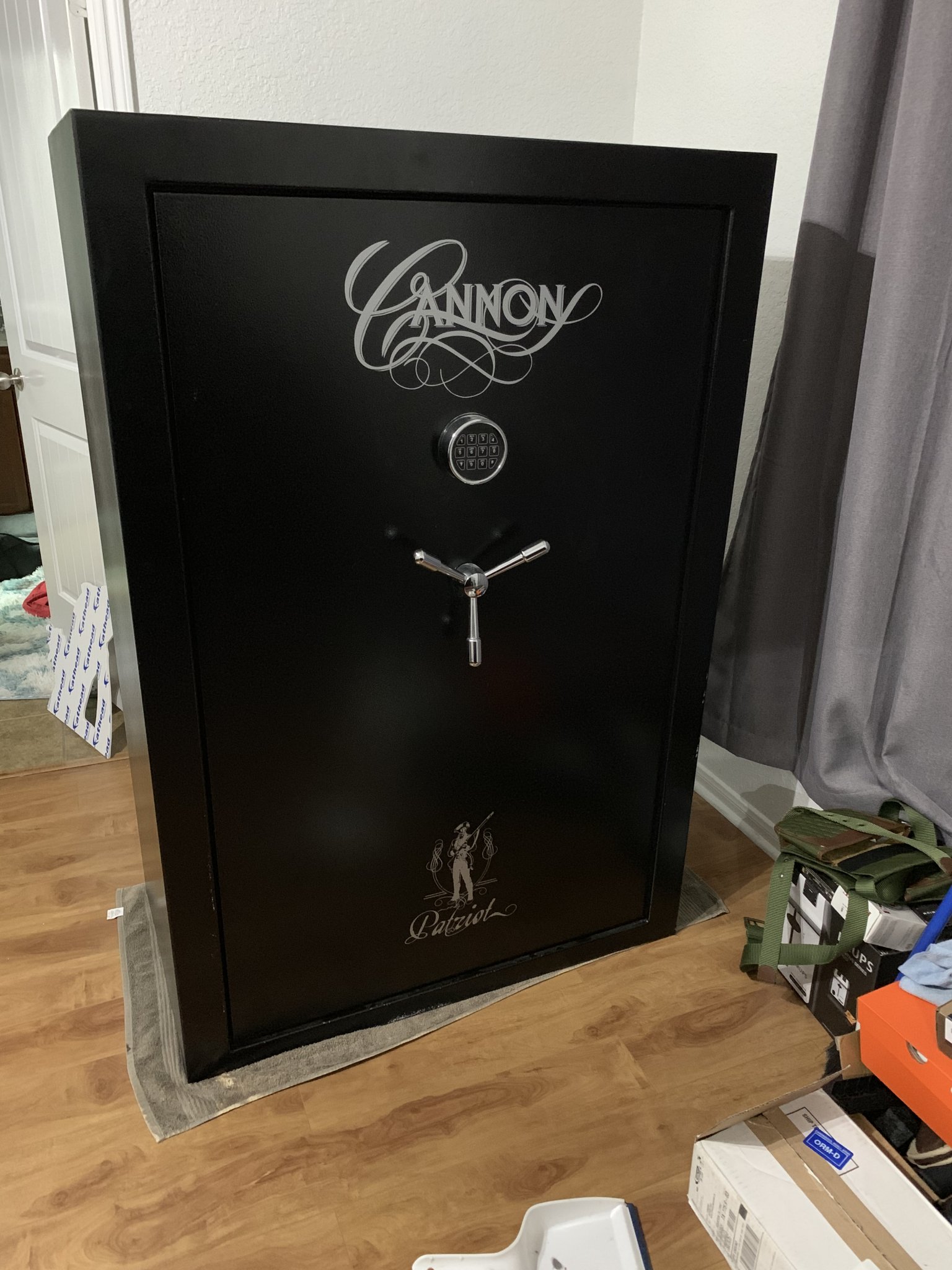

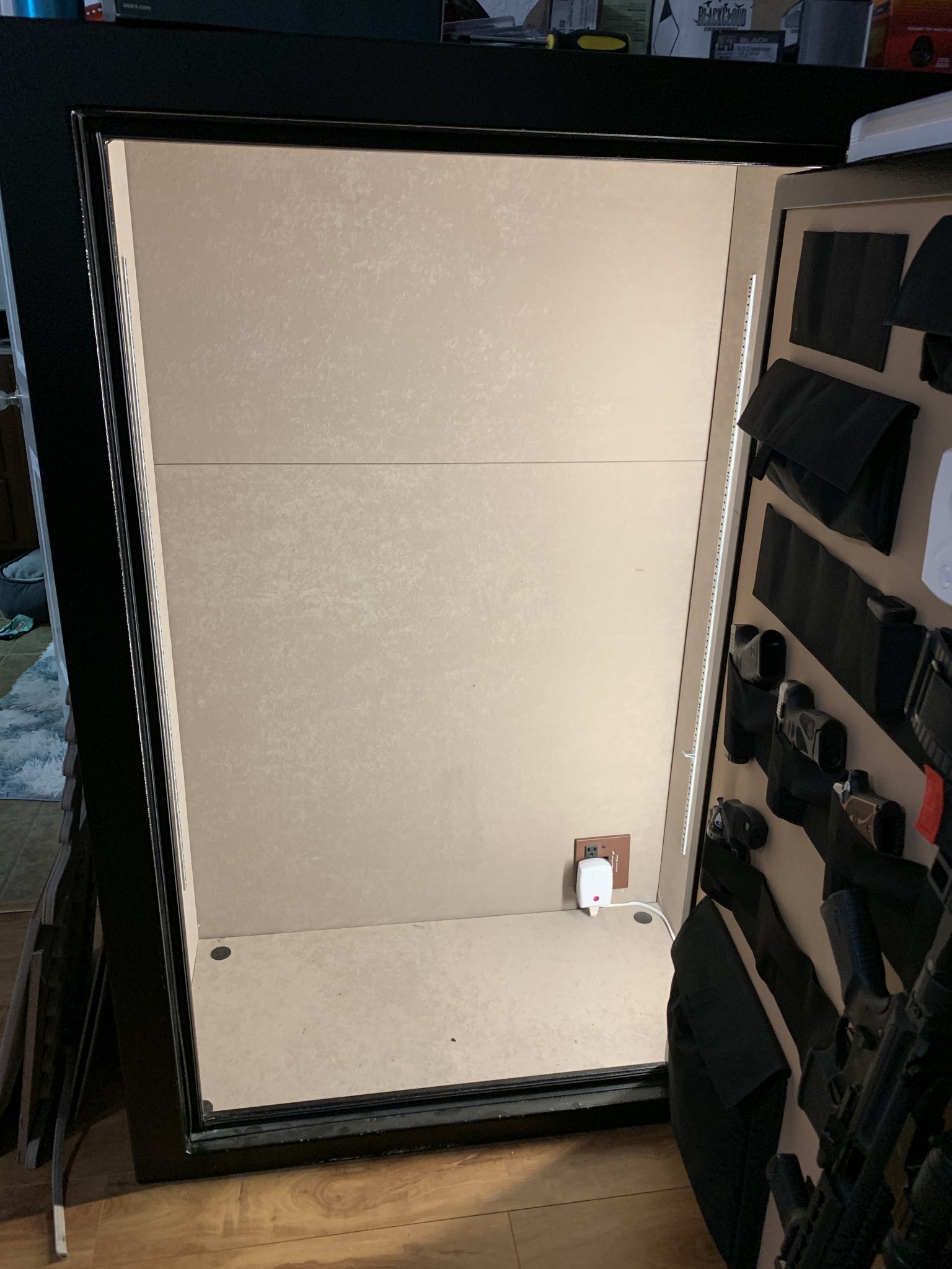

So the interior of my gunsafe is getting pretty old and torn up, time to do some upgrading. I’m planning on keeping the interior design as it is but replacing all the shelving and paneling with laminate floor planks to make it look nicer. Just wondering if anybody else has done interior upgrades to their safe and how it came out. Here’s a before picture, and a testing the waters picture of some leftover floor plankes put together on the walls of the safe.
FEDFBAC0-C42F-4FB5-986F-6668D5DFB77A.jpeg C2FB074A-5BF4-4A7E-9933-EE0241E7381F.jpeg

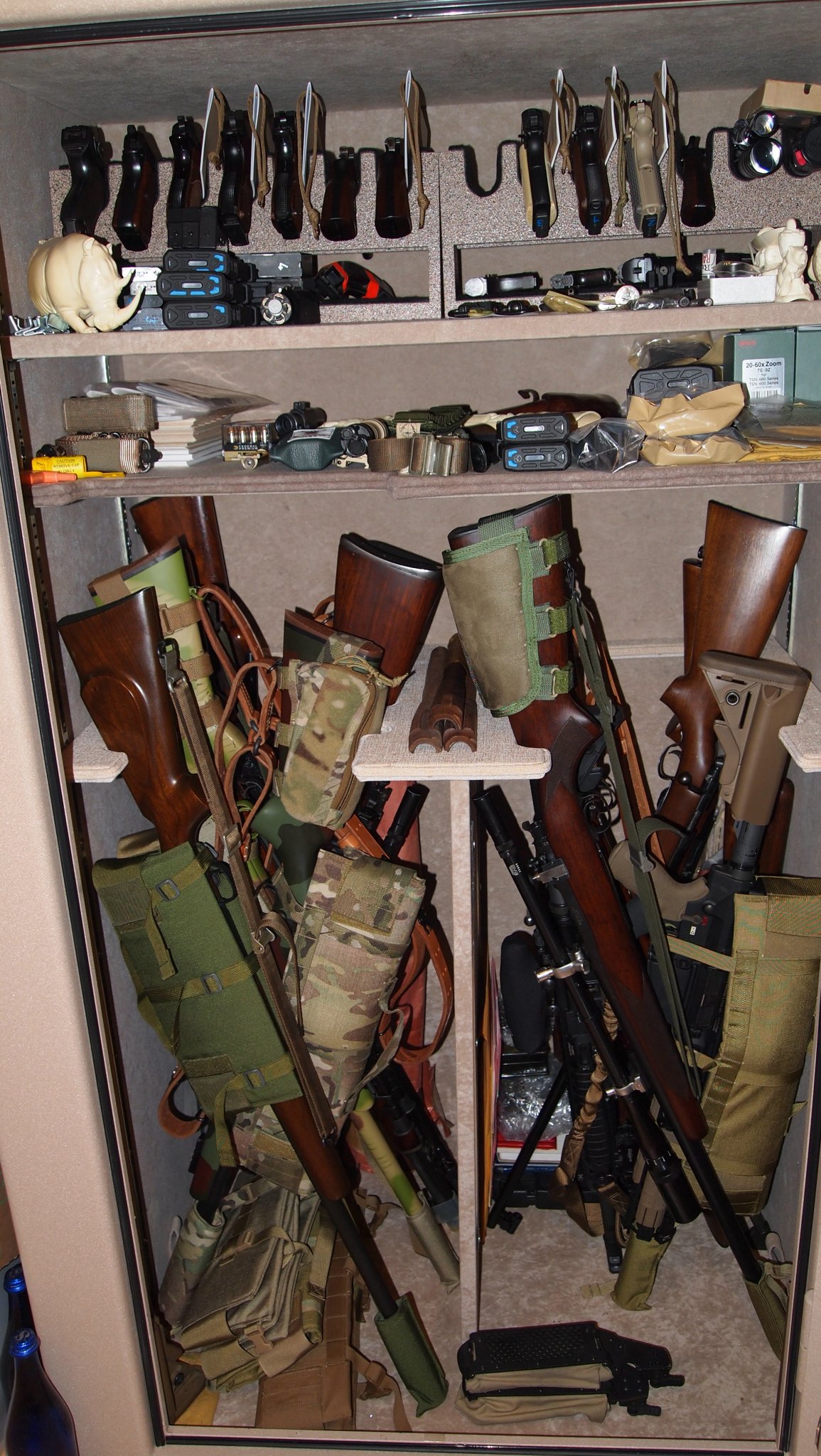

My safe was set up somewhat similar to yours.
Looking at your safe I found the left side (rifles in formation) to be useless. You cant possibly fit the number of rifles in there that the slots would suggest.
To compound problems I like to kepp my rifles in the safe butt stock up so I compound my space issues.
Im guessing that on the right side of your safe if you remove the shelving the top is a "U" that has slots cut for rifles.
That "U" formation I found to be best for me to store rifles "butt up, bore down" so I built a new top shelf with two "U" storage options instead of that rifles in a "Formation of Ranks" option.
When I cut the slots in my "U" I staggered them so the rifles were not opposite each other but staggered.
When I set them in the box one rifle goes in on the left, the next is on the right, etc.
A local upholsterer used some fabric to cover my new cut plywood storage design.
Its worked better. You dont have bulky action next to bulky action so the rifle arent really banging each other, still though, you find out quick not many rifles will fit in the safe and the guys that write the capacity in sales brochures are bald face liars.
Many will recommend safe rods. They would probably allow you to maximize space but they wont work with my "bore down, oil leaks away from the action" desire.

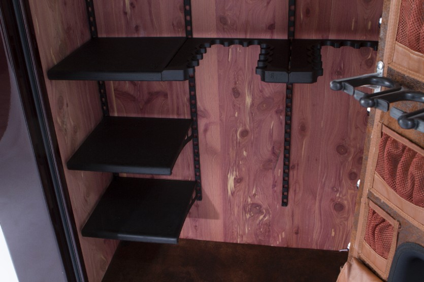

Hmmm, I don't think I would use cedar like the pic above. Cedar increases flammability!
If it gets hot enough in your safe to catch the cedar on fire, everything is pretty much fucked anyway. The fire ratings on these gun safes are a joke compared to the temps and time one would expect in a house fire.
Correct! If there’s a fire and it gets into the safe it’s prettymuch an insurance claim from there, so fire rating isn’t something I’m worried about, and I’m not using real wood, I’m using laminate flooring, far less flammable than most materials

This was my original top organizer....
The way that right side is cut its useless.
I made an organizer with to left sides....

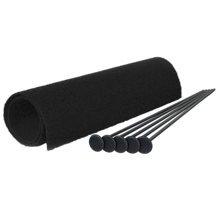

If you have alot of guns, this is the best way I've found to store them. I was initially skeptical, and didn't like the idea of sticking a rod down the barrel. But, the rod is plastic and doesn't hurt the barrel and it allows you to put guns closer together. It actually works and the guns get far less banged up than with the tipping and cramming of slotted wood boards.
https://www.storemoreguns.com/colle...oducts/products/rifle-rod-kit-gun-rack-system
Organize and condense long guns into a smaller space in your gun safe and access them easier than ever with Rifle Rods. Rifle Rods are a patented hook and loop based system that individually stabilizes each long gun in the upright position (leaning, as required in a standard gun rack, wastes valuable storage space).
The Rifle Rods gun rack system allows you to stack your long guns as many as four rows deep, freeing up as much as 50% additional space in your gun safe. The included Shelf Liner works in gun safes, gun closets, gun cabinets, or anywhere there is a shelf to store your guns. Injection molded plastic Rifle Rods will not damage your barrel, and they work equally well for scoped rifles, shotguns or modern sporting rifles. Don't buy another safe, retrofit your gun safe today!

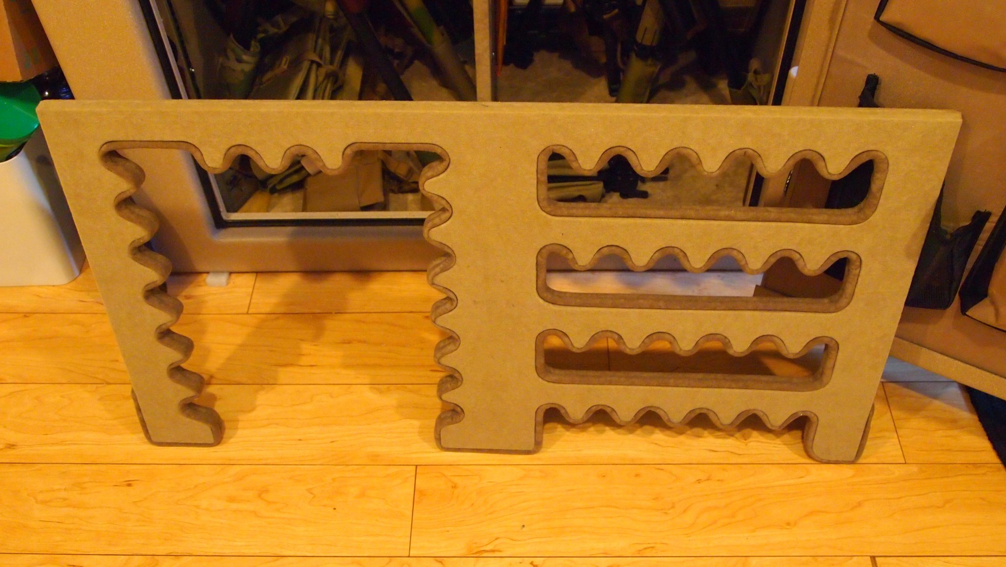

Very nice, I see what you mean by the U design now, I’m definitely going to use the U design vs the zigzag rows.
Wish I had of used actual wood, or even better Azek plastic so their is no moisture retention, when I cut mine.
I used 3/4 plywood and you can see where I used the hole saw to cut the rifle slots there is not much wood left.
Not a big deal now that its in the safe but I had to be careful getting it to the upholsterer, as well the upholsterer need to be careful doing his work, lest the part break.
All fine now that its in the safe and mounted.
I think I used a 2.5 inch hole saw to precut my slots than cut everything out with a jig saw.
I would have been better to have used a 3 inch hole saw because the stock pack rifles and SOPMODs could use more room.

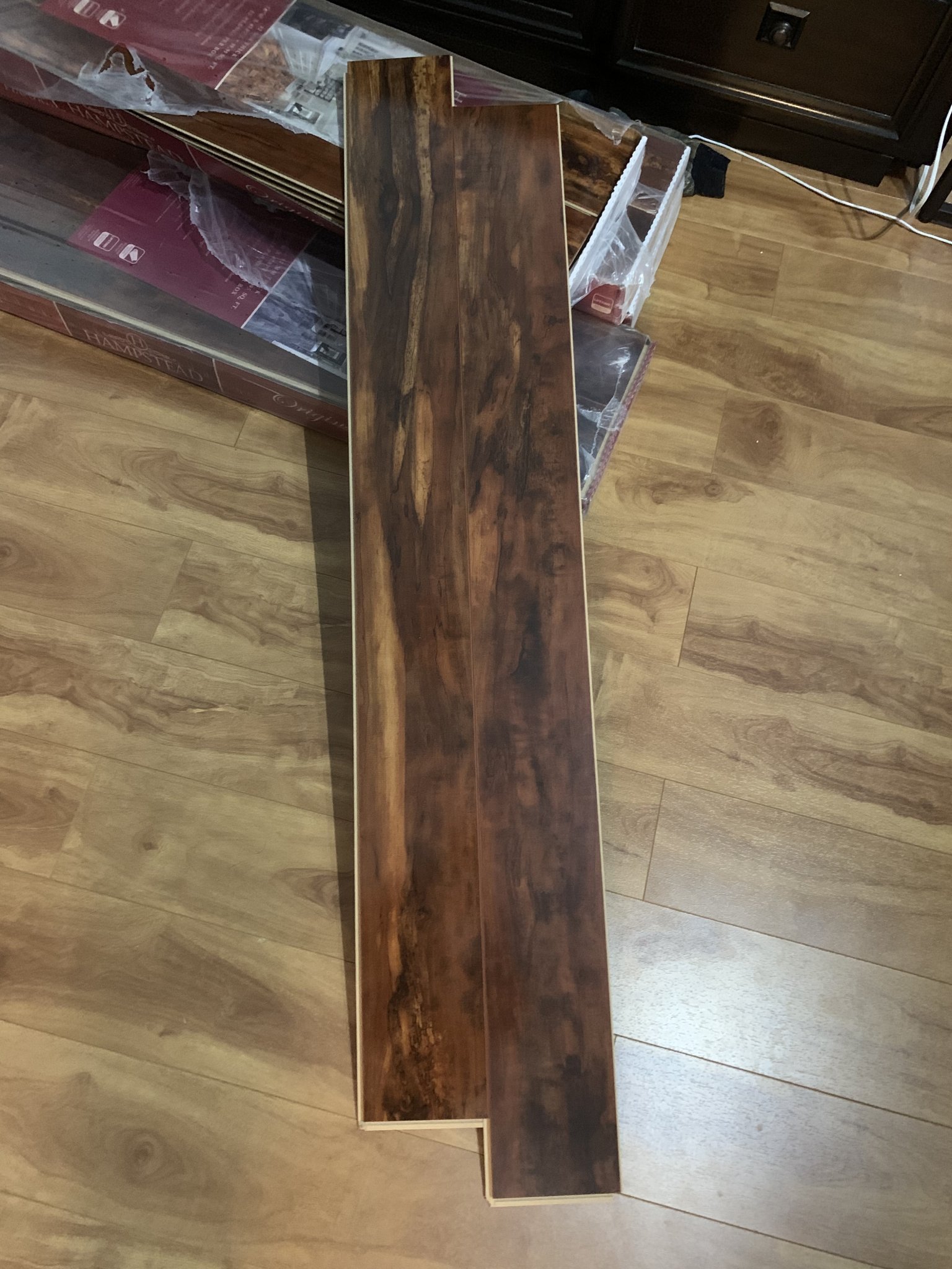

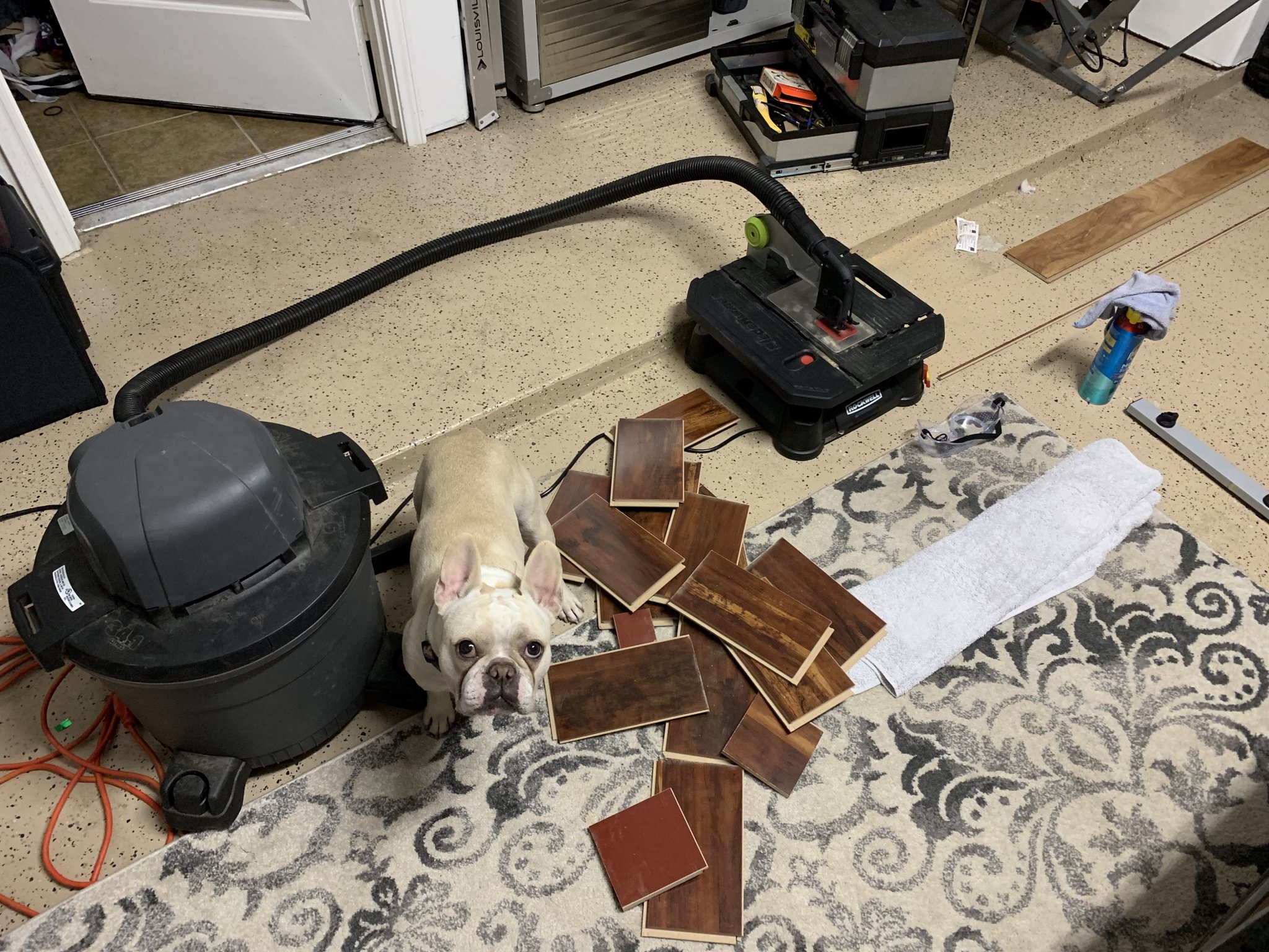

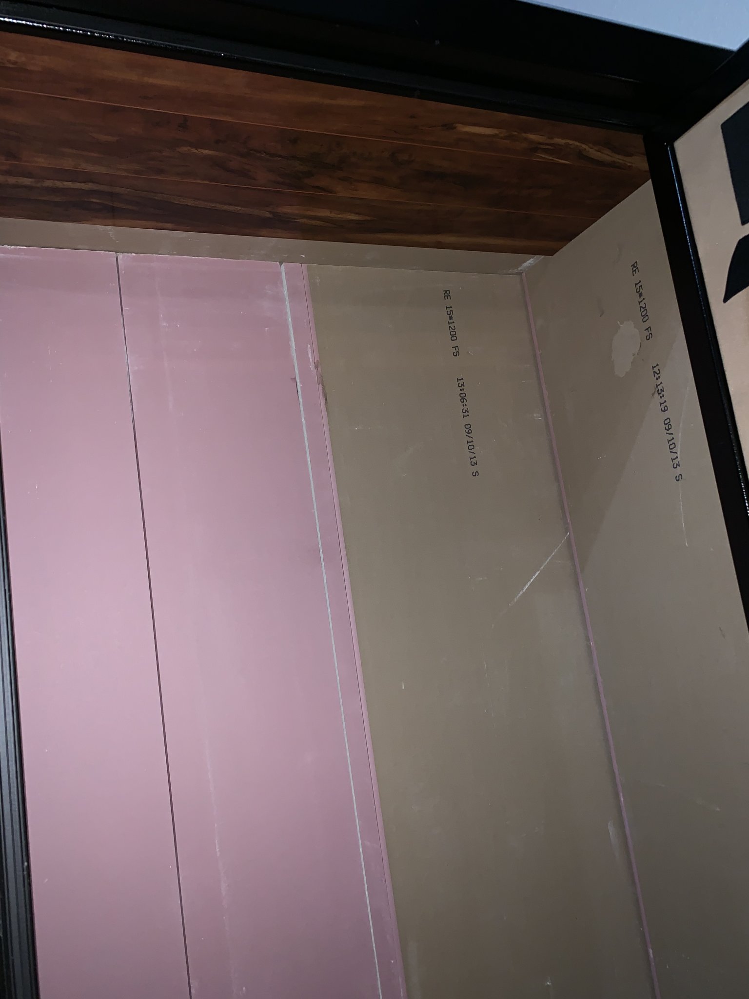

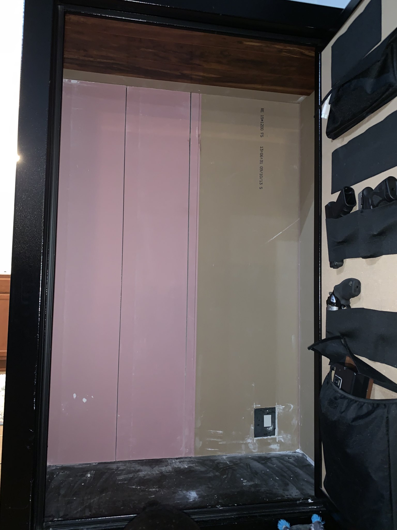

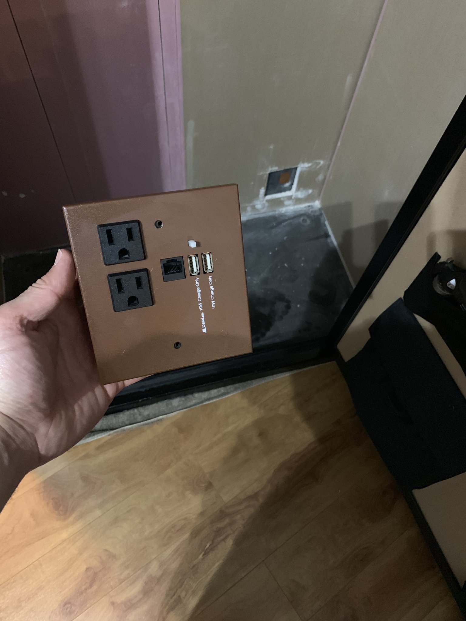

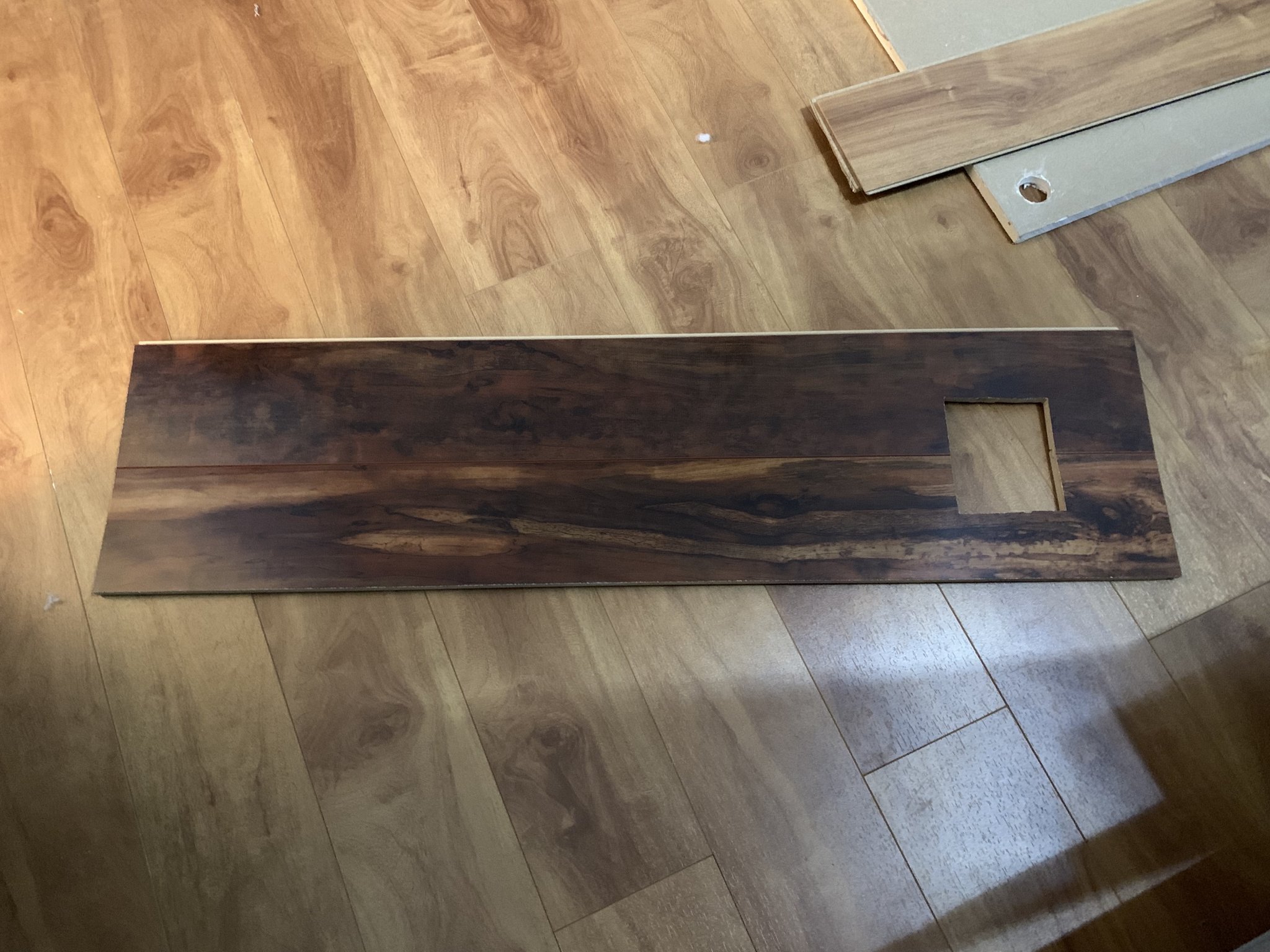

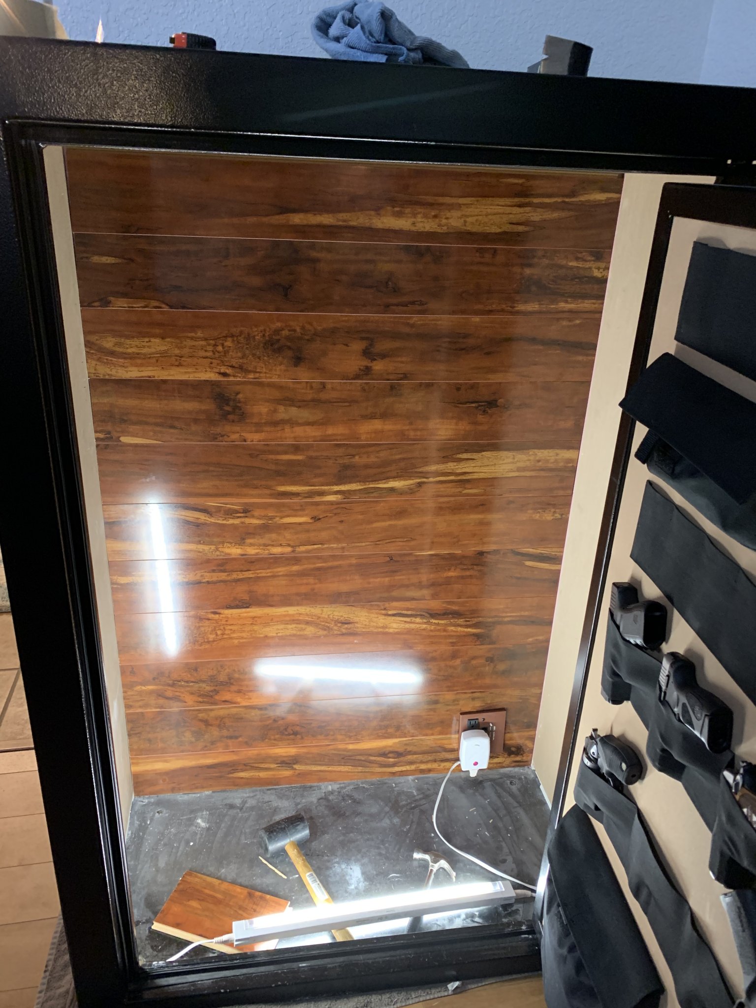

So here's an update on my progress which will go kinda slow, I'm shooting to finished with this in about 2 weeks. So I started off by cleaning out all my equipment, removed the shelving, removed all the upholstered sheet rock, removed the power outlet terminal, and then cleaned and wiped it down head to toe. I forget how dark they are without internal lighting. From here Im gunna start measuring and cutting the laminate and figure out the best way to mount it to the second layer of sheet rock that is lining all the metal panels. * A great tip I learned after scratching the hell out of the floors at my old house is get a buddy or two and lift the ends of the safe so you can slide a towel or soft cloth under the safe so you can move and slide it easier* If you look closely you can see the towel I used under the safe to move it.
F905F4E3-96E2-480D-9DBC-3332269813AF.jpeg 29890DF4-57B0-4954-A6FF-ACA0DC4E03BE.jpeg 88D0EFE0-2611-4ADF-A62C-0F0C713D09C1.jpeg 3264F754-5D9E-45AD-BEB3-61166E04D119.jpeg 16AE750D-A2C5-404D-90F9-235C24CA45D7.jpeg

Wait, so you originally had 2 layers of rock but will only have one layer when complete? There goes your fire rating.

If it a real fire, in the same room - in contact with the box, there are not many residential containers that will survive anyway.
The atmosphere itself will become so corrosive stuff will be a mess.
You pay dearly for true fire ratings and it absolutely consumes the interior storage area.
True fire protection containers are HUGE Squared,,,,,,,,,Huge in cost and huge in size if you plan on putting a reasonable amount of gear inside.
Think Yeti cooler. Big outside dimension - fits one 6 pack.

Exactly, if I keep the second layer of Sheetrock on and add any additional layer of material I’ll reduce the inner dimensions of the safe and have less room, and as small of a loss of space that might be I’m not willing to lose any usable real estate. So hopefully I can get some more input here on creative ideas for shelves and ways to arrange long guns, and less concern about fire safety. Let’s see some more gun safe pics!!!
