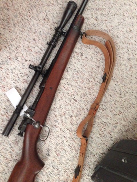

LGS has a Remington 1903 “Style T” for sale. Sprterized stock, heavy barrel, Lyman peep, Unertl Scope included. Good shape, asking $2k.
I don’t know much about this variant, so I wanted to bounce it off you guys. Is this fair? Does anything look off to you? What questions I should ask?
Thanks 2A3734A2-7A98-4E55-B78C-7701B6BD9092.jpeg 2EE02E03-E17D-4736-84C3-88E34584C077.jpeg C0B085FC-1408-47CF-858E-C0E76EAB881C.jpeg AAC5B1D0-DA6E-4D7C-B6DB-67974A3194A1.jpeg 25437FB1-AC76-45D1-BDC6-67A9CD5EE001.jpeg

Scope is a Lyman, not a Unertl. Beyond that, it appears to be a pretty typical sporterized 1903. That being the case, I'd say they're asking about twice what it's worth.

The biggest thing I think that determines value on something like this, is if it was done by the Military or not. I think this is a commerial creation and I don't think there is really much of a chance the Army would have built something like this that late in M1903 history. By the time Remington's came out, the Army was done with the M1903. And I can say without a doubt the Marines didnt build this either. I imagine some commercial gunsmith put this together back in the 50's or 60's as a nice target rifle.
I sure it's a heck of a shooter. But there isn't any real collector value here. It's basically worth the sum of the parts.
I agree, its worth about half their asking price.

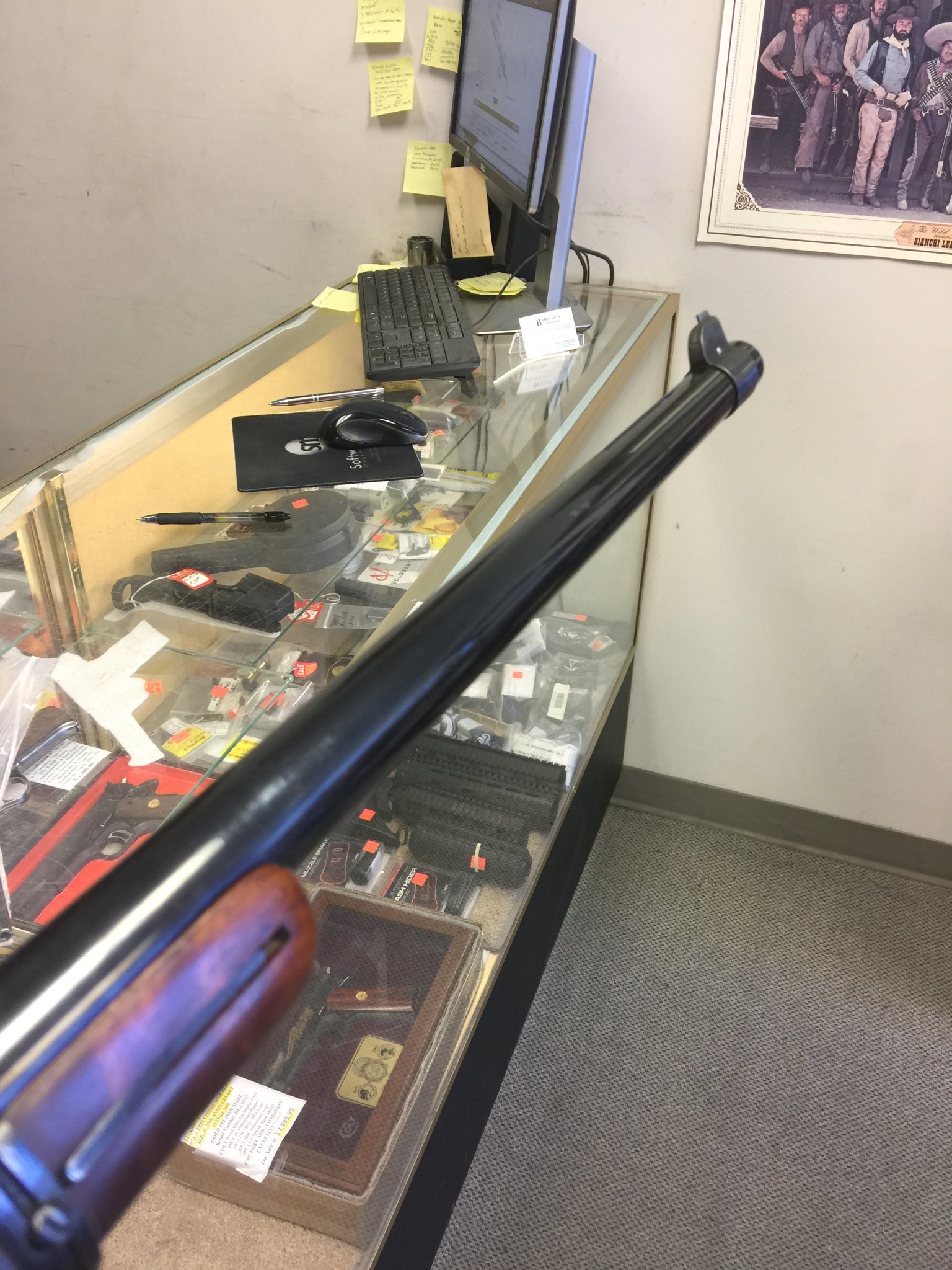

Something doesnt look right about the front band or the finish at the tip of the stock.
Not enough knowledge to give definitive answer but that in addition to the finish of the bluing has me thinking this needs further research.
Cpl Norton is right Remington built war guns they would not be building a "T" that would be SA.

I appreciate your replies, and agree that something feels off. The Lyman sight is in great condition and worth a little bit on its own but I have a feeling this was built to resemble a rare rifle so is really worth the sum of its parts. I would think if it really was a rare variant the serial number would be documented.

So after a fair amount of digging and consulting various sources I have come to the conclusion that this is a put together made to resemble a style T and therefore inflate the value for an unsuspecting buyer.

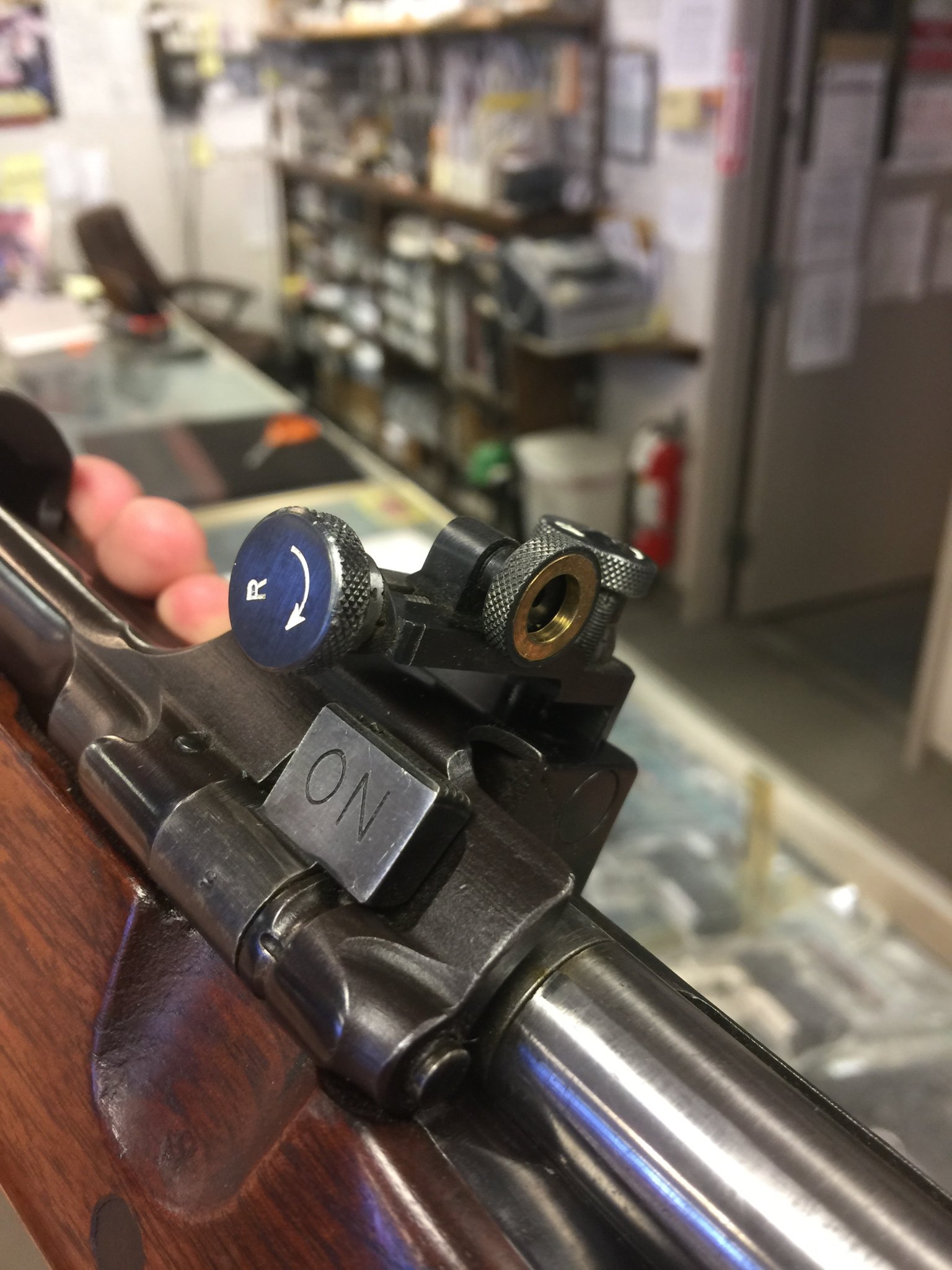

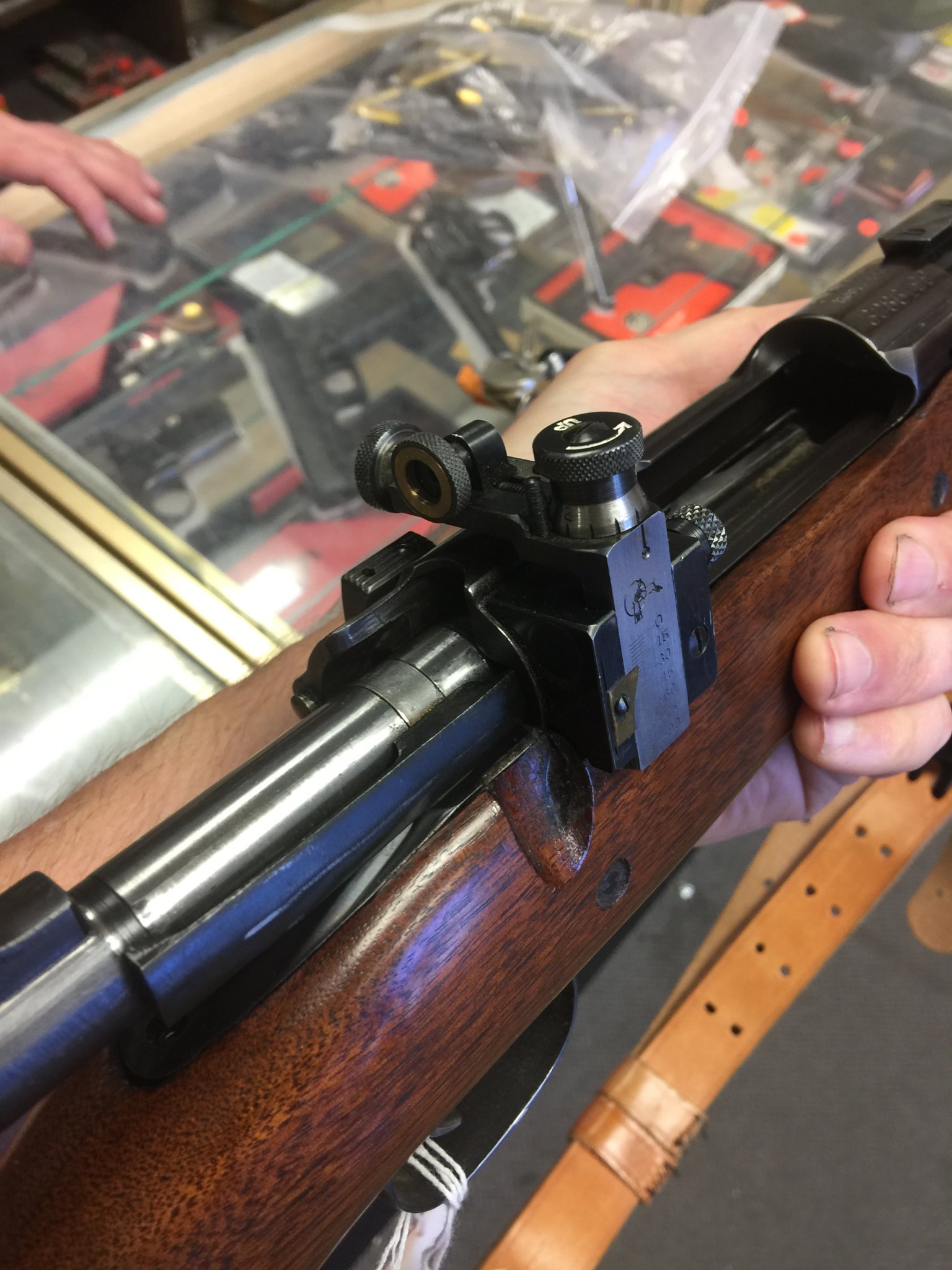

Remington never made style T rifles, only Springfield did and those are well documented by the DCM, serial numbers and all. In fact in the book "The collectable 1903" the author states that he has never seen an unmodified Style T. When I went to look at the rifle in person I noticed immediately that the lyman sight, while mint, was not correct (original Style T sights did not have the deer and reticle marking), and there were zero cartouche and armory marks on the stock. It is entirely possible that the barrel is an original style T which would add back in some value but I don't know enough about how many heavy barrels were produced over the life time of the rifle, so more research is needed.
