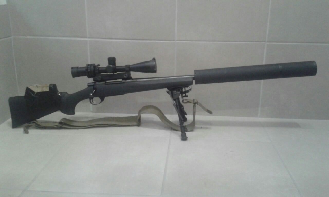

Just a thought from South Africa
Weight and balance concerns aside, I think more people would go for reflex suppressors if it weren't for the cost of obtaining one
If a suppressor can fit multiple rifles, it makes a high initial cost seem more like an investment than a fee, but if a reflex limits it to only a handful of firearms it might discourage any would-be buyers
Here we see reflex or even full reflex a lot more often because it's affordable enough that you get a suppressor per firearm you want suppressed
Seeing a US point of view on reflex suppressors was actually the reason i searched for this thread:D
I just got my full reflex about a month ago and couldn't be happier with it from trying it out
All the best from South Africa
Cheers
Alex

I'd say the design of the suppressor plays a bigger part than the reflex or lack thereof
I've seen reflex suppressors that are nothing more than a suppressor with extra volume over the barrel that don't perform that much differently from well made non-reflex suppressors
I may be a bit biased:LOL: but the guy that makes the suppressor I bought got his design patented because it does in fact redirect gases away from the muzzle and move the pressure spike away from the crown
Haven't had any chances to do a proper test but I'd say it is a fair bit quieter than most other suppressors around here
It also sits at around 450mm long and 62mm diameter so a tradeoff of bulk and weight for more volume
