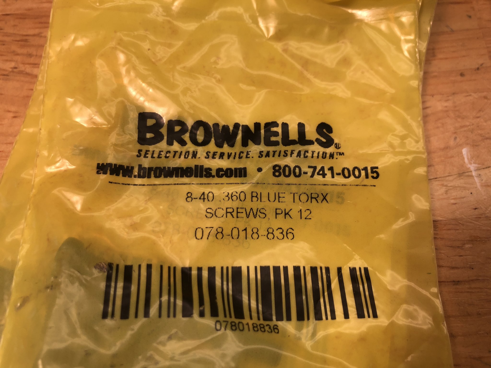

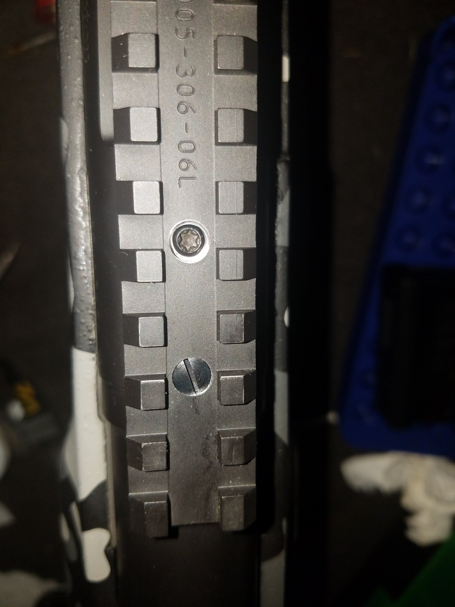

I've been too busy to get this issue resolved but I finally found time last night. These are actually 8-40 screws. I ordered new ones that were long so I could trim them since the Badger screws were short. The head on the new ones was too big for the counterbore on the base. I opened them up on a mill. I suspect the small head on the original screws and the lack of full thread engagement on the receiver diminished the holding capability. I still used the red Loctite 272 to make sure this isn't an issue again. Pic attached gives you an idea of how much bigger the new heads are. 20180316_214853.jpg

8-40 hex/torx head screws are available that only require enlargening the through hole w/o having to open up the counterbore for the head. And with the screw heads filling the counterbore, all your hole locations are going to have to match perfectly in the base/receiver.

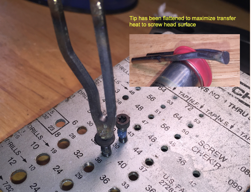

Red only need to get to around 550F to soften, a small soldering iron can do that easy. Have done it many, many times. An electric one works fine, but a small butane iron gets hot a lot faster than a plug in one, so if ever find yourself having to remove a bunch of rails that are all red loctited one, that is the ticket.

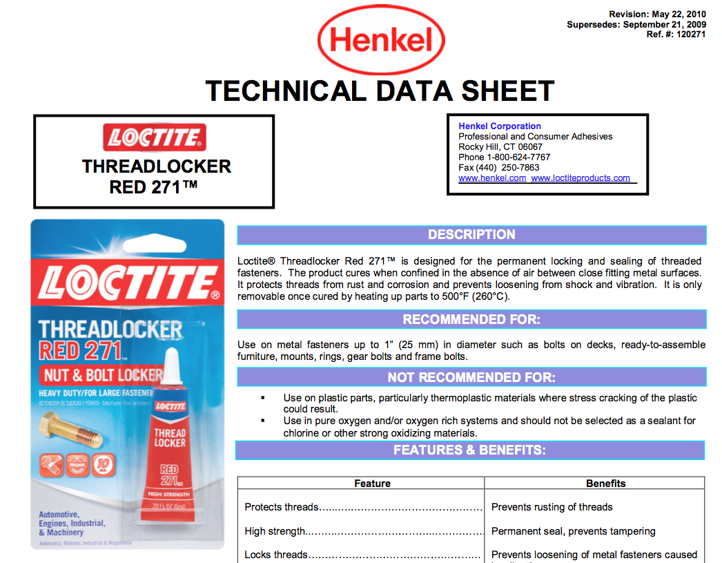

#33

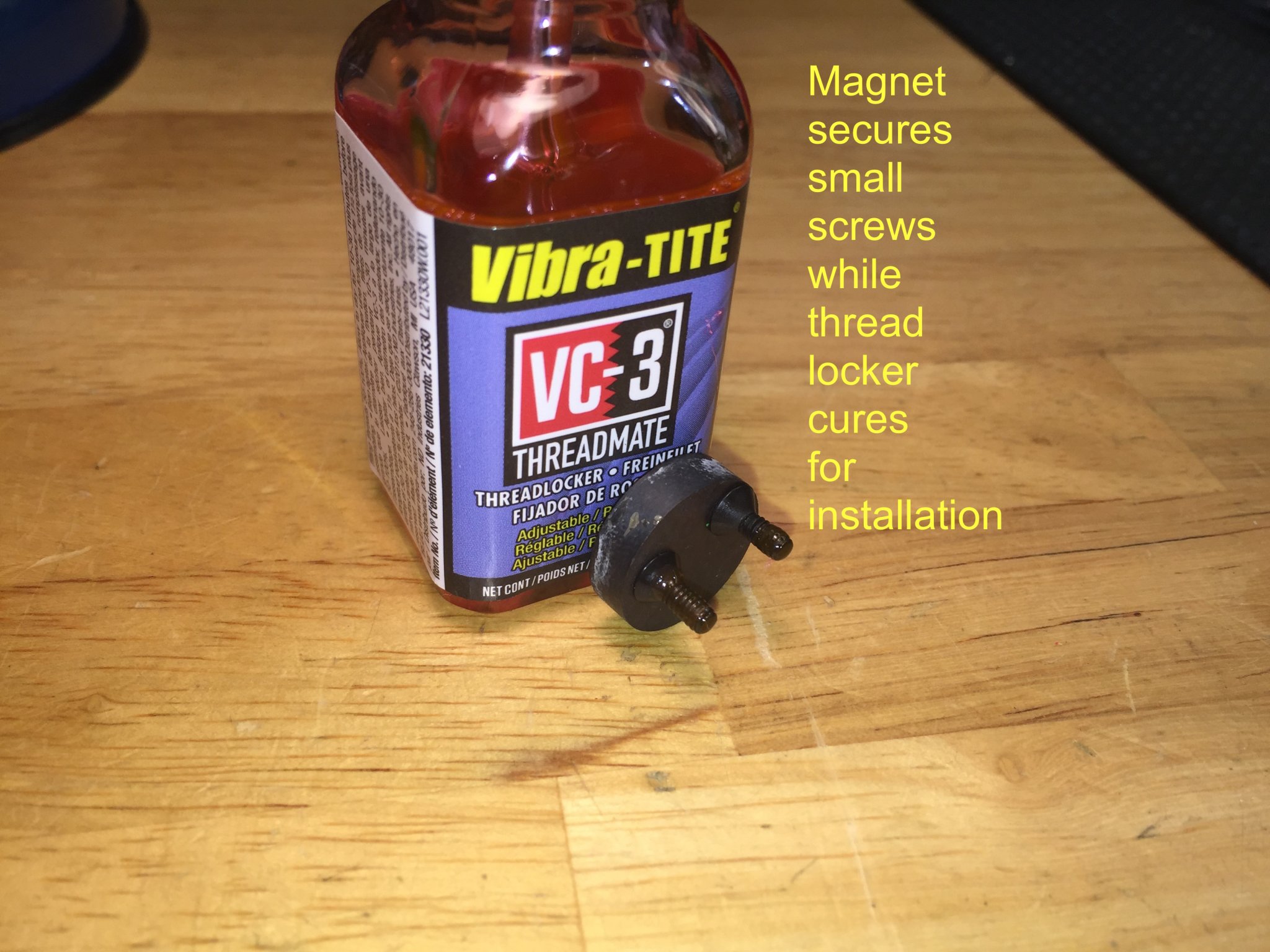

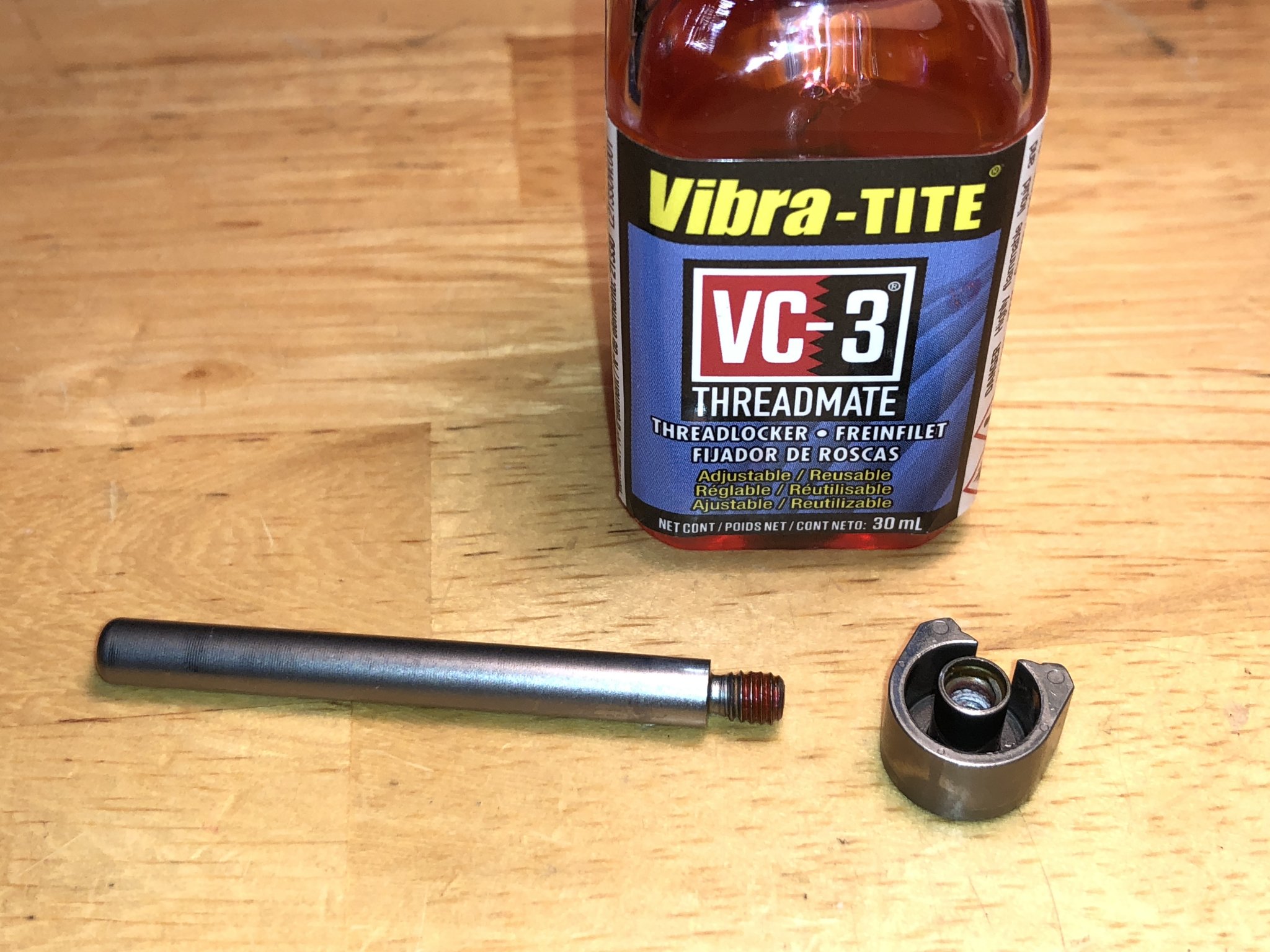

IF you don't want to be concerned with anaerobic adhesives and their temperature release thresholds, consider using
Vibratite-VC3 which is similar to Nylok style compressible thread applied adhesives. It is adjustable, removable, etc. yaddah yaddah. Check it out.

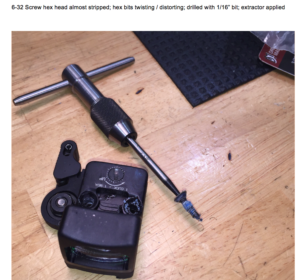

Likes: Jay McLean

Bullshit! Obviously you have never tried your suggested method of breaking down red. You could stick one small soldering iron in your dick hole and another on the screw. Your dick would freeze before the screw breaks loose.

IF I have to transfer heat to a limited screw head surface to release anaerobic thread adhesives (e.g. blue / red loctite), I try using my soldering gun with several different modified tips based on screw head configuration, to maximize heat transfer to the head of the screw. If a small torch is needed apply Brownells Heat Stop Paste around the screw head to limit any collateral damage from the heat source. Even too much blue Loctite can cause the screw to not be amenable to removal by heat for fear of damaging adjacent electronic elements; this RMR mount required drilling and extractor use.
Screen Shot 2017-04-01 at 4.21.46 PM copy.png Screen Shot 2018-03-17 at 8.57.18 PM.png
Yeah man, 16 years of building rifles (with most of that being sniper rifles for the Marines where we always used red loctite) and I have not tried removing a base with red yet using a soldering iron. You really need to bark up a different tree if you think you are going to convince someone with online bravado.
I assume you are trolling, but I still respond because you are going to lead other astray with your nonsense.
A soldering iron placed on the screw head of a scope mount screw will be more than enough to break free red loctite; anyone that says otherwise is talking out their ass. They have either never tried it or tried using a soldering iron on some much larger screw, like a dummy.
I bought the wrong screws and didn't want to wait for the replacements. There was enough clearance for everything to line up and assemble easily. I zeroed the rifle and took it out to 600 yards today, it tracked just fine.

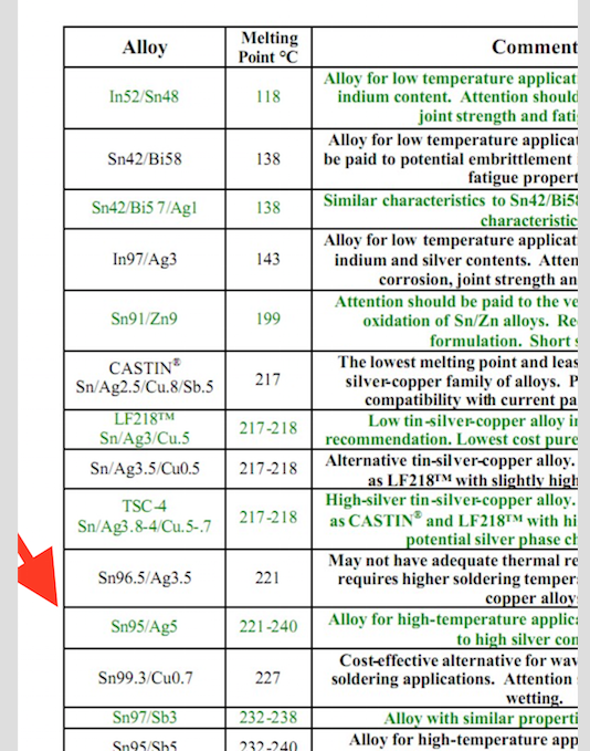

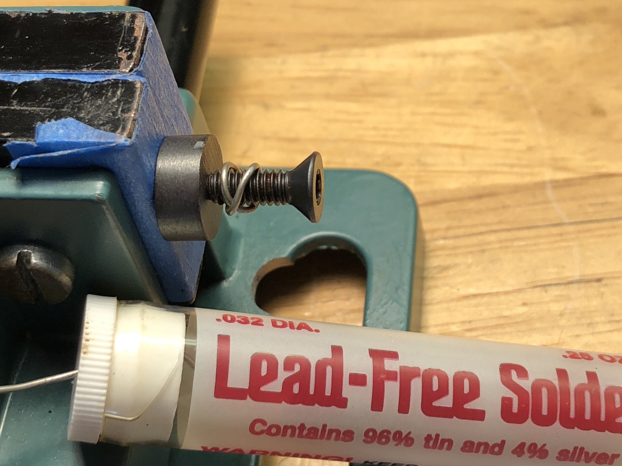

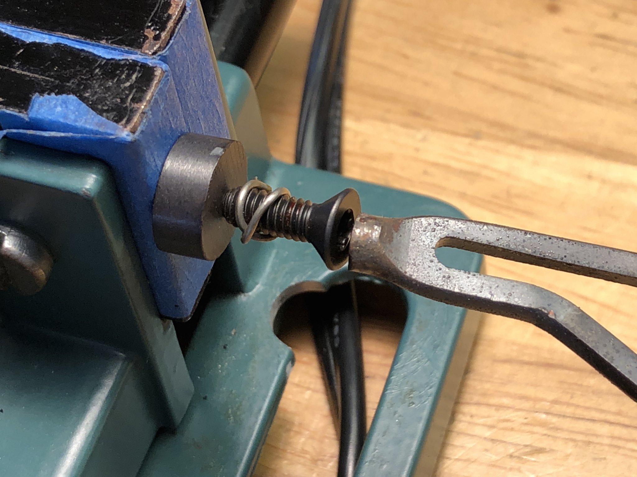

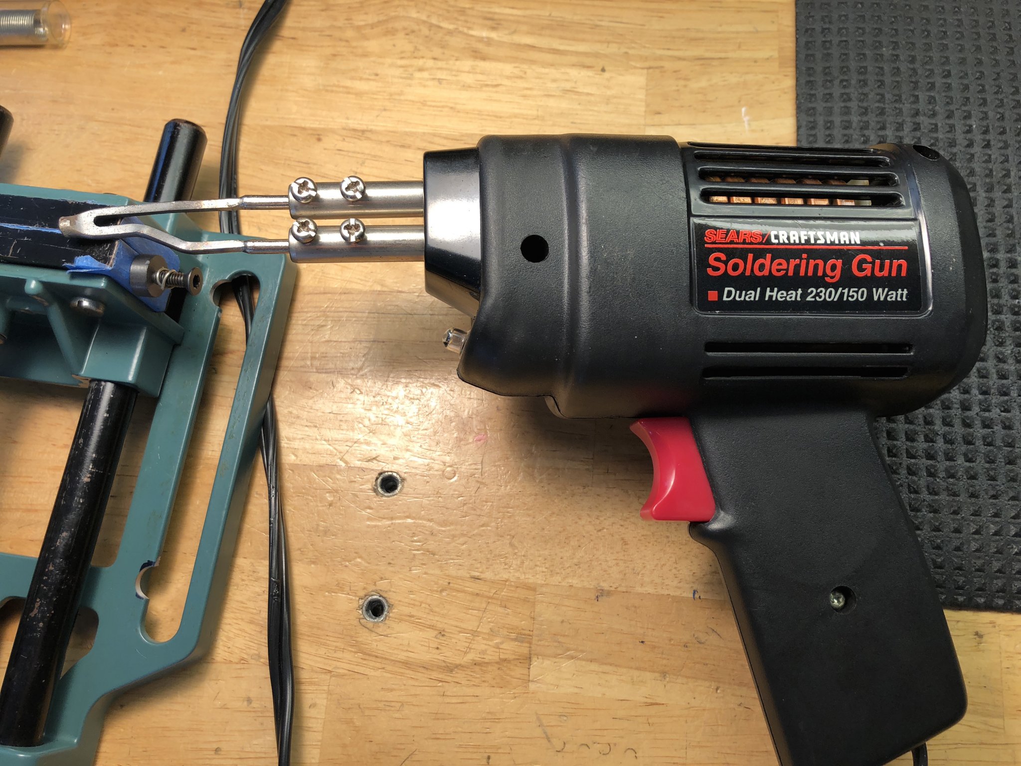

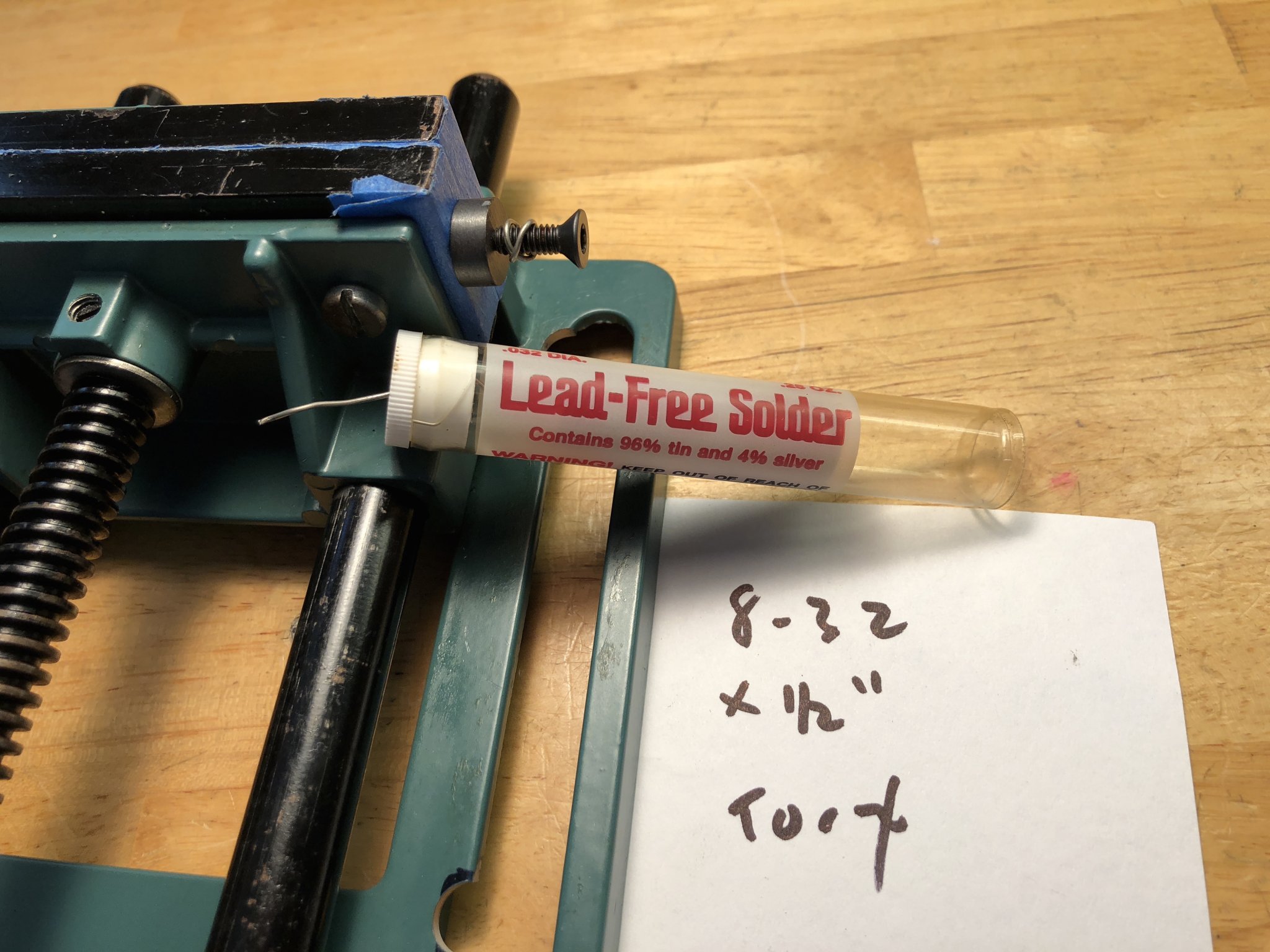

Just for the heck of it I was trying to decide how to simply demonstrate heat transfer down a 8-32 X 1/2" screw using a soldering gun with one of the flat modified tips I mentioned above. Here the screw is held by magnet with solder wrapped about the threads near the tip. The melting point of this solder is ~ 465 deg F; red loctite is ~ 500 deg F.
It took less than 30 seconds to melt the solder.
video:
https://www.dropbox.com/s/w26o3l8sr92d8bf/IMG_8357.MOV?dl=0
Of course thread length and being installed allows for surrounding metals to act like heat sinks so it can take a little longer based on these other variables, any how it seems to make the point that the method works quite well.
Having such information can also be useful in planning your placement of heat sensitive thread lockers on the threaded parts to be mated. I generally use the adhesives close to the screw head, as it is the shortest length for heat to travel and the adhesive doesn't get displaced / thinned on insertion as the fastener runs thru its length to final position.
Finally, using a magnet is an easy way to hold screws while some adhesives are curing before installation.
IMG_8352.JPG IMG_8353.JPG IMG_8354.JPG IMG_8356.JPG Screen Shot 2018-03-18 at 1.44.42 PM.png Screen Shot 2018-03-18 at 1.43.12 PM.png

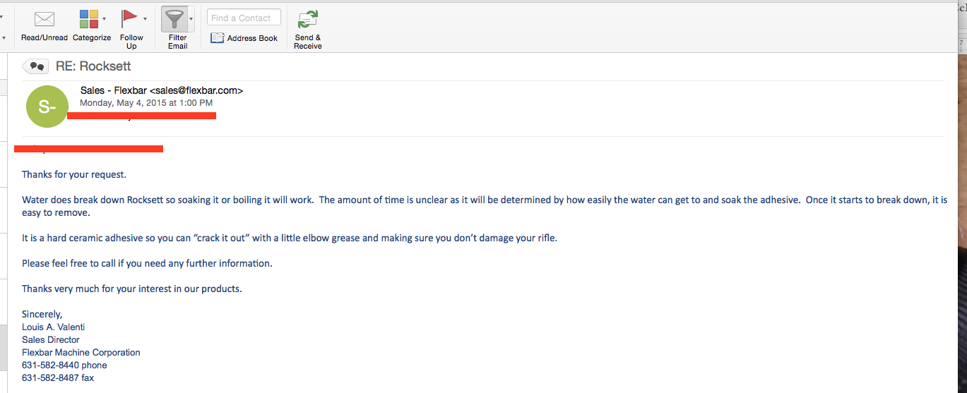

^^^Rocksett is a silicate-based adhesive with a temperature release threshold of ~2,000 deg F.....one would change the temper of the metals by the time that much heat was delivered...so heat is never the answer and is why many mfg.s of muzzle brakes / suppressors use it to secure threaded devices as a rapid fire suppressor temperature may exceed 1,000 deg F. Soaking in water, some warm it up a bit, dissolves the silicate then apply the wrench.
I confirmed the best method of release with the mfg. of Rocksett a few years ago.

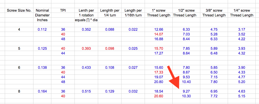

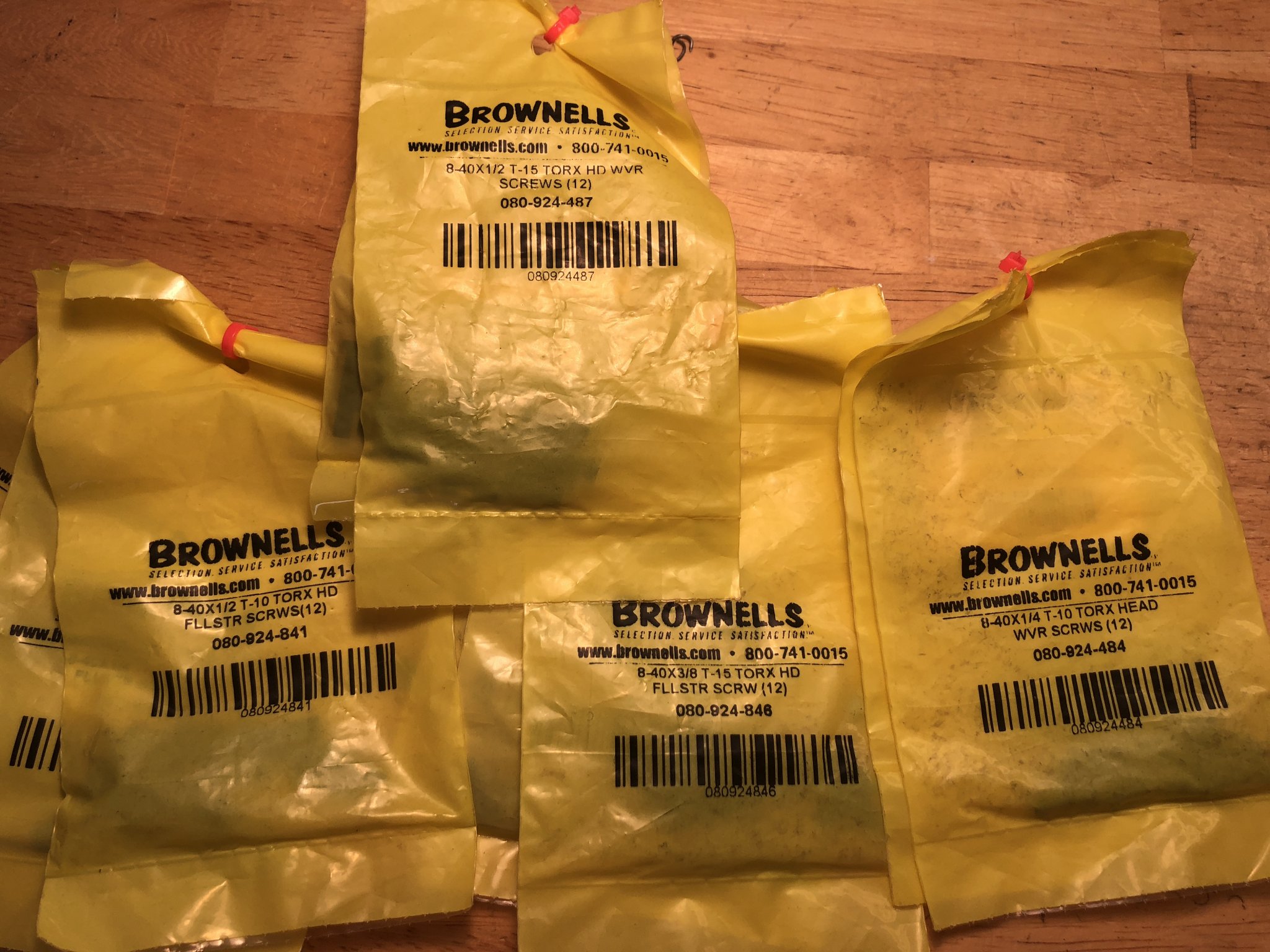

8-40 screws are commonly used for scope mounting, available in different size T-heads as well (T-10, T-15). I try never to use a non-Torx head style as the other configurations are not nearly as secure to the torque wrench as Torx or Torx-plus styles. Some even come with blue Nylok already applied to them. I made a chart a few years ago calculating the difference in length of thread engagements based on screw size and TPI. You can see that the 8-40 has almost one more inch of engagement than a similar length 8-36. The more length the force of engagement can be distributed over generally a more secure situation. You may also notice that the 40 TPI is the only one that is common among #4-#8 screw options.
video:
View attachment 6885195 View attachment 6885196 View attachment 6885197 View attachment 6885198 View attachment 6885200 View attachment 6885201
Sorry. I appreciate your effort to simulate the OP's issue but you exercise isn't relevant. I don't blame you for not using valuable components but let's get closer to a receiver with an aluminum scope base installed with red. Say you take a piece of 1/4 by 2 inch steel bar stock a foot long, drill and tap a hole in it, and fasten a piece of 1/4 by 1 inch aluminum 6 inches long using red. Take it off with your soldering gun. Your example with solder doesn't take the heat sink properties of everything into consideration.

Not attempting to convince anyone of anything. Empiric experience on real situations shows it works almost every time. When heat doesn't work simple drill extraction is Plan B.; not a problem, takes 5 min rather than one minute of heat.
Aluminum transfers heat quite nicely. The heat has to conduct down the mass of the screw before it moves to the surrounding metals. That's all I have for the crowd. It's always more difficult to prove the negative. Show us how it doesn't work. Signing off on this thread.
