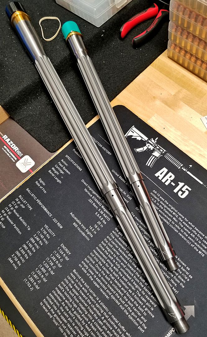

I know a lot of you have seen my various posts showing how accurate my Rainier Ultramatch 223 Wylde and 300 BLK (Shilen) barrels are. I've received requests from a bunch of the members asking me to test Rainier's new Ultramatch MOD2 barrels. Well wait no longer, Rainier went above and beyond and sent me 4 Ultramatch barrels in all the calibers I have been asked to test, Superlative Arms AGB gas blocks for all the barrels, gas tubes, and their new Nitrided 308 High Pressure BCG!!
I am really looking forward to testing these barrels to see how they compare to the original Ultramatch's. Rainier's Ultramatch MOD2 barrels are using high quality blanks and all the gunsmith work is top notch.
I have 1 product to review before I start testing these which I hope to be next week. With what feels like 6 months of straight rain here in the northeast, things have gotten a little backed up. I will be starting with the 224 Valkyrie first and have 250pcs of new Starline brass, Hornady 88 ELD-M and 75 ELD-M and 80 Amax that I will be using for the testing. I dont have any 90gr stuff but might pick some up and test later down the line since I cant test every bullet out there.
Here's some teaser pics. Stay tuned....
HUGE THANK YOU to Mike @RainierArms @Chicane556 for sending all this stuff over!!
Rainier 308 High Pressure BCG
Rainier Ultramatch MOD2 10.5" 300 BLK 1:7.5
Rainier Ultramatch MOD2 22" 1:7.5 224V
Rainier Ultramatch MOD2 20" 1:7.5 223 WYLDE
Rainier Ultramatch MOD2 22" 1:8 6.5 CM

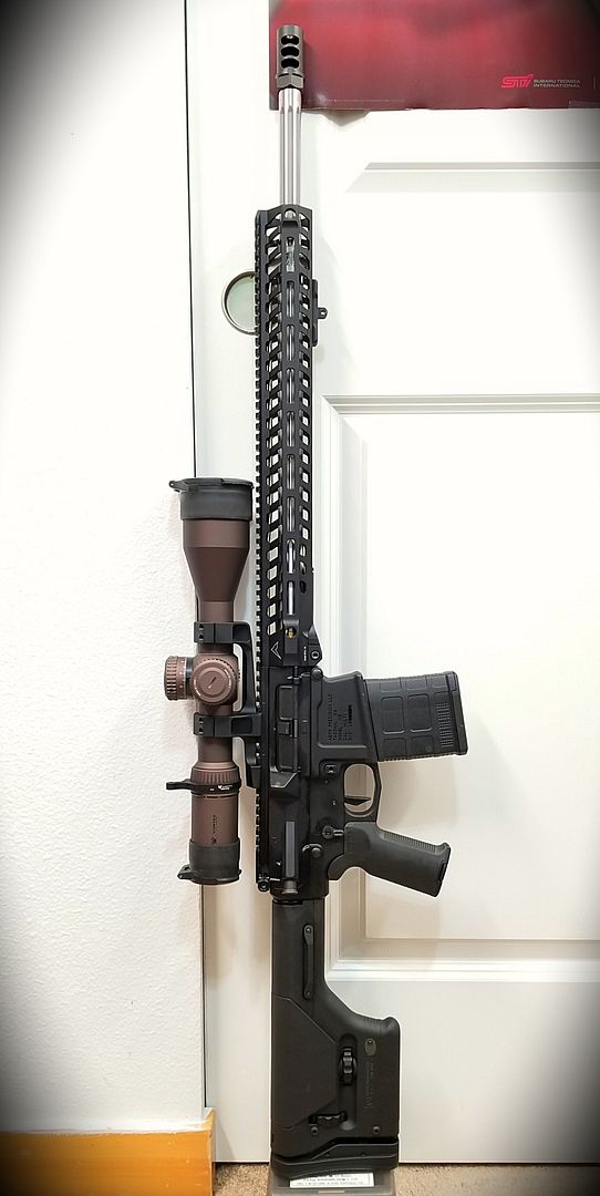

I own Two 16in Intermediate 223 MOD2 barrels and 22in 6.5CM +2 Rifle barrel.
AMAZING!
16inch is 1/4 MOA at 200 yards with 75gr HPBT Hornady and XBR and 22in 6.5CM just as accurate if I do my job behind the rifle.
Absolute Tack Drivers!

both of my 3gun rifles setup with RA MOD2 Ultramatch 16in Intermediate Gas, Superlative Block, JP LMOS and SCS with Hipertouch 24c.
I absolutely love XBR 8203 powder. I also found a node for under 1/2 moa with Hornady 55gr FMJ too. (.8-.9 at 200yds)

All four barrels are installed on their test guns and ready to go. Specs are as follows:
10.5" Rainier Ultramatch 300blk
BCM MOD4 Thermofit Upper Receiver
AeroPrecision SBR Gen2 Lower Receiver
Toolcraft Nitrided BCG
BCM Large Latch Charging Handle
ALG 8" Keymod Handguard
Rainier Arms/Superlative Arms .800: Adjustable Gas Block
Pistol Length Gas Tube
Rugged 3 Port 5/8-24 QD Brake
BAD Ambi Safety
Geissele SD3G Trigger
Spikes Heavy Buffer
JP Buffer Spring
Magpul CTR Stock
Hogue Grip
20" Rainier Ultramatch 223 Wydle
MEGA SBU Billet Heavy Upper Receiver
MEGA Billet Ambi Lower Receiver
Rubber City Nitrided BCG
Strike Industries Large Latch Charging Handle
YHM TJ Competition Series 15" Handguard
Rainier Arms/Superlative Arms .800" Adjustable Gas Block
Rifle Length Gas Tube
Rugged 2 Port 1/2-28 QD Brake
BAD Ambi Safety
Geissele SD-E Trigger
ERGO Tactical Deluxe Grip
JP SCS Gen2
Magpul PRS Gen2
22" Rainier Ultramatch 224 Valkyrie
MEGA Billet Nickel Boron Upper Receiver
MEGA Billet Ambi Nickel Boron Lower Receiver
Toolcraft Nitrided Bolt Carrier
JP Chromium Nitride 224V Bolt
Seekins SP3R V3 MLOK 15" Handguard
Superlative Arms .875" Adjustable Gas Block
+2 Length Gas Tube
BAD Ambi Safety
JP SCS Gen2
Magpul PRS Gen3
22" Rainier Ultramatch 6.5 Creedmoor
MEGA Billet Upper Receiver
Rainier Arms High Pressure 308 BCG
JP 17.25" MK III Free Float Modular DPMS/LR308 Handguard
+2 Length Gas Tube
BAD Ambi Safety
JP SCS Heavy Gen2
Magpul PRS Gen3
