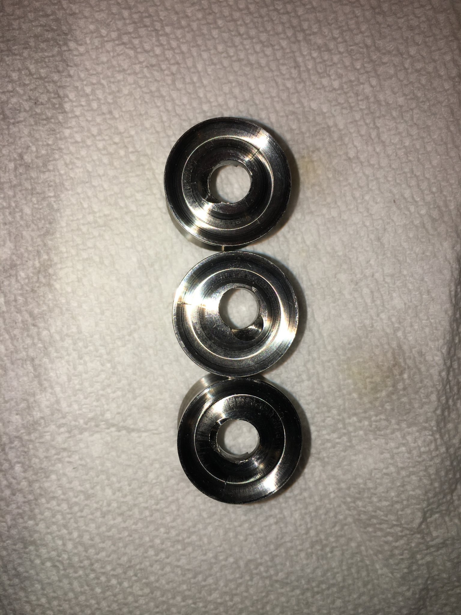

I started drilling baffles last night and wanted to point something out as an FYI. Using the drill fixture these are not 100% idiot proof. Apparently it depends on how big of an idiot you are being at that moment in time. The middle baffle is my second attempt. I guess I will put it back in the fixture and drill it again because it doesn’t line up with the others.
No way that's even possible if you had it inserted properly and the lid on properly. Did you watch the drill fixture video?
I watched the video. I’m not saying the fixture is bad or wrong, just that if you don’t pay attention you can mess them up. Just a word of caution to others to pay more attention to what you’re doing than I did.

What exactly did you do to cause this so others dont do it?
Im not sure on that. The first and the third are fine and the second is not. The only thing that I can think is that the baffle wasn’t fully seated in the drill fixture before I tightened the retaining bolt. I’m drilling more today so I’ll go slow and see if I can figure out where my error occurred.
Edit: just went out and played with the fixture a little bit. If you do not fully seat the baffle and tighten it is possible to tilt the baffle and not drill squarely. Once again, this is NOT an issue with the fixture. I think that I didn’t tighten the baffle before I moved on to the top piece. I drilled another baffle after taking my time and it came out perfectly.

Moral of the story;
Like anything machining, take your time and pay attention. Any distractions and you risk messing up a part that could screw a whole project.
If you can get that messed up one opened up concentric, just use it as your blast baffle maybe
Worst case I’ll order another baffle and redo it.
