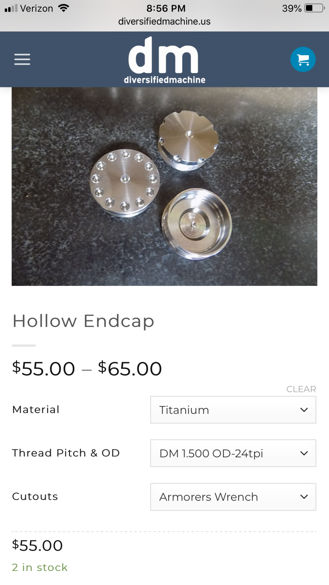

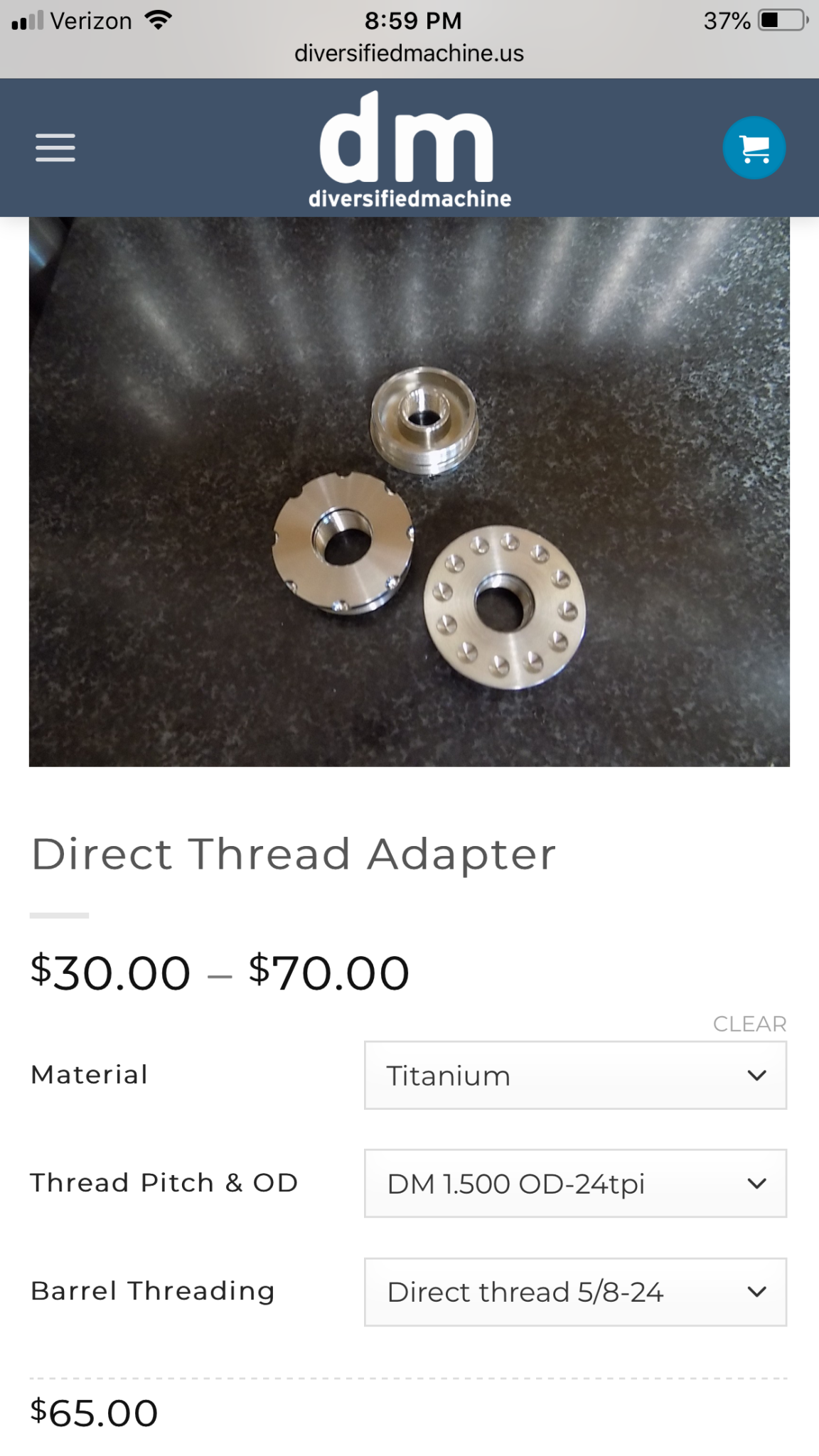

Are Ti. end caps only offered on the .22 traps ? . Can you get them on any larger traps like the 223/30 ?
I don't really mind heavy/rugged with volume @ 9" OAL x 1-5" . . But would really help shave a couple+ ounces off, the 2 pounds . as both those steel end caps are pretty heavy on the big Trap . the 2-steel caps together probably are 6 oz . on the 223/30 trap .
Kansas_Born
Belligerents
Sep 21, 2011
232
28
34
36
Avon, Indiana
You could always buy titanium end caps from another place. I found these in titanium.
