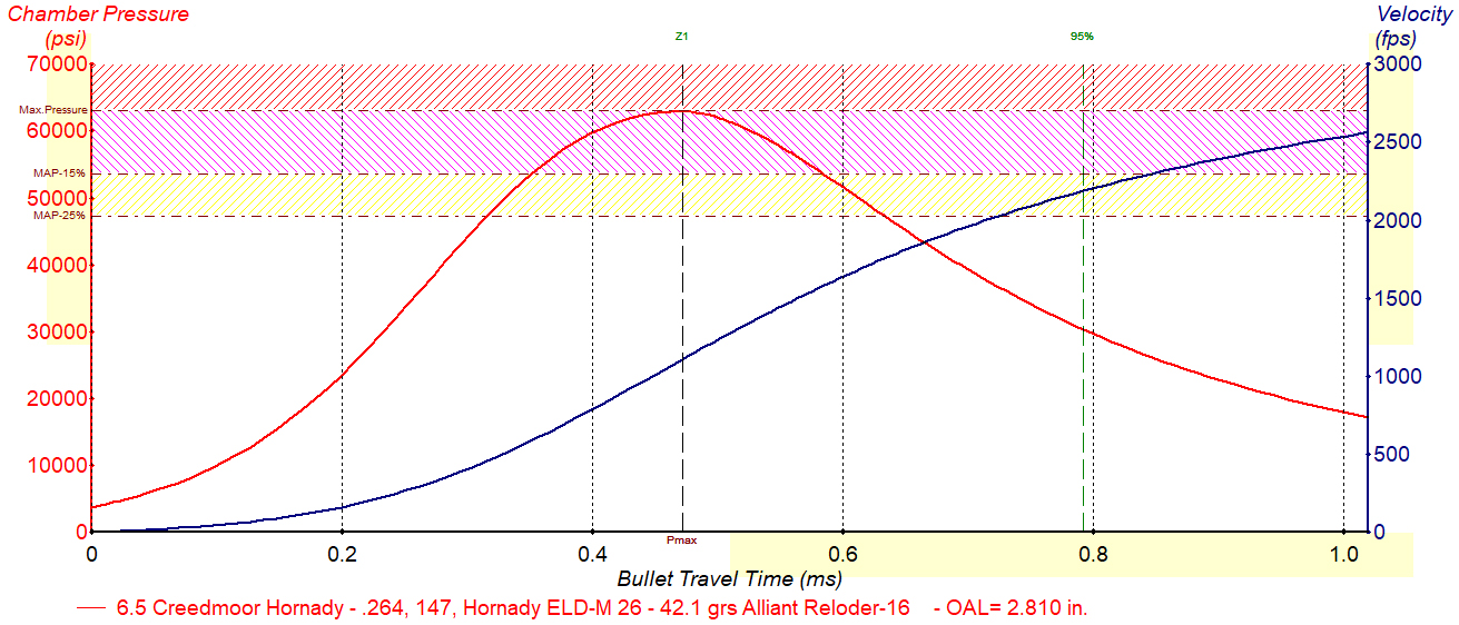

Code:
Case capacity and propellant properties may vary considerably from lot to lot!
**** Input data:                         Date: 10-Feb-2019     Time: 13:24:27
Cartridge................. = 6.5 Creedmoor Hornady
Projectile type........... = .264, 147, Hornady ELD-M 26333 with boattail
Max.avg.pressure(Piezo CIP)= 63091 psi   Shot start / init pressure = 3626 psi
Projectile weight      (gr)= 147         Groove caliber         (in)= 0.264
Length of cartridge    (in)= 2.810       Length of case         (in)= 1.920
Case capacity(Grains Water)= 50.60       Length of projectile   (in)= 1.420
Length of barrel       (in)= 16.500
**** Values calculated:
Seating depth          (in)= 0.530       Volume displaced   (gn H2O)= 7.13
Comb.chamber volume(gn H2O)= 43.47       Projectile travel      (in)= 15.110
**** Input data:
Propellant type........... = Alliant Reloder-16
Charge weight..........(gr)= 42.1        Load density......(g/cu.cm)= 0.967
Heat of Explosion  (cal/lb)= 411694      Ratio of spec. heats cp/cv = 1.244
Solid density    (gr/cu.in)= 406.4       Weighting factor...........= 0.5
Burning rate factor Ba(1/s)= 0.43        Pro-/degressivity factor a = 1.348
Burning limit ......... z1 = 0.6         Combust.Chamber Vb(ft³)= 9.966301E-5
Factor.................. b = 1.979       X-S.Area of Bore A(ft²)= 3.730893E-4
Bulk density     (gr/cu.in)= 226.6       Projectile mass mp (lb)= 2.099868E-2
Loading ratio           (%)= 107.9       Projectile travel x(ft)= 1.259173E+0
**** Results calculated:
Maximum pressure ........ = 62923 psi    Way of projectile at Pmax = 1.99 in
Muzzle velocity  ......Ve = 2561 fps     Muzzle pressure .......Pe = 15028 psi
Project. energy at muzzle = 2141 ft.lbs  Fraction of powder burnt  = 99.5  %
Projectile travel time from 10% Pmax to muzzle = 0.97 ms
Looks like you are right at "max pressure" at 62,923 psi. Not too bad overall. If it performs, run with it.

@AIAW wow thank you so much. I can’t believe what I’m seeing. Okay I need this program regardless of the hoops I have to jump through. That’s incredible. Thank you so much! Guys like you make this site and the shooting community better.

Oh, also give yourself about 5 percent on these factors. Powder can vary lot to lot about that much at the extremes.

Next step is to read Chris Long’s work on Optimal Barrel Time and see if your are on a node for a 16.5 inch barrel.
Note QUICKLoad is estimating exactly your actual velocity and that Pmax and Z1 are on top of each other. Both are good things.

Yes sir that's the basic idea, but I never adjust more than 5 to 8 percent. If I need to adjust more than that for the burn rate (Ba), something is off.
Contrary to popular believe, it's somewhat difficult to use QuickLoad for an initial load (outside of checking gross overpressure boundaries). You can sort of get close, but you're really just guessing at the burn rate for that lot of powder at a particular temperature. If you have a powder that has known to be stable from lot to lot then you can use a different load that uses that powder and as close to the bullet weight as possible as a baseline. The built-in Ba values in QuickLOAD are very good averages.
After you have a baseline of data into QuickLoad (fired brass case capacity, chrono data) you can really start to tweak it. Ideally you look for Z1 and PMax to be as close together as possible. Doesn't absolutely guarantee an accurate load but the chances are very high that you will be on or very near a node. Z1 is the point where the powder has stopped it's "active" burn. Ideally this would be where the peak of your pressure is (PMax). If PMax is way earlier than Z1 then you have a powder that is way too fast for that bullet. If it's way after, a powder that is too slow. All of these variable factor in while still maintaining an OBT (velocity). Speeding up or slowing down the burn or charge will change harmonics and of course, projectile speed.
None of this is fool-proof and set in stone to work every single time. It does however give you more focused areas to perform OCW or ladder testing around. Attached is the OBT Calculator Tool (Windows only) and the PDF table for various barrel lengths.
