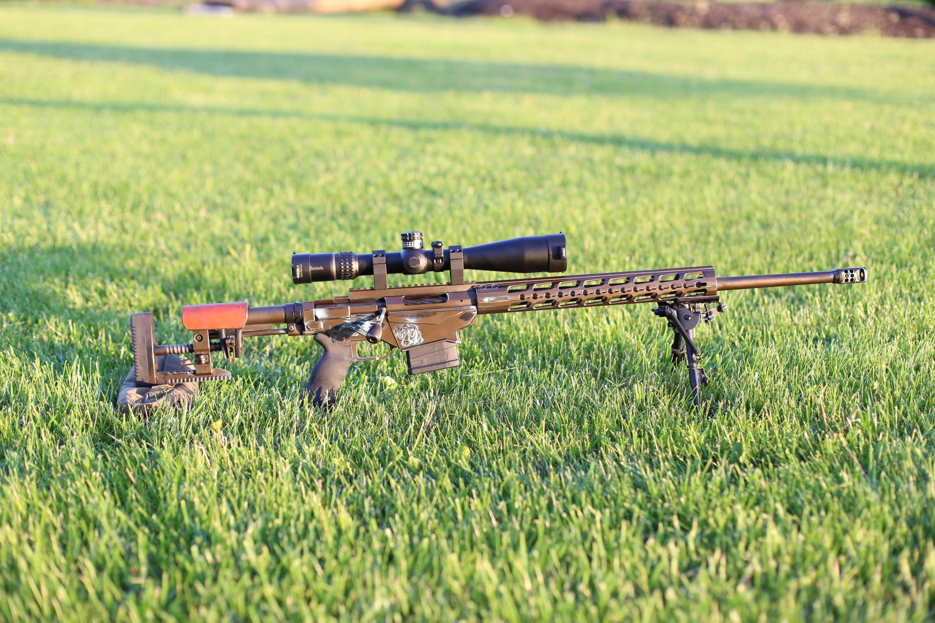

I was in the same boat. When I built my rifle my wife thought I was crazy spending that much on a gun. She went out and shot lr with me and was hooked.
Now she's got her own Rpr custom cerakoted, and she paid for all of it. She is a fan of the ar furniture also and likes the adjustability of the chassis over my manners. Just watch out when they outshoot you they let you know! 46B3B483-151F-4A62-99D8-8EF7D69125EC.JPG

Now she's got her own Rpr custom cerakoted, and she paid for all of it. She is a fan of the ar furniture also and likes the adjustability of the chassis over my manners. Just watch out when they outshoot you they let you know! View attachment 6875928
Good looking rifle. She's definitely got it tricked out. Mine finally made her mind up. We're going to get her a Seekins SP10 in 6.5 Creedmoor. It'll be a couple months out but shes pretty excited. She already wants to get it cerakoted another color.
