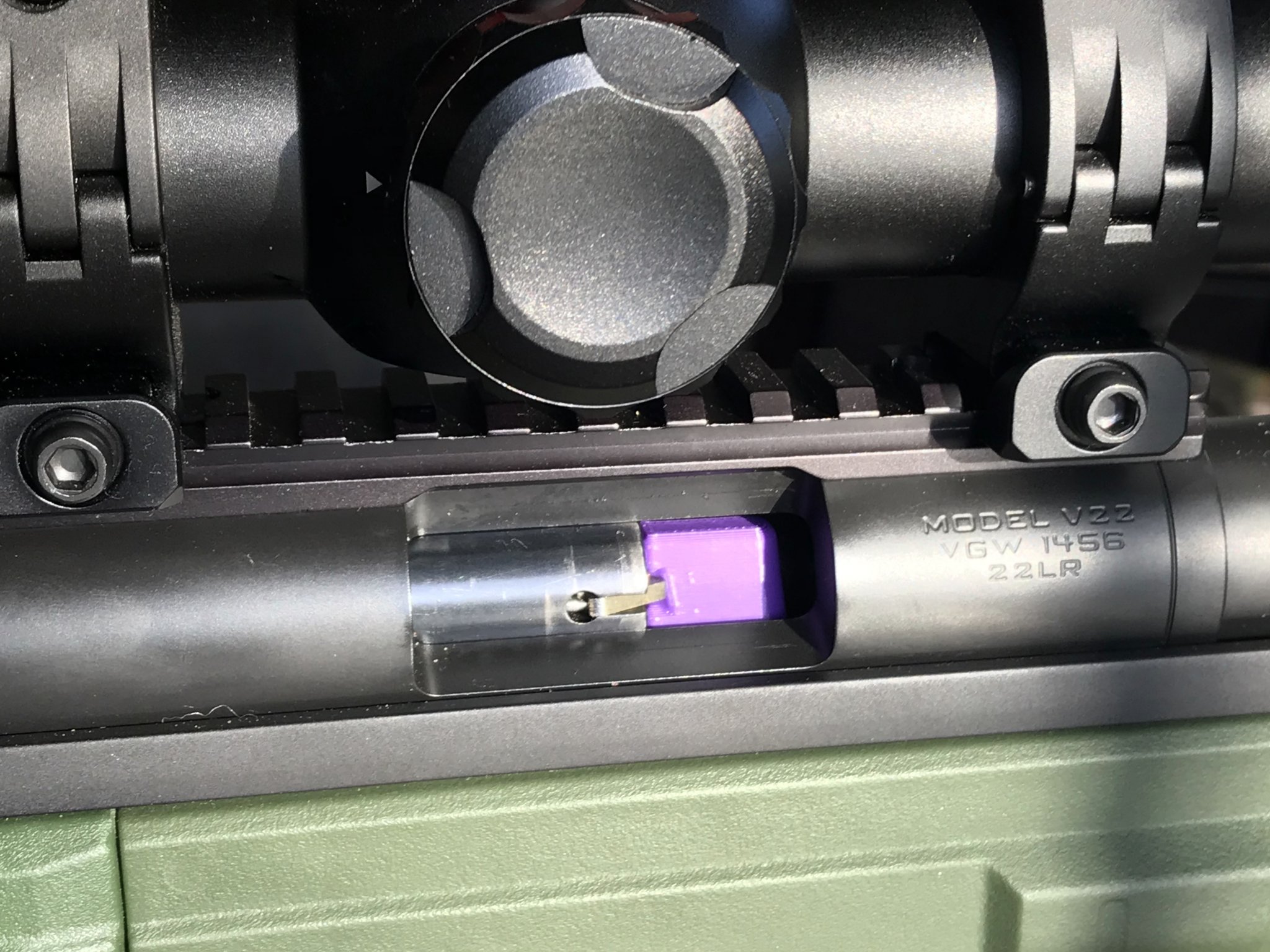

We started with a plug for the Rimfire V-22 from Vudoo Gun Works and then designed the solution below......What do you think?
January 21st Update:
The 700 Rem plug is nice but only compatible with the original 700 Remington action. With all the request for specific action and chassis, I have taken the design a different direction. We NOW are compatible with all Short Action 700 style actions including Vudoo rimfire and chassis that accept an ACIS mag!!! This is huge leap forward in compatibility for Yow-Tech. The "Mag Flag" is a bit unconventional but it checks all the boxes below:
  • Prevents loaded mag to be loaded
  • Indicates that bolt is blocked with bright color. Safety Orange, Red, and Yellow options.
  • Mechanicaly prevents bolt from moving forward.
  • Has holes that indicate there are not rounds in this plastic thing
  • Safety indicator flag included of your choice in style and color (see site for options)
  • California compliant (0 round mag??)) ha ha
Pre-Orders to open this week on Yow-Tech.com. Thanks for looking...Yow

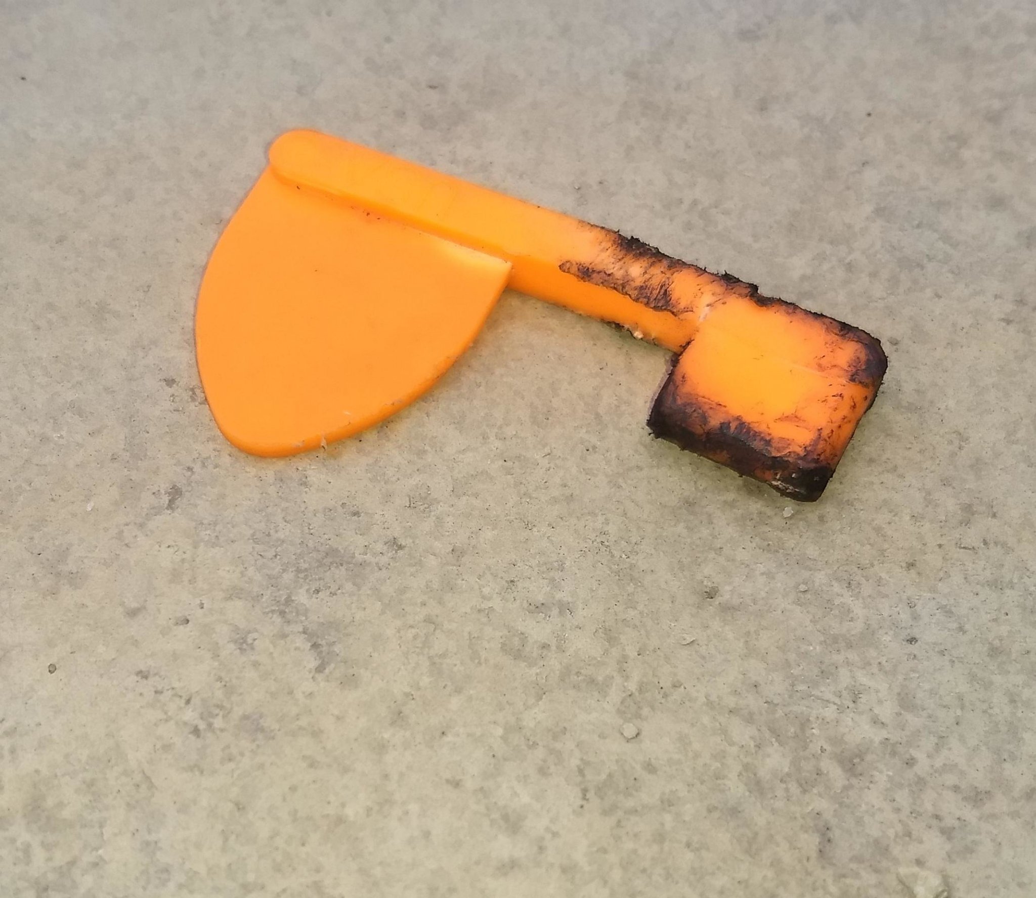

We were getting tired of loosing chamber flags when moving my rifle from the shooting line to storage stand. I am also not a fan of jamming plastic in a hot hole....I said plastic!!
We designed an innovative snap in - snap out chamber block that will also prevent the bolt from moving forward. In combination with our one piece and sprung design we include several flag choices to insure the RO (range officer) will be off your back.

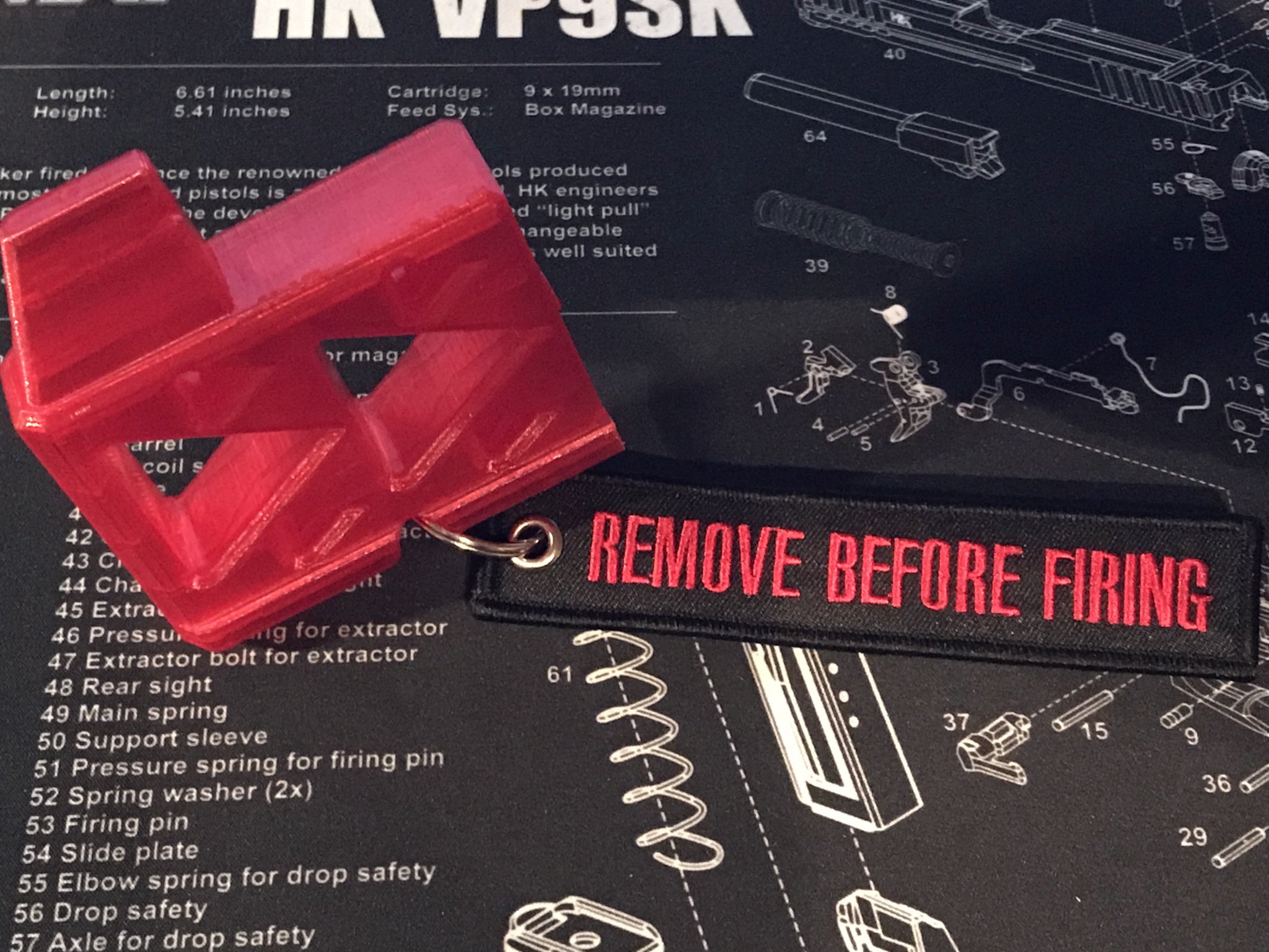

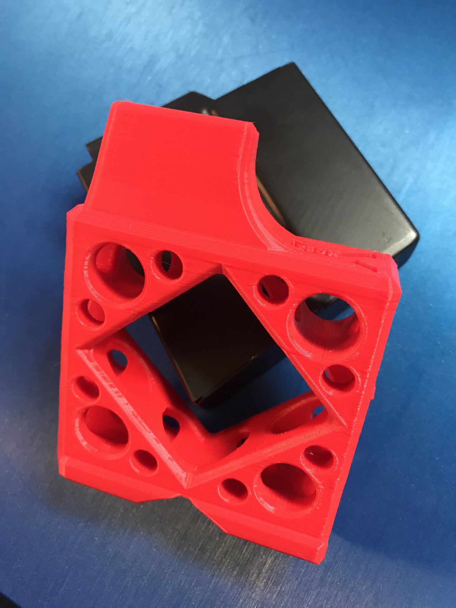

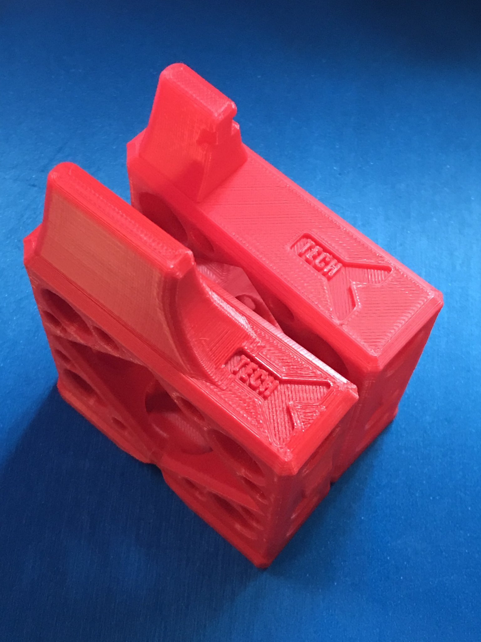

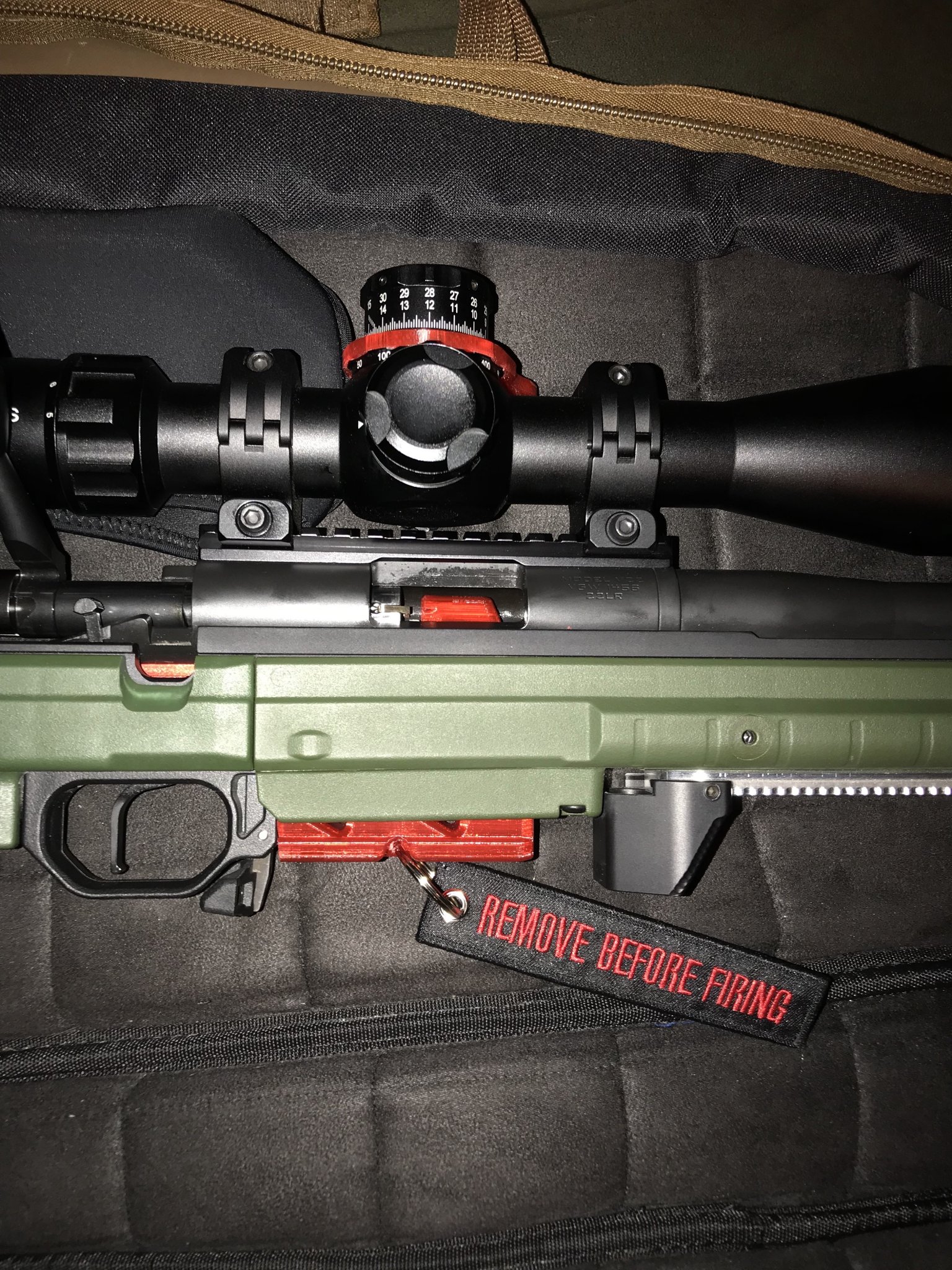

So I am testing a few more chassis but this new design will fit into any chassis compatible with an AICS mag. I have confirmed it in a Whiskey 3 Gen6.
Keeps the bolt back
Snaps in until mag release is pressed to release
Has flag of you choice attached
Impossible to have mag in at same time (not sure this has to be said)
Available in Safety Orange, Safety Red, and Safety Yellow.
Not the red in the pics below is translucent and this is not the Safety Red color offered.
Pre-Order soon on Yow-Tech.com!!!!

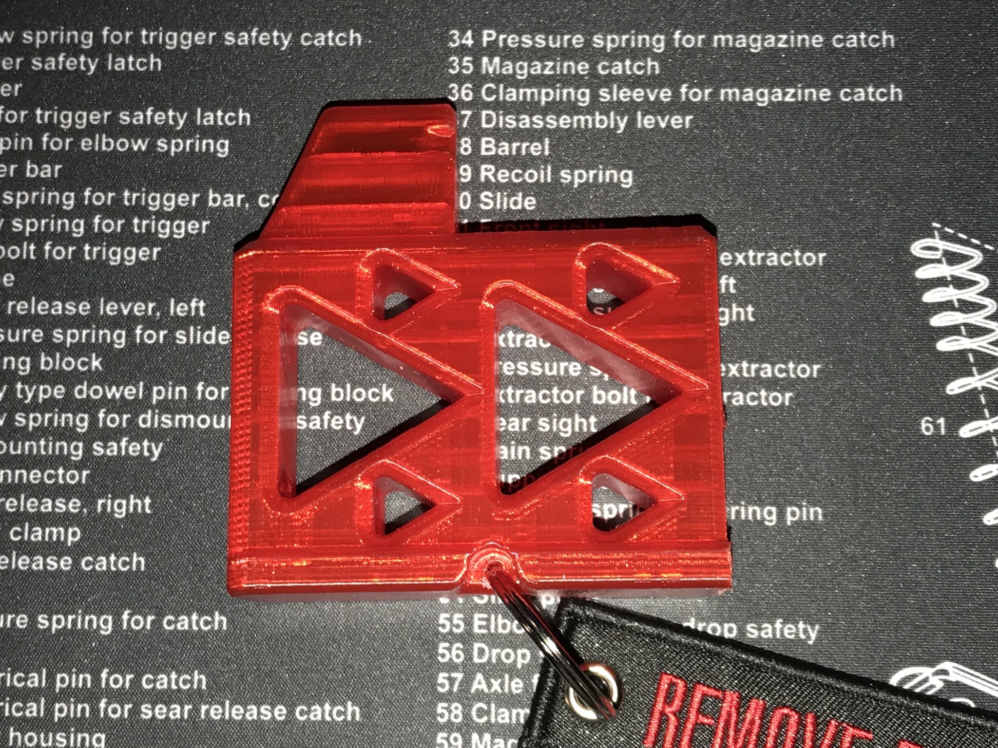

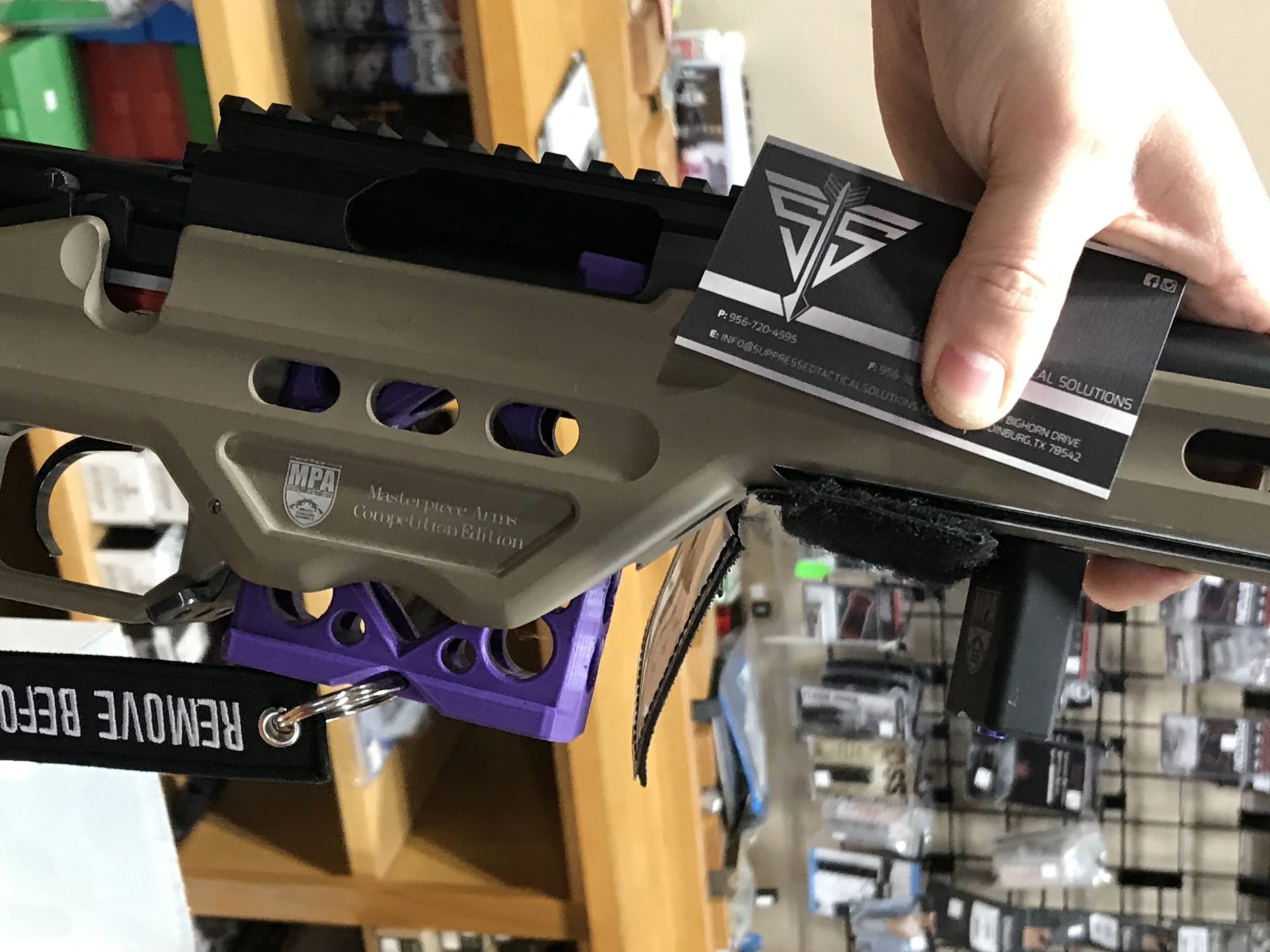

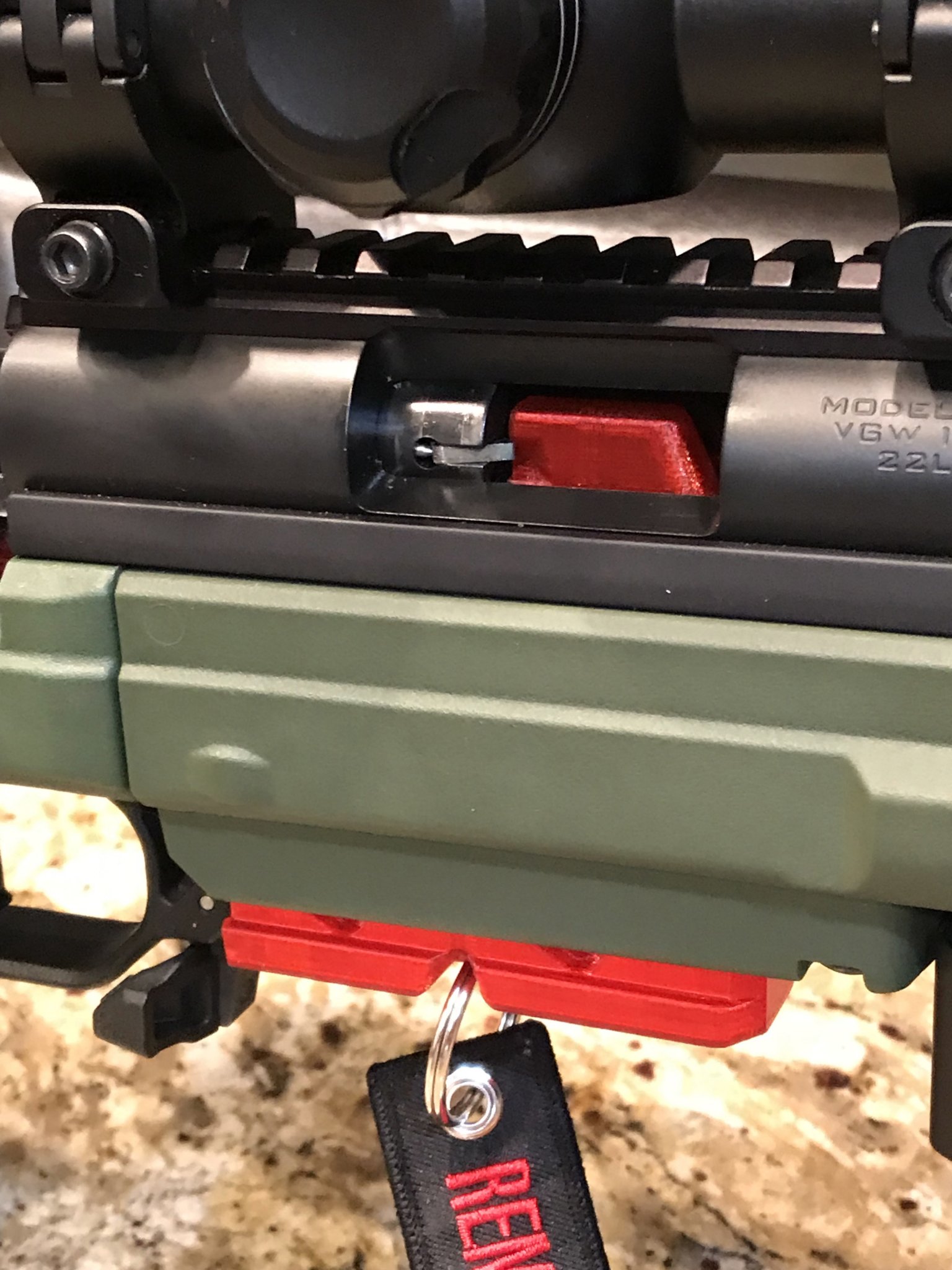

Confirmed fitment into MPA and Accuracy International ATAICS Short action chassis today.
The Revision 6 changes increased the height that matches a 5rd AICS magazine and I increased the size of the bolt stop to plug ejection port as much as possible to minimize dirt and dust contamination of action and chamber.
So full list of confirmed Short Action chassis:
KRG Whiskey Gen6
MPA BA
AI ATAICS 0.308

The top of the Mag Flag extends up into Bolt and one can not insert the Mag Flag without the bolt back. When the bolt goes back it extracts the round spent or not. When the Mag Flag is locked into place with magazine catch the bolt can not be moved forward.

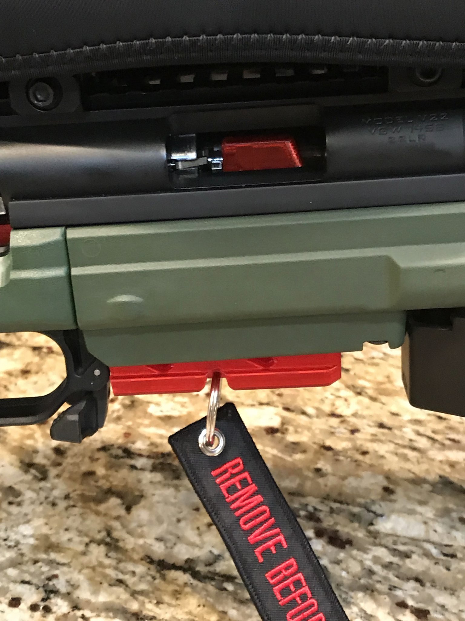

I’ve been trying for the past two days to bypass the bolt stop. It simply will not budge.
The absolute only way to unblock the bolt (and by virtue, the firing pin) is to hit the mag release and drop the device.
The only thing I can see that could be improved as others have said, is some way to keep dirt and dust from entering the chamber.

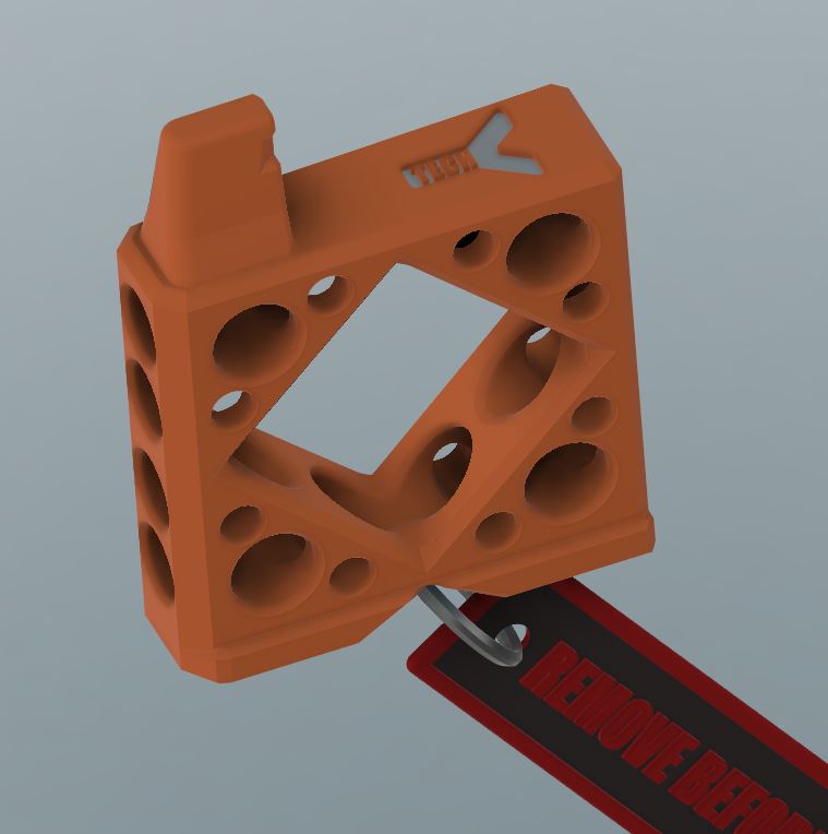

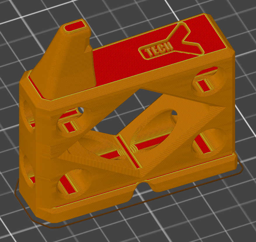

Based on structural FEA and field testing from folks on the forum, we have strengthened the bolt stop, as well as, changed the manufacturing parameters. See picture below for the new design with old version in back ground. This change has been implemented across all three MagFlag versions (Vudoo, AICS, and AW).
