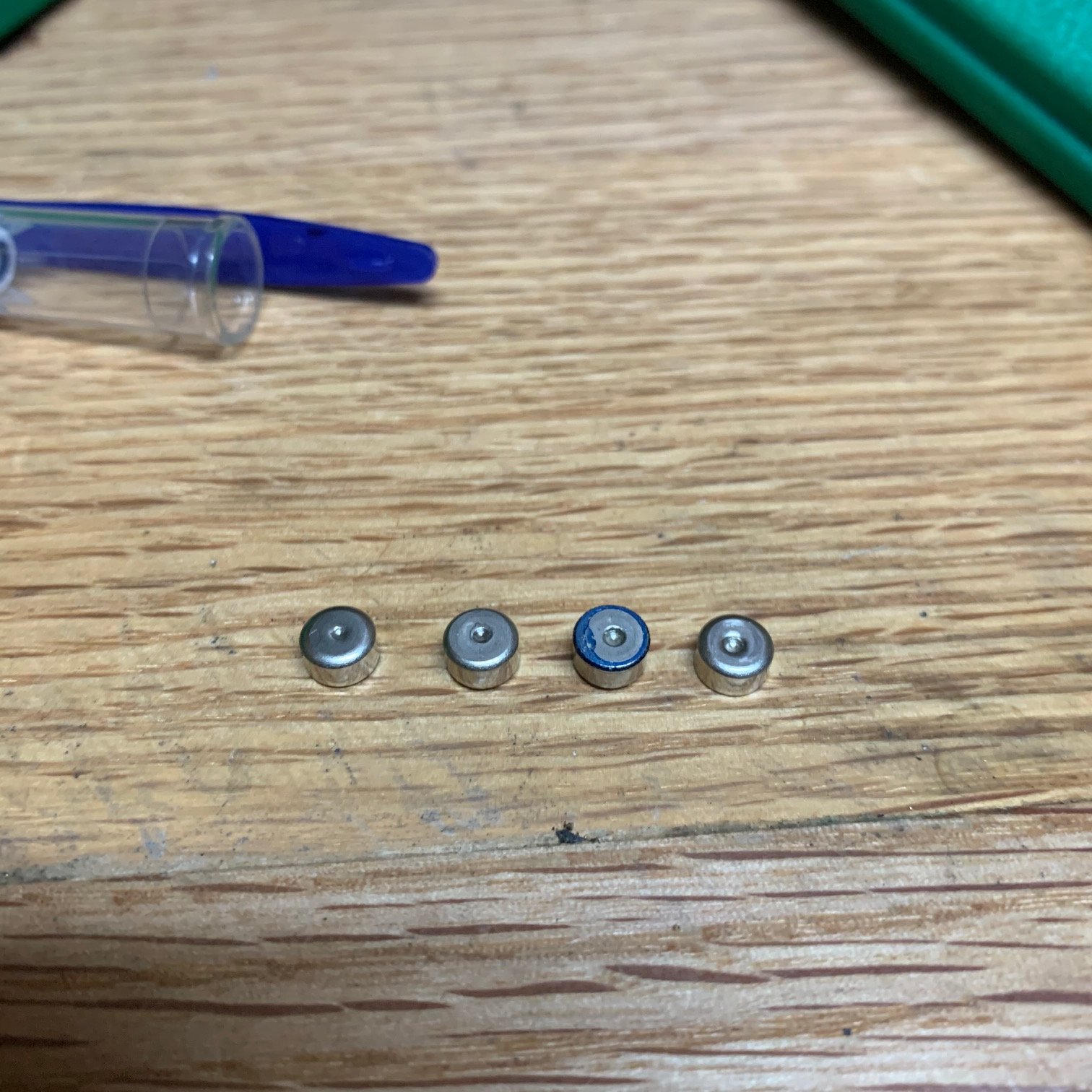

Ok. Yes I'm new to this board......but I've been reloading for 35 years so I know a little about the how. So, here's the deal. I have 3 Bergara's. In the last month I bought an Approach in 7mm Magnum and a Highlander in 6.5 CM. On a hunt 3 weeks ago I took my son to Oklahoma. Using the Highlander and my reloads (Lapua small primer brass, 127 LRX, H4350 and CCI mag primers). We hunted 4 days and on that last morning a nice 10 point comes in. Son readies the gun.....click....put another round it.....click again. I dug another round out that was in my pocket, slammed it in and it fires. Ok, so i blew it off that since we left the rounds in the magazine of the rifle over the last 3 days maybe the heat, thaw, heat, thaw had an affect with the small rifle magnum primers and it was an ignition problem. So back to Texas and started to reload for the Approach in 7mm Mag (Nosler Brass, Rem brass, Retumbo, H1000, RL 22, RL 23, 168 VLD, CCI 250 primers). Over the course of all these loads and combinations that I was working on I had 12 miss Fires on at least once on all the powders and brass.
Background, my reloading bench is setup in an insulated shop but.....there is not heat and only air and some of the powders I have had over a year. Unopened.
1. Could it be the uncontrolled climate affecting primers or powder? Am I keeping the powders too long without using them?
2. I played with the seating depth to a point of leaving the primers flush and even protruding slightly out of the brass. I even seated the primers deeper than normal.
I just need help with some more thoughts and more knowledgable experts than myself.

Can you pull some of rounds that didn't go bang?
If so, you can look to see if the primer went off and didn't ignite the powder, or if you got some bad primers. JRB did a video series on 6.5CM hangfires where he found poor ignition with some combinations of powder and small rifle primer. He pulled them and you could clearly see the primer had worked but did not ignite the powder.

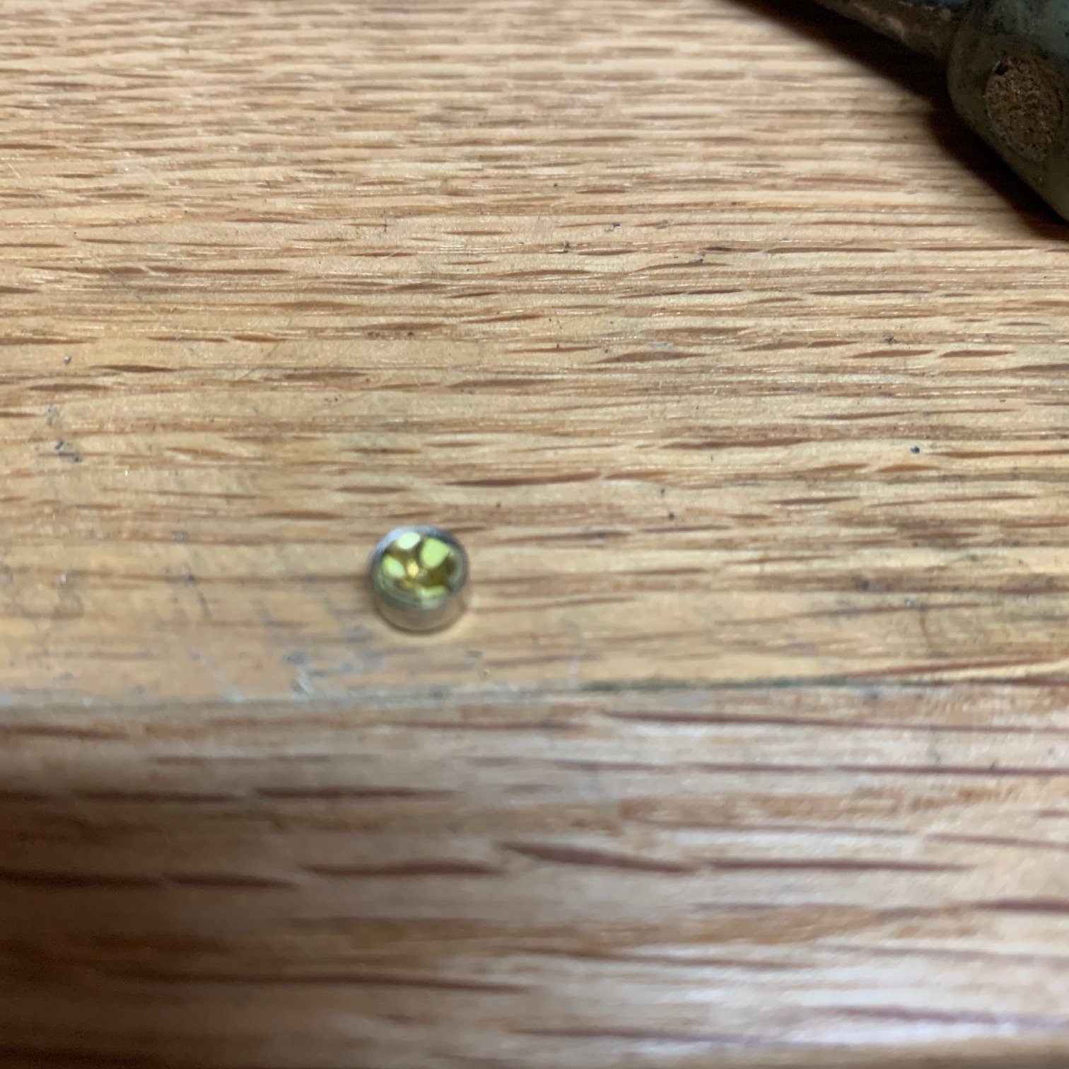

Ok....just pulled a bullet from one that just now did it. The primer is in tack and never fired. So It's got to be something going on with both the bolts of the 2 guns I'm guessing

for sure seat the primers just below flush. My guess is you are using some of your firing pin energy to seat the primers to the bottom of the cup and it's not leaving enough force to ignite the primer.
Check the factory loads, but typically the primers are just below flush and definitely never should be standing "proud" of the case.
I've had primers that got a bit wet from flooding and they always went bang. IMHO it's hard to make them inert, so my guess is it's the seating of the primer that's causing issues. Heat and humidity can affect the powder but sounds like primer depth is more than likely the culprit.
what do you use to seat the primers?

Check firing pin protrusion, head space with a gauge, and actual head space of your reloads.
If you bump the shoulder of your reloads back too much your gun will test OK against the no-go gauge but will not set-off the primers in your reloads reliably because the firing pin tip cannot reach far enough into the primers.
Your primers need to be seated firmly against the bottom of the primer hole in the case. Otherwise, firing pin energy will be depleted while pushing the primer down until it contacts the bottom and then there is not enough kinetic energy left to indent the cup against the anvil and ignite the compound.
Edit: Your photos show light strikes. Check the conditions I listed above.

Yes I reload for around 20 rifles. All my rifles are factory rifles. Bergara are the last three I've purchased and they are the ones i'm having an issue with.

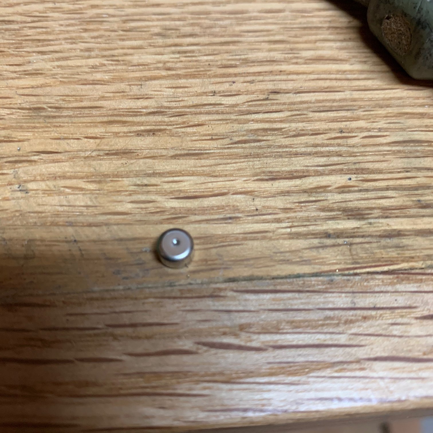

Yep, that primer strike looks lite! Can you measure firing pin protrusion on the Bergara's vs the ones that fire OK? I've found variances from several factory rifles from .043 (Savage) to .063 (Ruger). Everything has gone bang so I haven't needed to change anything.

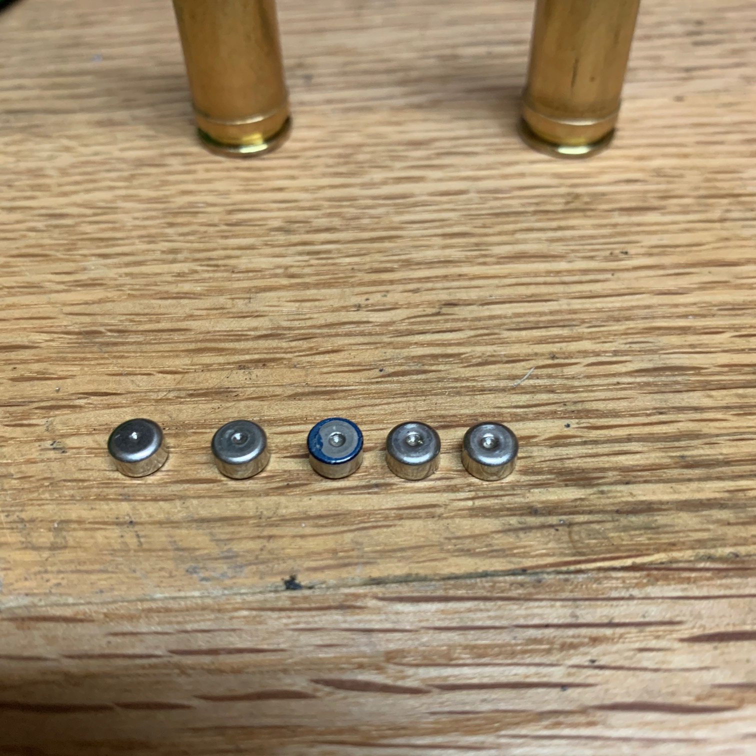

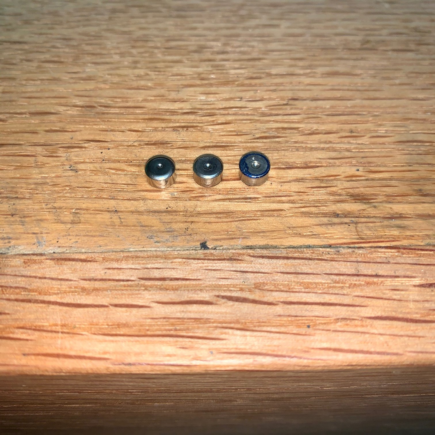

OK. Take a fired, unsized case that was used in the rifle you are having ignition problems with. Knock the spent primer out with a decapping die or a pin punch, reprime the case (no powder, no bullet), chamber and fire that primed case (pointed in a safe direction).
Then show a photo of that primer compared to the others with the light strikes.

One step further....the new one on the far right in this pic is from a fully sized once fired brass. So there is one not sized and one sized shown.

A lot was tried and posted since I suggested to reprime and re-strike a case that was fired from the rifle but was left unsized.

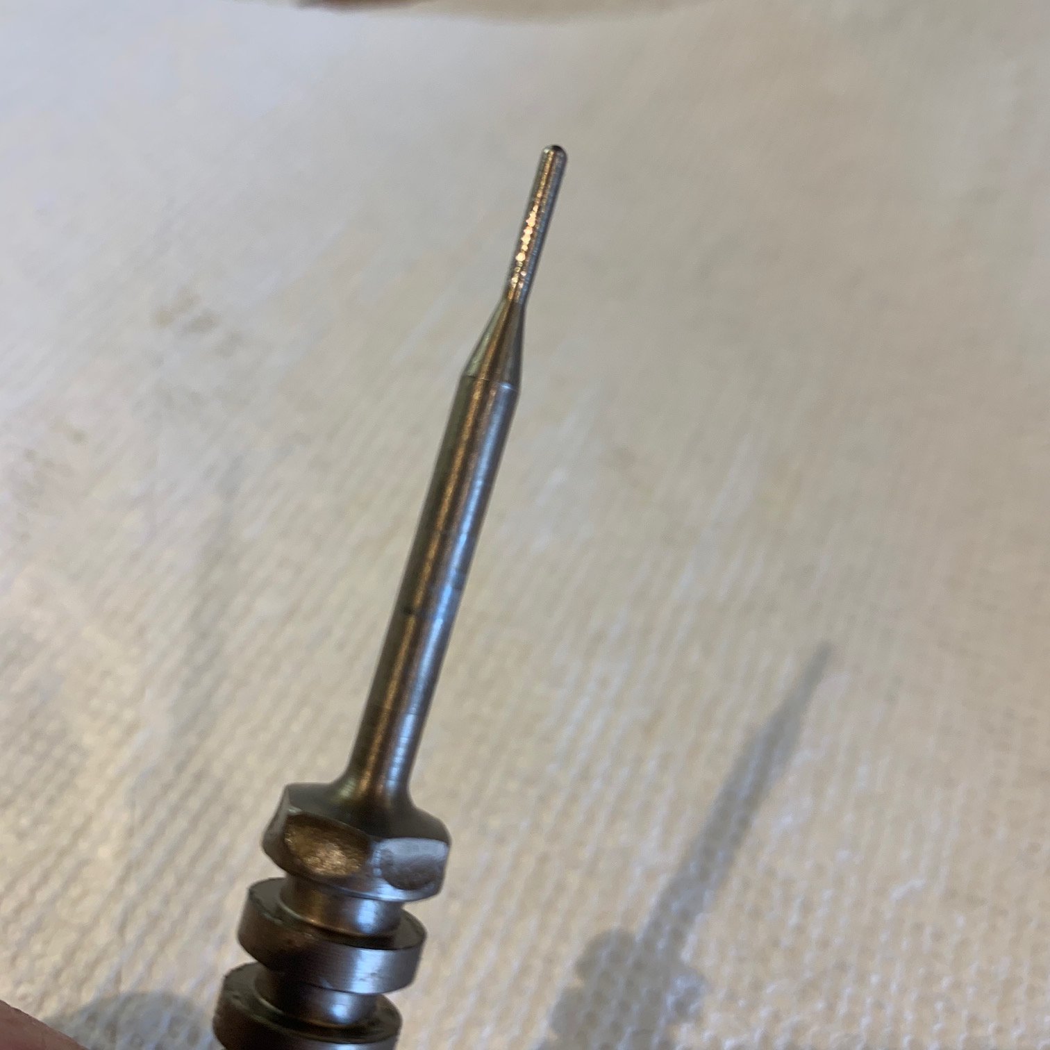

Seeing the results, I also suggest taking the bolt apart and checking/ cleaning firing pin and the inside of the bolt.

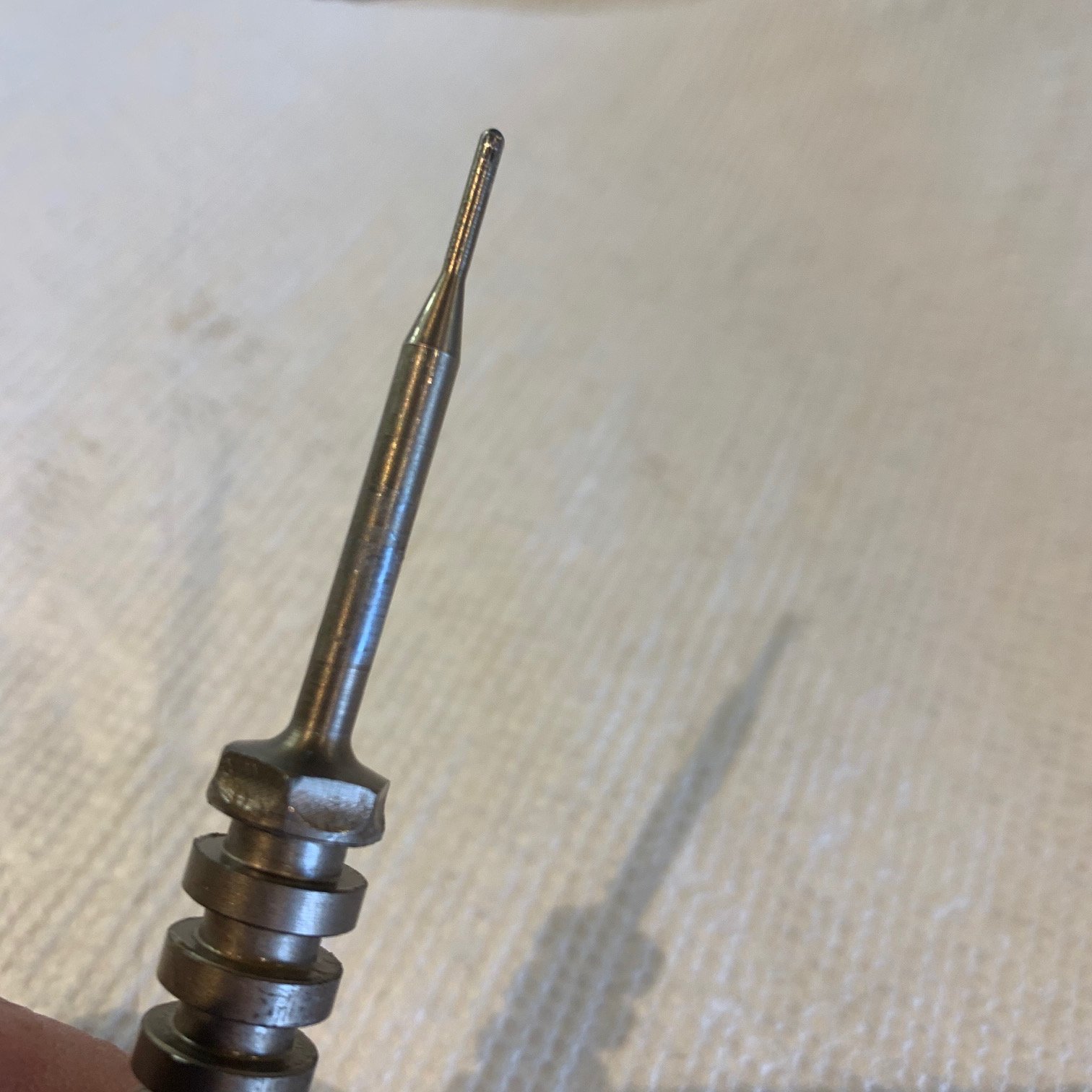

For grins i pulled the firing pin from the bolt. I noticed that one side of the firing pin was bright shiny rough and the other side was fine. The two pics show this. So maybe the firing pin is rubbing just enough on the side that it is slowing it down some.
