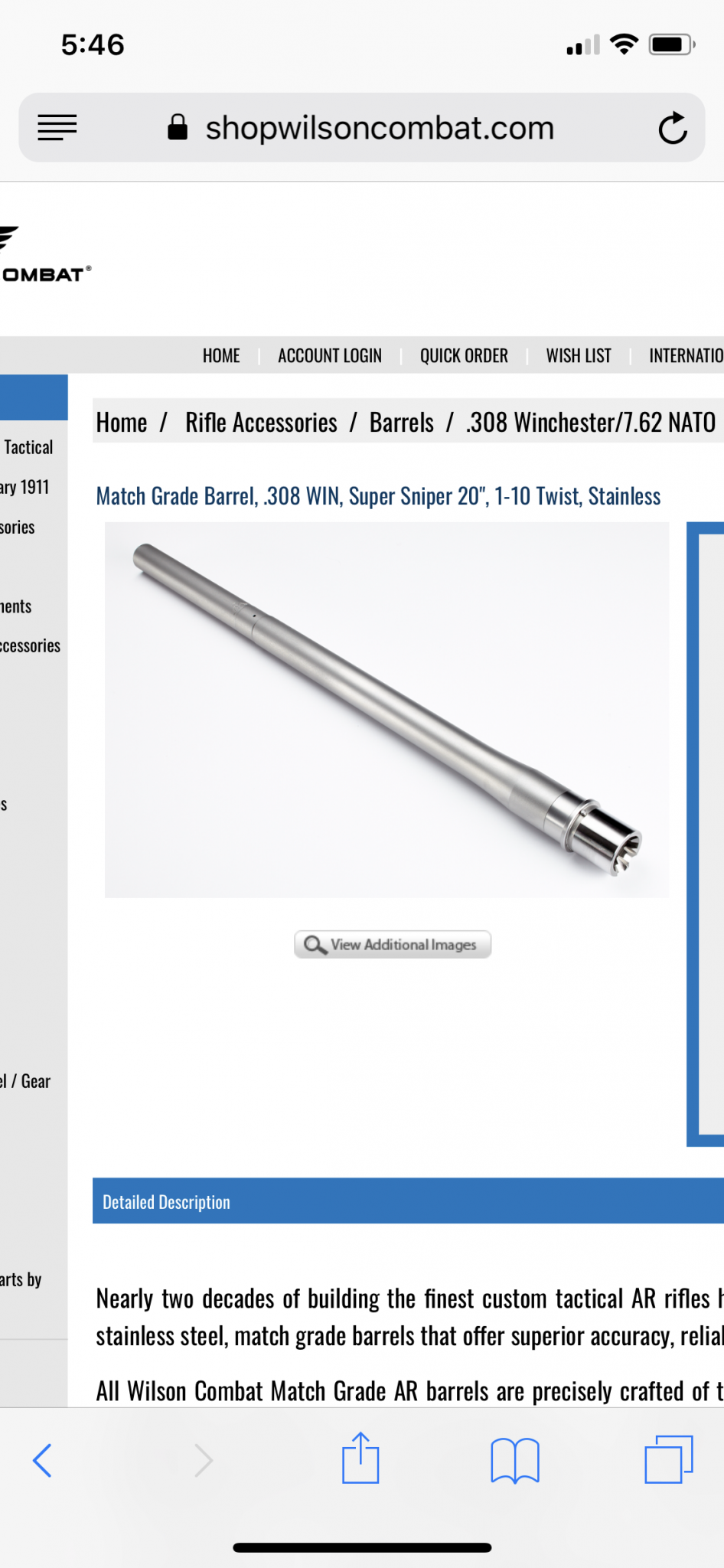

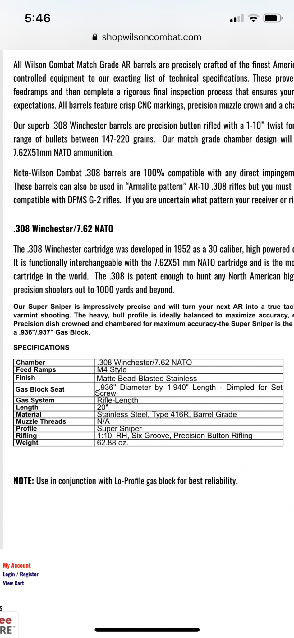

Wilson arms is different from Wilson Combat. Wilson Arms is who Padom was talking about. I have one of their 18” as well. Never tested it too much. But it was a nice shooter.

Wilson Combat is what I would try if I didn't already have too many barrels. ARP is another one that might be a good choice if available.
