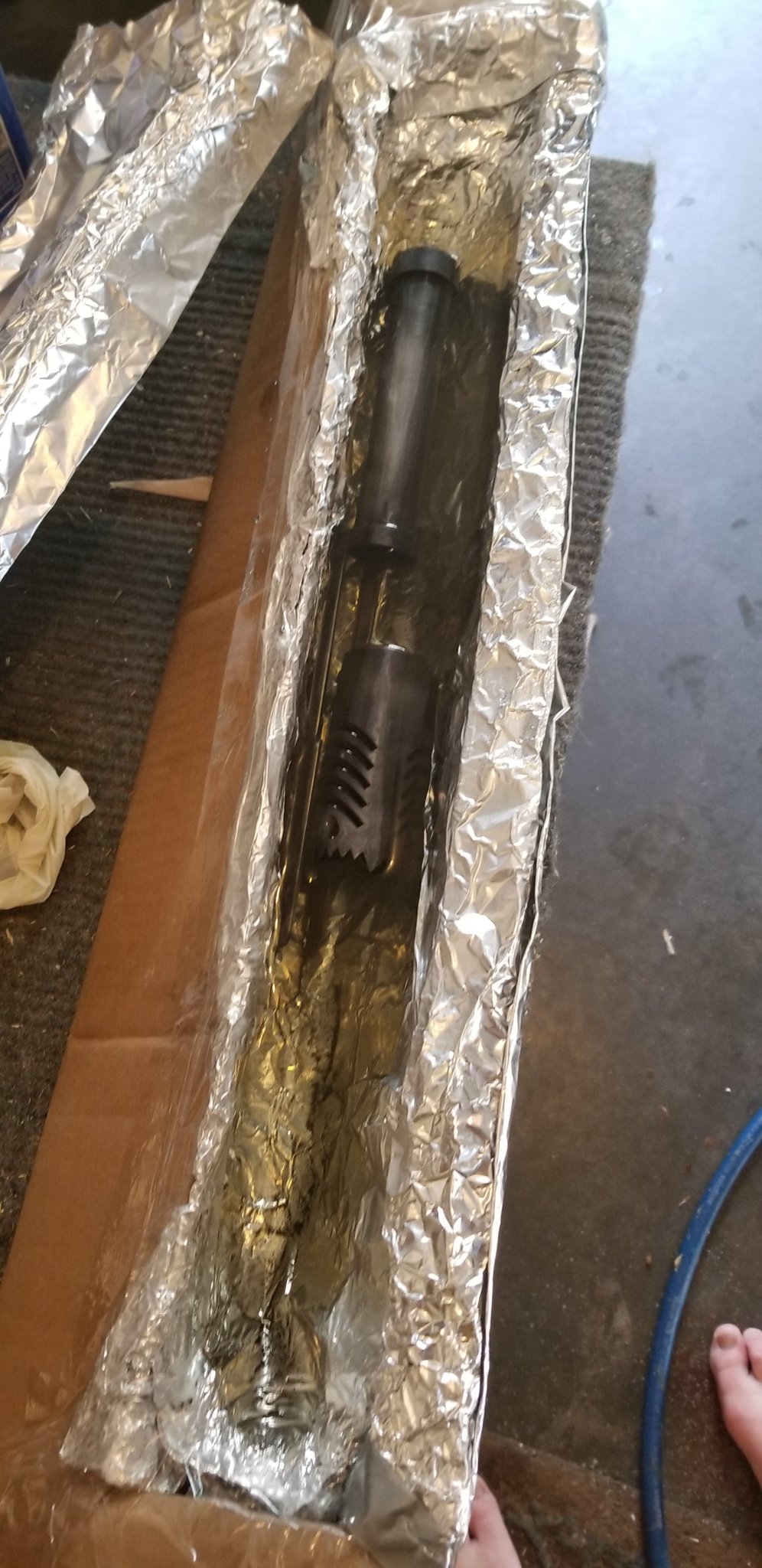

#39
here is a redneck soaking tub for long items that I made today for Shotgun that I am cerakoting.... worked great and only used 2 pints of acetone which I recovered over half.
