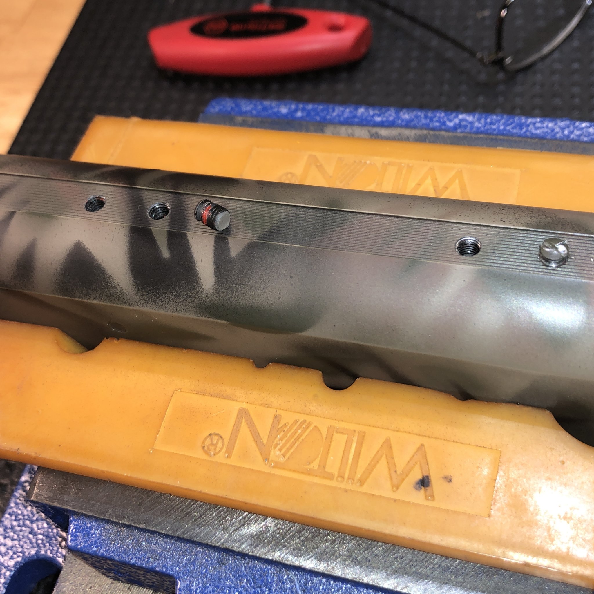

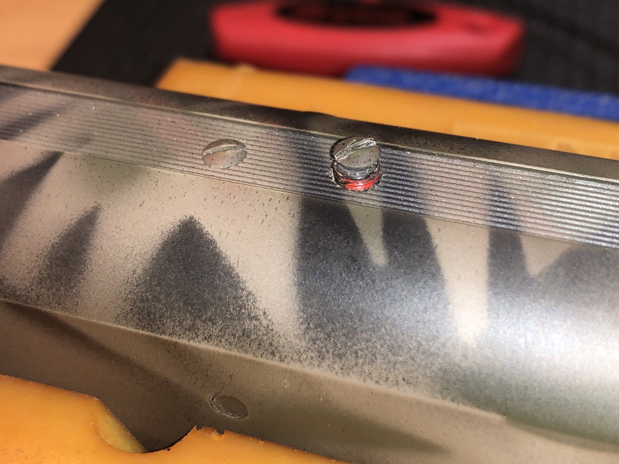

yes. i recently just sent this shotgun off for cerakoting and i am glad i installed these plug screws in the receiver!
