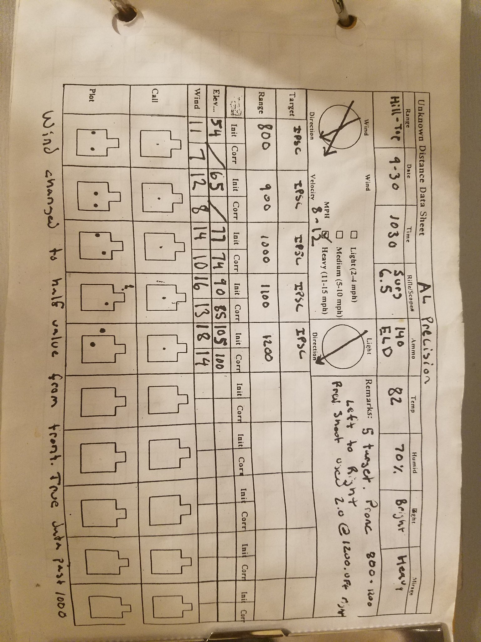

Sorry this took longer than expected. I decided to load a bunch of ammo last night so I haven't gotten back to this comment until this morning.
Like yourself, I have made the transition from mediocre Highpower shooter to mediocre PRS shooter. One of the things that I learned in Highpower, but haven't really applied to PRS is keeping track of thoughts and information. I really need to start keeping a databook for PRS matches because of how invaluable it can be; especially as a learning tool.
Strong Wind (15mph)
I stole the idea from a data-sheet for the "British Wind" table which was for 7.62 which basically was a strong wind will move a bullet 1 MOA per 100 yards. So it was 100=1 200=2 300=3 etc. It's something I learned when I shot M14s for fun. I converted the idea to apply for Mils and 6.5mm bullets. Basically, I count by 2s from 100-300, and then by 3s out to 1000, and by .4s after that. I am also fairly certain that a couple of different professional instructors teach similar methods.
The whole purpose of the exercise isn't necessarily to give you a direct output, but more to directly visualize how much your bullet is going to be moved. The idea is to take your strong wind as your benchmark and then reduce those values to 1/2 and 1/4 for a Medium, and Light wind.
A 15 mph wind is going to be a nice day at the beach, or just fast enough to make the Georgia heat actually pleasant. Also according to the Beaufort scale, it will raise dust and paper, so it's probably also going to be the point where you start putting an ammo box on your match-book to keep things from blowing away.
A 7 mph wind is right about where leaves of trees and grass should be in constant motion. It's also the point where the gnats have gone away 20 minutes ago but you haven't noticed.
A 3 mph wind is where you can feel it, and you are wondering why the gnats are still there, and why are there even gnats in the first place. It will also move grass and smoke, but it might be difficult to determine direction.
Sorry, I was just remembering all the gnats at the last match I shot.
Wind Bitch Method
Working with other shooters is a huge advantage. Good shooters tend to group together because they know it gives them an edge. Having the equivalent of a Highmaster shooter come off the firing line and tell you what he just used for wind is a huge advantage. When I am actually trying to be good at a match, I will try to squad with good shooters because the information I get from watching good shooters shoot is immediately valuable.
If the match allows for it, I will try to watch someone shoot through a spotting scope, and then ask them what they used for wind. It helps confirm or deny the wind plan that I would have came up with if I was shooting all alone, or didn't have someone to use as a wind dummy.
Databook
I've moved away from keeping meticulous data at matches due to laziness. However, it is something that I am going to start doing again because I think that it gives you a huge edge in collecting your thoughts, preparation, and self-reflection. Writing things down on paper in a format that is easy to come back to can pay off huge dividends when it comes to breaking the learning curve. Attached is a picture of a generic UKD datasheet that we used to use. It's basically an adaptation of Highpower. It doesn't have to always be filled all the way out.
All of the stuff on top is basic information that should be familiar. This is part of our planning phase for a stage. In our target box, I wrote IPSC, but I also sometimes draw the shape of the target.
In the remarks section, I put basic info about the course of fire, and that the previous shooter used 2 mils of wind at 1200 and that it was off to the right.
There is an elevation and windage box. I write in all the data I intend to use for the stage, and then any corrections I made. In this case, my data past 900 wasn't correct for elevation, so I put in that I basically had to hold .3 to .5 low to be on targets past 900.
I also had one of my friends watch my trace through his spotting scope so I could have some information on where my shots were going. If I don't have friends, I try to ask the spotter things like "Was I hitting high or low?" "Where were my misses?" Usually most will give you their best assessment and that gives you information to go off of.
At the very bottom is final notes. It says that the wind changed to half it's value, and that I need to make sure to true data past 1000. It's basically a final recap of my thoughts immediately coming off the line.
So what other advantages does the databook give me? It allows me to mentally prepare for the next match by re-shooting this one. Chances are if you shoot a decent bit, you are going to shoot at the same venue more than once, and the stages are going to be similar. I can look at my notes on Alabama Precision or Core and have an idea of what would make my next match better. I know that in Alabama, I would prefer to shoot the longest range stages first because the wind can get really bad in the afternoon. I know that at Core I will probably bust time on the shoot house stage, and that focusing on getting good shots is the best course of action for me. I also know that at Core, I have done pretty well on the rocks stage by just putting the Gamechanger bag on everything, and held slightly low the last time I shot, and it worked pretty well.

Also, thanks bangbangblatblat for the tips on your data book and THANK you for posting a pic as well!
