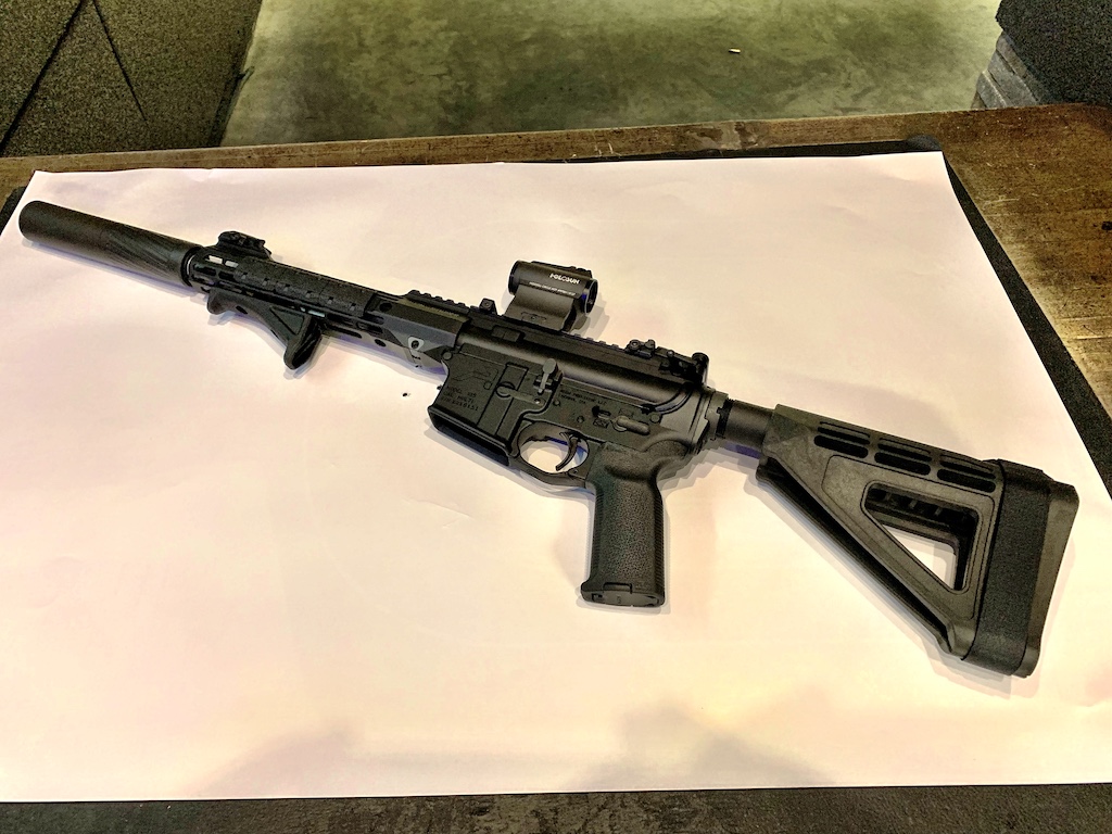

I am at the shake-down stage of my first pistol build. It's a 10.3" 300 Blackout that will run suppressed 100% of the time.
The SBA3 should work fine with your existing buffer tube. That said, I would also look at the new SBA4. I have the similar SBM4 that is not adjustable and get a really good cheek weld with it.
It's hard to say is the JP buffer setup will work without knowing the gas system length, caliber, whether it will run suppressed, etc. Part of my shake down has been running various buffer weights to determine what will operate with 100% reliability. That said, they are all standard carbine buffer components. Nothing special for a pistol. Your mileage may vary since you have an adjustable block.
As mentioned before, just make sure the lower was marked "other" on the 4473. Also, be aware of the opinions by the ATF on foregrips that can be installed on pistols depending on the overall length.

Sorry, should’ve added that info earlier... carbine gas, chambered in 5.56, and for now at least, I will not be running a can on it. Just gonna throw on a Lantac Dragon for the time being.
