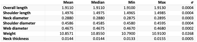

Even though it's a little old, I thought I would contribute back to this thread since it was one that I read before I placed my recent Peterson order. In my case I picked up 500 SRP 6.5 Creedmoor. The cases appear to be very robust. Flash holes are cleanly cut and uniform. At this point, I only intend to chamfer the case necks and then load them up. I took several measurements of a 10% sample and the dimensions appear consistent across the lot. At this point, they're on my short list and I intend to buy more.

For sure. Everyone establishes their own case prep methods that work best for them. In the end we're all just trying to eliminate variables. My aim was more to share that after inspection I found that Peterson produces quality brass with consistent dimensions. Or at the very least, I can say that this box of 500 exhibits those characteristics.

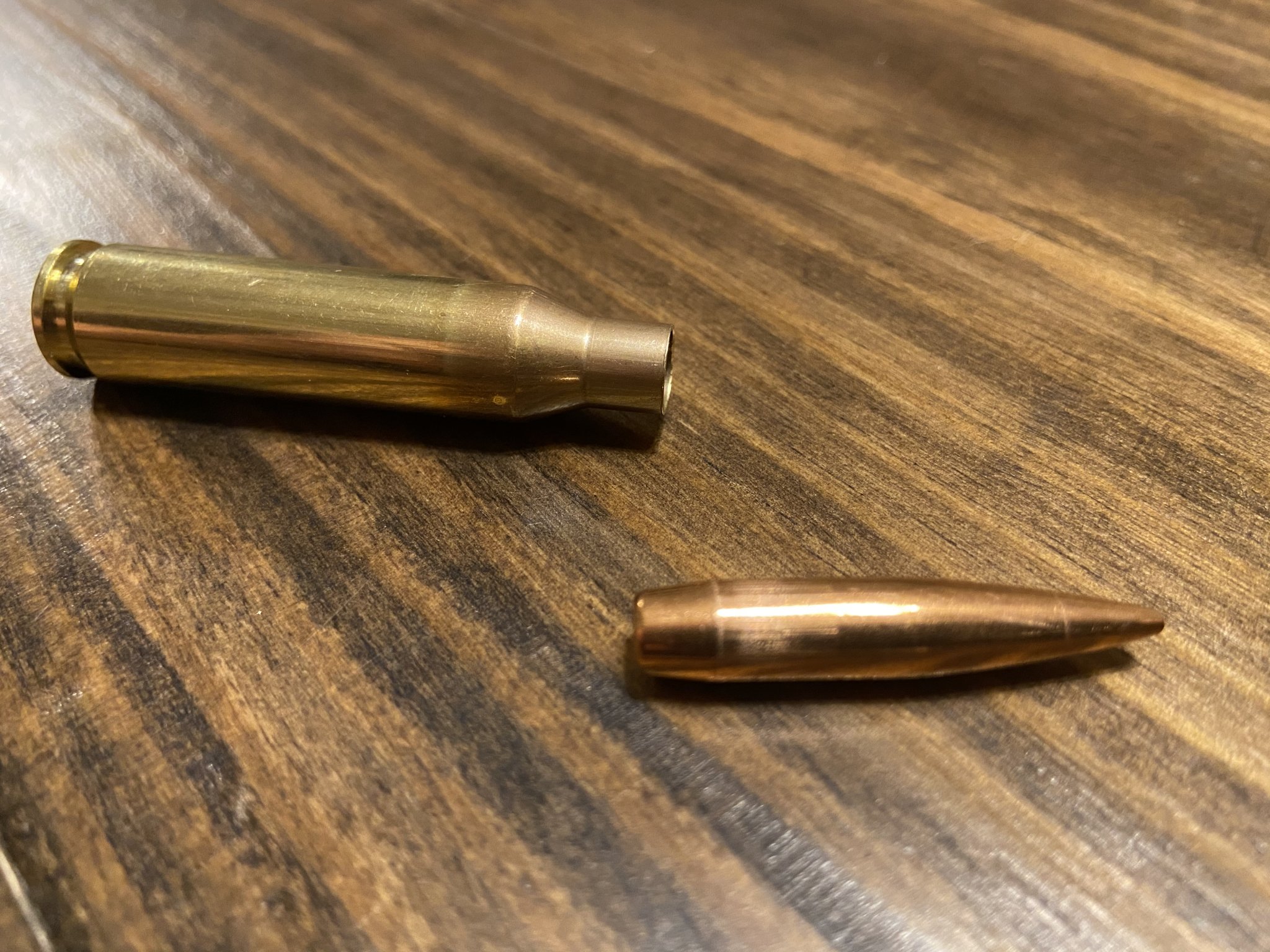

I just so happen to have some brand new Peterson brass I can do some testing on. This brass has never been fired, I did not chamfer the neck in any way. I loaded up a ladder test and I got pressure before I reached this round. It has been loaded for around a month or so. I pulled the bullet with an inertia hammer.
the pics make it look worse than it really is. It’s not visible to the naked eye unless you hold it in the light just right
i would say the coating is working. I know 100% that Lapua brass will score the copper jacket pretty damn obviously even
