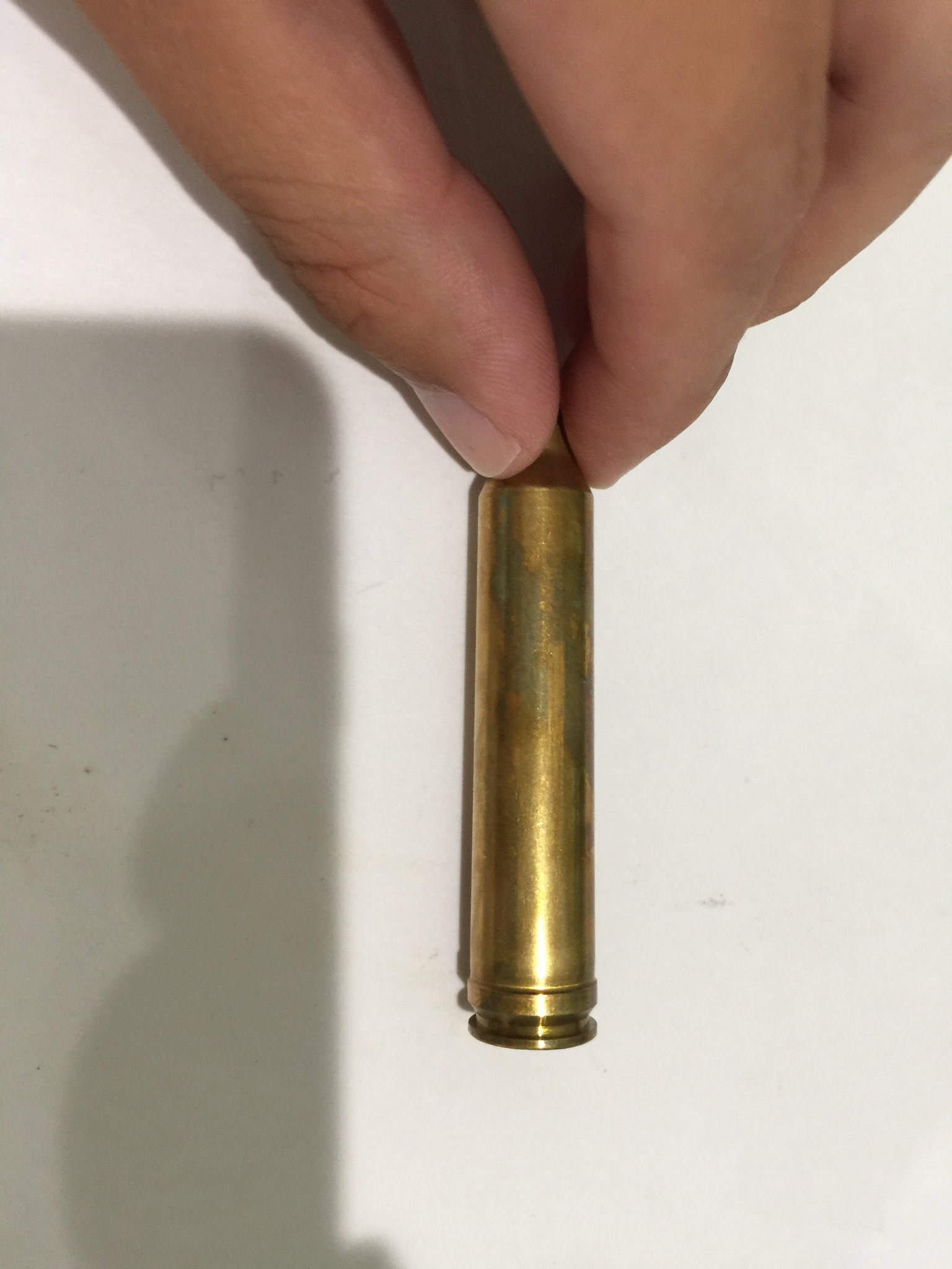

Before trying to rubbing the rainbow like color off, one of the cases looks like this following:

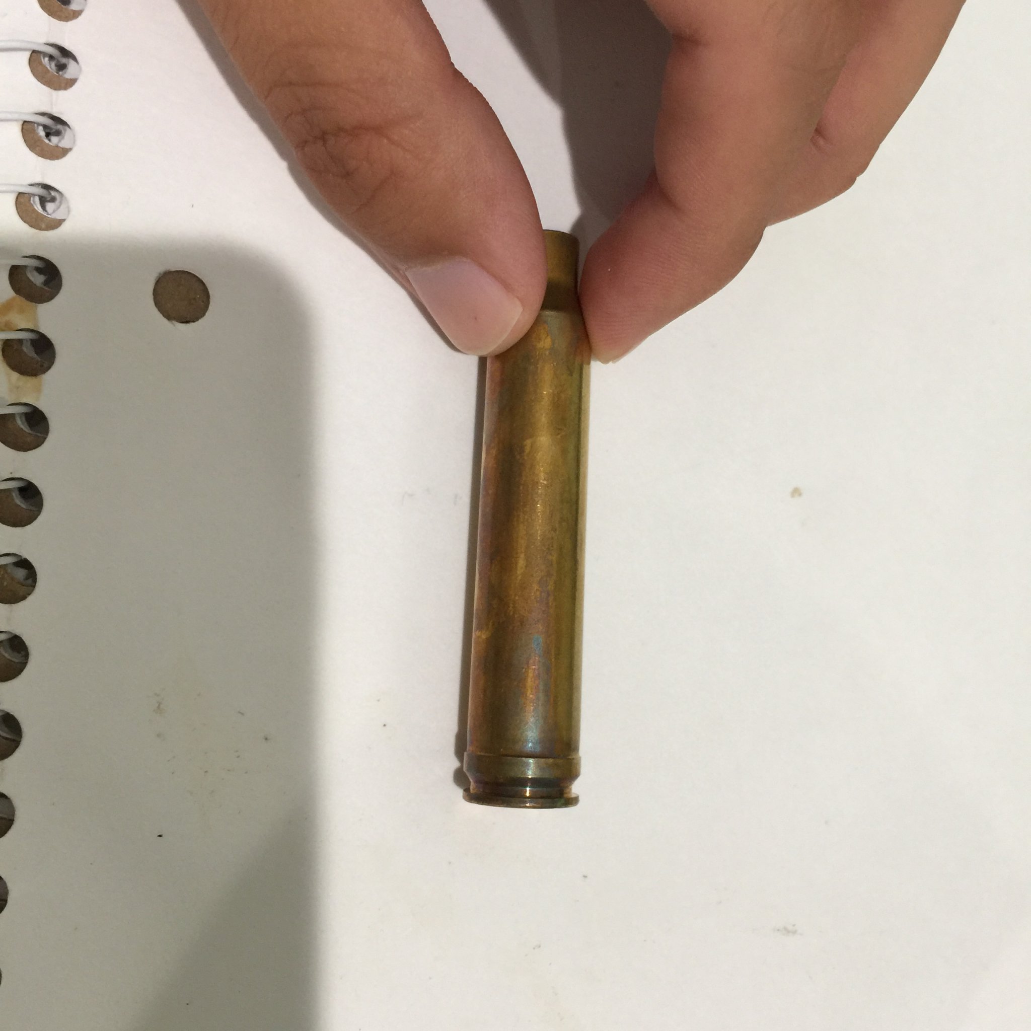

Aftering the rubbing the case looks like the following:

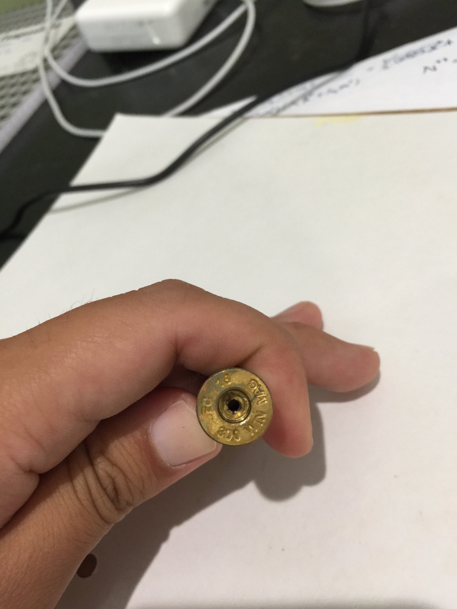

The bottom of the case after rubbing:
So even after then rubbing there's still some slight blueish color on the case.
