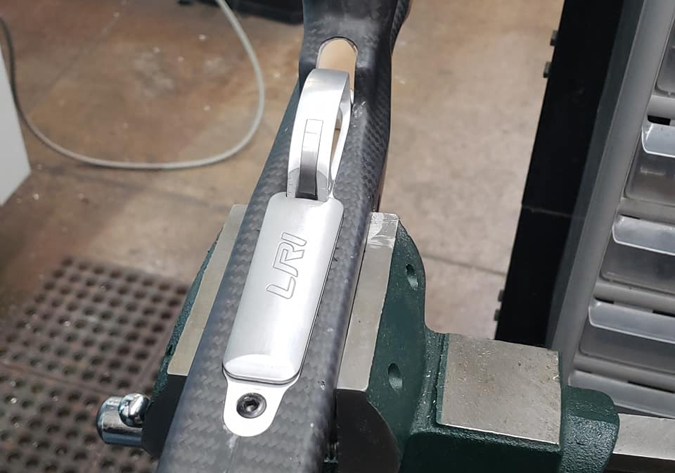

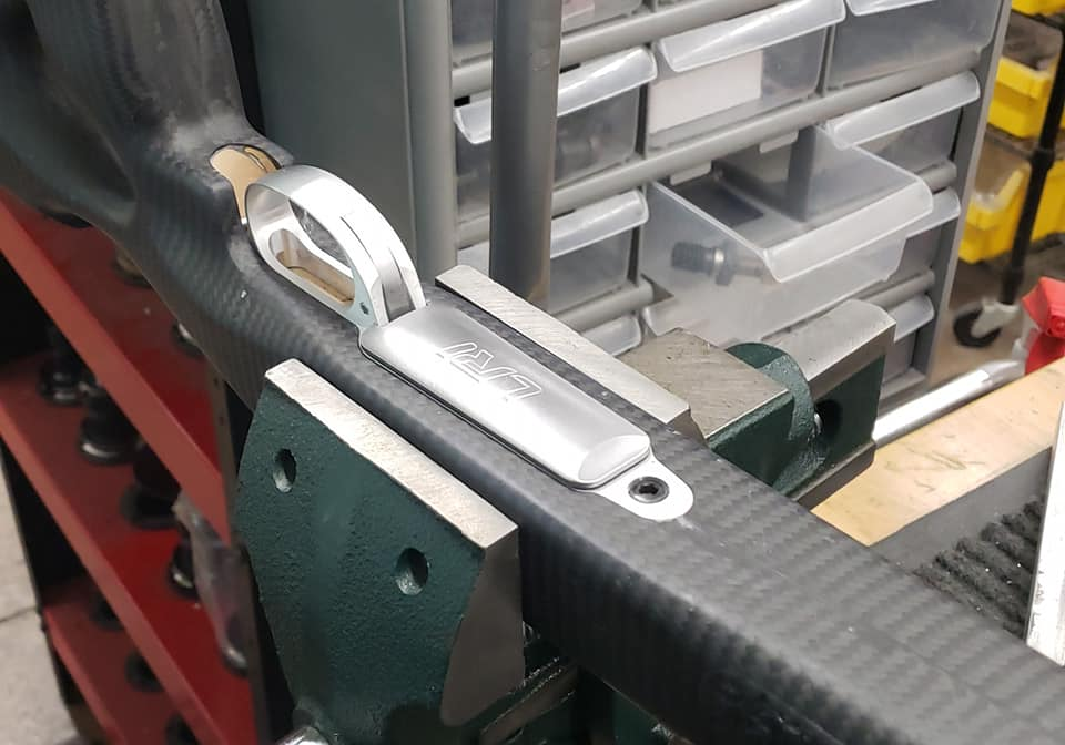

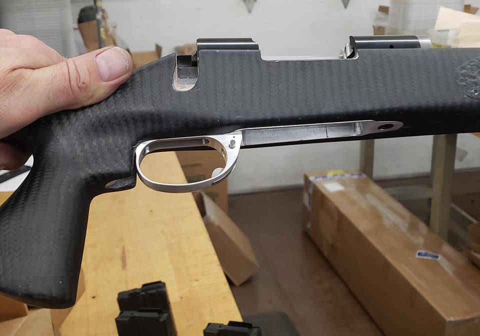

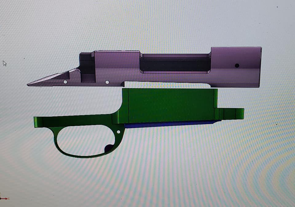

The idea: Offer a DBM for true hunting rifles that appear to be BDL hinged floor plates. This was at the request of a big player client we do subcontract work for.
It started on a Monday at 10am a week before the NRA convention. Friday afternoon my wife and I were breaking every traffic law you can imagine as we raced to Fed Ex to get it delivered for Saturday am. 2 minutes to spare... :)
Now, now the next problem to solve. Were looking at close to 20,000 units a year.
I like those problems.
Pretty cool. The floormetal is a two op part. I think I can get it in one with a small tooling revision. We shall see...
This accepts convetional AI, MDT, ARC, Alpha, and Accurate magazines as well. Obendorf type release latch. Contoured guard bow to try and give a respectful nod to classical sporting rifles. A "gamer gun" version will come online parallel to this as well featuring the church belled entry well and larger paddle type release lever.
Thanks for looking. They are going into production here soon and will be available on our store as well. We'll also offer a LA version and an M70 type is not too far away either.
100% machined from 6061 AL, 304SS and Chromoly.
