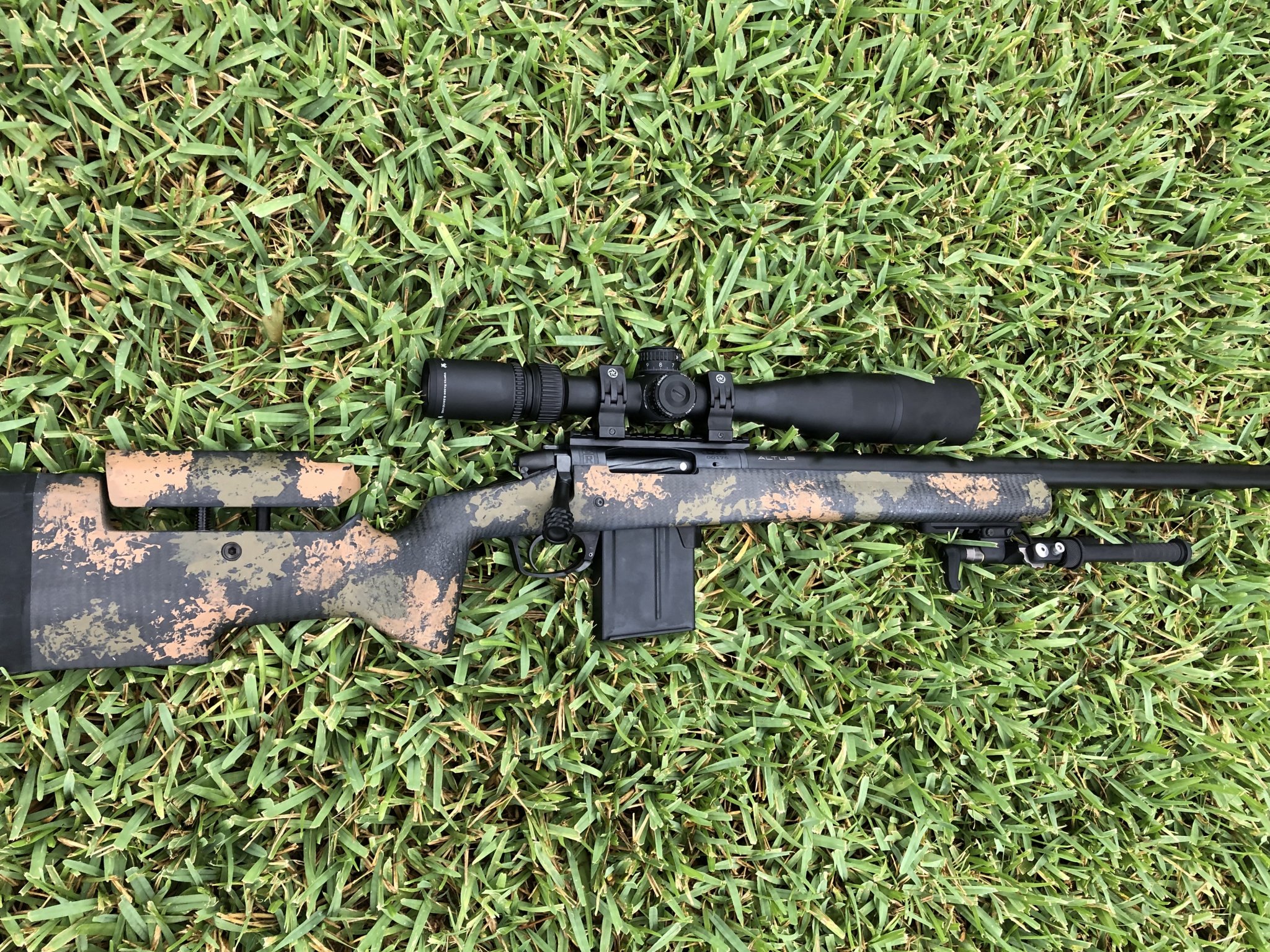

Just got mine put together and broken in.
17.5” 1:8 twist carbonsix magnum contour chambered by Straightjacket Armory. It shot the factory 105 hornady black, 108 eld m and 87 gr vmax extremely well. Smallest groups were 1 hole and largest were just over 1/2 minute. 108 and 105 had exact same poi and shot inside the same group. 87 vmax printed .5” higher. Super happy with the build. Already have a magnum bolt face and Nick at Straightjacket is chambering me a 22” proof in 6.5 PRC. Can is still in jail...350 days...fml.

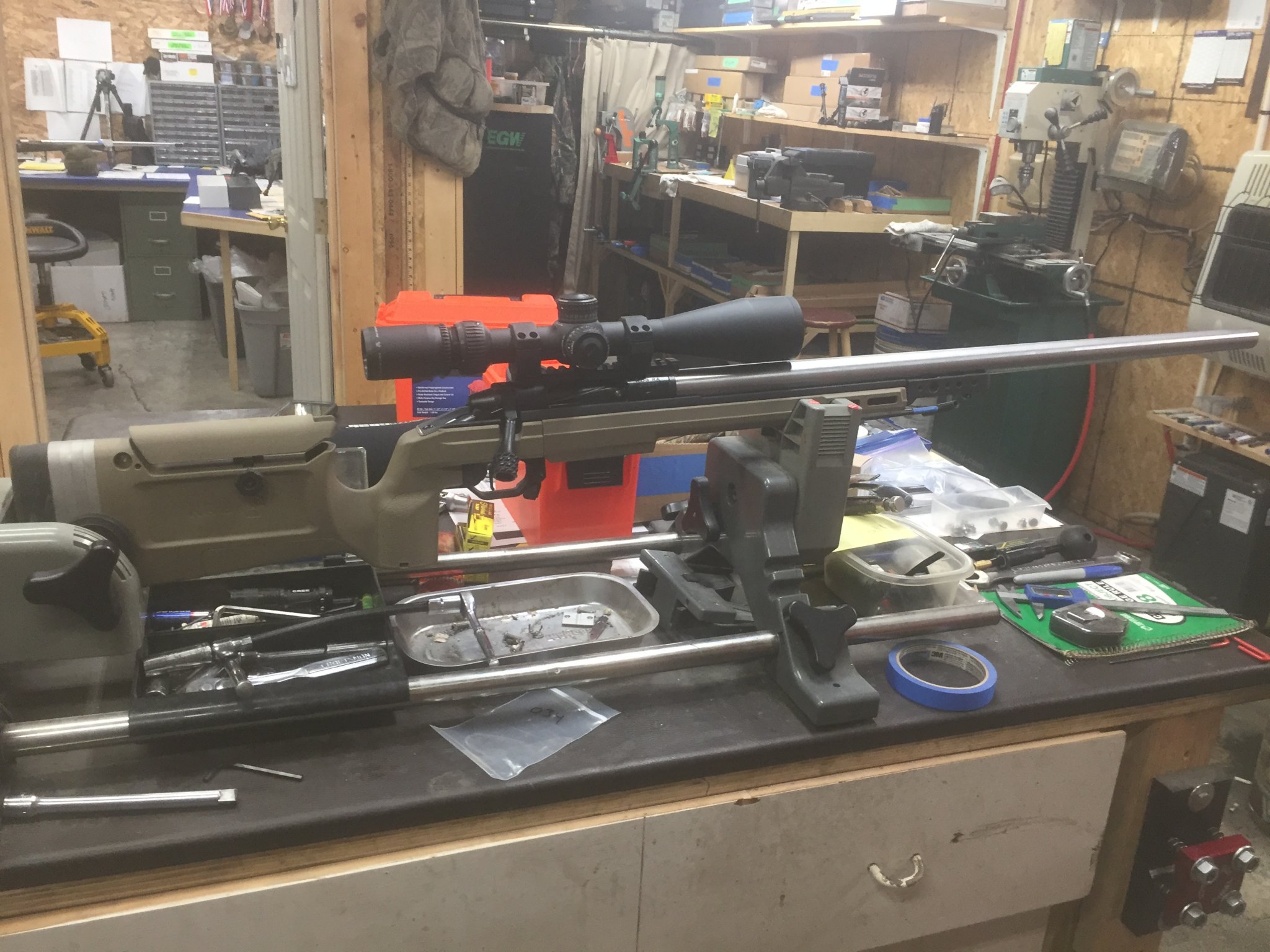

I made a quick video while testing out my cheap savage barrel. Some guys were wanting to see how the Origin ran and how smooth it looked. So if you can get past my rambling, well there you go!
As far as the results I had the POI shift on me down .3 mils so now I get to buy a new barrel. I did check to see if everything was ok with the gun when I saw splash 5ft low but I just hit the Tpost and it shot down.
Should I go with another 6.5 creed or give the .224 valk a go?
Also a side note, you know you've loaded the 11th round when you start making faces.. :ROFLMAO:

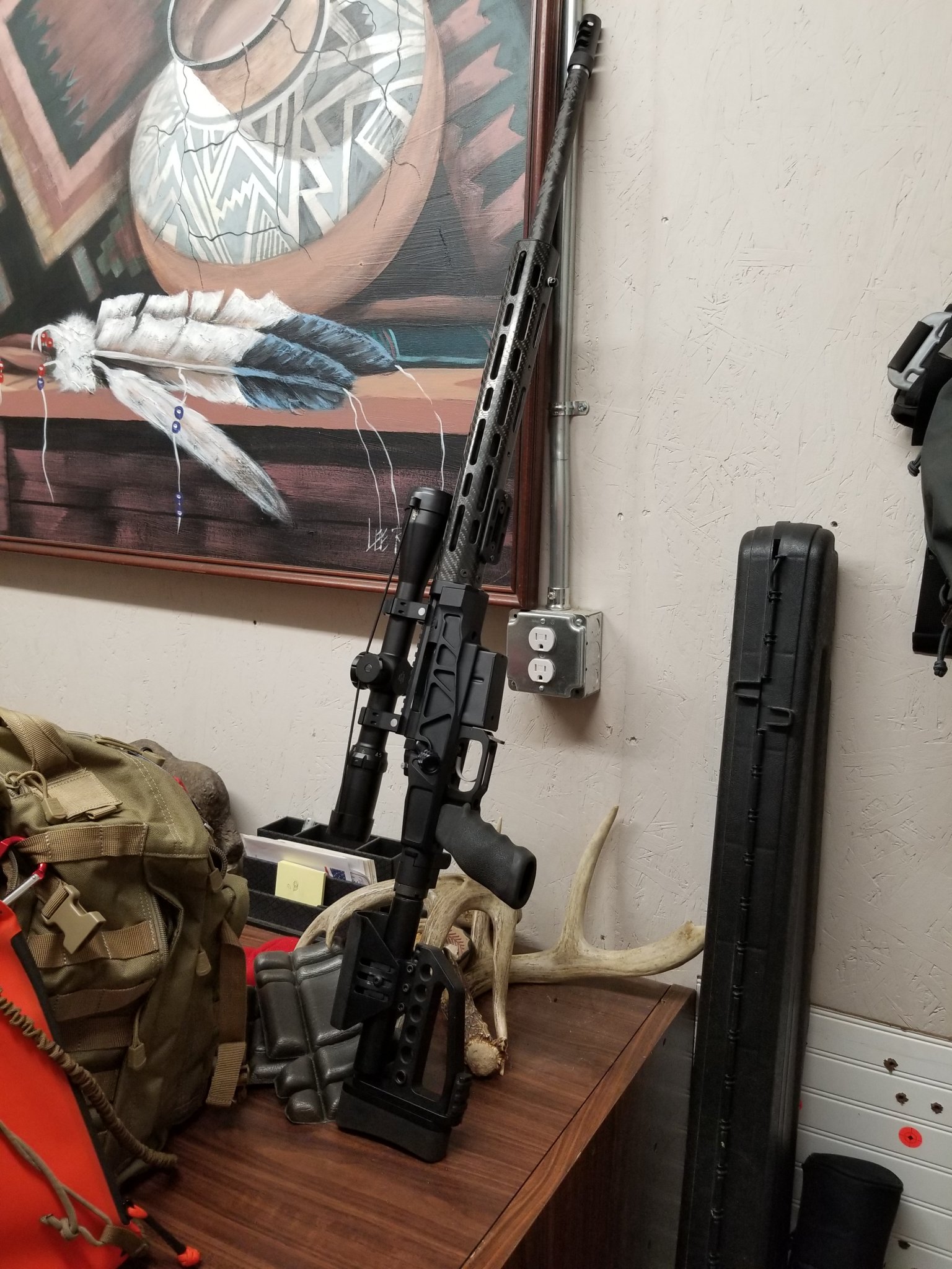

I finally built mine from the pre order..
Running three Xcaliber pre fits.
21" 224 valkryie 7 twist
19" 6.5 creedmoor 7 twist
17" 308win 8 twist
Bighorn 12pt barrel nut
Area 419 2P brake
TT Diamond flat
KRG W3 folder
Fedex lost my 6.5 creed barrel but I have the 224 valk barrel to shoot this weekend and a couple cases of 75gr AE which is all I plan to shoot out of the valk. So far they feed okay out of unmodified AI psr contract mags. Might change the bolt knob to get a little more room away from my scope but content otherwise.
