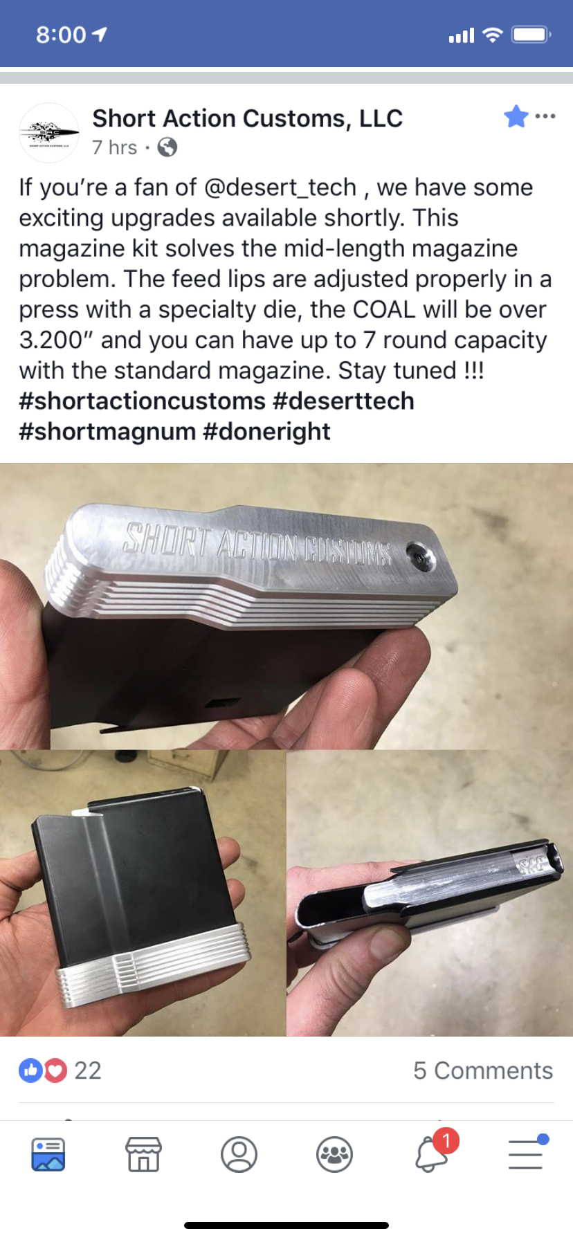

Still excited about SAC’s magazine mod he’s working on. If DT smooths out the bolt and SAC fixes the magazine, that make a great rifle that much better.
What is the SAC magazine mod? I’ve missed this
