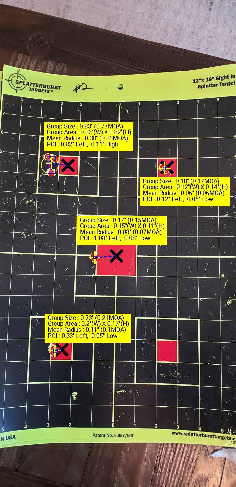

I have been reading on how to clean properly for accuracy for a long time and have tried many different methods and came to the conclusion that factory barrels from clean only have so many shots till accuracy falls off at least to some degree (same hole vs acceptable for hunting).
Some guns would lose it shortly after 10 rounds and some around 50 or so but then I bought my first Shilen select match and after the initial cleaning then after 10 rounds I have almost 100 down the tube and running consistantly around 1/4" c to c With boron nitride and hasn't seen a patch since.
