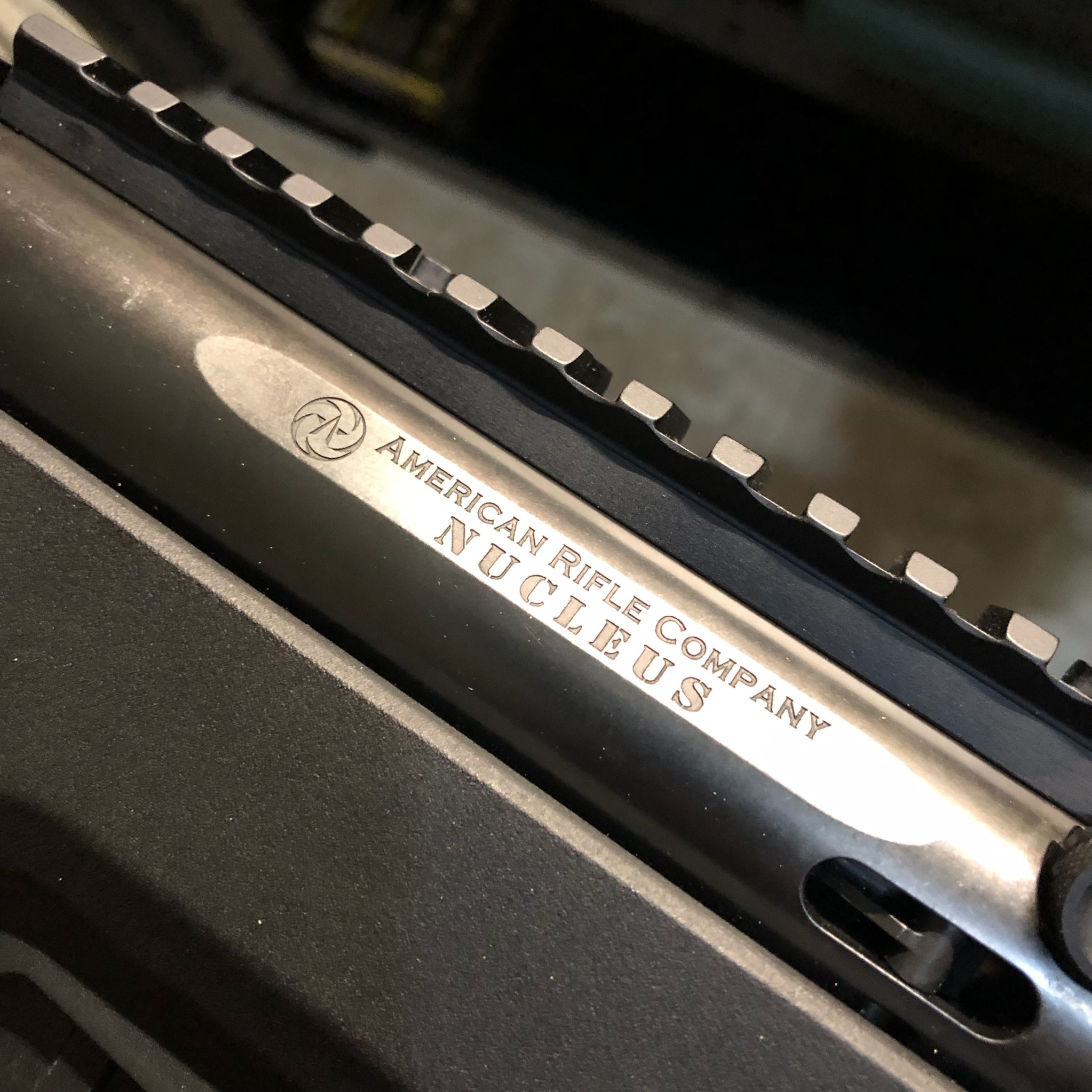

The world could use more rifle pictures and less bitching about order numbers. I've had my action now for a couple months. I have about 300 rounds threw mine so far. Definitely a huge upgrade over my RPR. I have shot a couple club matches with it and took 4th in both of those, only being off the top by a few points. PVA spins up a hell of a barrel!
RH SA Nucleus .308bf
PVA 6mm Creedmoor 25" Medium Palma
Magpul Pro 700
ARC Mags
Sawtooth rail for 15" seekins handguard
Area 419 barricade stop chopped up to move further back towards magwell
Huber 2 Stage - 0 light primer strikes with factory and handloads
Love the chassis, only problem is upward pressure on the mags binds up the action. I am trying to help it with the 419 barricade block.

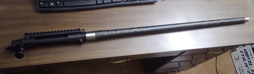

DROSed order #302X today after work, 1 short action and 1 long action.
Both bolts operated smooth but with a little more effort than expected, but that might be because I was holding the action rather than them being bolted into a stock. All 4 bolt heads and extractors looked great, all the machining looked great overall. Bolt releases turned easily by fingertip, but the detents are firm enough not to rotate accidentally-- and it won't rotate unless the bolt is all the way back anyways.
As others have said, the actions are slathered in oil and some grease... They'll need cleaning before use.
Just need my 223AI barrel from PVA now to get the short action up and running. Hopefully the accurate 223 mags I already have run OK, if not I'll modify ruger 223 mags.

jgs8163
Belligerents
Jan 23, 2014
171
99
34
Southern AZ
Finally done for the most part. Still waiting for my Rockcreek barrel but it’s still a ways out. Had some issues with getting it but it’s all good. I had this backup we Barloc’d on. To the range in the morning.
