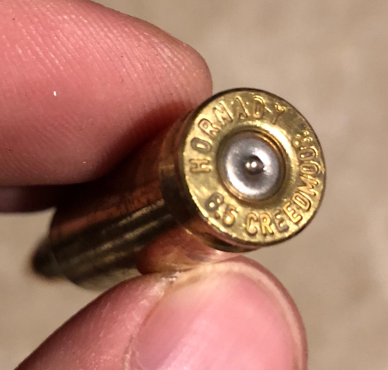

OK, so I replaced my spring with the 19# and did some testing. I had five ftf out of 31 hand loads. I had both CCI and Federal primers fail to fire. All those that failed, did fire when tried again. This is better than the 40% failure I was seeing on handloads before, but still not great.
The factory hornady (147 Eld-M) I shot had no rounds fail to fire.
When I replaced the spring it looked like the bolt was lubricated with a grease. The grease may be heavy enough to slow the pin down just slightly, so I am going to strip the bolt, clean out all the grease and lube with something lighter. Also going to replace the trigger (Timney) with something else.
Hmmm!
Is it possible to reassemble the bolt without the spring then see by pushing the firing pin by hand while holding the trigger back to see if there is any interference.

Hmmm!
Possibly, but I don't fancy removing and installing the spring again. I am not a big fan of the bolt's assembly/disassembly procedure. Getting the spring off is OK, but for me getting the spring back on sucks.
I've stripped down the bolt, cleaned and removed all the grease, lubed with oil, and have another trigger to test with. Going to the range to test tomorrow, so hopefully I will have some good data to report back with.

So, good day at the range today. 1 round failed to fire from 75 hand loads. I put that in the margin of error for hand loads so I say that is pretty good.
To recap, was seeing 40% fail to fire on hand loads (CCI 200 primers). Replaced spring with 19#, and cleaned grease out of bolt and lubed with a lighter oil. Seems much better now.
Edit: Didn't replace the trigger since I wasn't seeing significant number of failures. All rounds fired with Timney 517.
Was the failure a light primer strike?
Have you had a failure to fire before with your hand loads on other rifles?
Seconding @whatpsupdoc here. The only time I've had handloads fail is when the primer pockets were not cleaned well and the primers were not fully seated. The firing pin expended all of its energy fully seating the primer. Putting the unfired/struck cartridge back in resulted in the rounds firing in most instances, but a couple took 3 attempts.
I've had rifle rounds that I forgot to charge with powder as well. Those end up with a fired primer but the bullet doesn't move. There isn't enough energy in the primer to move the bullet at all. Taking the bullet out you see black carbon all over the base of the bullet.
I have 120 rounds through my Nucleus at this point, 100 handloads and 20 factory 140gr ELDMs. No failures to fire so far.

I'm pretty sure you misunderstand entirely what I just said. The chamber is tight enough that when I first ran the brass through the gun most rounds were a pretty snug fit (including a number of those that failed to fire) because I only ran an expander ball through the virgin brass to avoid making it undersized and causing precisely the problems you are referring to.
I have since fired the same pieces of brass through the rifle several times, and had 2 more light strikes after swapping to the 19 pound spring but before my TriggerTech arrived. It's not a headspace issue when brass fired in that chamber and then appropriately resized using the same technique that's worked for me in 5 different guns and several thousand rounds this year alone without a single light primer strike up to this point.
When I swapped out the trigger I unloaded several of the pieces with light primer strikes that I had been holding onto and loaded them again with new primers, new powders, but the same bullets (can't waste those 105 Hybrids right now) with exactly the same load they originally held. Didn't size them except to give the brass the proper neck tension again after the previous bullet was pulled. They worked fine, as has every single round I've loaded since switching to the TriggerTech Diamond without changing anything about how I'm loading them.
Headspace is important to get precisely right if you want to adhere strictly to the caliber specifications so that you can shoot any ammunition of that caliber in it. My rifle, being chambered in 6BR, will never see a single round of factory ammo and this barrel will never touch brass besides what I've already shot through it. If the headspace on a round is already snug from my method of headspacing (and it's happening even with fireformed brass that has been appropriately sized to fit my chamber just right), running a false shoulder will change precisely nothing.

I received my 19# spring today, but not until after I hit the range.
Over the weekend, I disassembled the bolt, well, most of it. I couldn't get the retaining nut/washer off so I soaked it with brake cleaner and cleaned it up best I could.
After cleaning, I reassembled everything.
Hit the range today after work with the same exact ammo I've had FTFs with. I fired twenty rounds today with zero issues. Now we're getting somewhere. I'm wondering if the spring was just dirty and the grit/grime was causing the spring to not push the firing pin the way it should be, meaning the spring is essentially too weak.
I get home from the range and the new spring was waiting for me so I again accepted the challenge of having to remove the old one. I was able to compress the spring with one hand, and loosen the nut with the other hand and finally remove the old spring. What a pain in the dick.
After cleaning the firing pin and assembly, I got to work putting the new spring on.
I had to use the provided washer for assembly, and another set of hands as there isn't a snowball's chance in hell you're going to accomplish this task alone.
After everything was put back together, I installed the bolt back in the rifle.
The first thing I noticed was the amount of force necessary to open and close is the bolt is noticeably higher.
And not just a but higher, I'm talking fire a really hot round and have to lift like you got a pair hard.
Now, the bolt was dry during this process, so I take the bolt apart to apply some oil to the inside moving parts.
So, took the bolt out, applied a thin layer of oil to the spring, and some grease to the lugs. This helped out a lot, but the bolt lift is still harder than before. I can't imagine running a 22# spring.
I'll be hitting the range at least once more this week and then it's up to SD for a match. I'll post how things go as I get more time.
I'm embarrassed to say that I'm bringing a back up gun, just in case.

I had the same issue with a Mausenfield action earlier this year. The grease/oil that ARC uses for packaging gums up the firing pin enough to slow it down. If you don't clean it before using, then you may see light strikes. I was able to resolve this quickly by contacting ARC who first recommend that I clean it thoroughly before sending in the bolt or changing the FP spring.

Grease in the bolt will pack into the front of the bolt and slow the firing pin.

Hit the range yesterday with the 19# spring. I fired about 40 rounds with no issues.
When I assembled the bolt with the new spring, I did put some oil on the spring. I'm not sure if it's necessary, but I'm hoping it doesn't cause any issues.
I'm heading out again tonight to confirm some velocity numbers, but after yesterday, things are looking up.
All rounds went bang when I pulled the trigger.

I fired 109 rounds at the Lacreek Precision Rifle Match today with the 19# spring. I had 1 round that didnt go bang. I ran the bolt and hit the same round again and it went. It is a pretty decent improvement from the last match.

Capt. Hot Sauce
Aug 28, 2018
15
10
6
The hills of southern Ohio
Well... Friday on sight in day, I had 8 of 20 with light primer strikes. Could visibly see they were light. Saturday had 1 failure out of 100. Ammo both days was from same batch of hand loads. This was with 19# spring.

spelunk
Gun Loving Redneck
Belligerents
Feb 19, 2010
526
68
34
Prosser, WA
Do you plan on trying a different trigger? It would be interesting if say a TriggerTech solved your problems. These primer problems are making me real nervous about my Nucleus. I don’t think I’ve ever had a primer fail to ignite in either of my Bighorns or my Defiance in the 7k+ total rounds fired through them.

Capt. Hot Sauce
Aug 28, 2018
15
10
6
I forgot to add that I switched to a Triggertech Diamond before this weekend. The light strikes this weekend were with the TT and not the Timney.
I see no rhyme or reason why one day it has a high rate of failure, one day not.
spelunk
Gun Loving Redneck
Belligerents
Feb 19, 2010
526
68
34
Prosser, WA
That is really strange. I hope you get it figured out and working properly. Keep us updated if you don't mind.
