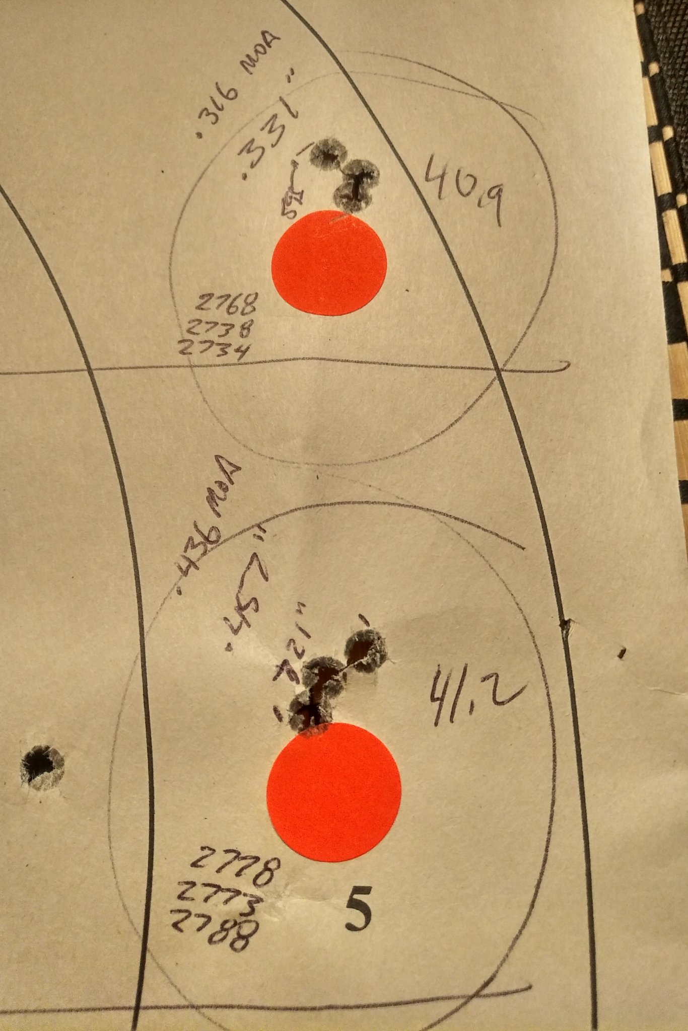

So if this doesnt settle the questions about 130 RDF's I dont know what will. So I loaded up 55 of them with 41.1g H4350 in Virgin lapua brass today to get some rounds down a new 6.5x47L barrel I am reviewing. I used the best load that I had from my other 2 6.5x47L barrels here. They shot like straight shit. Like I was shooting 55FMJ with a Red Dot at 100yds in a $500 AR15.
For comparison so someone doesnt cry the barrel was junk or it was the shooter or whatever else. I shot this 5x5 with 130 Berger Hyrbids, zero load development, also with 41.1g H4350 in virgin lapua brass right after shooting the above 130 RDF target in the same rifle.
Reactions: Redeye3 and kthomas

Agree with this comment. I've got the 105s working but only after weight sorting and they seem happy with a 60 thou jump.
Prime brass, Fed 210M primers. Yeah, they moving a bit slow, but for my uses for 800 and closer, this'll do. I got my 147 ELDm's for that silly stuff farther out.
Oh... and I can meter BL-C(2) out 41g +/- .05-.1 grain on my Lee Perfect Powder Measure each throw and weigh every other charge for QC. Loaded up 20 yesterday in no time flat!
