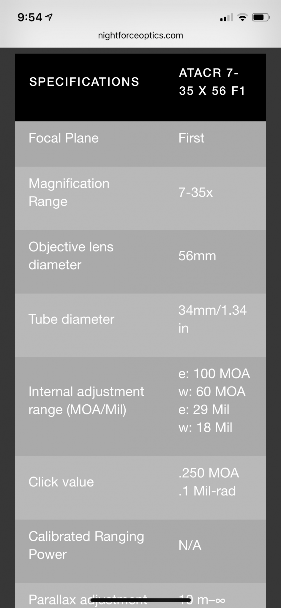

NF is saying the 7-35 has 100moa or 29 mils of internal adjustment. The 5-25 has 120moa or 35 mils. So yes, on paper, you lose some adjustments. In reality though, folks are getting more than 29 mils on the 7-35. With a good 20 moa base, I’d wager the 7-35 should give around 18-20 mils of adjustability. On my 6.5CM, 20mils gets me to 1660. I can hold in the reticle and hit 1mile (1760).
I guess it comes down to the extra couple mils of travel, or the extra 10X on the top end. It is 100% up to what your uses dictate.

7-35 have 36 mil
