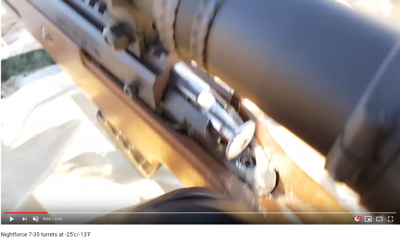

Hey all, found this video. Just wanted to see if anyone else had this happen or any thoughts on it? And have you guys used other scopes in below 0 conditions?
NOT MY VIDEO!

Since the dial is translating up and down, I'd wager that the detent is just frozen in place and no longer engaging on the teeth inside.
-13 degrees is pretty rough on grease.
-25 degrees is pretty rough on grease.
Yep, I would entirely second that. Short of a set screw not tight that's really all that could go wrong (if the reticle still moves).

I would bet in those temps you have to wipe all the grease off first and then even look at the O rings used.
-25 is pretty extreme, most stuff won't work I am surprised the electronics he showed still did.
When I am in AK teaching everyone asks about temps below -10 down to -25+ and it's pretty tough to give them answers because we never see it here.

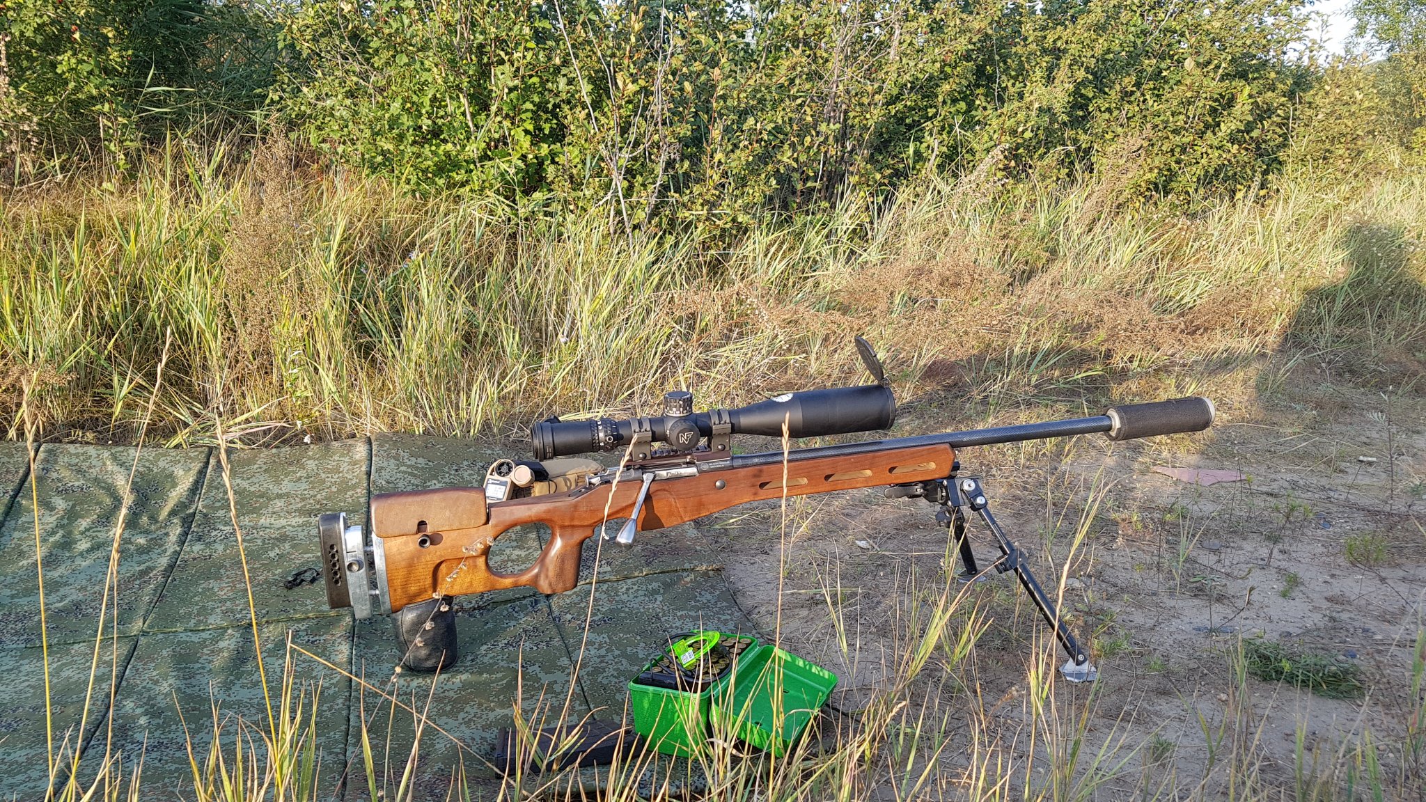

Hide, hello!
This is my video 😁.
A few comments:
1. yes, the NF 7-35 really worked perfectly in cold. Exception of clicks, they did not click)).
2. I had NF 3.5-15 and ATACR 5-25 sfp, lupy 2.5-8, 6.5-20, VX5HD 2-10, they all froze equally with NF 7-35.
3. The electronic device is the Garmin 701. The screen freezes and works slowly, but the ballistic calculator counts correctly.

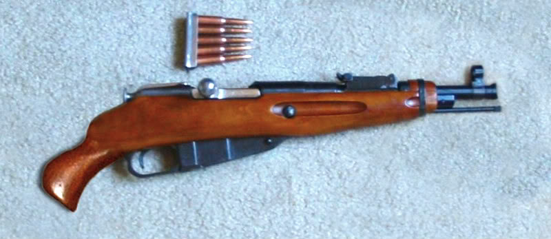

4. Yes, this is a Mosin rifle. It was made in 1927. Barrel replaced by heavy. And it is not small as suggested by AIAW 😊.

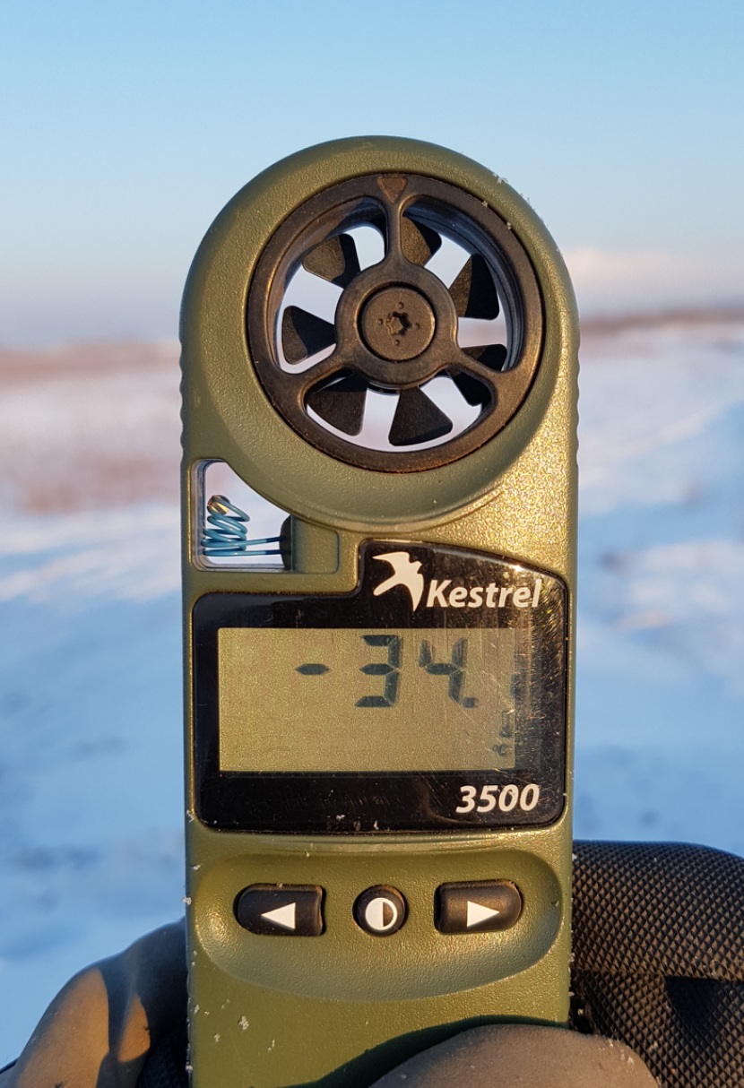

5. -26 'C is not so cold for shooting. At -34'C really chilly ).
6. I shot at 460 meters. 3.1 mrad up. In the video, the turrets and parallax are shown already after the shooting, randomly.

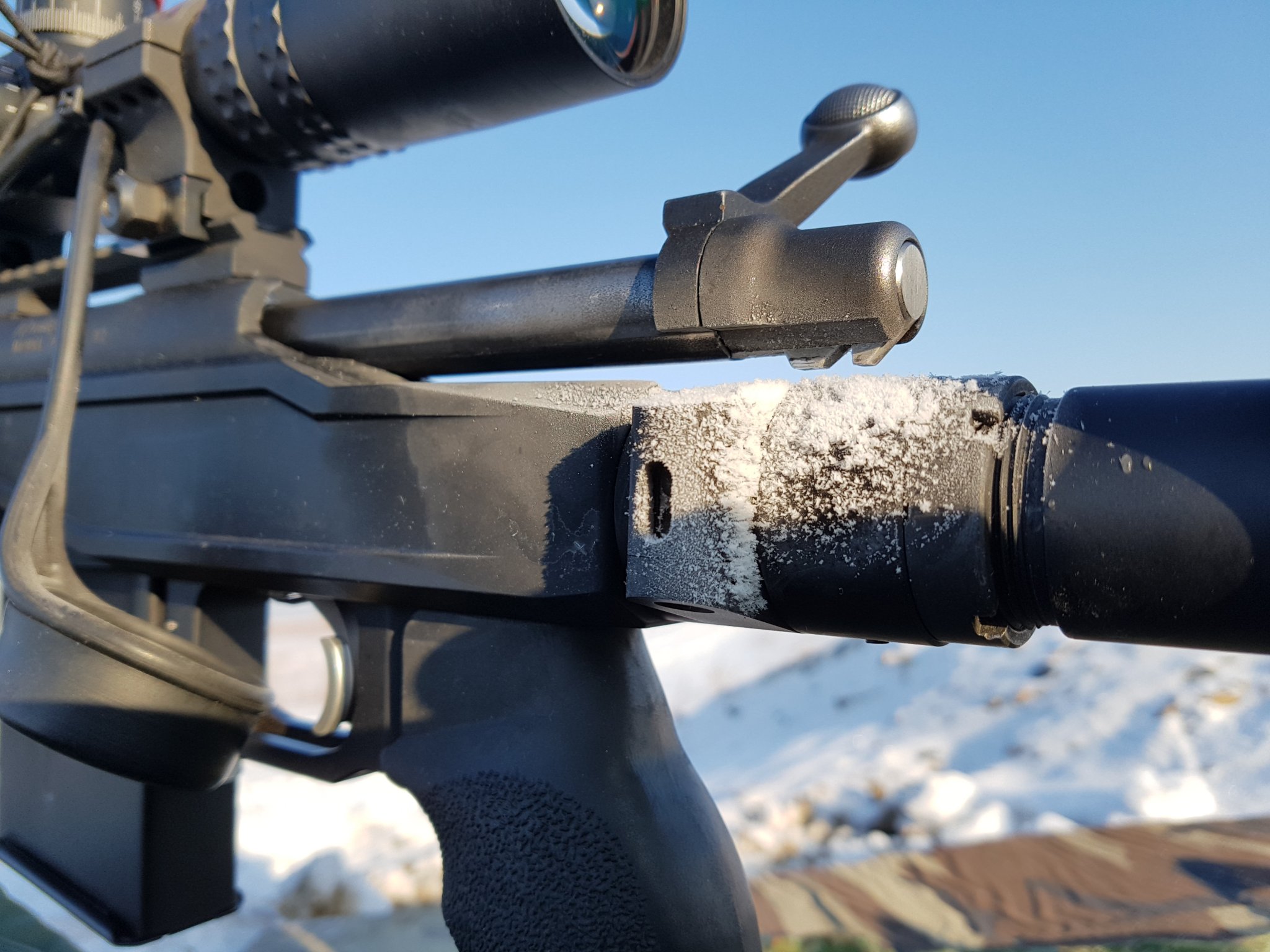

I have hunted, taken game dialing NF ATACR 5-25 in -20-30 here in WY as well as the NF C461 ATACR 552 scopes w/o failure. Late season backcountry Elk weather can get very severe here.
True, knocking off the ice crusted on from firearm/scope in the inevitable 40 degree swings (especially evening) is a pain and either I couldn’t hear / feel the turret elevation clicks - with 20-30 plus mph winds on top of the extreme temps don’t know the answer but I dumped the Elk at range in those miserable conditions and successfully ran back to zero.
I have and had to learn the hard way that certain weapon systems are in my experience certain to fail in those conditions regardless of how careful I ran them (no grease/lubes etc)
This last year I ran the rifle cover (link below) exclusively and it has proved to be quite helpful - but you still need to pay attention your weapon system on a regular basis regardless of conditions.
Each day in the field I build positions that the terrain throws at me - practice fundamentals, dial, dryfire on animals that I have no intention of shooting.
That reinforces my ability to do everything that I need to accomplish during a very short window - but it also keeps me on top of the functionality my gear.
