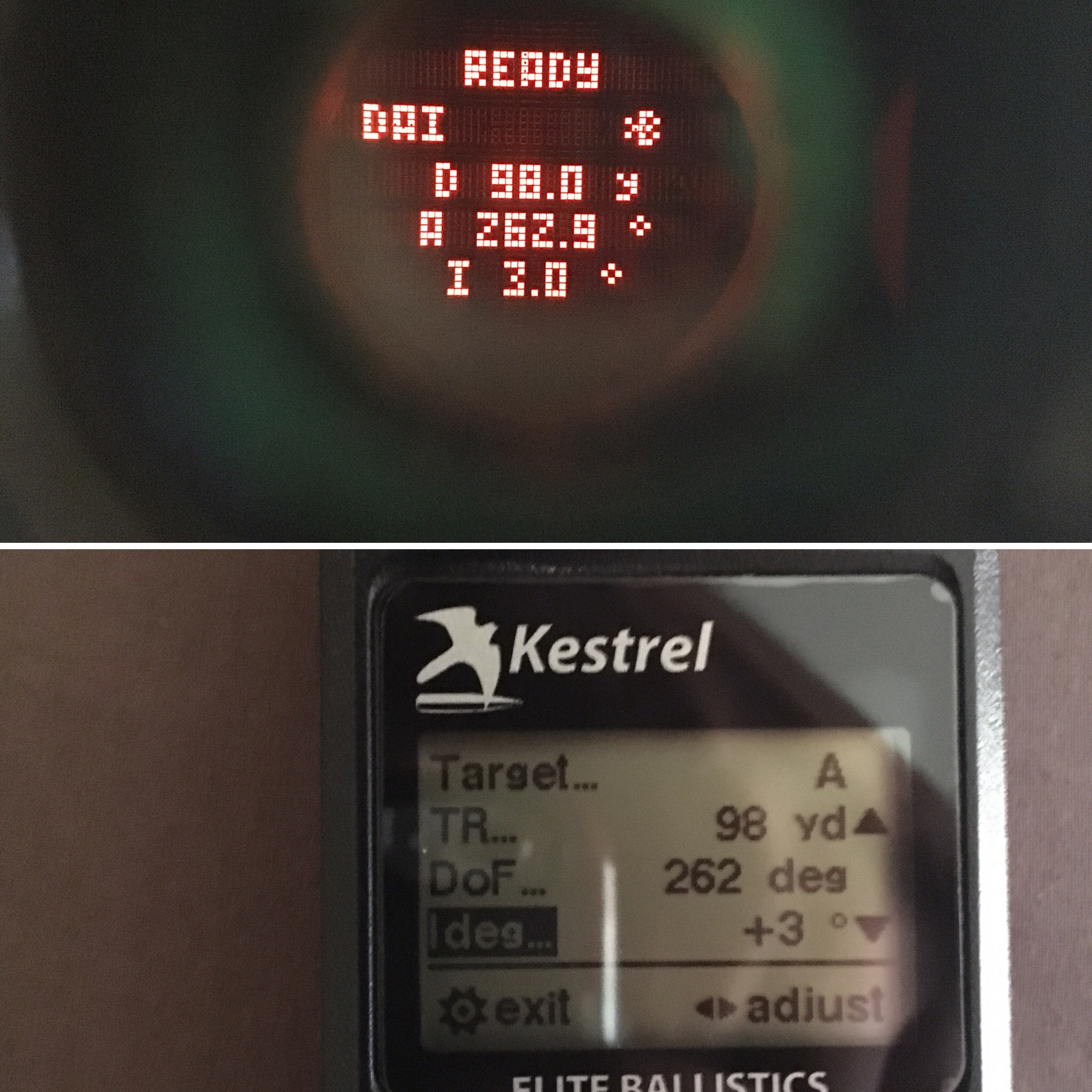

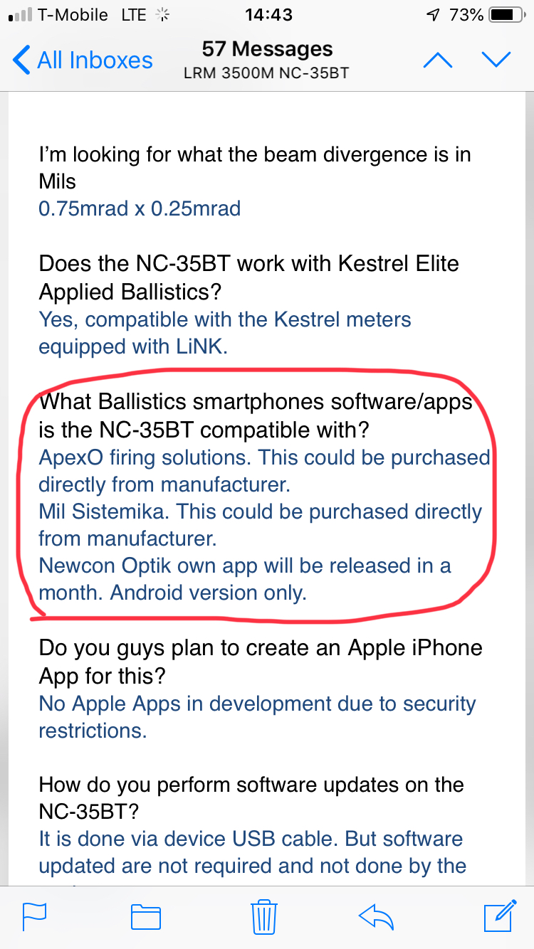

Three questions: Will the Kestrel's (5700 Elite w/Link) data show in the Newcon 35BT's screen? Or; does the 35BTs' data show up in the Kestrel's and provide the solution (s) as the Terrapin X's does? Are there any ballistic solvers available now that include or are unique to the 35BT? Thank You
JB.IC
Belligerents
Jan 25, 2019
198
66
34
Below in the pic answers your apps questions.
When you link the LRM 35BT to your Kestrel AB, it will feed the distance, angle, and bearing automatically into the solution when you range your target. So your firing solution will be real time as soon as you range the target.
The information of what you ranged will be displayed inside the LRM display and it will also be stored in the last 10 ranges menu screen.

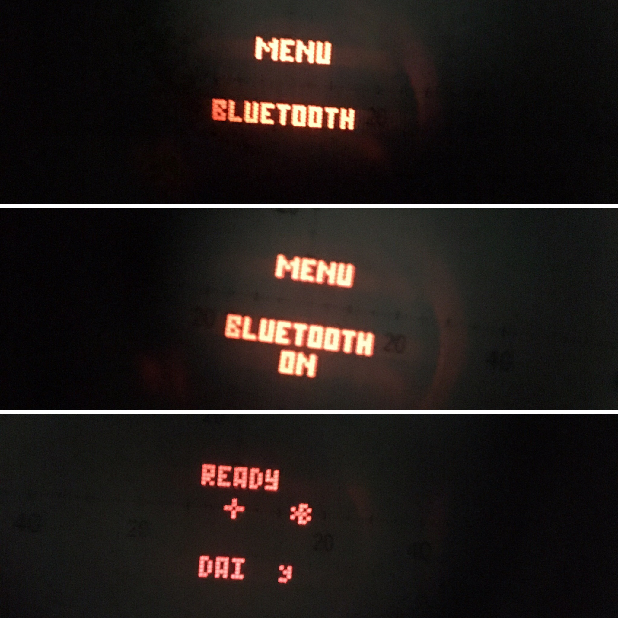

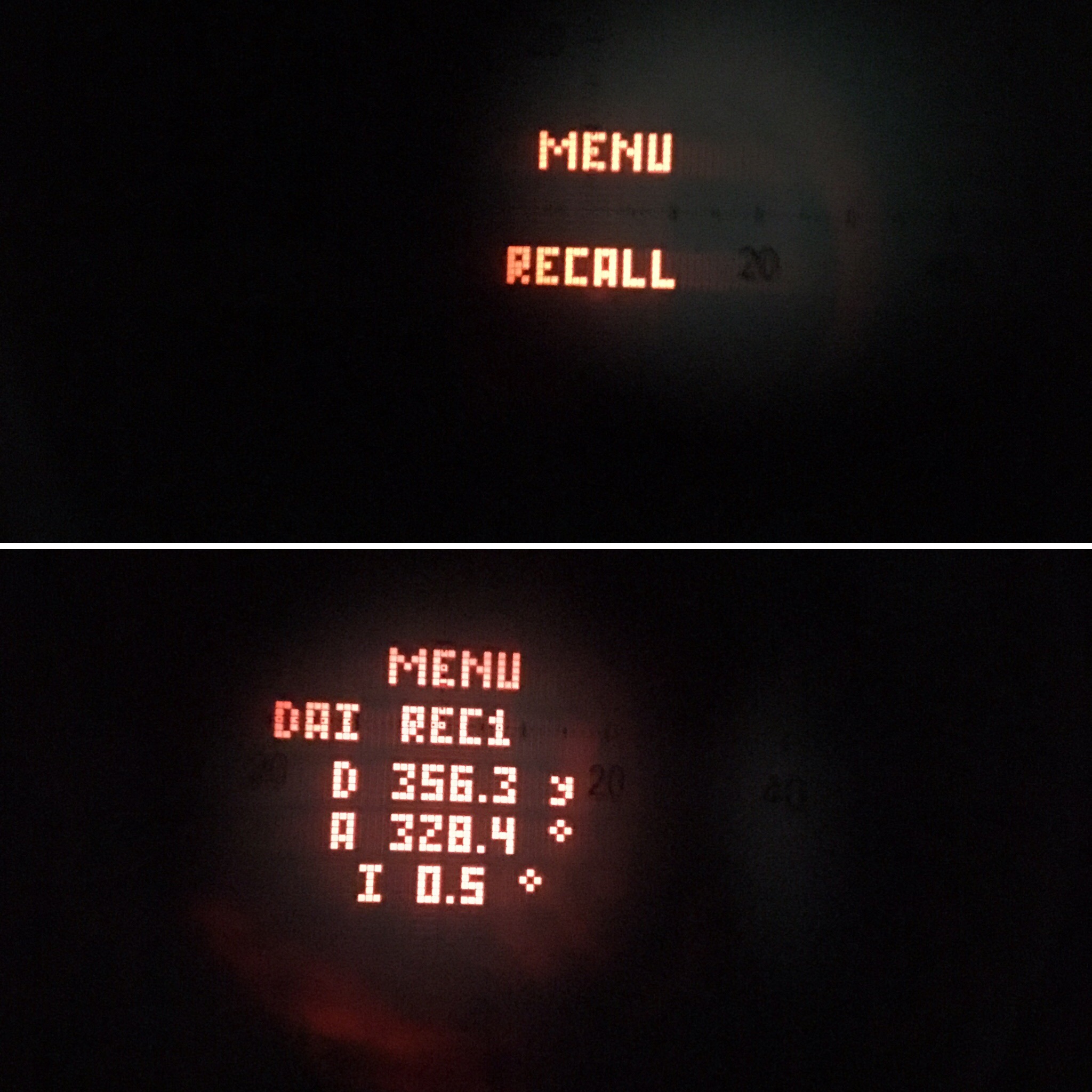

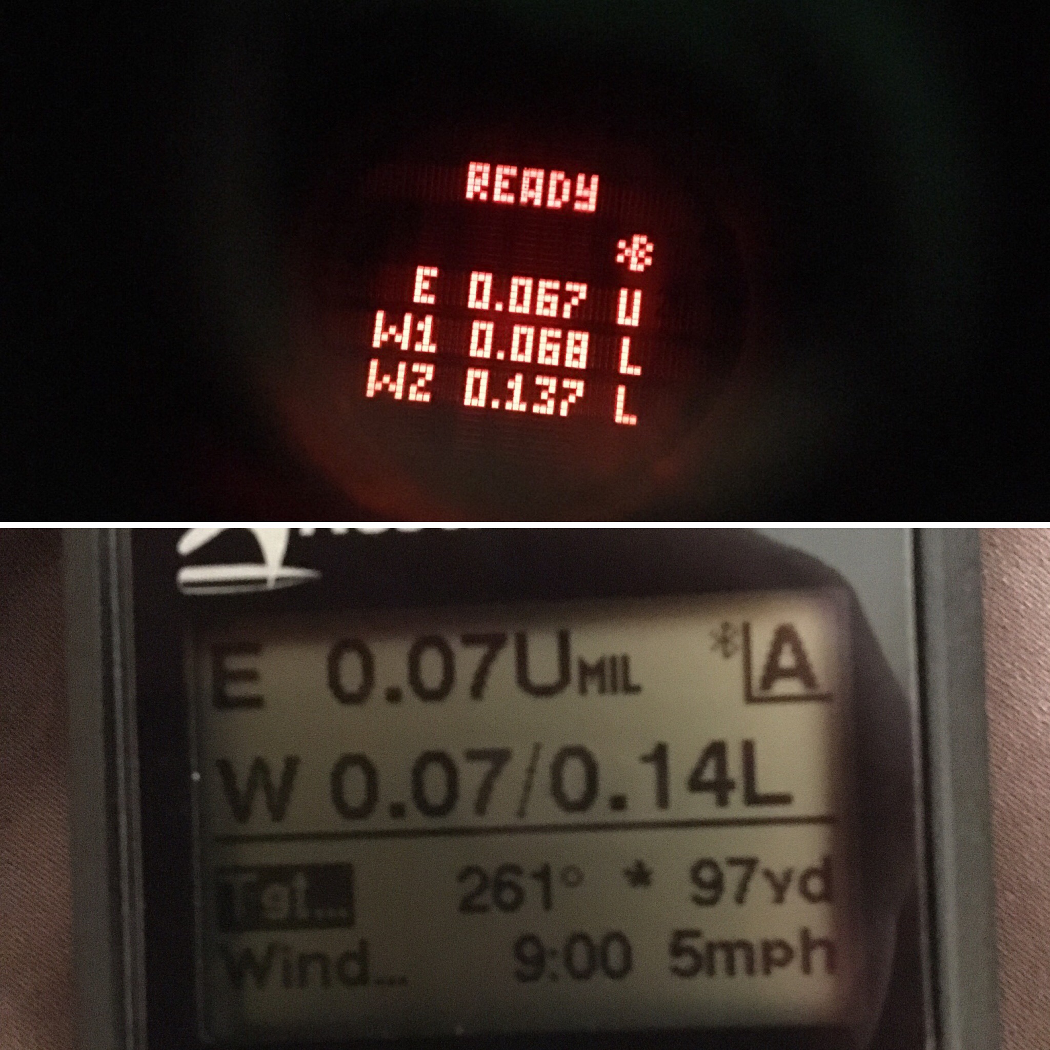

Thanks. I’ve attaced some images to show the menu screens of recalling ranges and Bluetooth connection with the Kestrel AB
Recall last 10 ranges
Turning on Bluetooth with the LRM. You’ll notice the little Bluetooth symbol on the DAI(Distance, Azimuth, and inclination) screen.
You can see the ranged information is transmitted to the Kestrel and matches the LRM’s display. I selected the actual target A to also display the inclination as it doesn’t appear in the regular ballistic output screen.

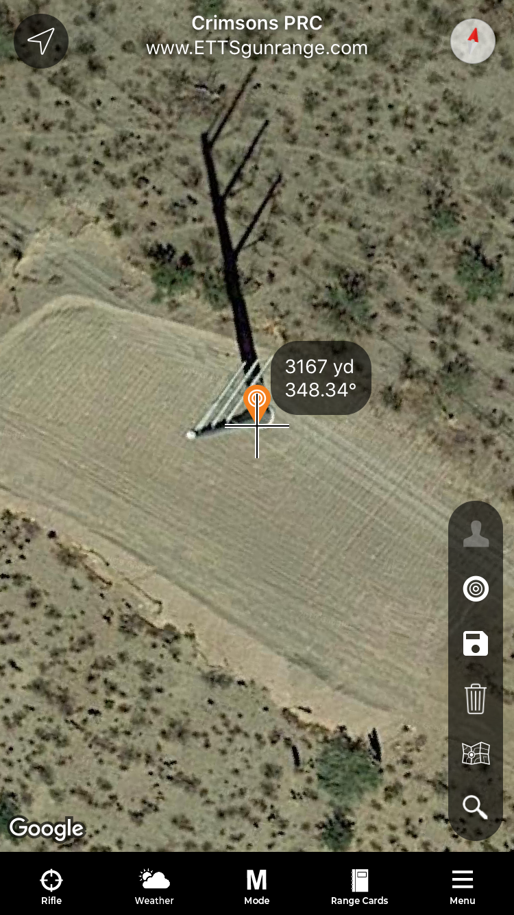

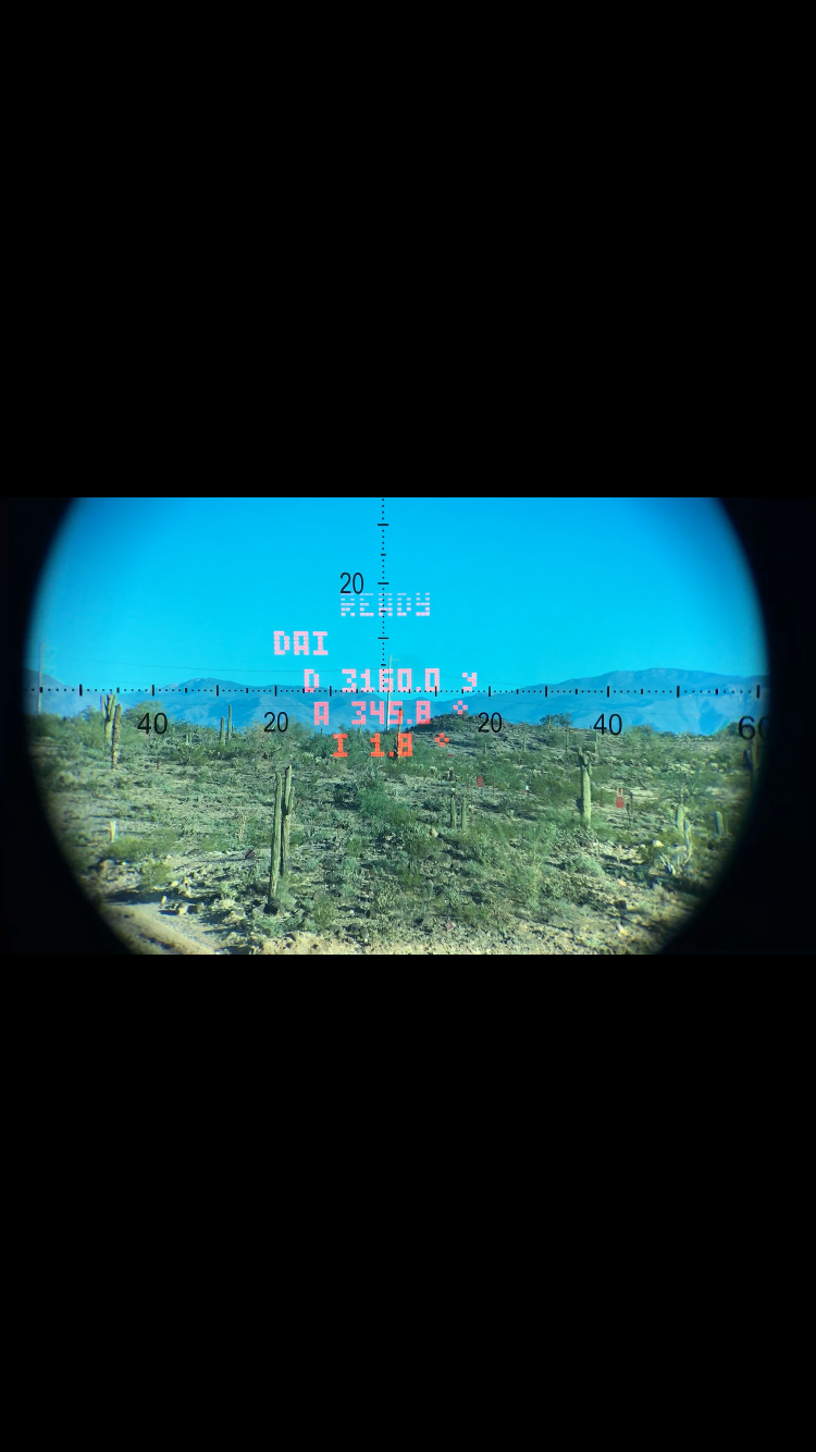

And finally a neat feature. The LRM will display your firing solution based off the settings menu - “time ind”. It’ll display for so many seconds. As you can see the LRM displays the firing solution to an extra decimal place.
I live in a HOA so none of my ranges are far. I don’t want to scare the neighbors so all my ranges were from my “backyard”

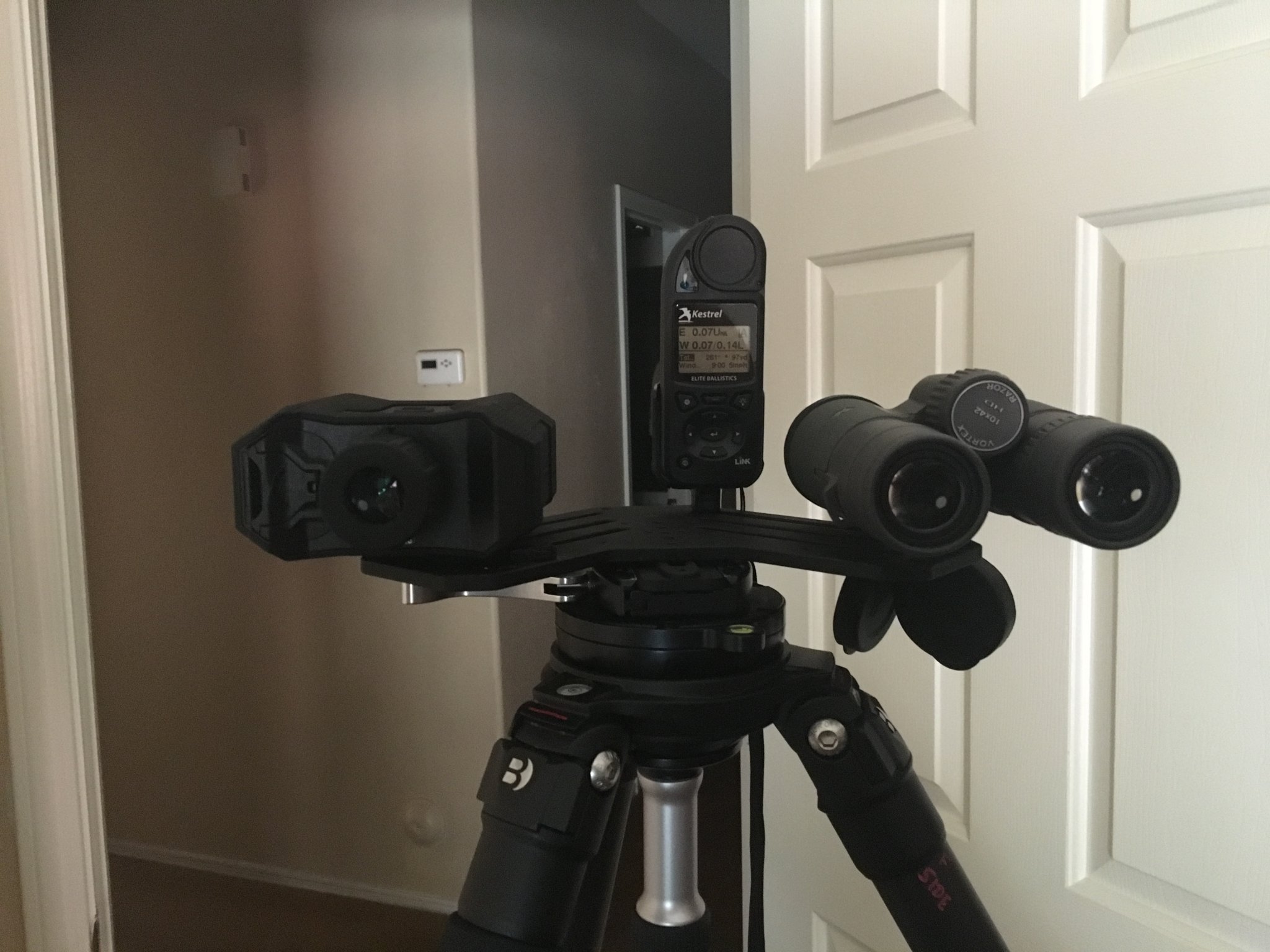

Wow! That’s is a great setup! What are the details on that tripod? I’d love to set my gear like that.
Tripod, Leveling base, and arca clamp:
- BENRO C474T 100mm video bowl
- RRS TA-4 leveling base (100mm video bowl)
- RRS B2-LLR-II Lever-Release Clamp (80mm).
Attaching hardware:
Henderson Precision:
- OMP-Optics Mounting Platform
- Universal 3 inch 1.5 "D" RAIL
I like the setup and it’s stable for shooting off of. I’ve used RRS tripods in PRS matches, the BENRO is half the price and does exactly what it needs to. I’m not mad about my setup and I desire no more than this.

If I recall and get it right the B connects to the Kestrel 5700 Elite whereas the C has the standard generic BT capabilities. Seems there's some form of protocal in BT connections/connecting. I think there's something else too, but can't remember. Do recall that while the M is less expensive than the B the C is more costly. I suggest conferring with Newcom and as many dealers as will discuss the various nuances of each model.
Thank you, I appreciate the info. Unfortunately, I have reached out to Newcon and have had little success. It took forever to get a response (finally via email) and then the info. wasn’t great. Maybe someone has a better suggestion for comms?
338LMAI
Feb 21, 2019
69
20
12
Go here: https://www.eurooptic.com/ProductComparison.aspx?prods=e44e41b0-eb3e-4bd3-a4d6-2104525d4540_7086f816-01ea-4d5e-96c3-99e44816550d&categoryId=Search for a comparison between the M and the C. Wonder if they dropped the BT or just can't get enough...
