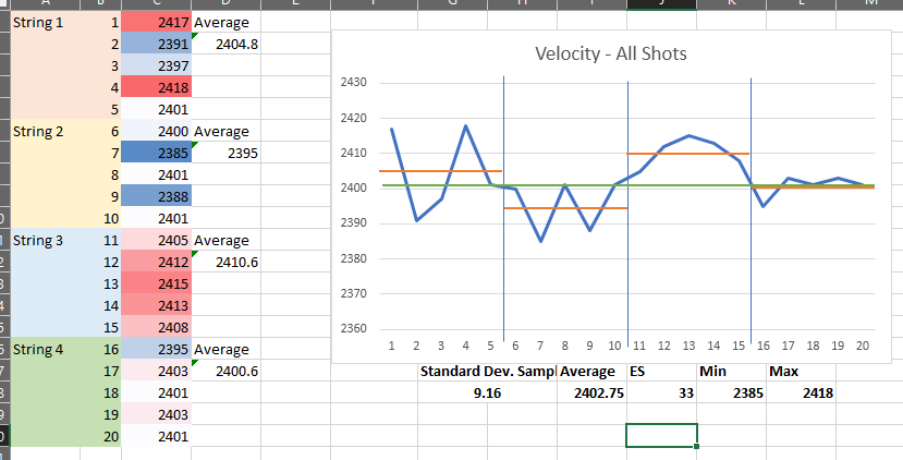

Hi all,
Just getting started with bolt guns and decided to pick up a v3 and test the factory rounds I zeroed the rifle with. I plan on reloading for this rifle and wanted to have a target starting point for load development.
My question is it typical to see the SD drop as the barrel warms up?
Thanks!
I shot 4 strings of 5 rounds with the following results.
Series1 Shots:5
Min 2391 Max 2418
Avg 2404
S-D 12.1
ES 27
Shot Speed 2417 ft/s 2391 ft/s 2397 ft/s 2418 ft/s 2401 ft/s
Series2 Shots:5
Min2385 Max2401
Avg2395
S-D 7.8
ES 16
ShotSpeed 2400 ft/s 2385 ft/s 2401 ft/s 2388 ft/s 2401 ft/s
Series3 Shots:5
Min 2405 Max 2415
Avg2410
S-D 4
ES 10
ShotSpeed 2405 ft/s 2412 ft/s 2415 ft/s 2413 ft/s 2408 ft/s
Series4 Shots:5
Min 2395 Max 2403
Avg2400
S-D 3.3
ES 8
ShotSpeed 2395 ft/s 2403 ft/s 2401 ft/s 2403 ft/s 2401 ft/s
Rem 700 with a 16.5 inch barrel 1:10 twist
Federal GMM 175 grain SMK

I ran all the numbers you posted as if they were in a single String to check SD over the larger sample (all 20 rounds in sample). This graph shows all shots and averages for total string:
While it does seem that the SD is reducing, if you look at the averages, it shows that if you were to have used shots, say, 9-13, you would have seen a much higher SD and the average velocity for any given 5 shots its pretty variable but stays within the SD for the sample. The overall SD from start to finish is 9.16; if you ignore the first 10 shots, you get an SD of 6.31. Yes its possible that your SD may stay in the 3-4 range but I'd guess it was simply luck of the draw that it continued to get smaller. 5 shot sample strings are (statistically speaking only) very small with high uncertainty.

Thanks guys - real new to this and was just testing the v3. When I start load development what would be consider a large enough sample size to obtain useful date for a given load development?

Thanks for the link I will check that out. I wanted to mention that the four strips I listed were actually sequential. The reason for the separate strings was that I saved the data after each 5 round mag. Additionally the barrel was clean and the first shot of the string #1 was the cold bore shot. <<< this almost sounds like I know what the hell I am talking about ;)
Good to know. I think the last 15 shots would be more indicative of your potential load/barrel. Welcome to the often confusing and addicting world of Long range shooting!
